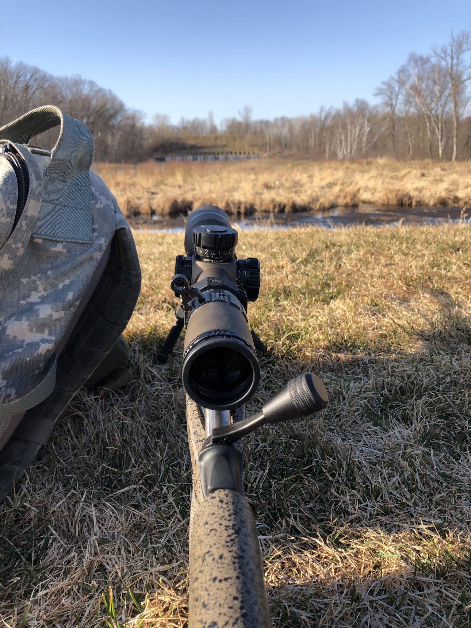

Went to a local skills builder PRS match, basically a learning class but still with time limits ranging from 60-120 seconds. The whole shooting never did it feel liie I was straining to see the target. Very impressed with the quality of the XRS II. By far the best scope I’ve used and I think it’s every bit of worth the asking price. Never had fatigue sitting behind the scope looking for the target or even measuring target like I had with my DMR or LRTSi. The quality is there and the price is well worth, but I was fortunate enough to find this scope for cheap at $1500 like new or slightly used condition. Couldn’t pass it up. If you’re on the fence take the plunge, won’t be disappointed. This is my first season shooting PRS style matches.
