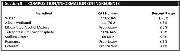

If you did not get a good rinse from the cleaning solutuion the acid or colorant in Simple grenn could have casued the discoloration.
MSDS Sheet for Simple Green:
I would bet it was lack of a good rinse and either the sodium citrate or the colorant had a reaction with the brass.
