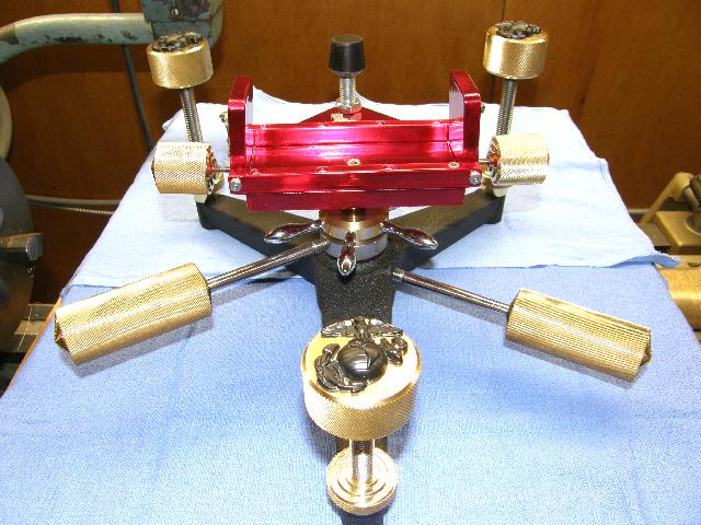

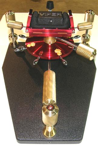

I am fortunate to have a best friend who builds one of the finest rests in the country. He has built me both a Benchrest rest as well as my F-Class rest. I have never seen a time when I was out shot by a joypod rest.
Roland

The guy that got me started in F-class shoots on a Viper. Love the customizing on your rest...Semper Fi
JBD, His a lucky guy then, The man's name who makes these rest is Bob Pastor, he does a hell of a fine job and the rest's themselves are a thrill to shoot off of. You actually wouldn't have to have to separate rest like I do. The benchrest model would work very well at F-Class just with the addition of F-Class feet. Semper Fi!!

Those things are slick! What bag are you using on the Fclass rest?
