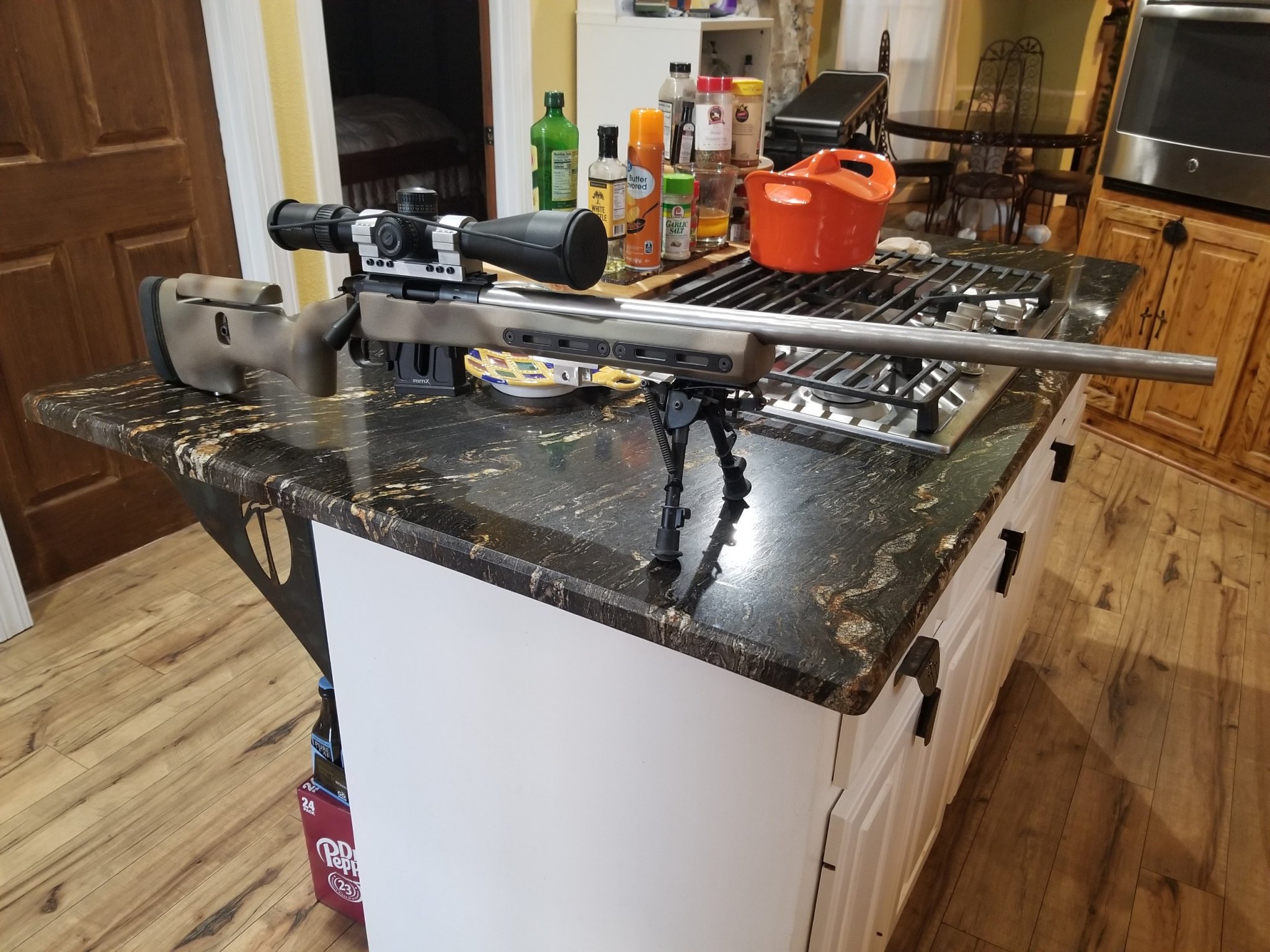

Sorry men! I've been out of pocket awhile did get the Bartlien trans in. Got it spun up to a heavy Palma length dialed in at 26.375 precision machined the chamber to a 52d super match short finished with a diamond form lap. Zeroed and shot yesterday at 200 yards the great grand sons were down. Out of 50 rounds at 200 yards the 6 year old went 15 for 15 on a 6x6 steel the 11 year old went 11 for 15. PaPa shot the swinging crow with 20 under 2" 11 were just over 1". When the wind settles and the temps drop I'll be running it at 400 in a 5x6 Ithink I'm gonna be I'm pressed !
Don't really understand your last statement. A swinging crow is a large target. What was your hold point? Are you saying you shot a 20 shot group under 2 inches at 200yds? Also what ammo were you shooting?
I thought I had pics of my crow couldnt find it. I zeroed this barrel at 200 yds I just mounted it last week havnt really worked it that much. Ammo was SK yellow box and yes 20 rounds at 2" maybe 2.125 I built this barrel off a barrel that shot killer last year it was a Bartlien 11-10.5 at 25" with a standard 11° crown. This barrel came in at a 11.25 to 10.875 twist with a duplicate Kimber step crown length is 26.375 Inches. The chamber is a Mod 52 d with conical lead .0003 tighter and short the bullet is engraved within .050 of the case lip. The crow target is life size all my metal is cut out on laser. I attached a pic of last years barrel at 200yds the 11-10.5 with 4 rounds just outside a 2" diamond out of 30 rounds 20 of them running around 1.8" this was with SKLR the ammo lot I built the new barrel for I'll start shooting it soon
