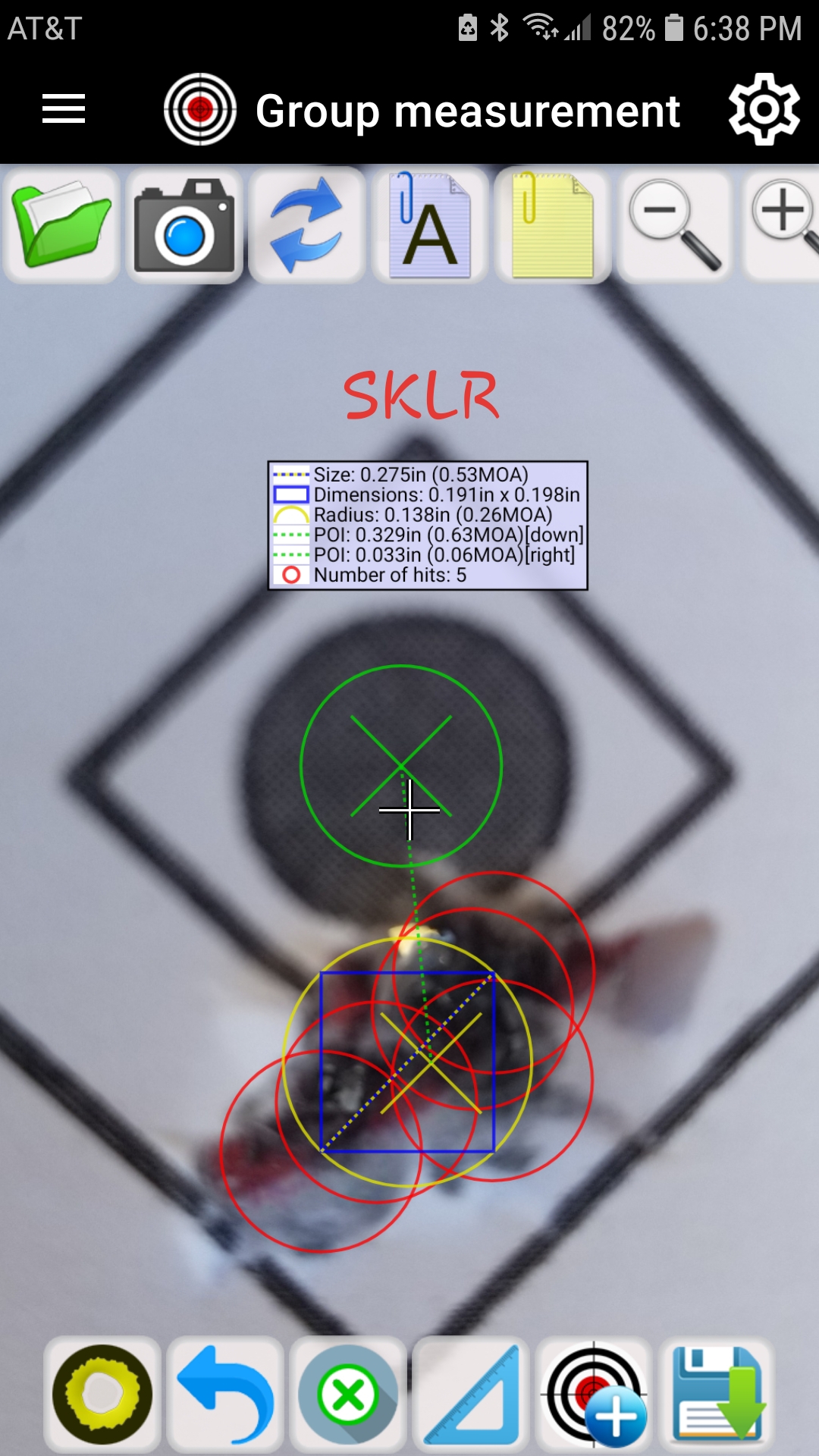

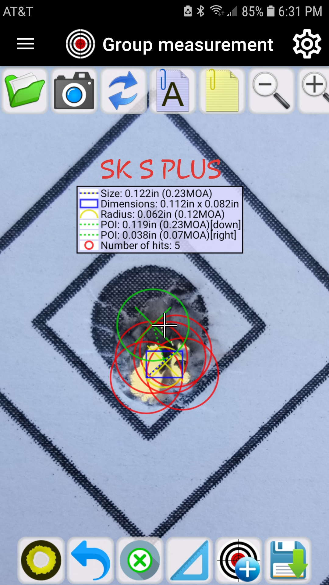

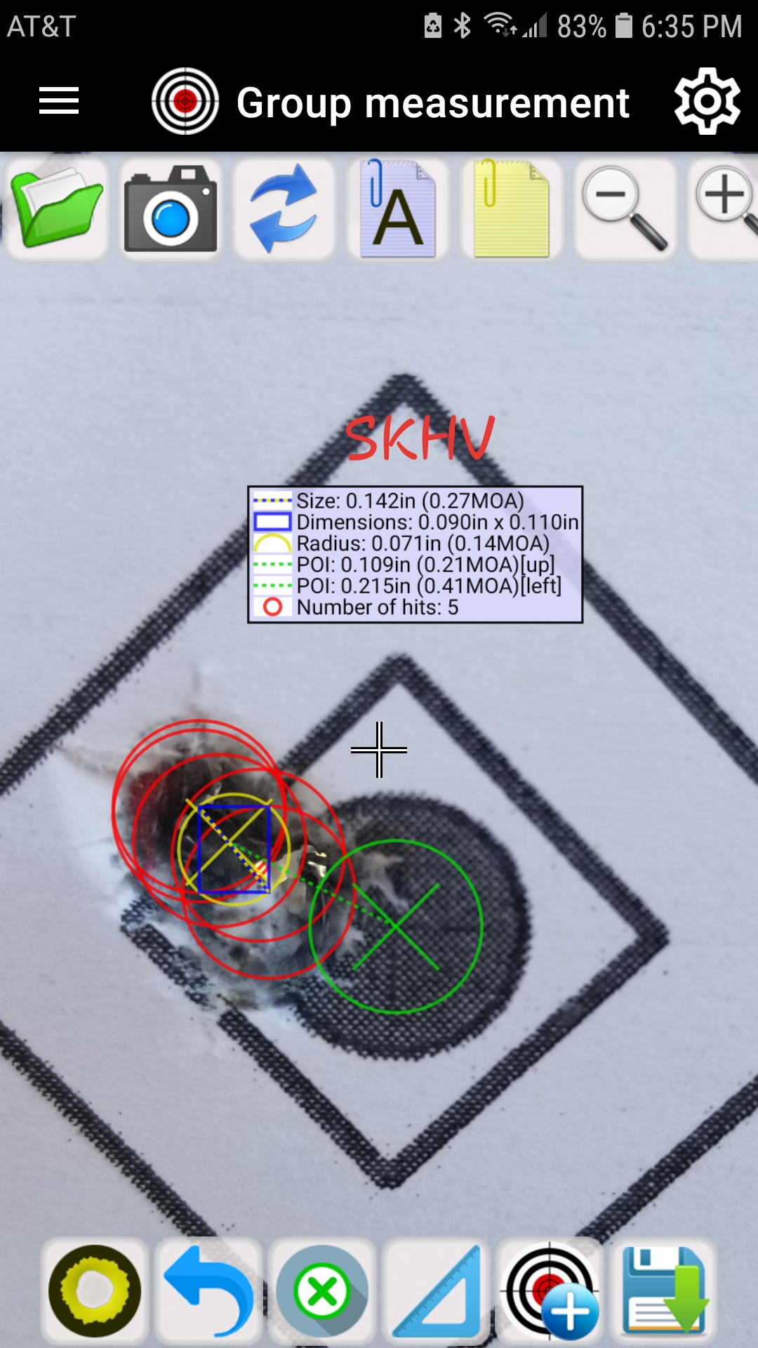

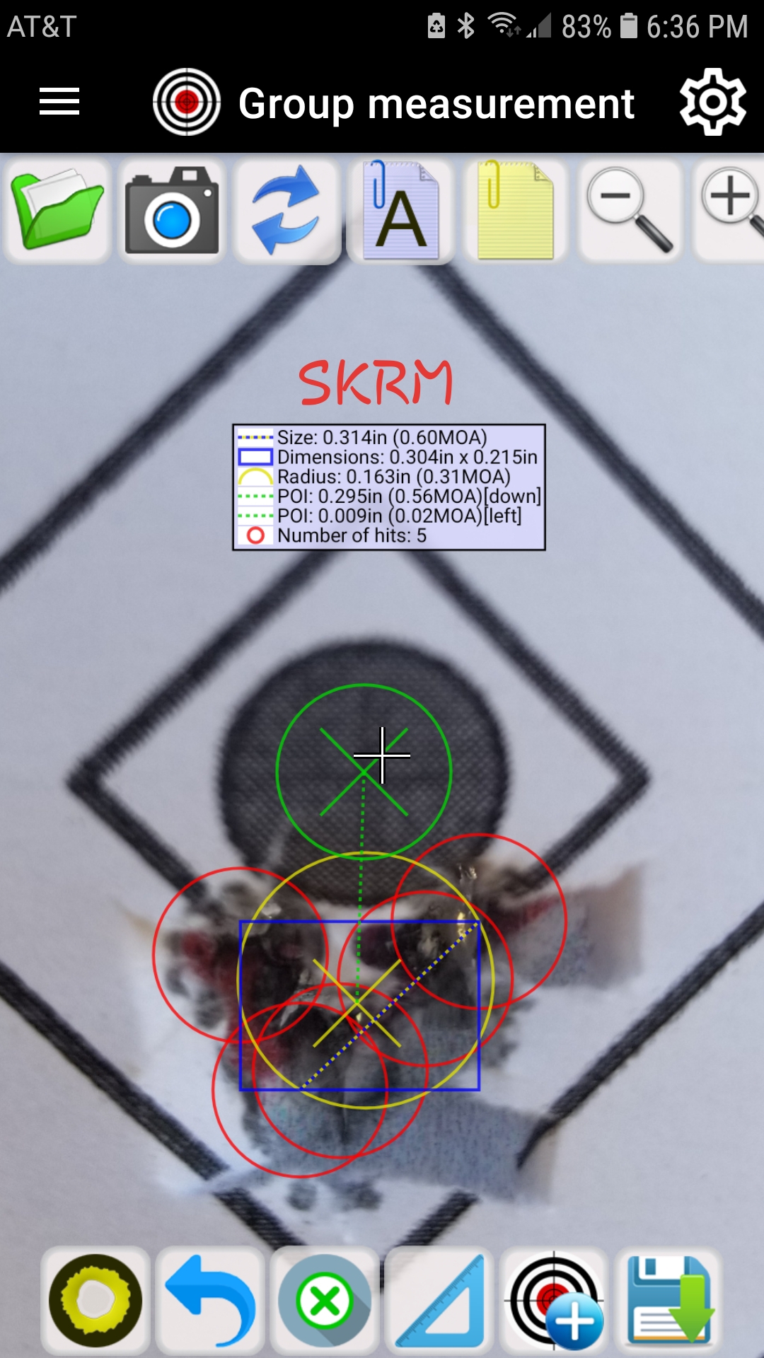

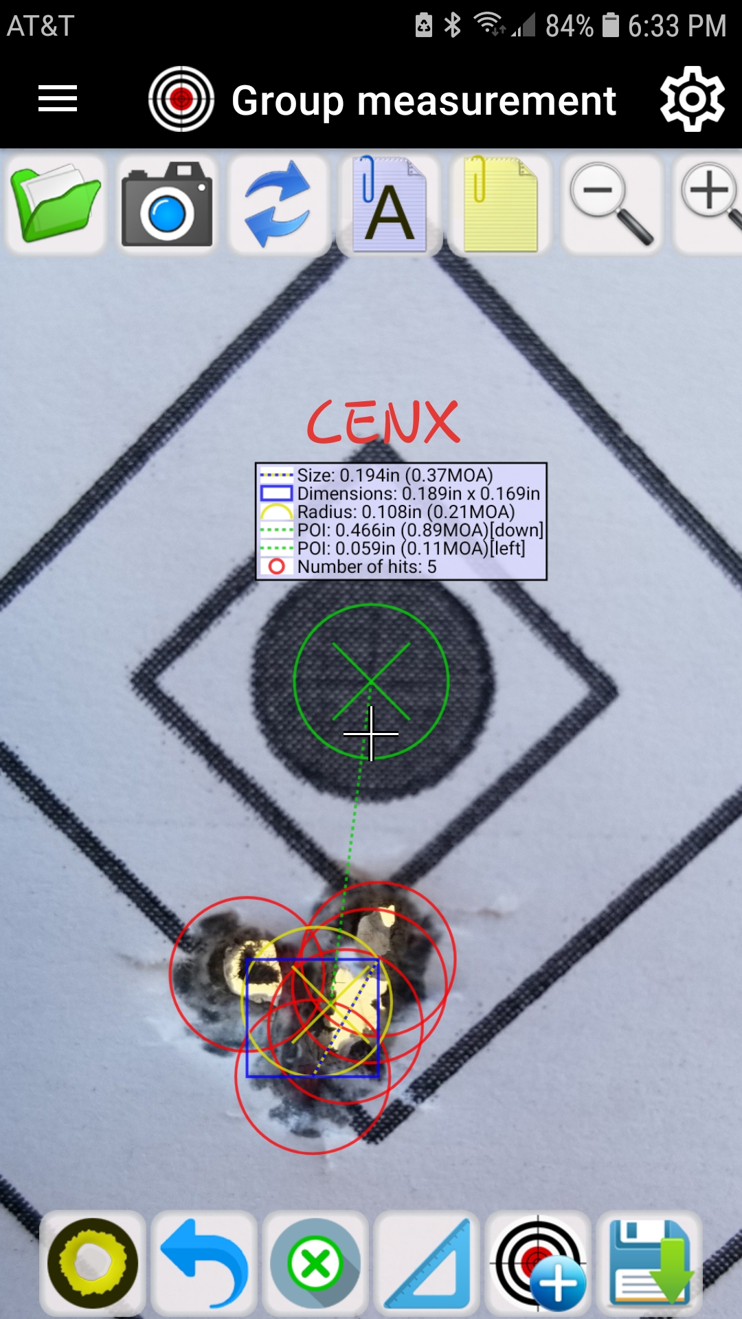

Well we dropped her 26 clicks and pulled her back 8 left for the wind from 200 the other day. We shot 5 consecutive groups with 5 different lots at 50 yards with no foul shots this barrel likes alot but the SKHV might be deadly from 300-400 with that extra fps , but the plus shot best for variable wind and heat.
