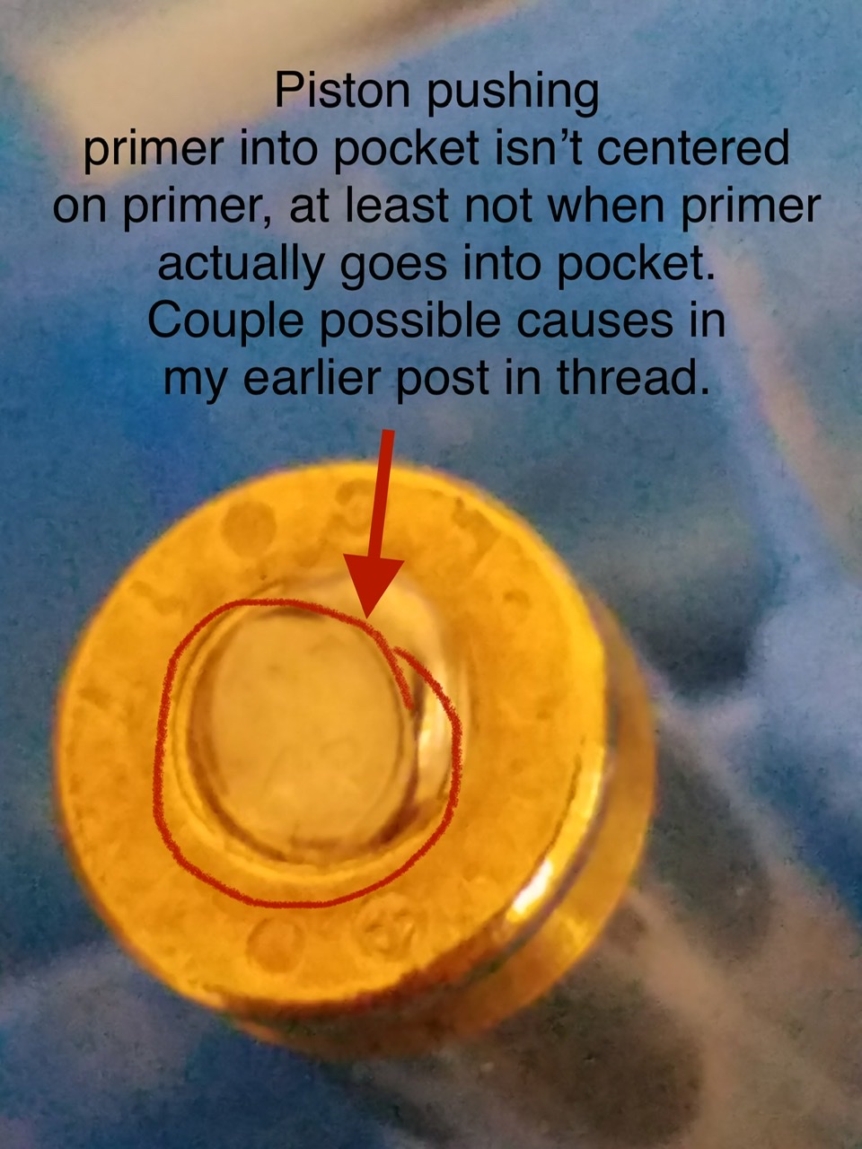

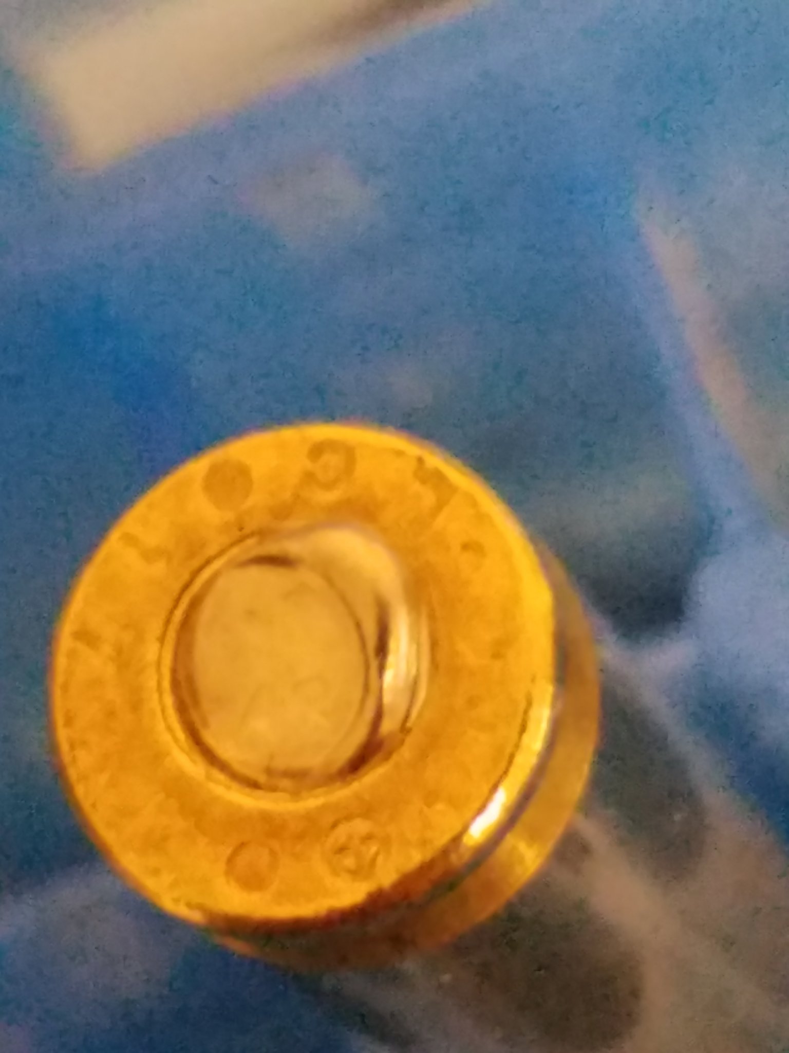

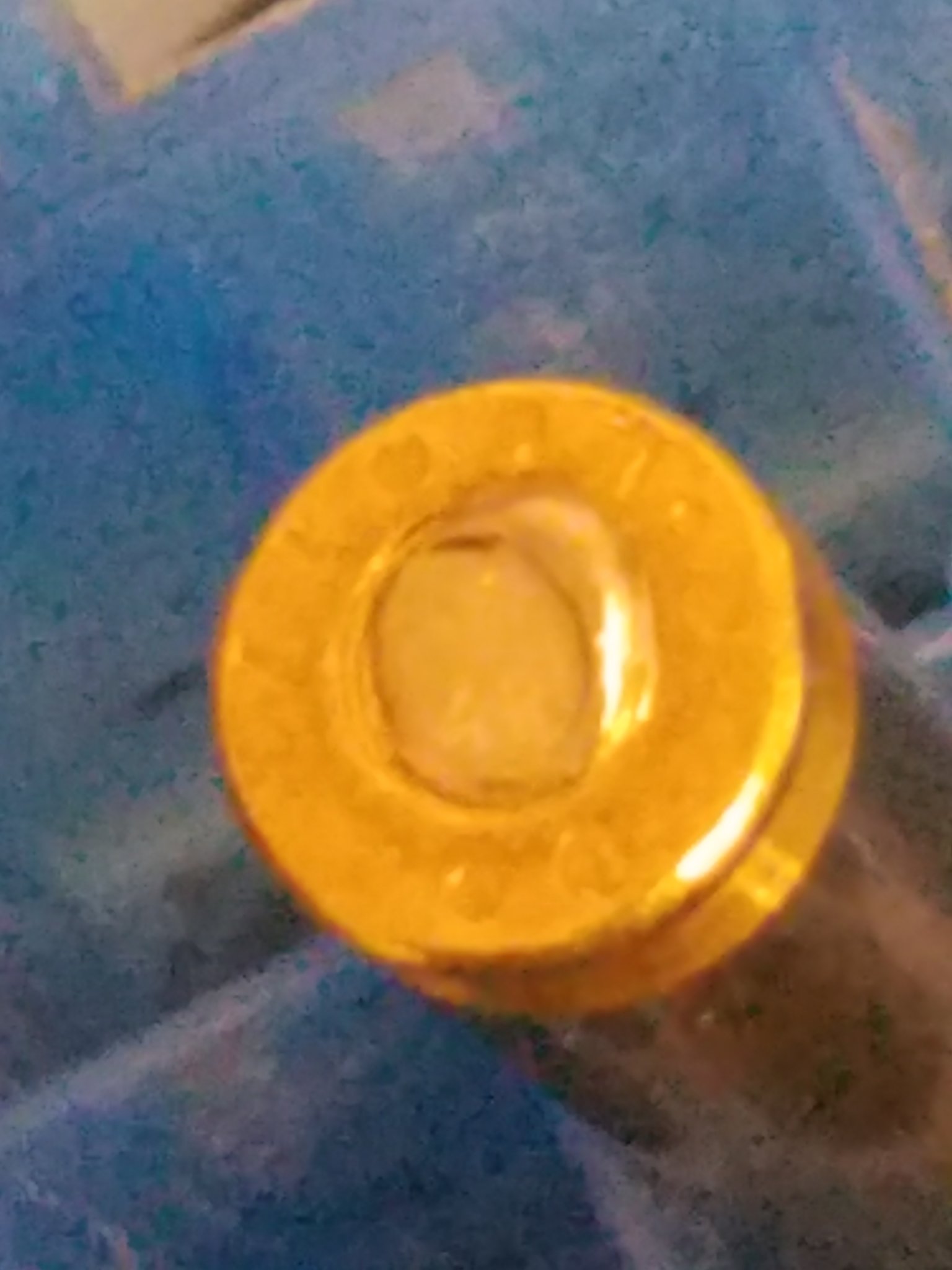

These are examples of what happens with the 205mar

I’ve seen this when primer pocket and priming tool don’t line up. Primer starts crooked, cup catches edge of pocket and crumples giving you a FUBAR’ed primer.
Could be pocket isn’t concentric in case, could be misalignment between shellholder and primer carrier,
I learned if I ease into seating primer I could feel the problem cases and realign so primer would seat w/o damage but definitely slowed production rate.
