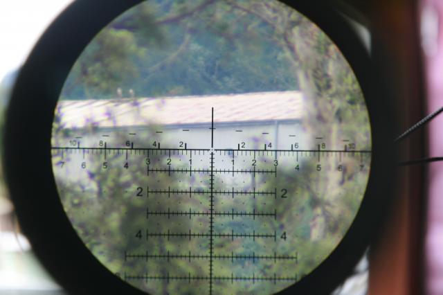

At 20X you will be able to hold about 9.5 mils. 10mils would be the very bottom of your view. You could always back off the magnification a bit, or hold 10 the dial 2 mils.
Found an image of the XRS 4-30x50 H59 at 30x zoom. I'm seeing about 7mils of reticle.
Thanks for the helpful replies. I would have liked to not dial and use the highest magnification at longer ranges (900+) but it looks like it's not happening.
It depends on the trajectory of the caliber you are shooting. That, and the size of your target.
Rarely will you use full magnification at the longest of ranges anyway. If you want to hold instead of dial, what is the problem with using a standard reticle with Mil hash-marks? The G2 would be ideal for your purposes.
The h38 indeed could be the answer to "your" problem, since the center of the reticle (your 100 yard or meter zero) lies a wee bit higher than center...thus allowing you to see more of the vertical part of the reticle at higher magnification than with a standard h reticle.
