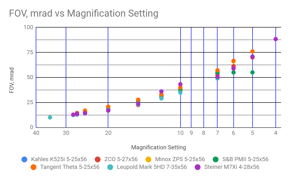

Not sure what California disclaimer is supposed to be. I think you are using a whole series of strawman arguments, so I guess I really do not understand what you are getting at.
If you are claiming that noone pays attention to FOV, I think all of the serious reviewers do. I know Bill does and so does BigJimFish (there is a reason I am comfortable putting their work on my website; I may disagree with the here and there, but their stuff is always thought through).
I always list FOVs and add FOVs at the same magnification in every spec table, so that people can compare apples to apples. I have been doing it this way for at least a decade and probably longer. Here is the latest example:
If you look at the spec table, notice that I list the FOV at 10x for every scope. That is at real 10x magnification, not at whatever is marked as 10x. That will directly correlate to apparent FOV.
I don't think anyone disagrees that FOV is important. It comes up in every conversation on crossover scopes I can think of.
However, decoupling FOV from magnification is not productive, because then you are decoupling eyepiece size which feeds into overall bulk of the scope. That is particularly important for crossover scopes. Everything is a compromise and we can have a nice discussion on what is more important for different applications, but if you are throwing around hypothetical configurations that do not exist, then do not omit what you would be sacrificing .
In general, I do agree that apparent FOV does not get the attention it deserves with riflescopes (if that is the point you are making), which is why I made that video and I have some ideas on how to illustrate that better in future videos. However, FOV does get discussed a lot.
Lastly, keep in mind that the way magnification rings are engraved is somewhat arbitrary.
Here are some measurements as a function of the magnification setting:
ILya
ILya

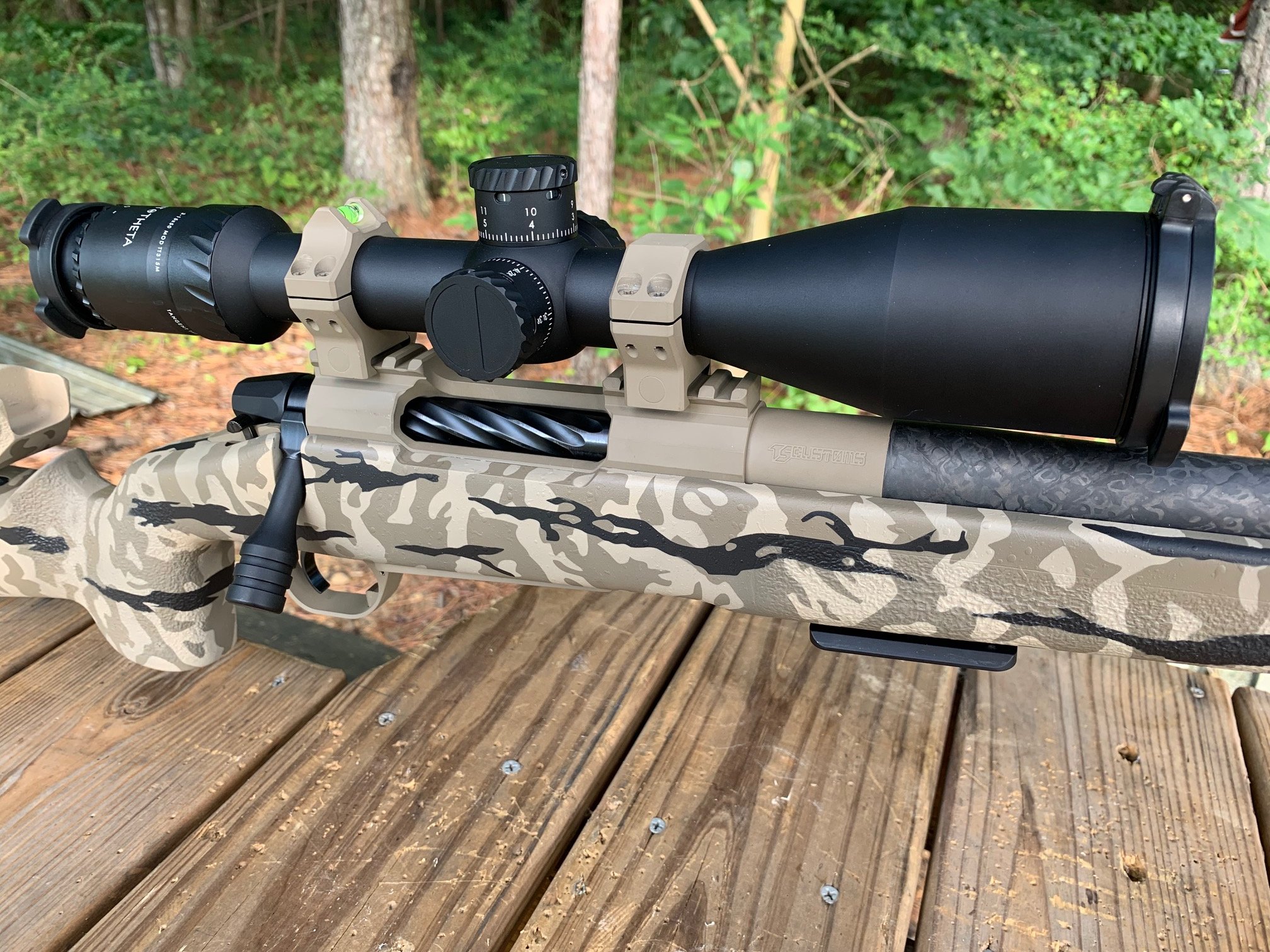

Finally got it setup. Love the glass. Love the center dot and simple reticle for hunting. Simple zero stop setup. Love that the reticle is usable all thru the mag range specifically being able to see the center dot even at 3 power for those possible snap shots that can happen while hunting. If I had any negatives on it it would be the eye box and parallax are touchy at max end of mag range but that's really being picky
Sound move for a nice rig; I assume you picked the FML-1 reticle?

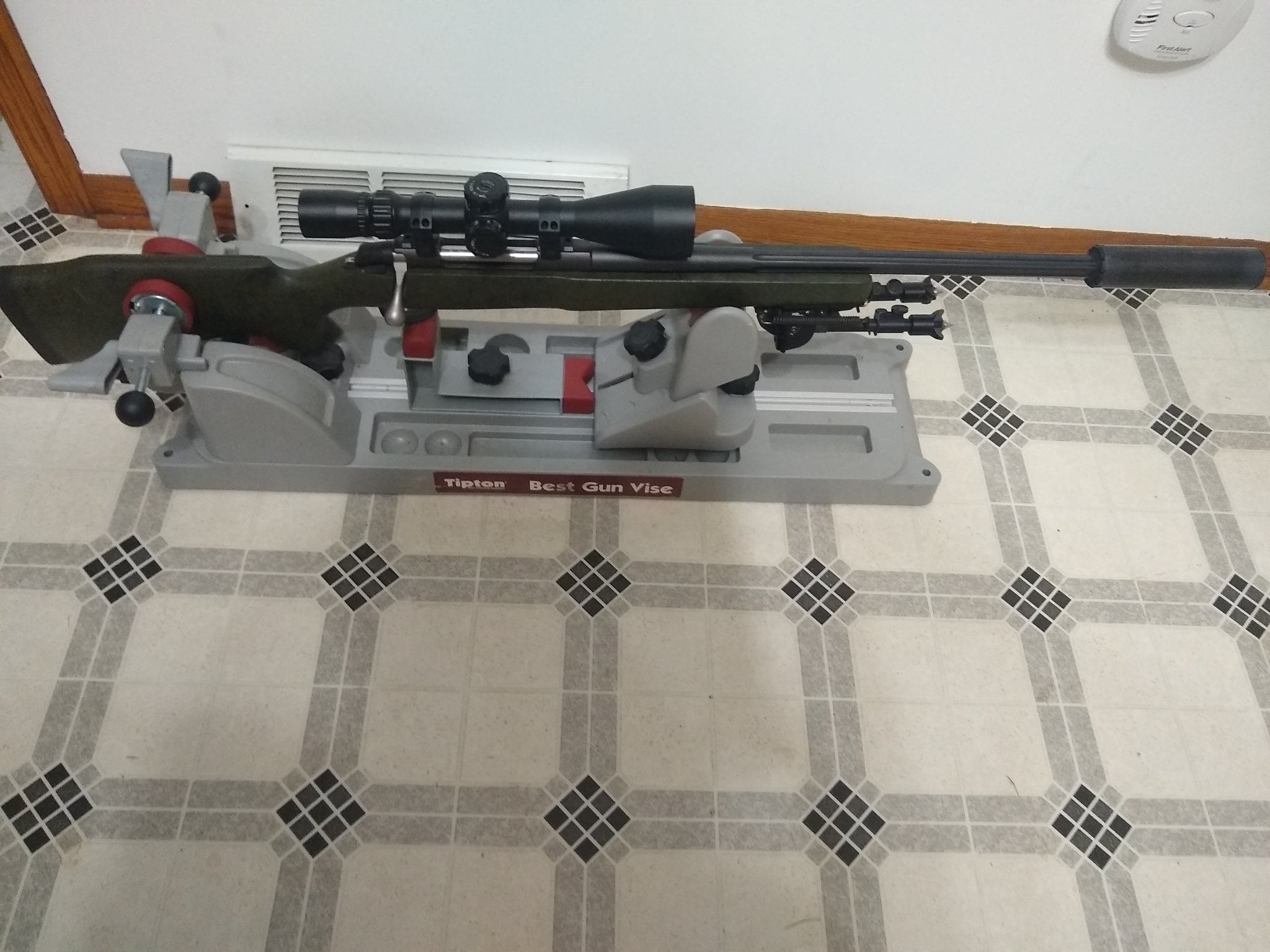

Well the March setup worked beautiful in SD. Sold the rifle tho and working on a lighter weight setup lol. Always can do better/lighter/faster. Thanks for everyone's input. Brent

I've been down this road and have had most of the shorty scopes as I was running a 16" Desert tech and didn't want gas blasting my glass. The two common issue had with S&B US, Khales 3-18 and MK5 are parallax is not as forgiving as your full length scopes and CA. I know CA does not bother some people but I hate it. The only short scope that I did not experience the CA is the ZCO 4-20. I hate the S&B turrets, clicks way to close together, and was just underwhelmed over all with the MK5, given its not a $3000 scope.
After a lot of trading and buying I got the TT 3-15M, this is one amazing pc of glass. No CA, very forgiving parallax, glass has edge to edge clarity, awesome turrets (11 Mils per Rev) heavy clicks and have never had them turn on me and its 27oz. Its just the perfect hunting scope if you want FFP. My second choice is the ZCO its just a little heavier but a very solid choice. If I was on a budget the MK5 would be a solid choice as did everything well other than what I stated above, tracking, illumination, turrets were very acceptable, reticle mehhh.
Good luck with your decision! View attachment 7413694
That setup is very nice and I also own the TT315m and ZC 4x20 and they by far are my favorite scopes.They both just make my shooting experience so much nicer.
