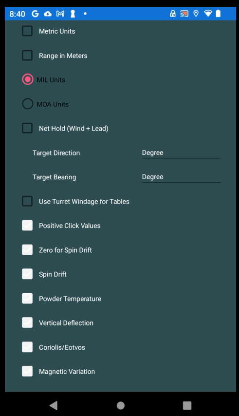

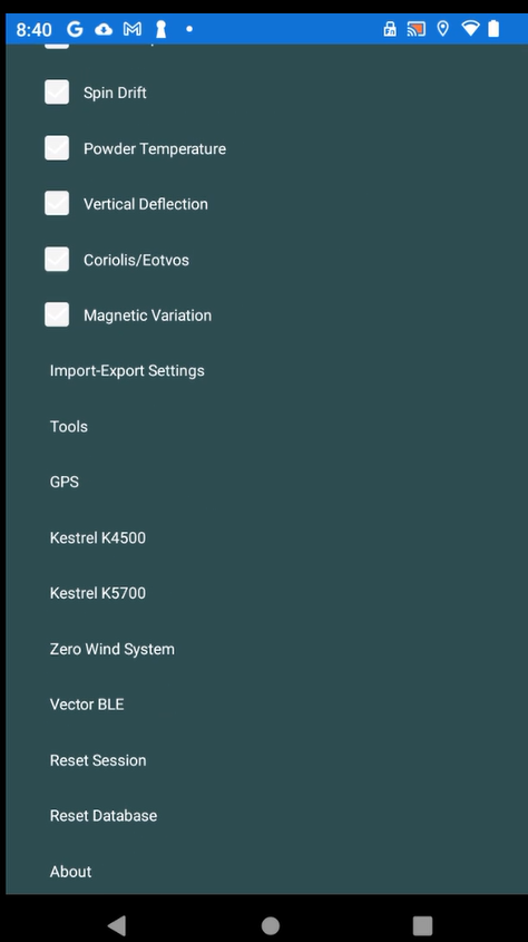

Field Firing Solution (FFS) new Android release?

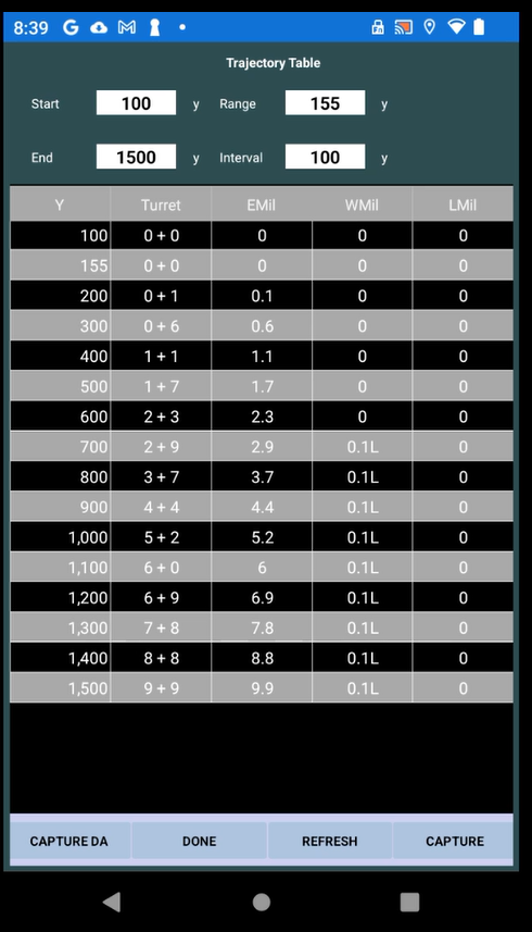

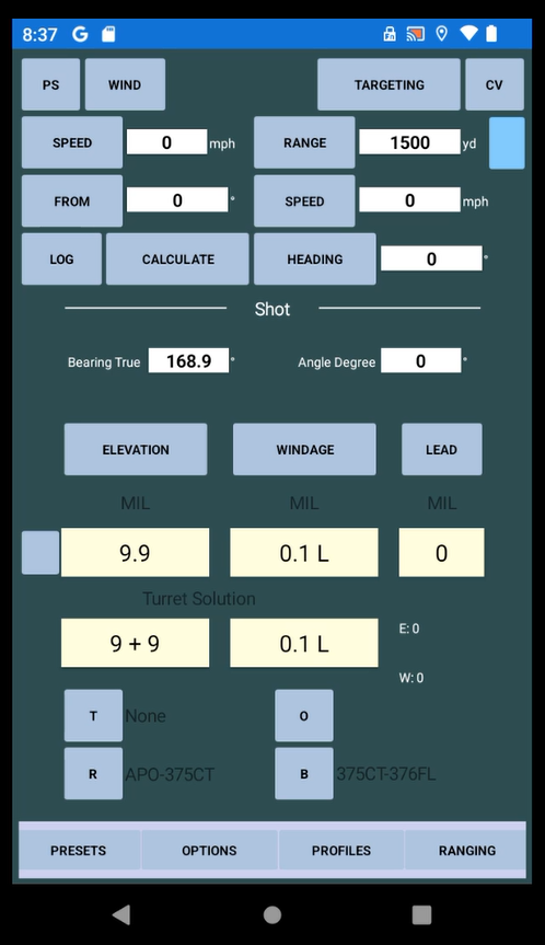

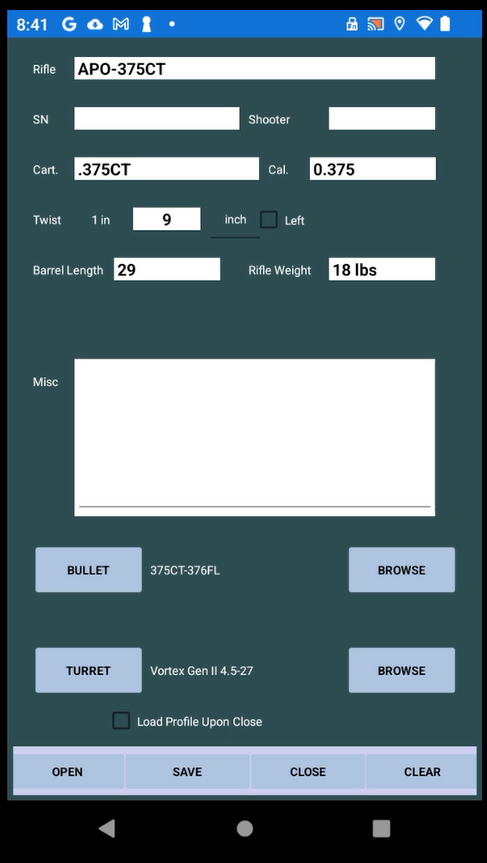

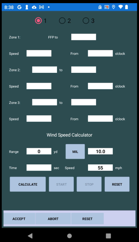

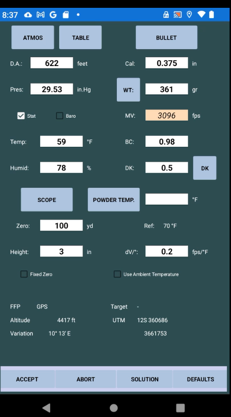

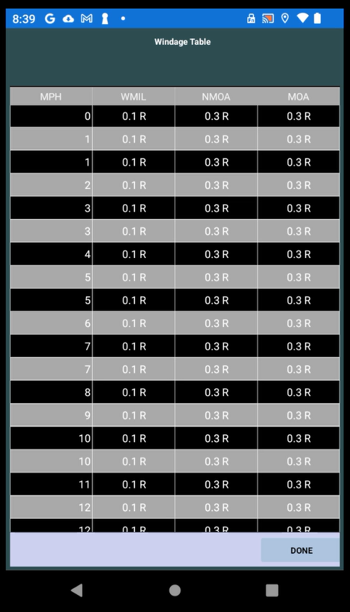

Some screen shots of the work in progress
I think that being targeted to run on Android devices, the UI should be revamped a lot to fit the modern designs and at the same time taking advantage of the current UI paradigms. Honestly, refactoring the old FFS won't cut the deal. Still looks like an obsolete DOS :rolleyes::rolleyes:

Certainly future versions will take some advantage of the options available, but the initial release will follow the original program for familiarity. The reality is a field ballistics program is just some numbers in and some numbers out. Look at the success of the Kestrels with ballistics, the worst user interface possible, but still quite functional.

I want a UI that lets me select a platform, enter the environment, then present a page with the relevant data for the shot. All other functions should be layered behind that. I have no use for graphical representations of reticle holds, nor graphs of the trajectory or stuff like that. I don't need a map view of targets, a list with range and azimuth is plenty. As a rule, fancy and flashy just get in the way when working.
The above being said, if there are any Android UI experts out there that would like to contribute ideas on the UI, feel free to send me notes or sample files. The project is currently Xamarin Forms, as we had some issues with MAUI.
