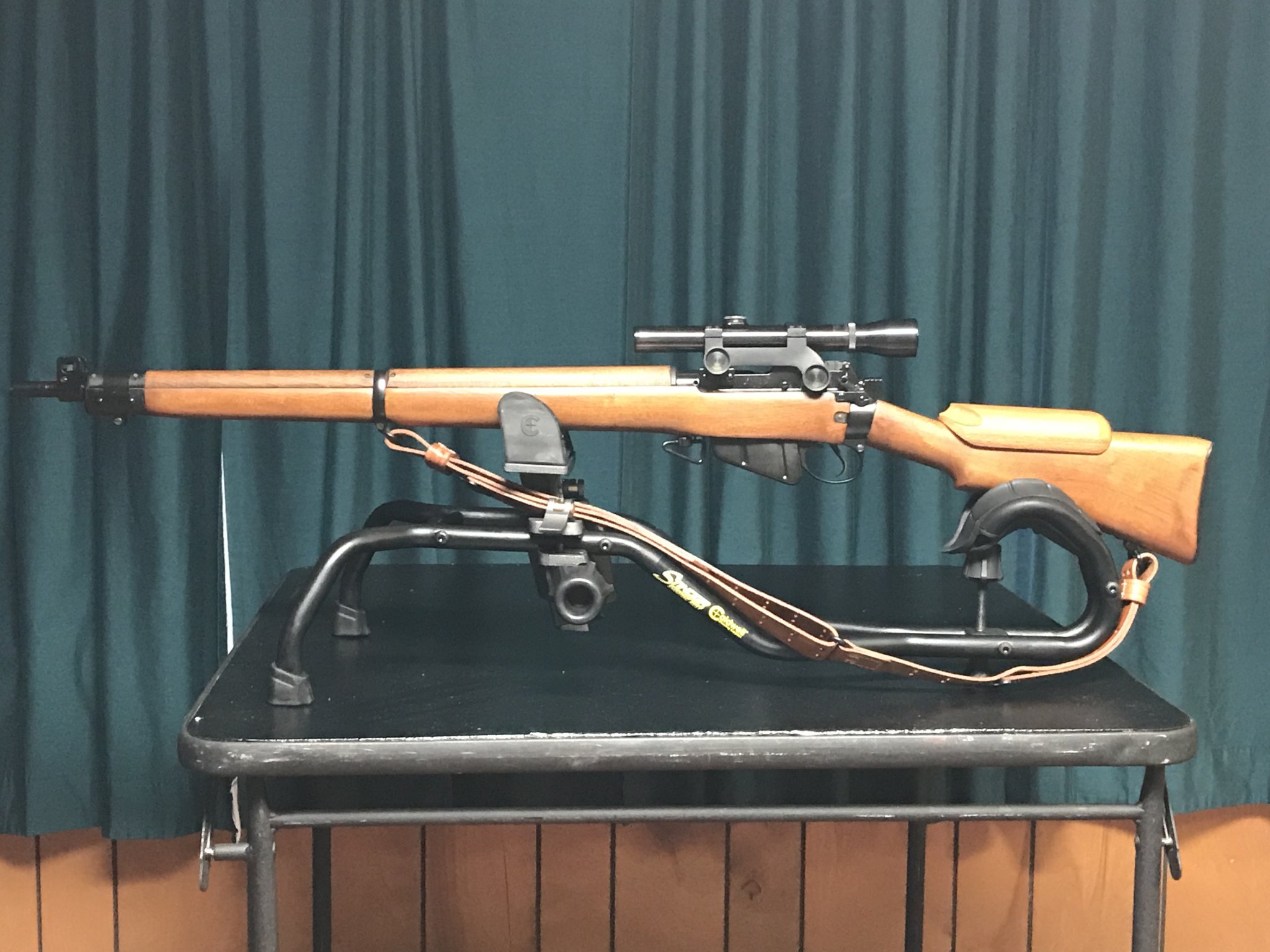

A couple years ago I bought a beat up 1942 Longbranch Lee Enfield No4. The stock was shrunk and the barrel turned out to be shot out but I got it cheap so no worries there. I decided that since the barrel and stock couldn't be saved I would salvage the reciever and get it turnbed into a repro sniper. I already had the stock and Criterion Barrels makes a .303 military profile, so I just needed to source quality pads, bracket and a cheek riser. I contacted Fulton of Bisley in England and got the pads through them. The bracket I got from Roger Payne, a former British armorer who built L42 sniper rifles, that were based on the WWII Lee Enfield No4 (T), back in the day. The cheek riser was sources from DS Solutions also in the UK. Yes, you can find cheaper knockoffs, but they have a checkered track record for quality.
I contacted Brian Dick who is the gunsmith for the Lee Enfield in the States. He's the one who every Lee Enfield enthusiast recommends. He doesn't do reproductions so he recommended Bruce Dow for the conversion work. Dow isn't a big name, but he has a good reputation within the precision shooting community. He rebarreld the receiver, mounted the pads, and collminated the bracket. He also refinished the metal parts before sending it to Brian Dick who restocked the rifle to MOD 1 standards. This is the end result...
I’m hoping to get it out to the range this weekend to break it in and I may still get a repro scope (currently has a K3 on it) but I couldn’t be happier!!

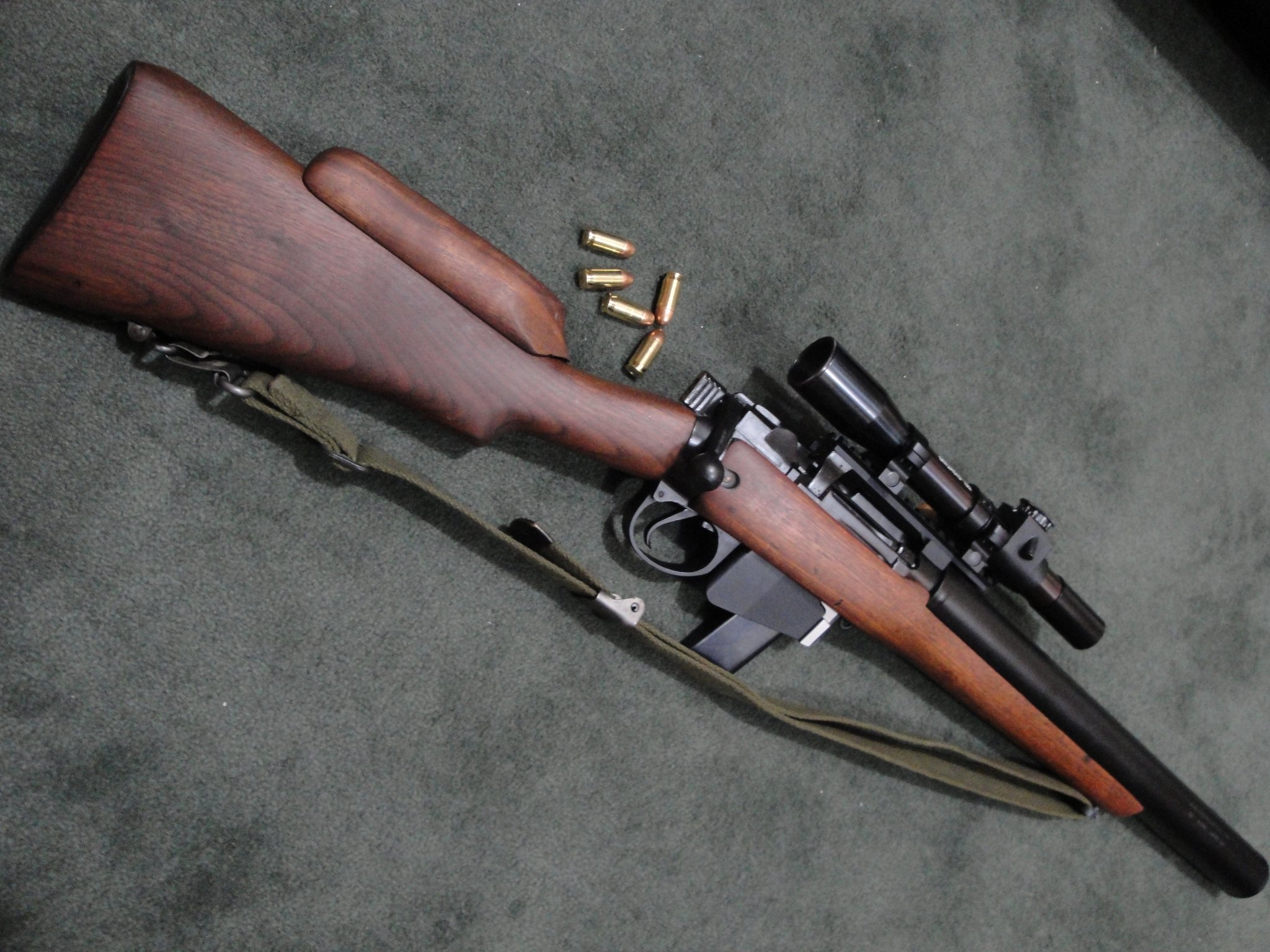

Its Delisle inspired but not an accurate copy. Fun to shoot!

***Range Update***
So I got her out to the range today to finish barrel break in and scope dual in. After I had the scope zeroed I shot a few 5 round groups using Hornady Vintage ammo. I’m an average shot, maybe a little better but over 3 groups each starting from a cooled barrel I averaged about 1.75 MOA. The interesting thing was that the first 3 shots of each group were cloverleafed and the last two rounds opened up the groups.
I’m quite impressed and happy with the rifle and I look forward to seeing what handloads can get me down to.
