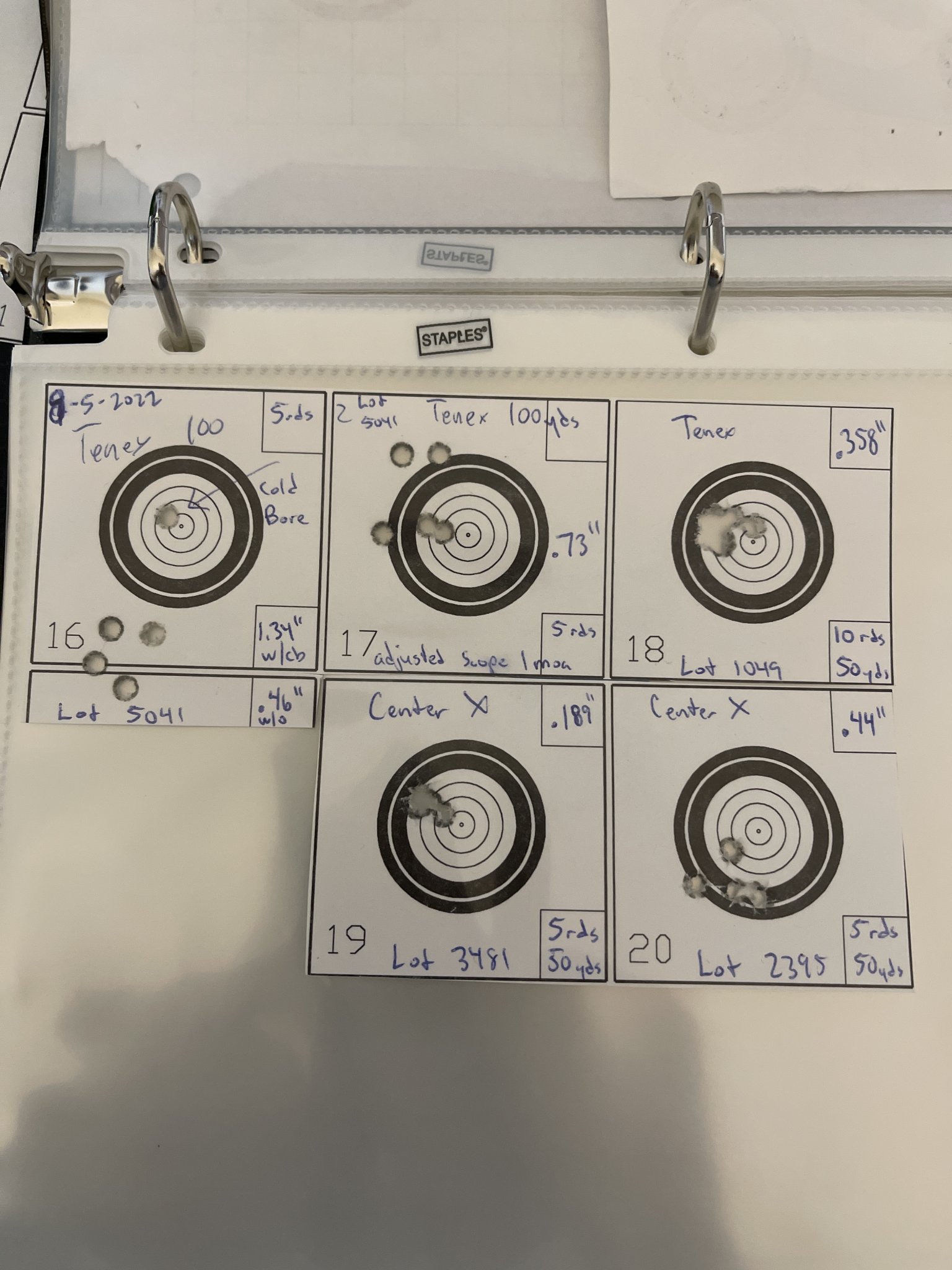

First 85 rounds from my vudoo…. Kind of interesting…. To me
Klay23
  • Jan 27, 2021
    562
    157
    South Carolina
    After a long wait I finally received the vudoo I ordered back in January I think it was. Thought it would be interesting to keep track of shots and groups etc. almost all of these were from 50 yds except for the 2 groups at 100. They are all 5 round groups as well with various ammo. Group size is being measured from outside to outside minus .22”. Very happy with this vudoo. Need to shoot some more groups at 100. I zero’d it off one lot of Center X and otherwise have been simply holding center of target for everything. None of you may care but the information is interesting to me anyway, ha. Everything off of a bench over the last week. 3 different times out shooting also. This is literally every round threw this rifle so far other than the first 5 rds to get the scope on paper. I have had no issues or hang ups in any way so far.
    Different ammo:
    Center x, 2 different lots
    Sk standard plus
    Lapua Midas +
    Sk long range match
    I’ve never been to or shot in any 22 comp so curious if this is good enough etc. I just shoot with a couple friends and can only compare it to that

    Back to the og topic…. Curious if these are decent groups? I have to admit they are “so far” better than my cz457 with lilja barrel. Cz has shot lots of good groups as well, but just seems to be less consistent. I do love the MPA chassis though and the magazines are much easier to use/seat/load etc. Sorry if this seems ridiculous. I have never shot in a competition or anything like that or seen one. I just shoot with a couple friends here and there and they seem good comparatively.
    When I was at the testing facility in AZ, I saw a few vudoo's that were grouping .2 and below. The 50 yd group looked almost like 1 hole. It was amazing.
    you are in the going in right direction with your .3.
    if you really really want to see what your rifle can do... send it
    edit - I saw your .135 ... I think you are there :); but I'd still send it. It's pretty damn cool, all the work ups you get with different ammo. you can also see what your rifle will do with different lots of ammo.
    That’s sk standard +…. It seems to like it but all of the groups aren’t that small. Probably a .3” avg. I have it. Will post it shortly. I’ve kept up with each one out of curiosity.
    Congrats on a good Vudoo. I would try and BUY ALL the preferred ammo you can.
    I think it’s good too, but honestly don’t know. Only one I’ve ever seen. Kind of the point of me posting this. What is real and what is internet…. Ha

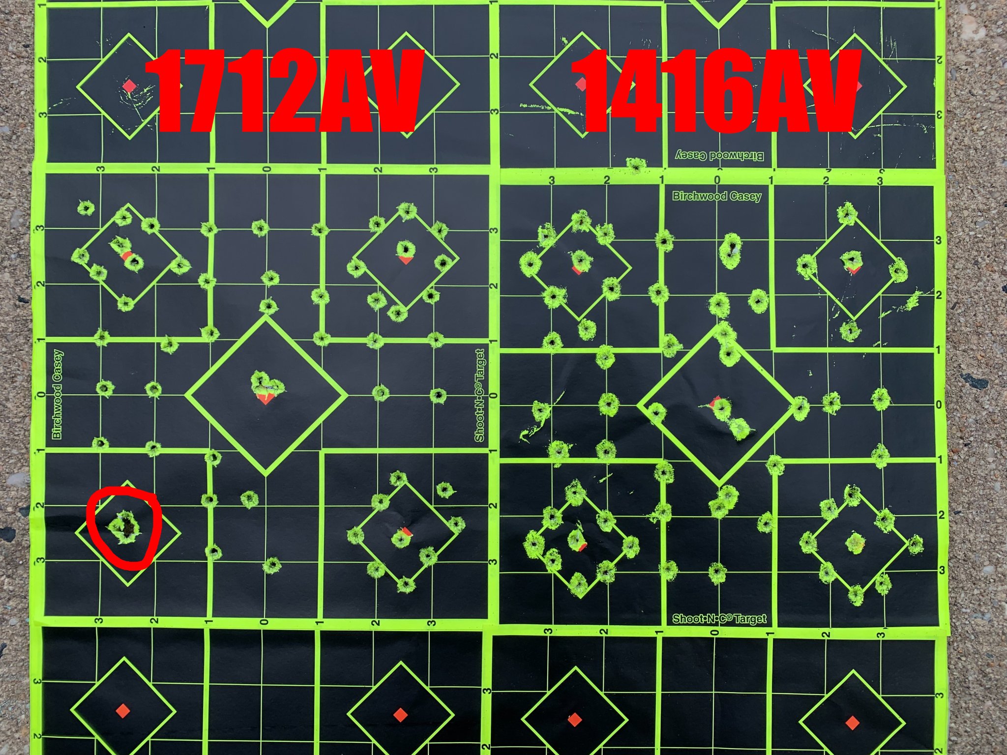

    Groups get difficult if you shoot the center of the bullseye out in the first few rounds. I started shooting "grid" stuff like @justin amateur has posted about, but I use 8" Birchwood Casey targets.
    This was with a couple of my Anschutz rifles, but the concept is the same. Some of the "bad" shots were sighting in, some were me. Any aimpoint can be used, diamond tips, bullseyes, any where the lines cross or touch. The circled group was 10 rounds, this was all at the local indoor range...so only 25 yards.

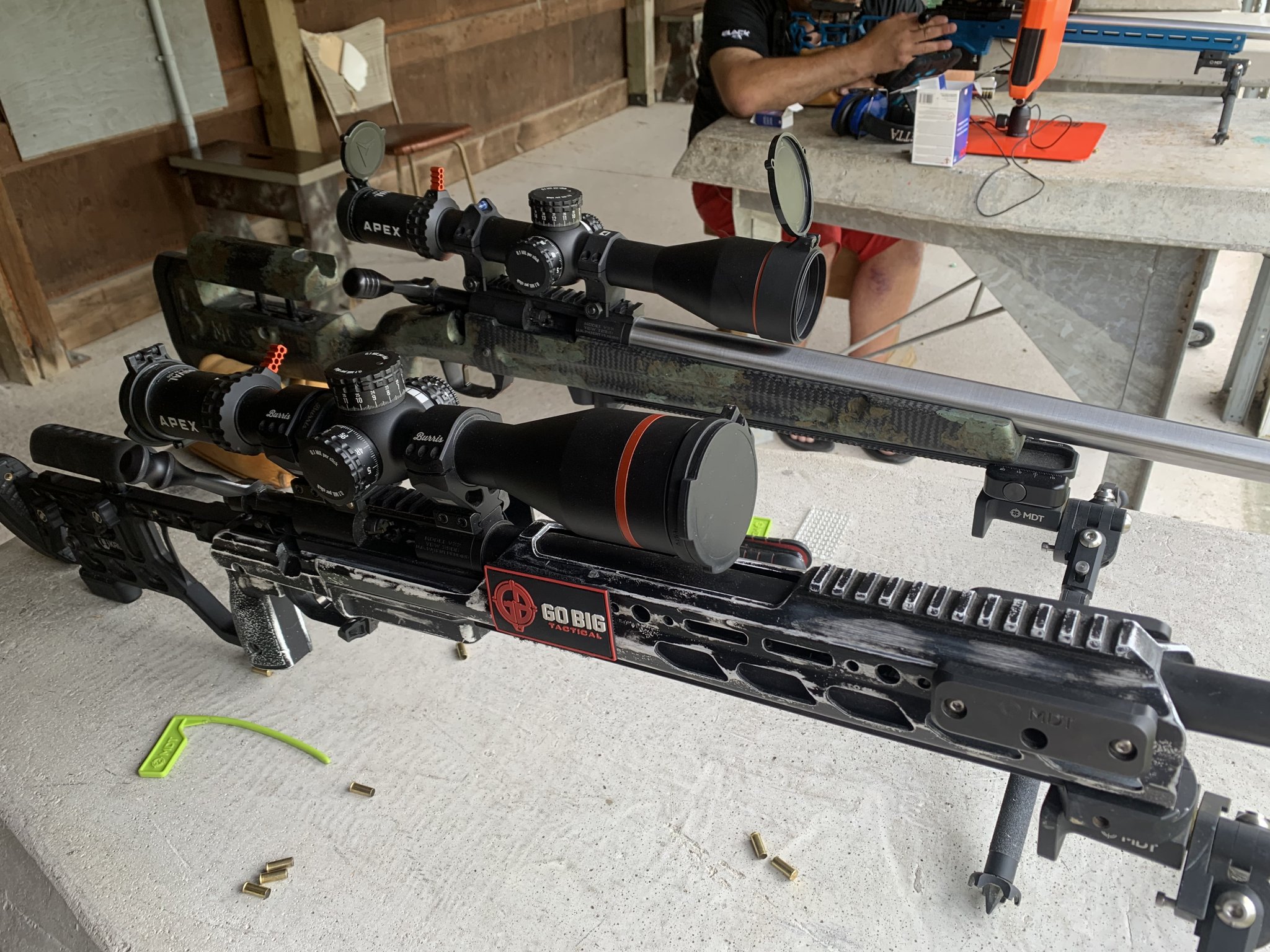

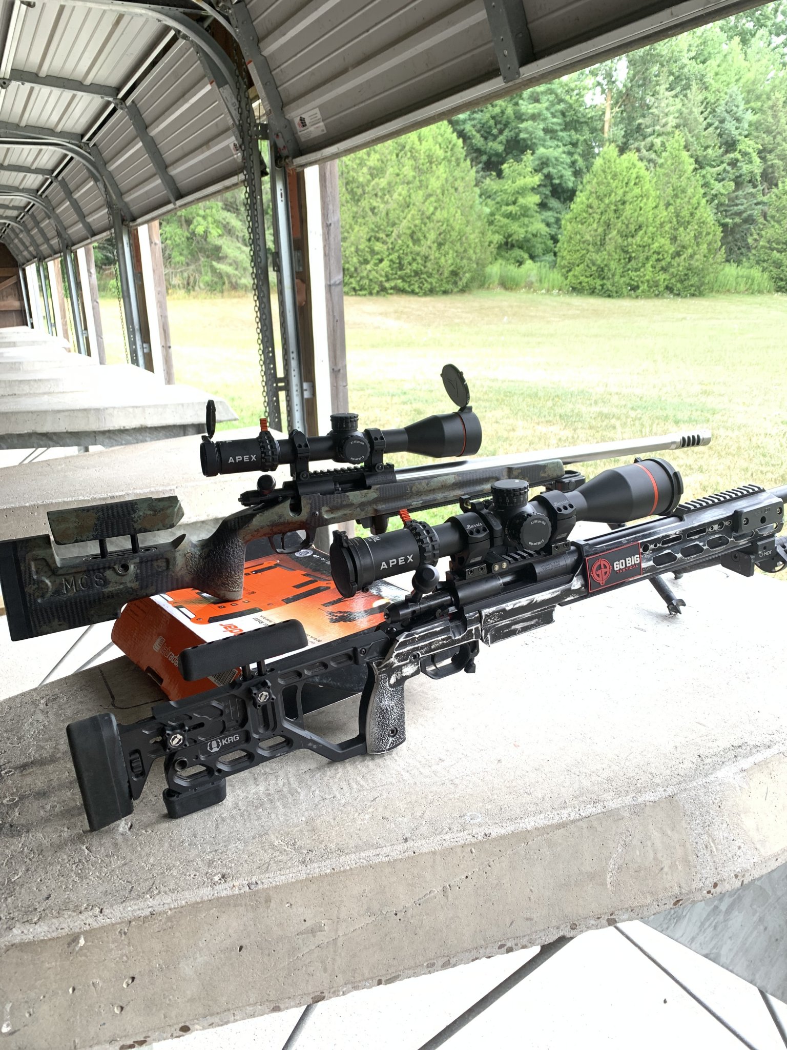

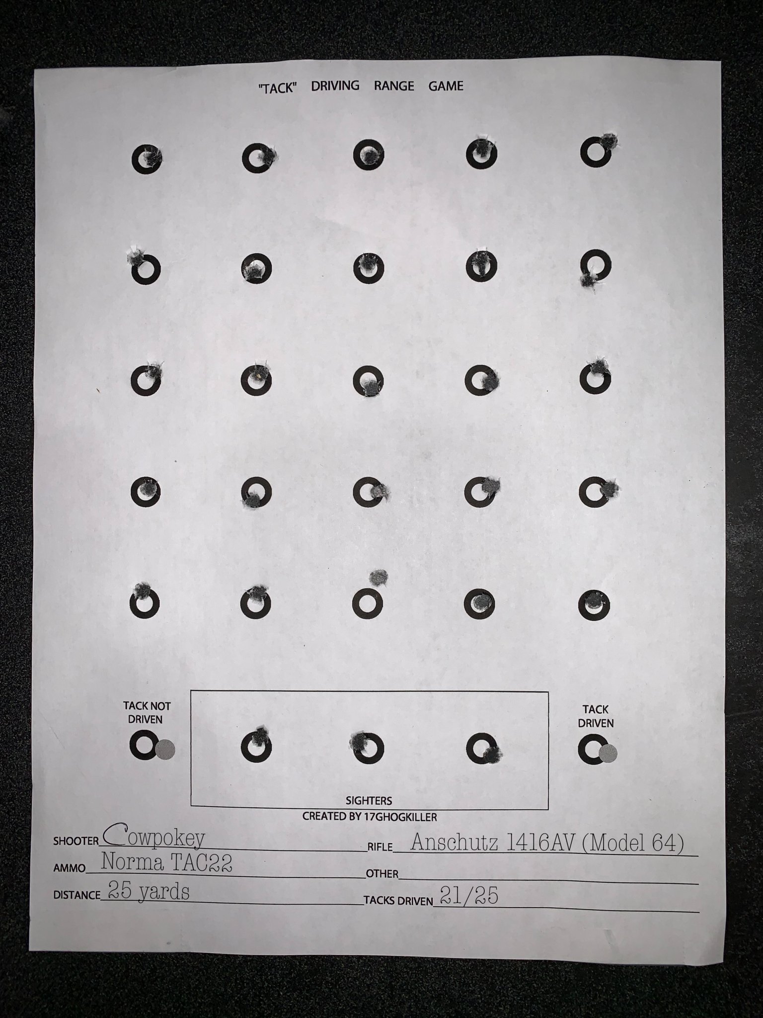

    If you want to compare different rifles competing under essentially same conditions with similar skill levels, check out the history at
    That’s cool. I need to get in one of those. Looks like my setup would be competitive too, ha.

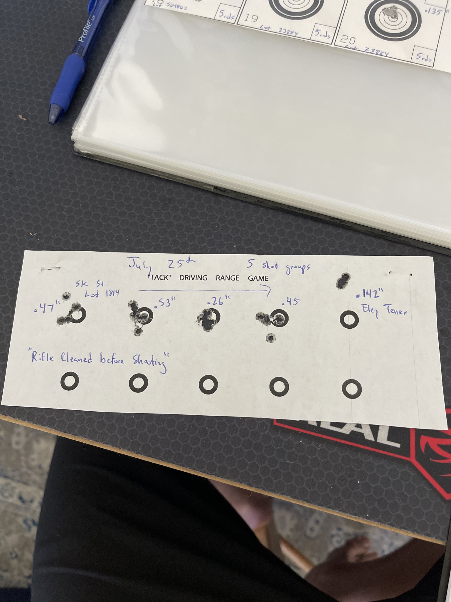

    A couple of thoughts... OP may already know some or all of this.
    • After cleaning, don't shoot for accuracy until you've run at least half a box of ammo through.
    • Different brands of ammo (e.g., Lapua, Eley) use different lubricants. If/when switching, it will take, again, at least half a box of the "new" brand before POI and group size stabilizes.
    • With Lapua or SK ammo (which come off the same lines), the lube on all labels from SK Standard+ through X-Act is the same (only Polar Biathlon uses something different). This means you can switch from cheaper label to more expensive label without waiting for the aforementioned stabilization.
    • At the end of the day, we're talking .22 rimfire and all the weirdness of the caliber. A buddy of mine sent his Vudoo to the Lapua test center in AZ. The rifle set a single 10-shot record of something like 0.4" center to center (they record groups edge to edge) at 100 meters (109 yards) with Midas+. Sounds great, right? Well, I saw the whole report, and the rest of the test groups weren't that tight. My rifle also performed best with a certain lot of Midas+ - the best lot of Center-X performed within a couple of millimeters of the best lot of Midas+, and the Center-X was 40% cheaper.
    • Five-shot groups are all well and good, but to me it's more revealing to see how much larger round counts perform. For example, I shot a mini-Palma match over the weekend, using bipod and rear bag. This is a 100-yard match with 800-900-1000 yard targets scaled to 100. The 10- and x-rings for the "1000 yard" target are 1.52" and .78 inches. I cleaned the COF, scoring 450/32X out of a possible 450/45X. Each of the three targets required 15 rounds for score. The 45 scored shots landed collectively in 1.25 inches. Yes, there are multiple sub-MOA 5-shot groups in there, but the collective aggregate is bigger.
    Fwiw.
    Fwiw.

    I was quite disappointed with my V22R/Three-60 Ravage out of the box. My 457 and Clark 10/22 both shot better groups as brand new guns. I contacted Vudoo and heard back from Mike Bush… if it wasn’t better by 500 rounds through it, send it back to them and they’d figure it out and make it right. But by 500 rounds, it shot great, and I sent it to Lapua to get ammo-tested (though Mike had said wait until 1000 rounds before a Lapua trip). Is it that much better than what my CZ 457 can do? Usually, though not much, certainly not commensurate with the price differential, but it competes in a different classification in our local matches (CZ is “Sporter”), the Vudoo is under “Match/Unlimited”). I don’t regret the purchase one bit.
