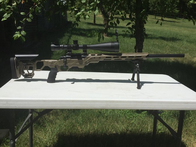

gun is chambered in .260
tac 30 action
26" Bartlein barrel heavy varmit contour
timney calvin elite 2 stage
cadex competition chassis
atlas bipod
sightron siii scope

Nice! Hard to tell from the photo, that's OD color right? I love a good Green/Black rifle! Cadex chassis look so darn gud.
I'll also put in a good word for Greg at Bugholes! Excellent service, helped me out a bunch too, and also very timely! My Bugnut barrel build was the most accurate rifle I've fired to date!
Thank you, It's actually tan, not the best pic......I absolutely love the chassis.
