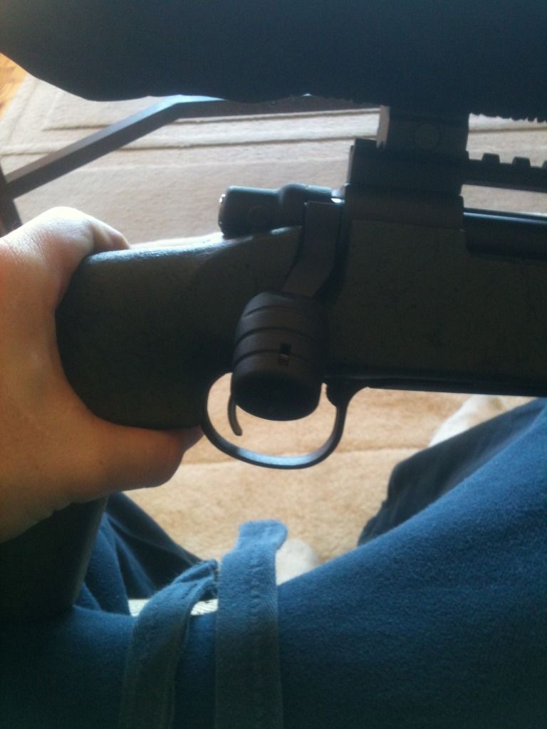

    This is my first post here as well as my first bolt gun build.
    So here it is:
    Remington 700 SPS-V (26" heavy 1:12 rh twist), sitting in a B&C A5 stock, with Millett LRS-1 (6-25x56 mil/mil) 20 moa base. I'd like this rifle to be a good 1000 yard 1moa rifle (eventually). Pretty much everything is stock. It has 52 rounds down the tube with good results (first 5 shot group using 168gr fgmmm):
    until i pulled the trigger on #52... An o-ring came loose or un-done inside the tube of the scope. So it will be sent back to the manufactorer. by the way i do have lower rings coming as well as a harris 6-9 bipod.
    Ok i'm going to cut to the chase, I am active duty military and deploy for whats looking to be about a year in less than a month. The government does not pay me enough to afford what i'd really like to have especially since i'm in college as well. I am seriously considering leaving my gun with a good smith. Work i'd like to get done while being gone on deployment:
    <span style="font-weight: bold"><span style="text-decoration: underline">Action:</span></span> Trued, blueprinted with new barrel. And bolt fluted.
    I recently bought the KRG bolt handle ("cover": http://www.kineticresearchgroup.com/products/boltlift.php) and really like it. It doesn't move around, and make the bolt much smoother and easier to operate.
    As well as action work i'd like to get a new barrel. I would love everyones opinions here. As stated above i'd like this to be a good (not f-tr or crazy good_which usually equals crazy money) just all around good barrel that will shoot the heavier 175-178 at around 1moa at 1k. So i'm thinking a 22-24" 1:10-1:11 5r barrel (eventually threaded for a suppressor). Which barrel manufactorer? idk i'd like everyone opinions.
