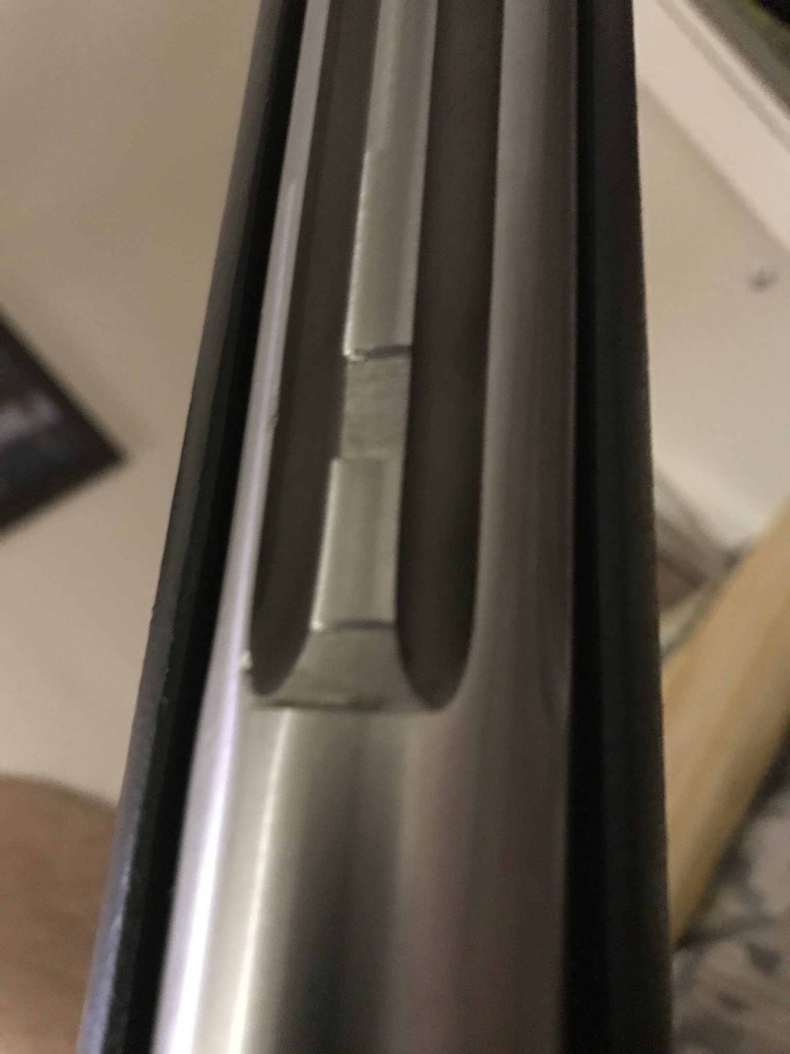

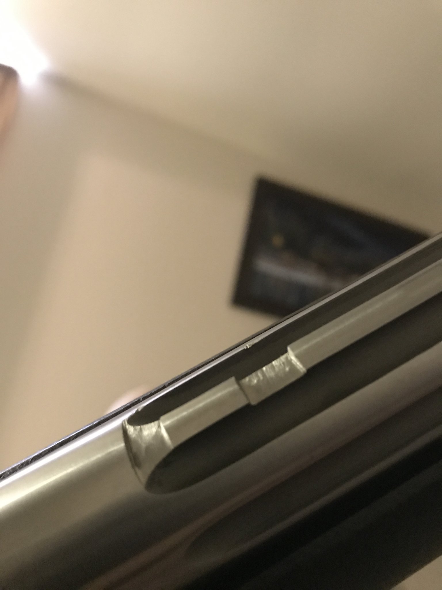

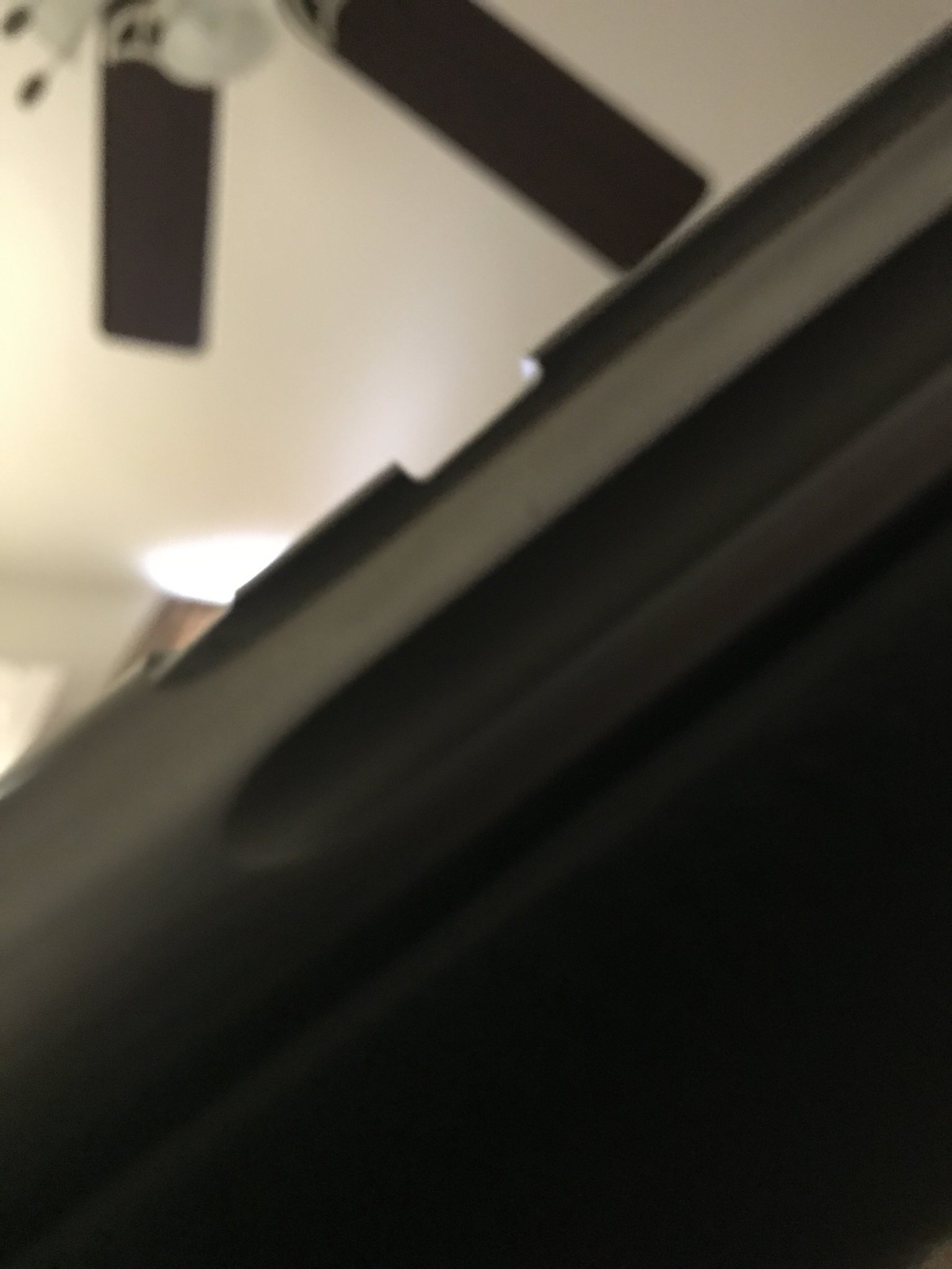

Just picked up a fluted 7 stw today and some jackass ground into the top side of the barrel about an 1/8 inch for some reason I'll never know!!!! Maybe a level of some sort? Anyways, is there a way to "repair" or hide this? Was thinking turning the barrel down maybe? It's about an m24 contour. Any help at all appreciated!

If there are no text/markings on the barrel, you could set it back half a thread pitch so the grind marks are facing down.
Personally, I'd just leave it as is since it won't be very noticeable with a scope over it.

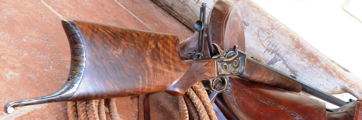

Yes, it's definitely ALOT of blending, grinding and polishing. It's not something I would pay someone else to do, but would do myself. Very labor intensive. It would be a cosmetic weld, and I don't think it would hurt the barrel, especially safety wise. I've welded up receivers with no problem. I welded the receiver on this Remington Rolling Block Scheutzen that I built. This gun started as nothing but a rusted receiver found in a barn.
Reactions: 300sniper
Buddy, no shit, that thing is one absolutely BEAUTIFUL rifle. Kudos. You're an artist.
Did you buy the rifle or are you installing this barrel on a different receiver? Do you know where that spot is going to be when you get the barrel installed and correctly headspaced?
It is currently installed on a rifle I bought today.
Then I think you have two options. Both of them have already been suggested. You can leave it alone or you can have that rib milled so the notch looks neater. Maybe find a scope the right size to fit into the new neater notch.
I'm gonna see if a smith locally may turn t down a couple contours. It's a fat bitch!
Personally I would have dove tailed in a small sliver of steel and blended it in....would have been nearly seamless.
I’de be surprised of bedding compound stays in there for long
