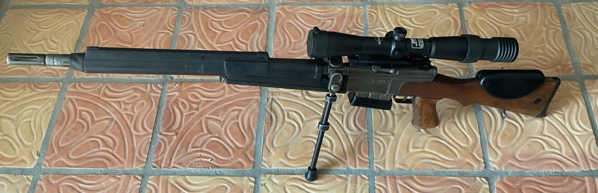

French FRF2 Sniper rifle

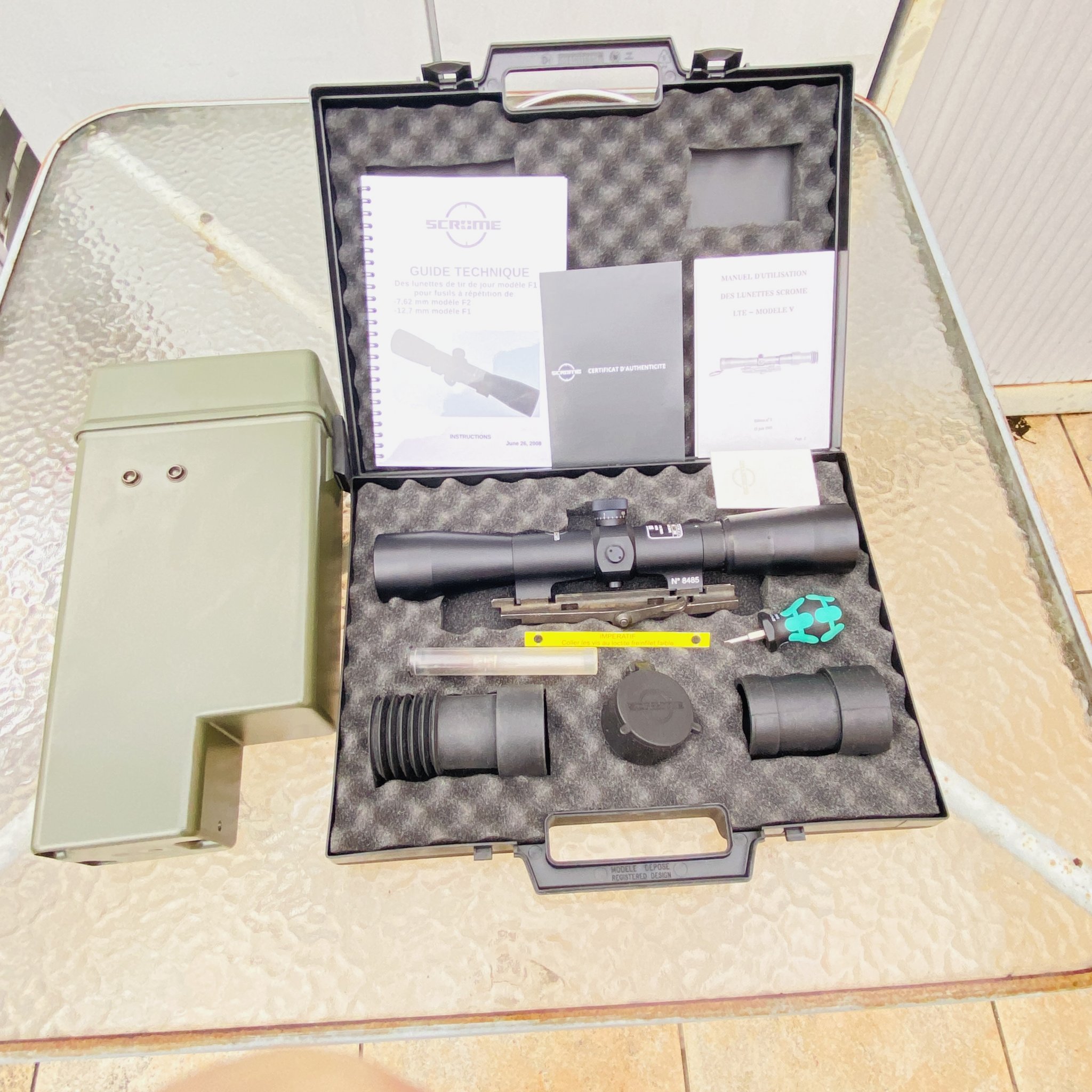

My scope received

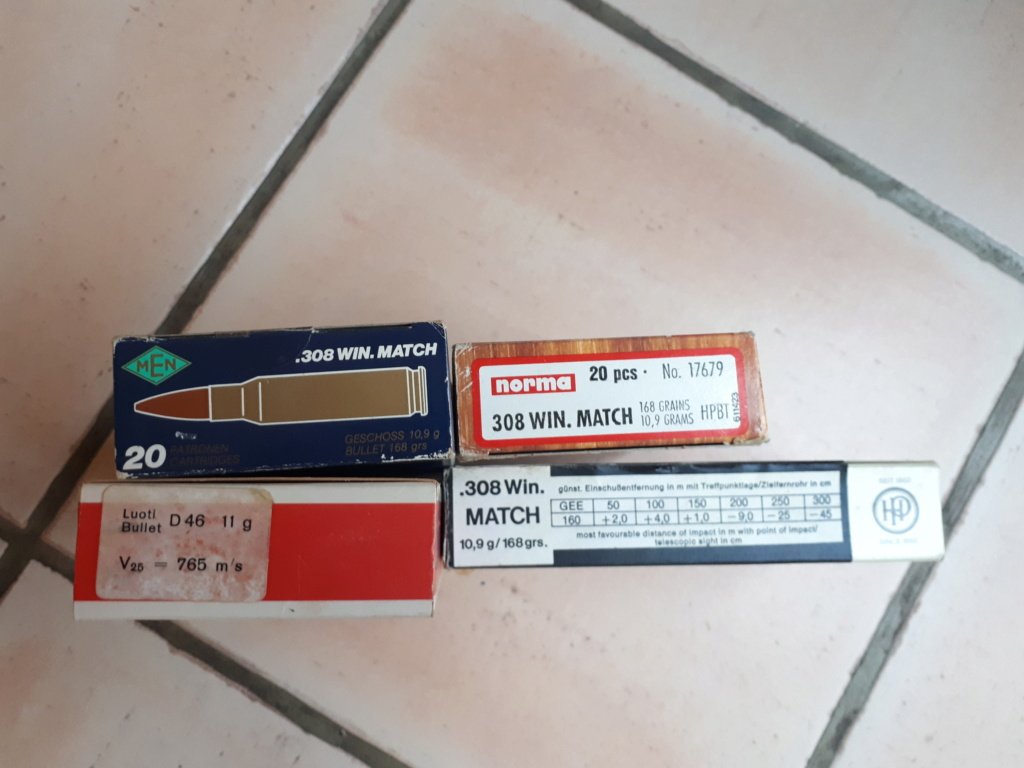

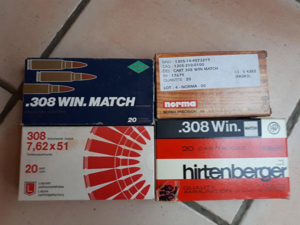

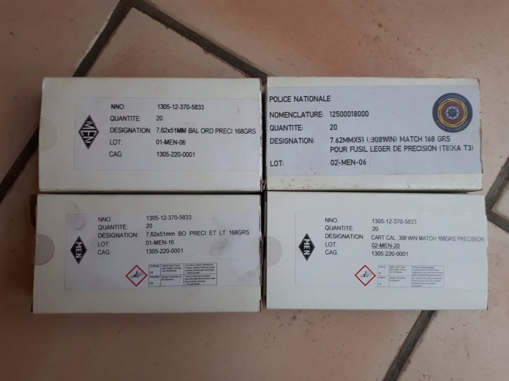

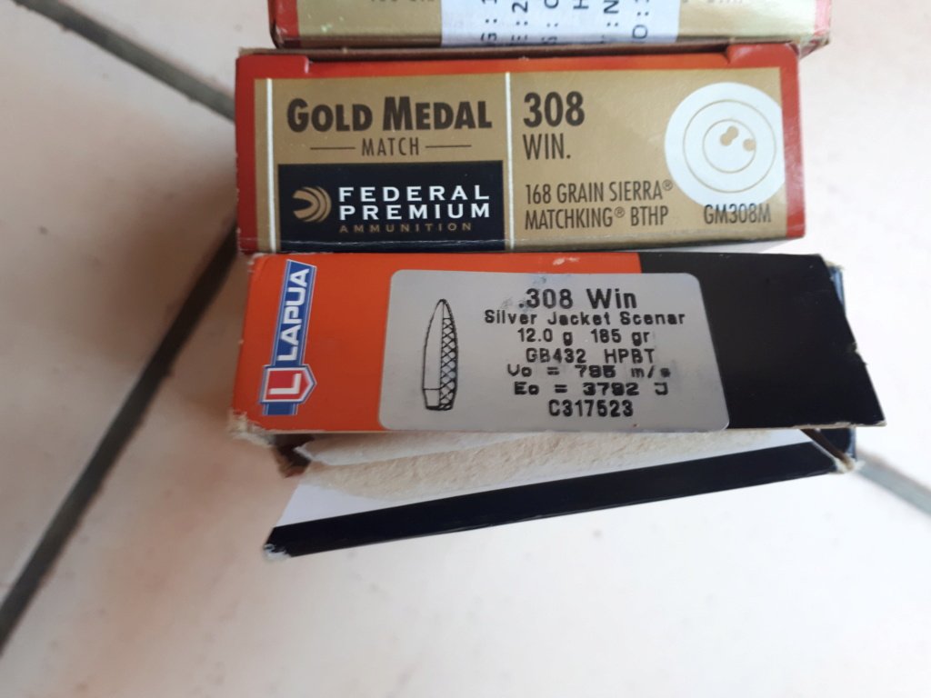

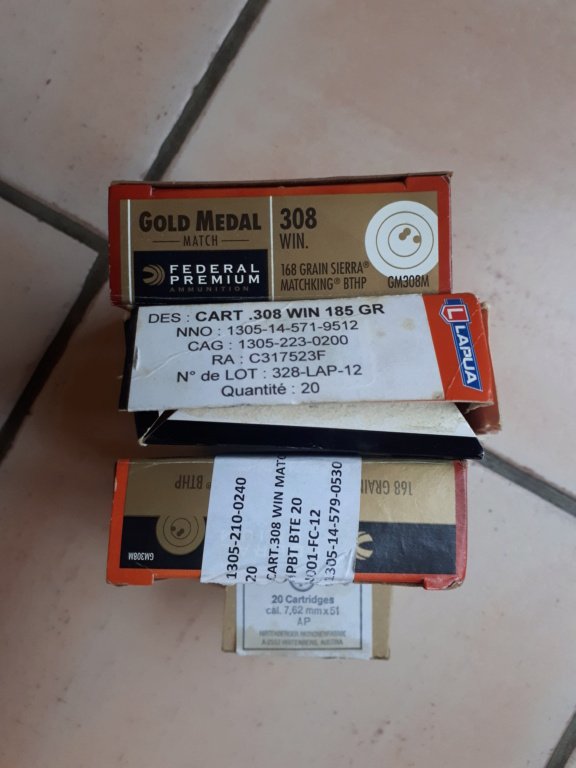

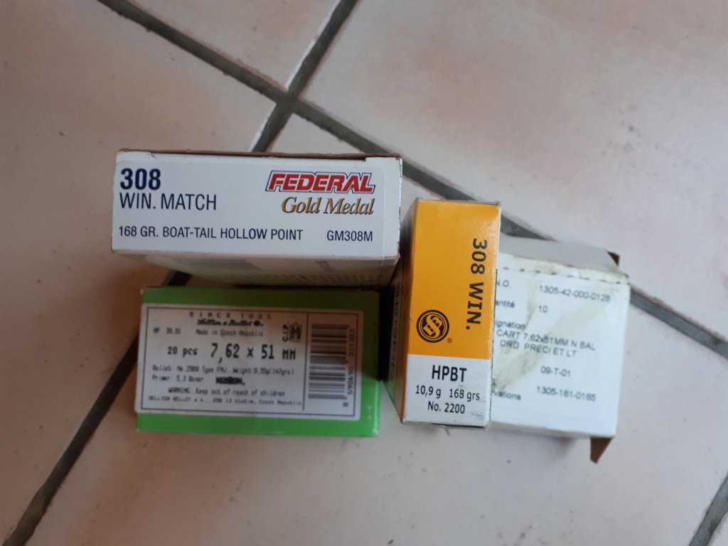

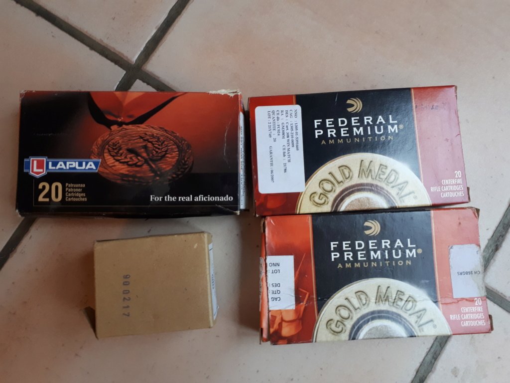

Please find attached the ammunition used by the French Air Force in the FRF2 rifles.
the most stable ammunition used in the frf2 cannon is the 185 grain lapua has more than 600 meters of good results better than the 168 grain sierra

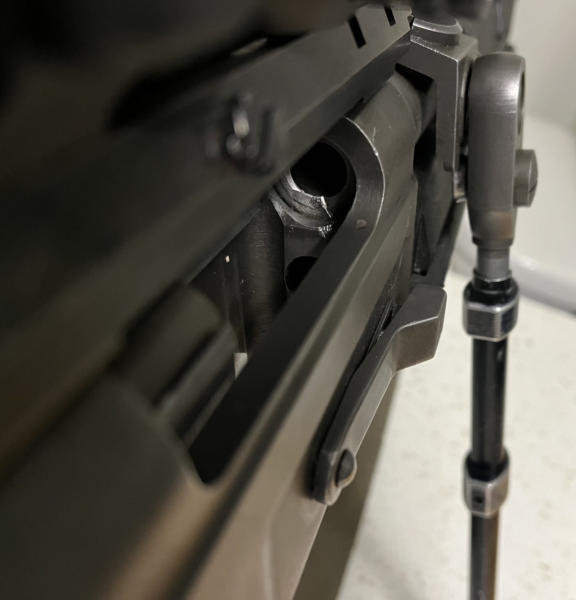

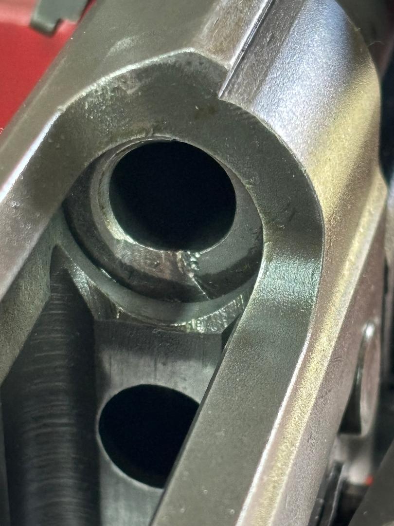

Has anyone else encountered an issue with the feed ramp of their rifle? I bought mine secondhand, started putting a few rounds through it and noticed that rounds feeding from the right side of the magazine sometimes get caught up, and it looks like over time have gouged out tracks in the bore and entrance to the chamber. Any recommendations on what to do? Seriously bummed out that this happened to such a rare rifle.

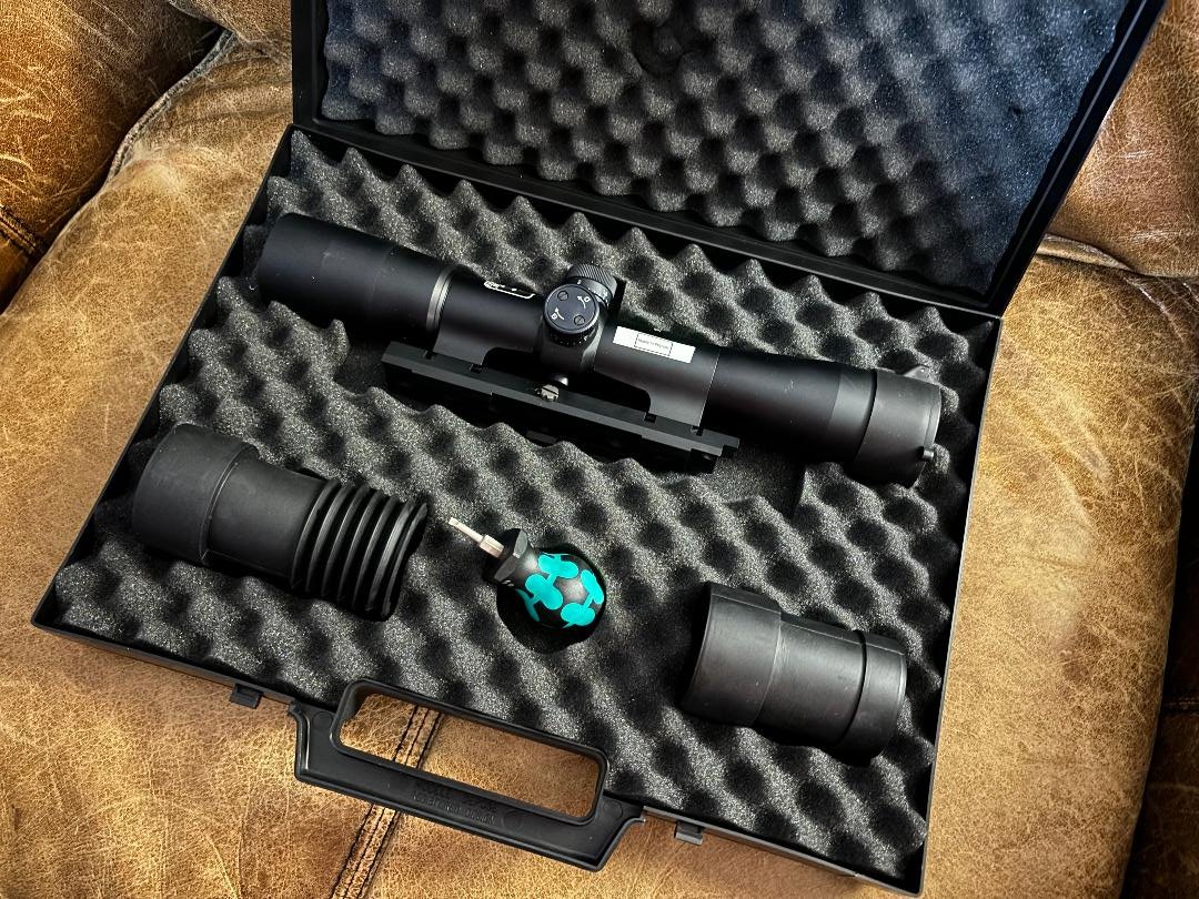

have you received your scrome scope J8 ordered
Yes, I received it about a week ago. A user manual wasn't included. Attempts to get one from Navy Arms was fruitless other than sales lady called me back to tell me that their "armorer" told her that I could download one at "scrome.com." This is not the case. A very thumbnail four-page fact sheet can be obtained but not the user manual.
I notice that the new ones supposedly cranked out in small batches (starting in '22, I read) by Scrome did/do include a user manual. (The Navy Arms package did NOT include one.) Me, not being Mr. Telescopic, needed the manual. E-mail to Scrome/Elynxo has not yielded a response. Posts to various YouTube sites also negative.
Any advice on this deceptively tricky goal (acquiring a user manual) would be appreciated.

So, it looks like the Navy Arms' trusty "armorer" missed this item in his inspection or have you learned anything more about this concern?
Apparently a good number of the FRF2s he's seen have the same kind of damage (can you guys confirm/deny)? He says it's caused by loading the rifle with some of the rounds in the magazine too far forward. The magazine is decently oversized so there's definitely room to load the rounds into the mag without pushing them all the way to the rear. I tested this theory by loading a mag with all the rounds flush in the back and cycling the rifle -- no feeding hangups so I guess that was the culprit.
The armorer recommended taking a jeweler's file to level out the track marks but I don't think I want to do any amateur smithing on an $8k rifle. Knowing how to avoid inducing the issue is good enough for now.

Mine has similar damage. No problems feeding, though.
