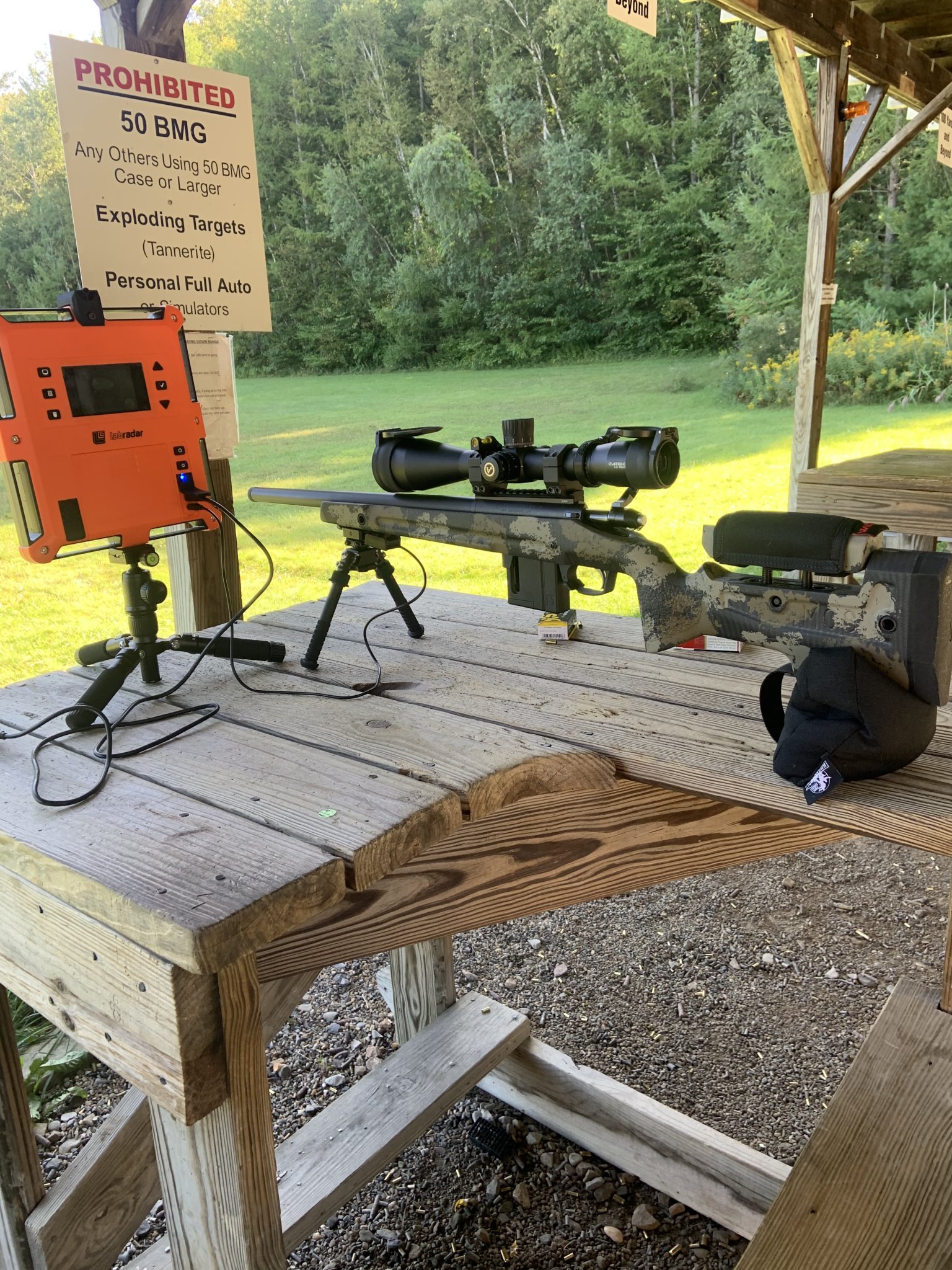

    The problem is, I don't want to use the vblock. I have a tuner on my rifle and I don't want to hang anything on the barrel.
    I have one (the FX unit) and it works great with my .22lr rimfire. The only problem I have is they no longer include the tripod adapter. If anyone has one they aren't using I will buy it.
    I just bought one new earlier this week (Ordered on-line July 2nd). It came with the new barrel V-block installed but also had the tripod adapter in the box. Just took 4 screws out and swap them only took a minute to do.
