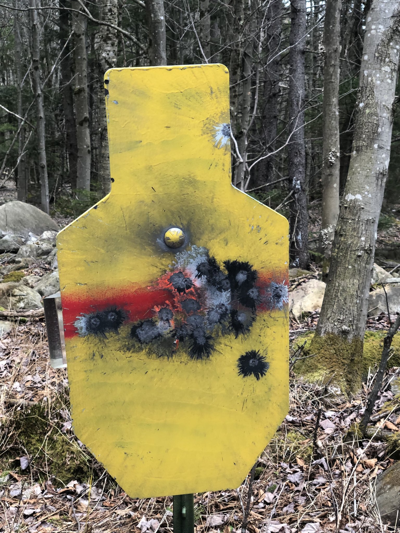

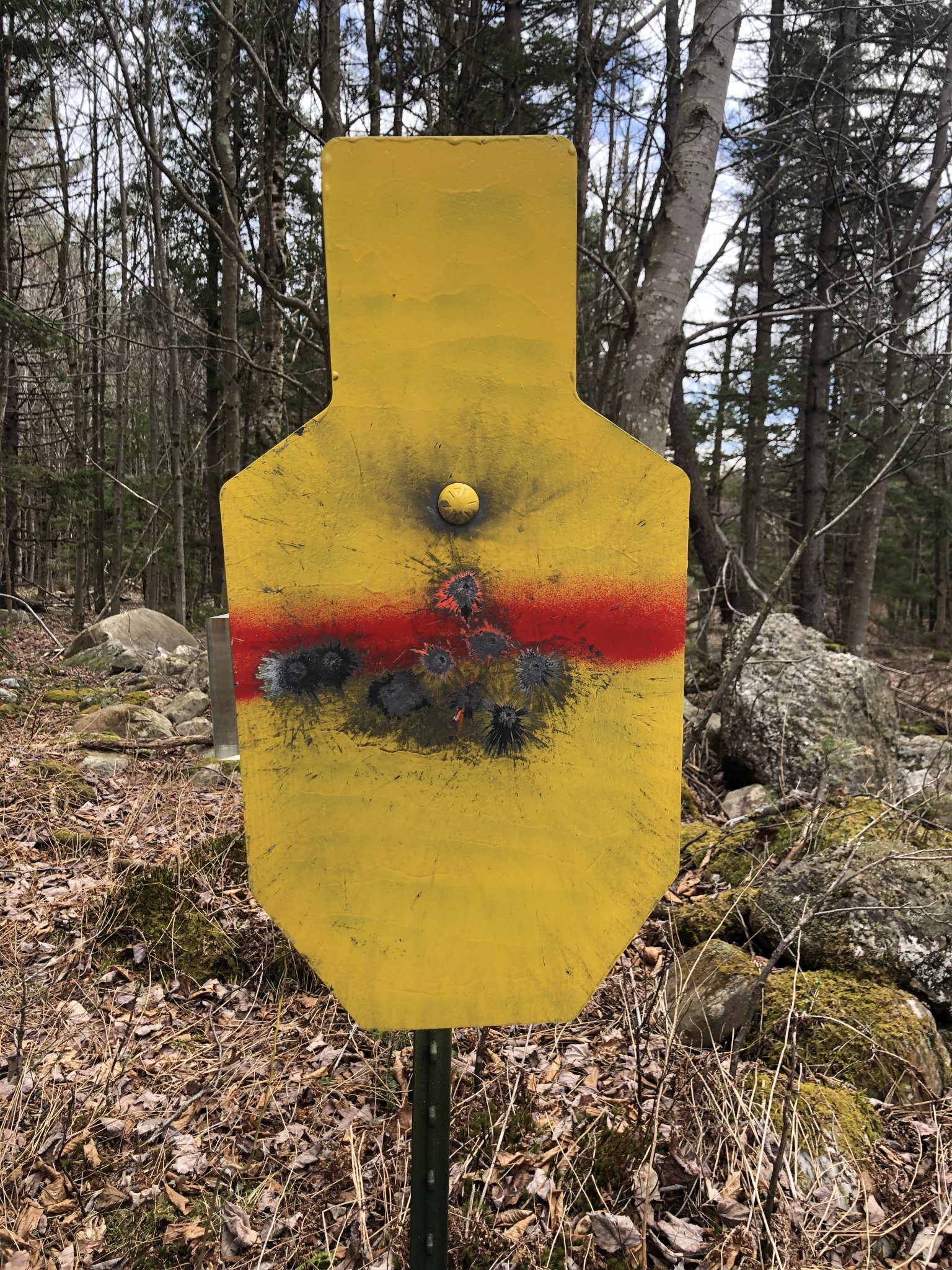

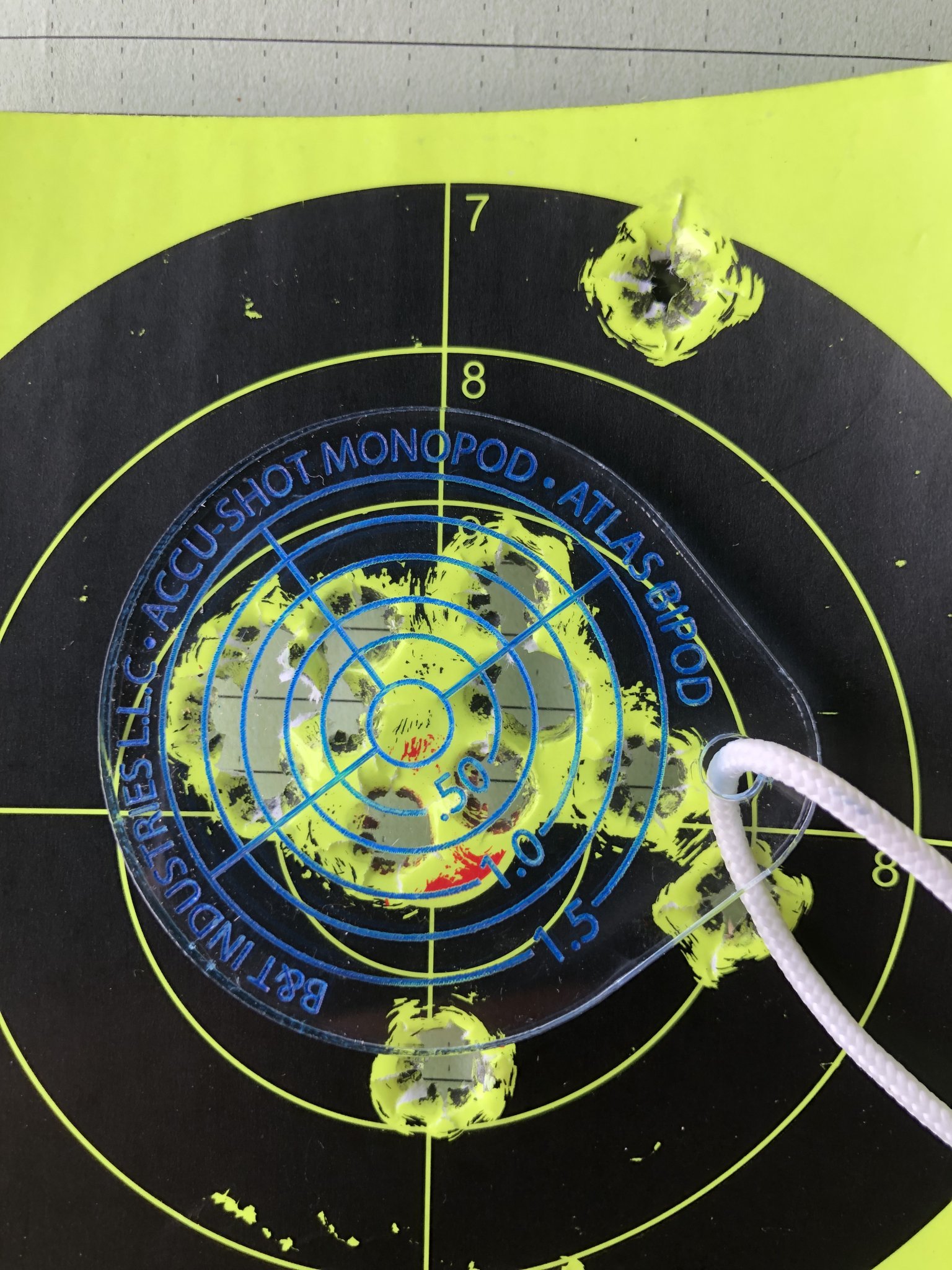

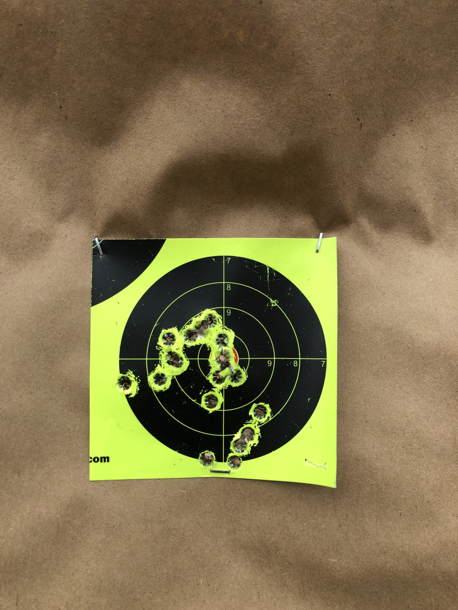

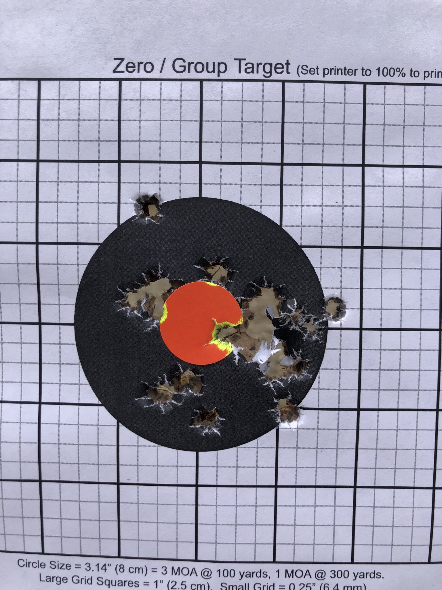

It’s got less than 300 rounds on it and its looking like it may surpass my “go to” rifle.
The previous “Go to” at 300 yards with 175 FGMM…1:11.25 Krieger SS
4 inch target. Twenty rds 175 FGMM.
The new gain twist….some redonculous gain twist I came up with because I have no clue and figured I could pull some number out of my ass and claim myself a ballistic genius.
Deets are probably in here in an earlier post.
I did follow the Lowlight directive not to exceed .75 in GT. Originally I was thinking I could go from like 1:11.25 to something near a 1:9 and the bullet would act like a car moving through transmission from neutral to 6th gear.
I don’t think it works that way and I’d be shmeering jacket the length of the bore had I done do.
At 300 yards….
4” Circle….20 rds FGMM
3” Circle…..20 rds FGMM

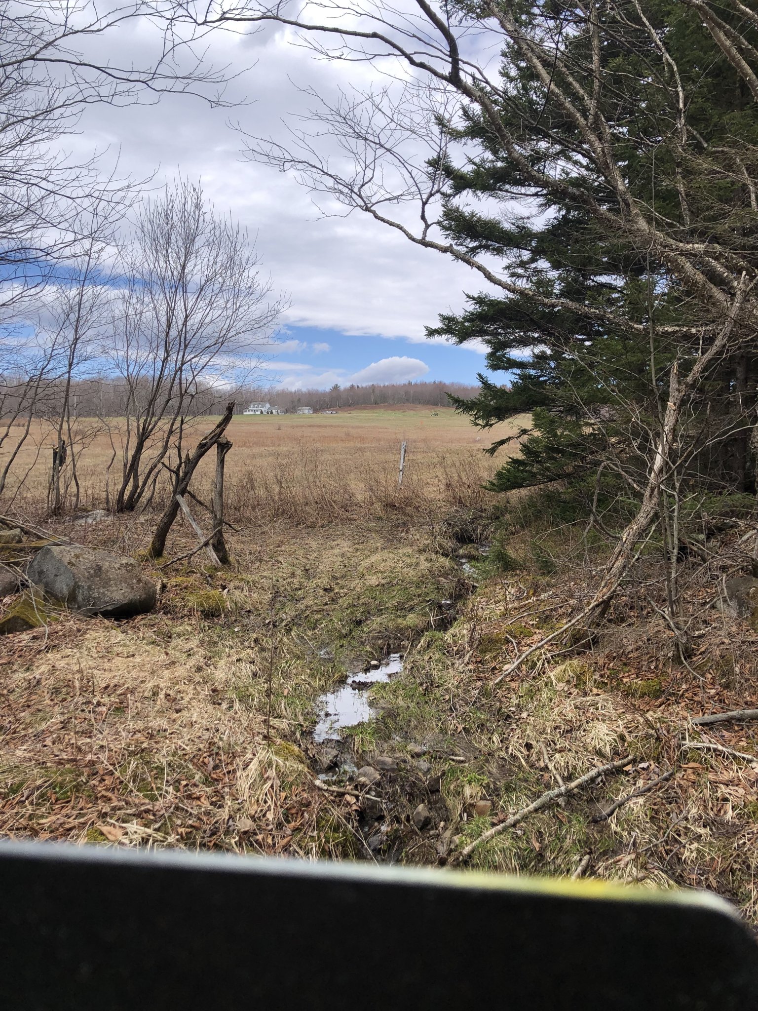

At 525 yards….175 FGMM 10 or so rds.

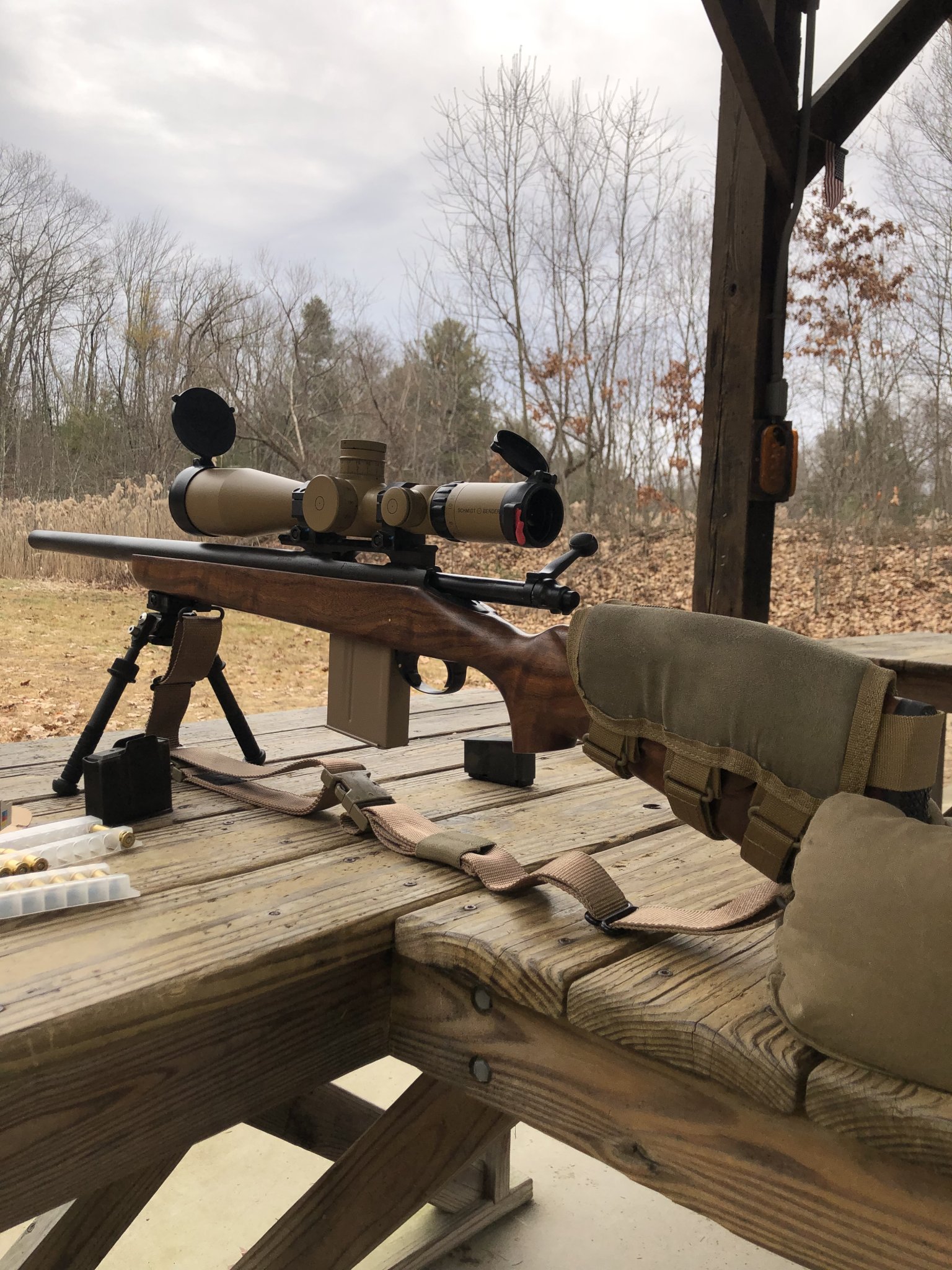

End of day I think I shot 30-40 rounds and was the only one that could hit the plate.

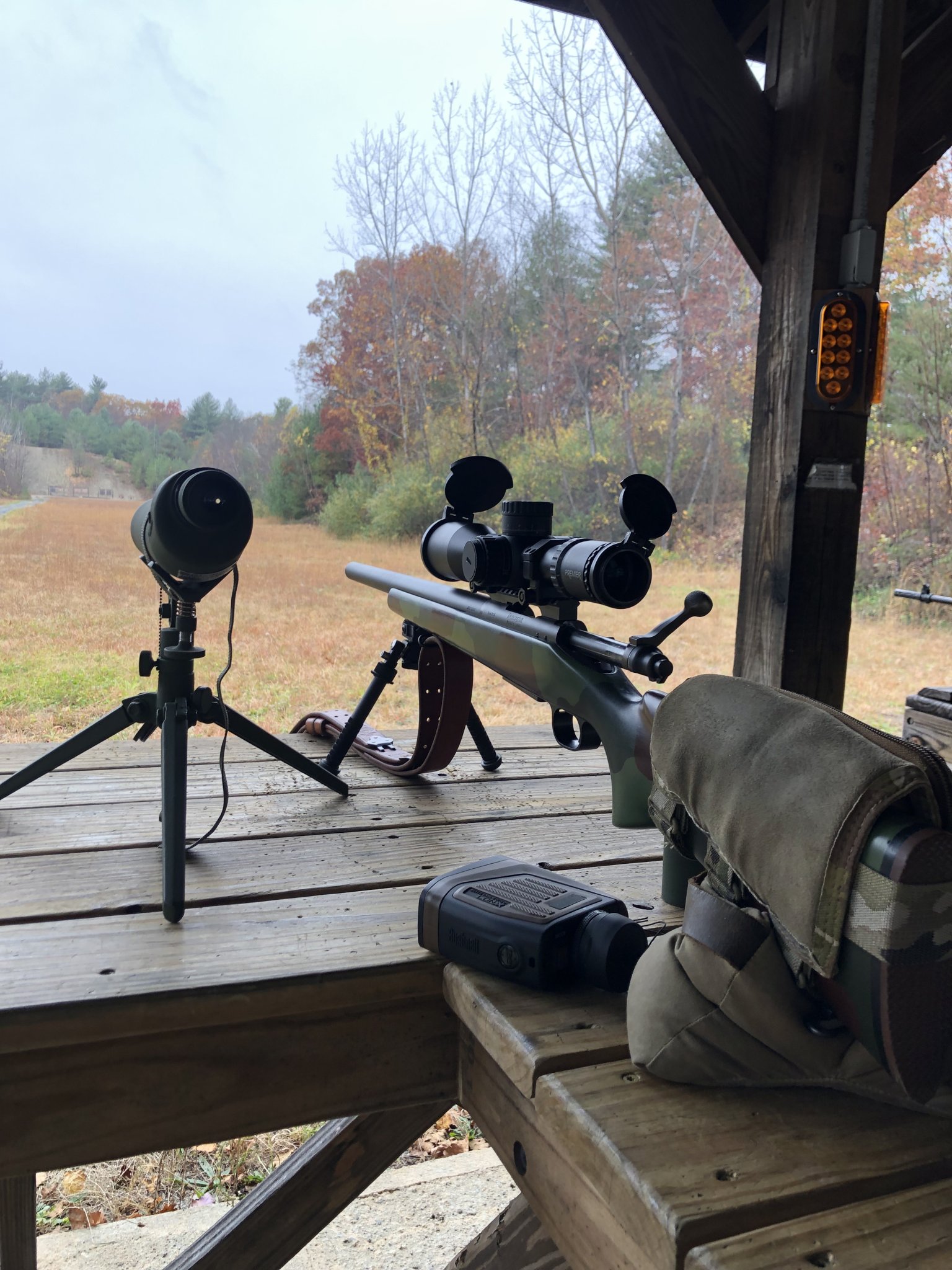

Looking back to the shooting position.
Shooting position toward target….
