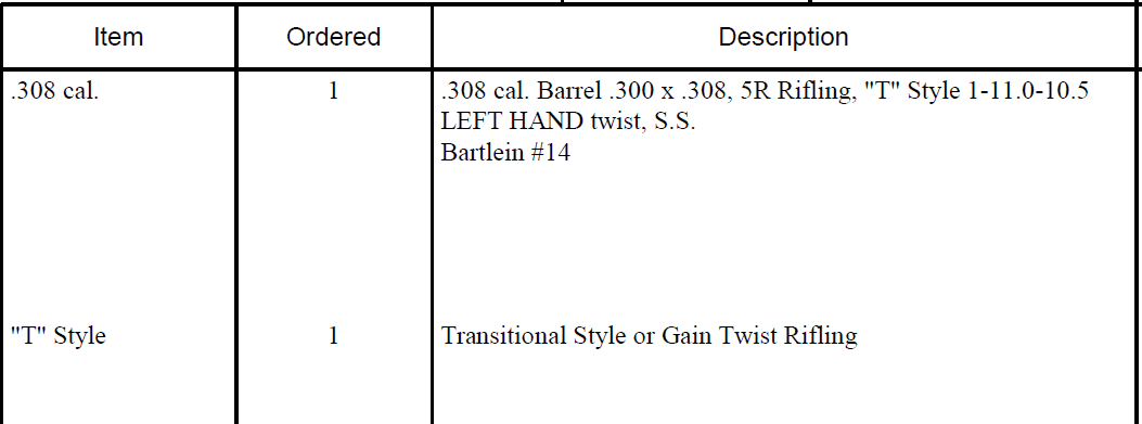

What would be a good GT for a .308? Going to order a LH GT bartlein tomorrow. Don't plan on shooting anything bigger than a 200gr at most, primarily will shoot the 175grs.
Hoping the collective answer is "Post 211"......
Responses that followed said that is fast for those projectiles. I was thinking like a 10.5 to 10.
Call Bartlein and they will steer you in the right direction. I would be thinking maybe 9.75-10.5 if you're going to be shooting up to 200 grs and moving on the slower side.
I have to call to order so I planned on asking for their recommendations.

Placed my order and went with what they recommended.

That's more conservative for a short-barrel .308 for 200 gr projectiles than I would have wanted, but they know more than me.
I said heaviest would be 185gr, maybe 200 but probably not. Haven't decided on a finish length yet either.

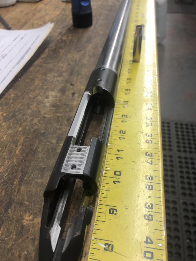

My Bartlein LHGT is barreled as of LRI Tracker received today.......
They test fired it.
I should ask if the bullet went where expected.....

I plan on rebarreling my .22-250 next year with a LHGT carbon fiber wrapped barrel from Bartlein. I need to call them to figure out what gain twist they recommend for what I want to shoot. This is my varmint gun.
I have a 22 inch 11.5 to 11 twist bartlein 5r that shoots 208 eldm's with no issues.
Good to know. Being mindful of the military standard of 11.25 for a 175 Sierra, I guess there must be considerable difference between optimal vs acceptable twist rates.
What is your elevation? I'm restricted to damn near sea level so I always need to be cautious about it.
