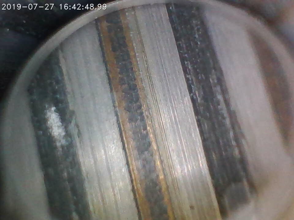

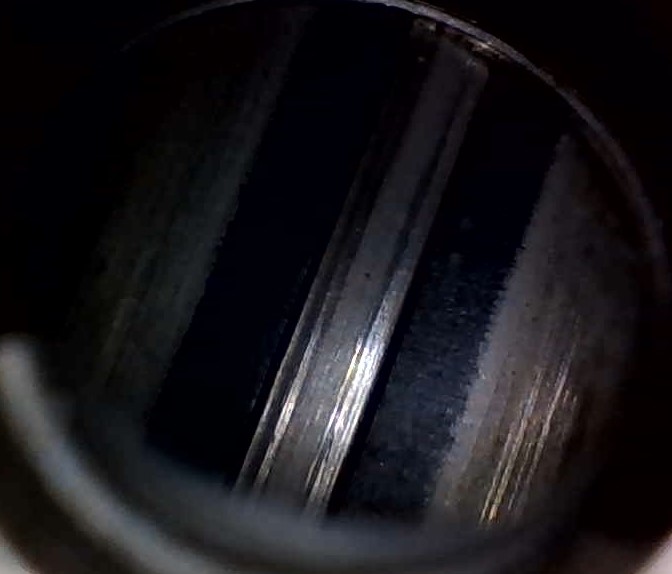

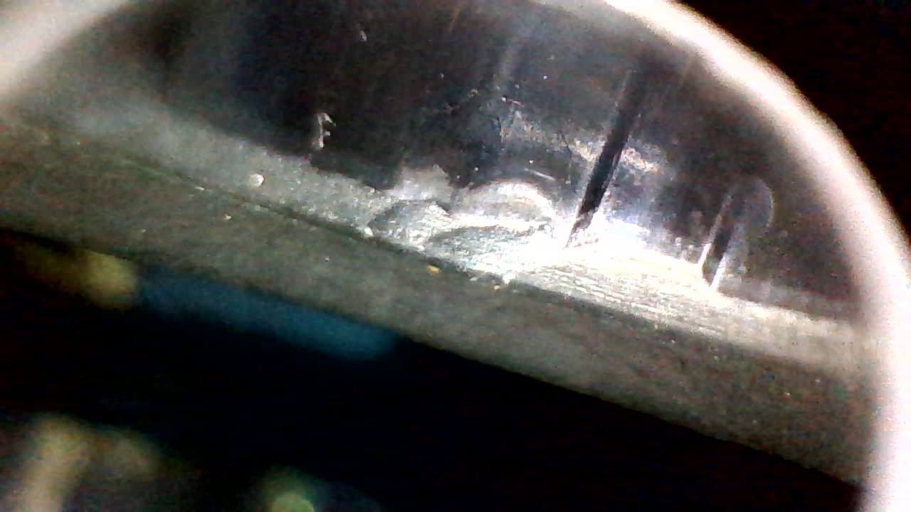

40 S&W M&P with about 5k rounds through it. This is just as the rifling starts. There are three 'claw' marks on EVERY groove...not just one. The horizontal chattering from the tooling goes in 2" or so also. Funny thing is...I shoot mostly cast lead that is powder coated red (Harbor Freight)...and finish the day off with a few mags of JHPs to 'clean out the powder coat'. These pics after about 200 rounds from the range yesterday.
7119130
40 S&W M&P close to the muzzle. More copper.

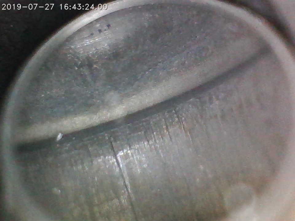

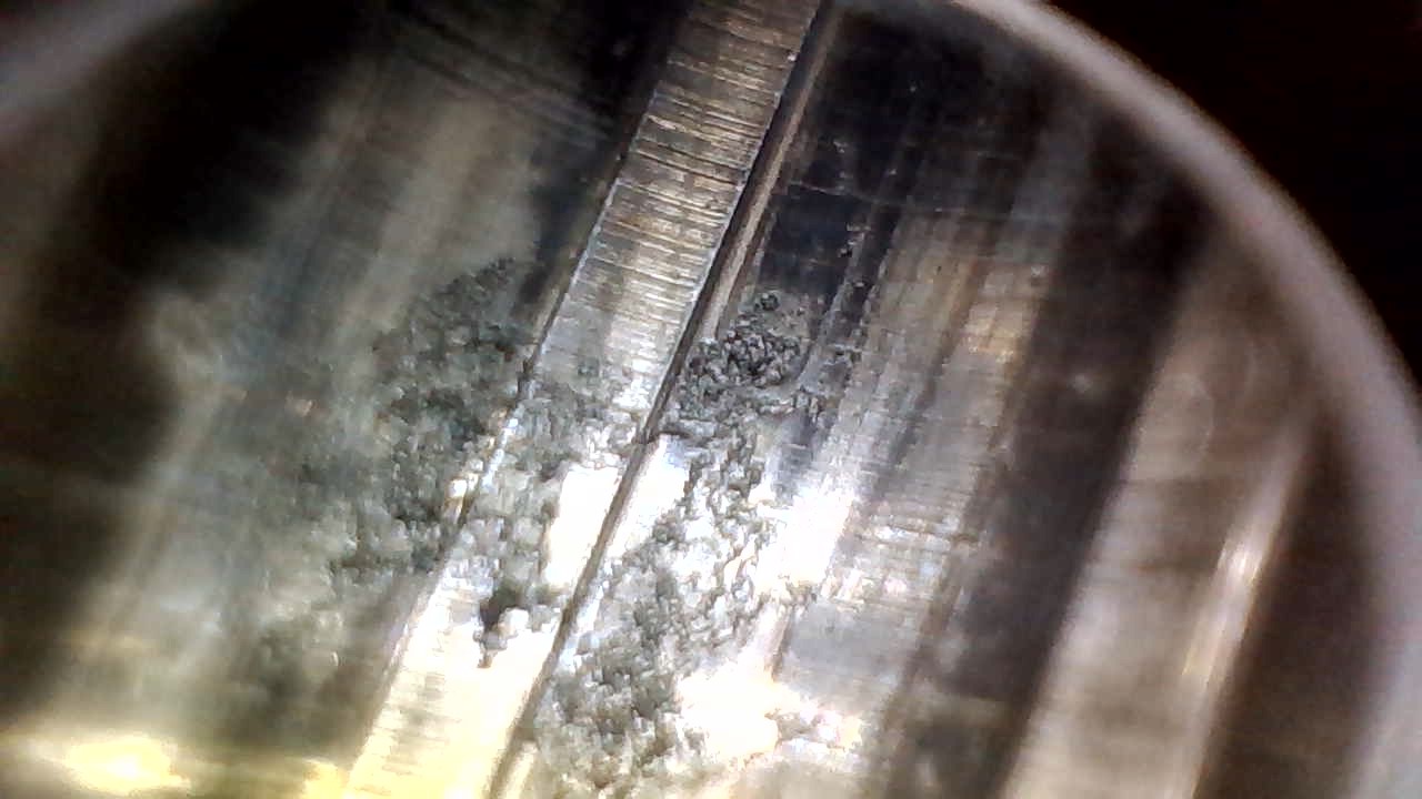

9mm S&W M&P shooting cast lead that is powder coated red. Shot a few mags of JHPs at the end to clear out barrel...or so I think. When loading these I felt I didn't bell the mouth enough and was scraping the powder coat off the base of the flat base 125gr truncated cones....I think this pic shows I have some leading....this after 200 rounds or so yesterday.

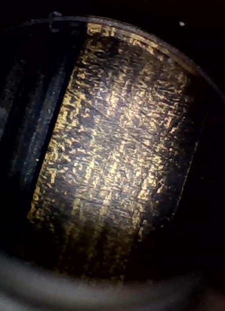

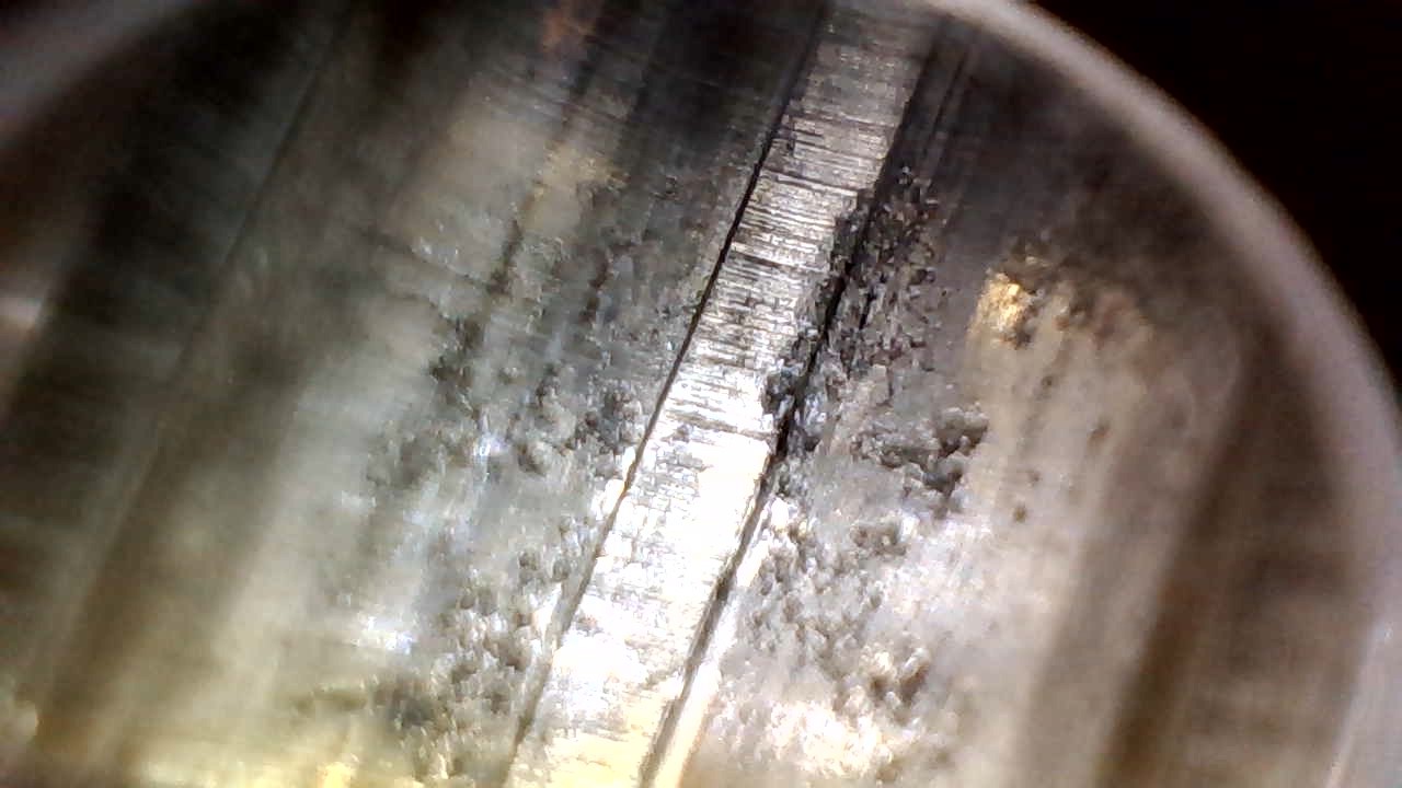

This is from a Remington 308 heavy varmit barrel that I shot in ELR 10 year ago and still love to shoot. It has about 3100 rounds through it and still shoots 1/4 MOA with modifications to a new stock and trigger. What do you think? Are the black bands still evidence of being stupid and shooting moly when that crazy was going strong? 168gr amax moly at 1000yds at Thunder Valley Precision back in the day was the en fuego cheetah scat. Luckily I stop that silliness before it did some permanent damage. This rifle still amazes me....off the shelf retail gun and shoots better than most of my customs.

I know not to look to close into what a bore scope shows. But the 7mm-08 can't hold a group. Even checked bolts, and changed scopes. It's been a few years since I shot it so I don't remember what it does exactly.

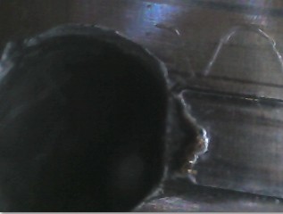

As for my 716 crown, it looks either likes dents, or tooling marks, they are so tiny it's hard to tell.

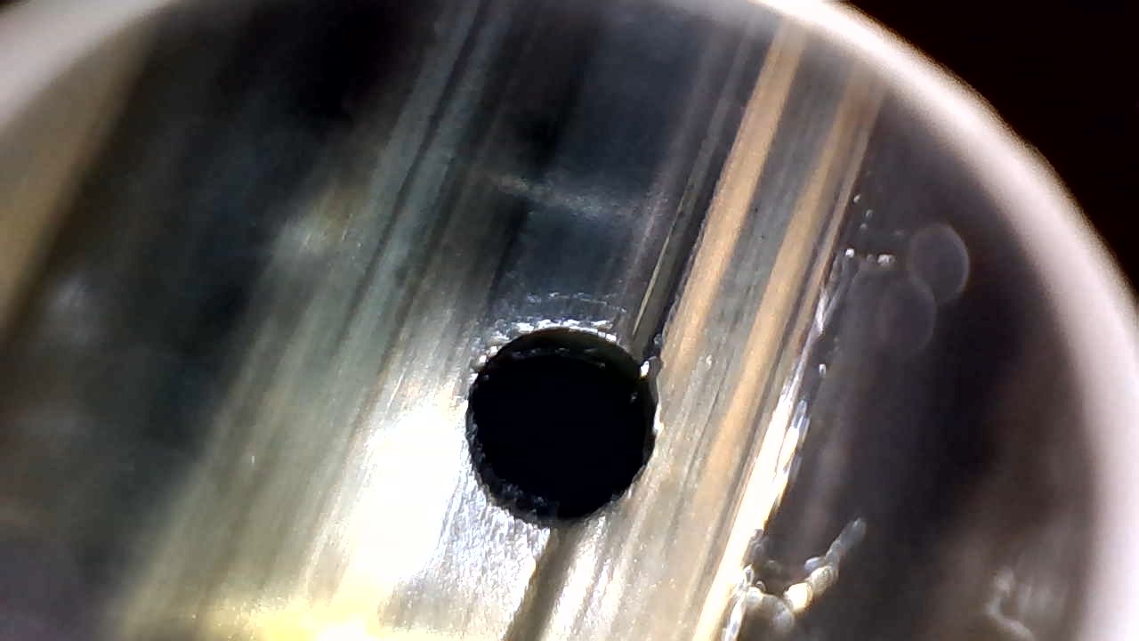

So. 556 Proof 16” barrel. Minor erosion despite heavy use.
Interesting post gas hole copper fouling. Heaviest place right there.

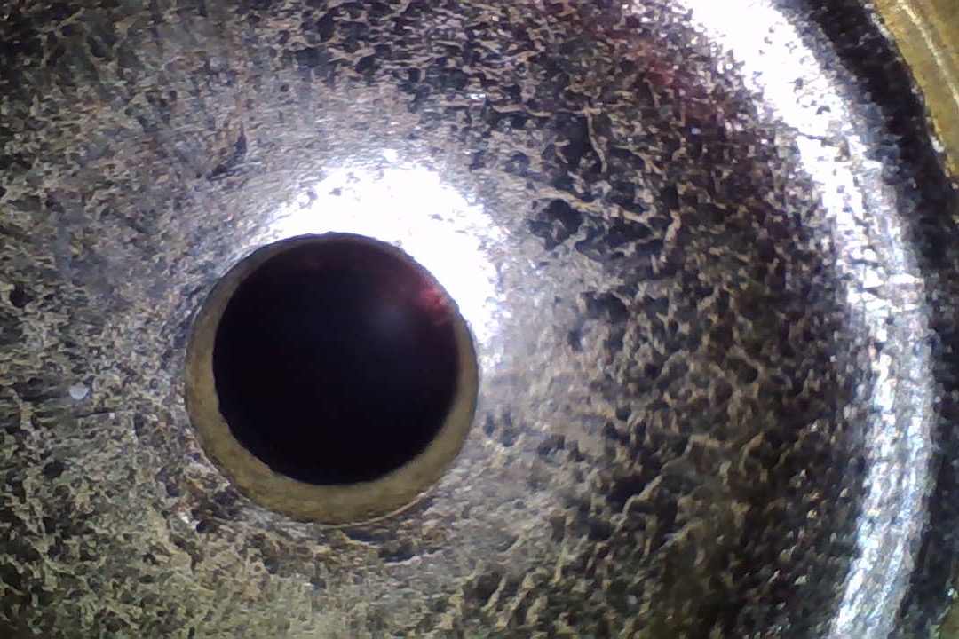

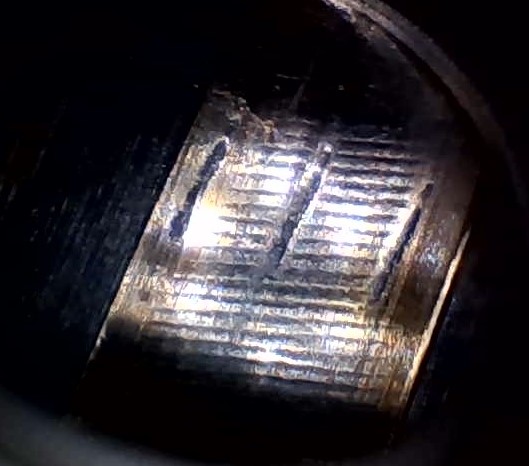

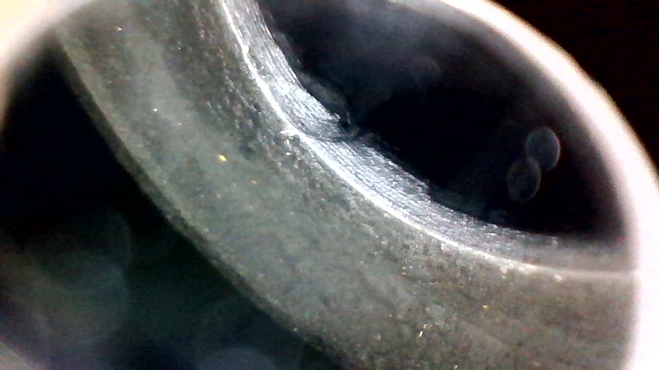

Sig 716 Chambered 308
About 500 rounds maybe?
Crown! Thinking this is why I have an 1.5" gun and not 1"

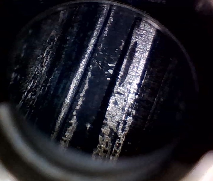

Pictures of the moon, I mean a 7mm-08 that I neglected growing up as a kid.
View attachment 7119064View attachment 7119065View attachment 7119066
Have many more of those and stopped taking pictures after 15 of them. Needles to say it don't shoot very well. Going to rebarrel it now me thinks lol.
Don't feel too bad. I have 20 year old Savage 22-250 with a worse looking barrel, that shoots my hand-loads into a .5 MOA group. "If it ain't broke....." :)
