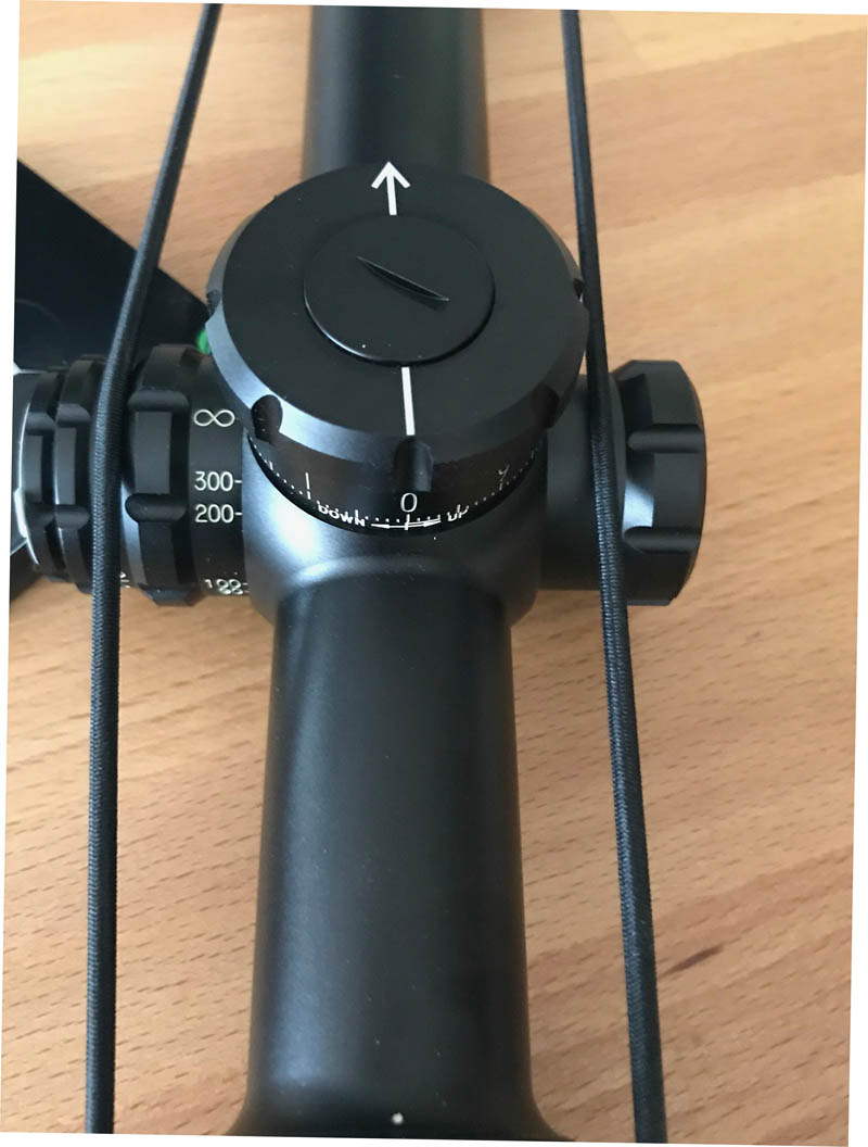

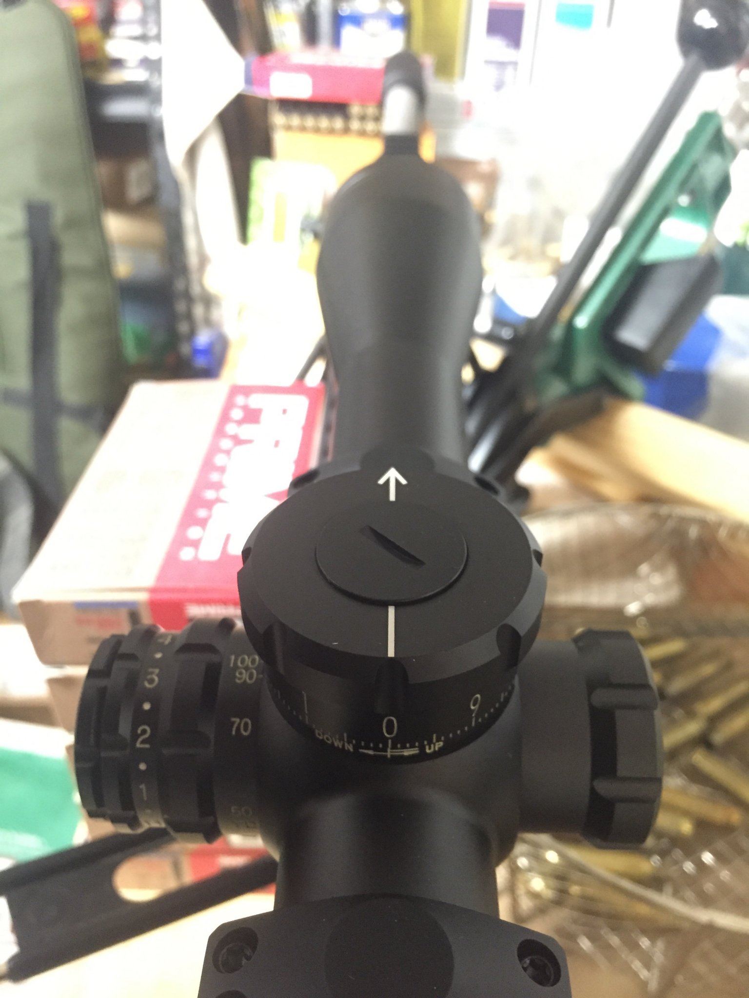

Yep, basically when you align the elevation knob on "0" the arrow does not point down the scope body. You can reset the dial, but the arrow will off again. When I said "1.5 clicks off" I just meant that if I dial 1 click toward making the arrow strait (in my case down), it's still not enough, and 2 clicks is too much. So in the attached picture you can see the arrow points to the left when at zero. If I dial 1 click down, and reset the knob, the arrow is off the same amount. As identified by an earlier post it seems the real issue is the "0" hash and rev markings on the scope body are not aligned to the center of the scope tube. The photo supports that, it certainly looks like the zero has and rev markings are rotated to the right with respect to the center of the scope tube.
If the arrow wasn't there I bet 99% of us would never notice this, but that arrow is a giant "Something is wrong here" flag. I see it as sort of a fluff feature but if you are going to put a giant arrow on a knob as a visual reference for zero, it should at least be "eyeball" strait when at zero.

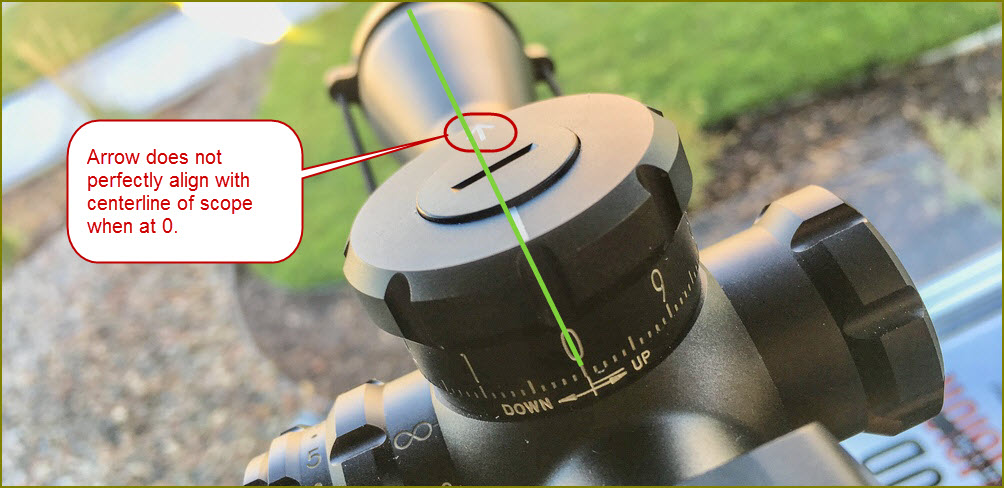

Thank you for clarifying amc, is this what you're talking about on yours?
The green line doesn't go straight through the flute in the turret. Is it perspective that makes it look like that? Or is the turret cover that far off from level? I had a 3-12 bent so bad the zero stop would not move on the brass shaft and the turret cover would rub part of the revolution. Bushnell sent me another from their "repair inventory" according to paper work.

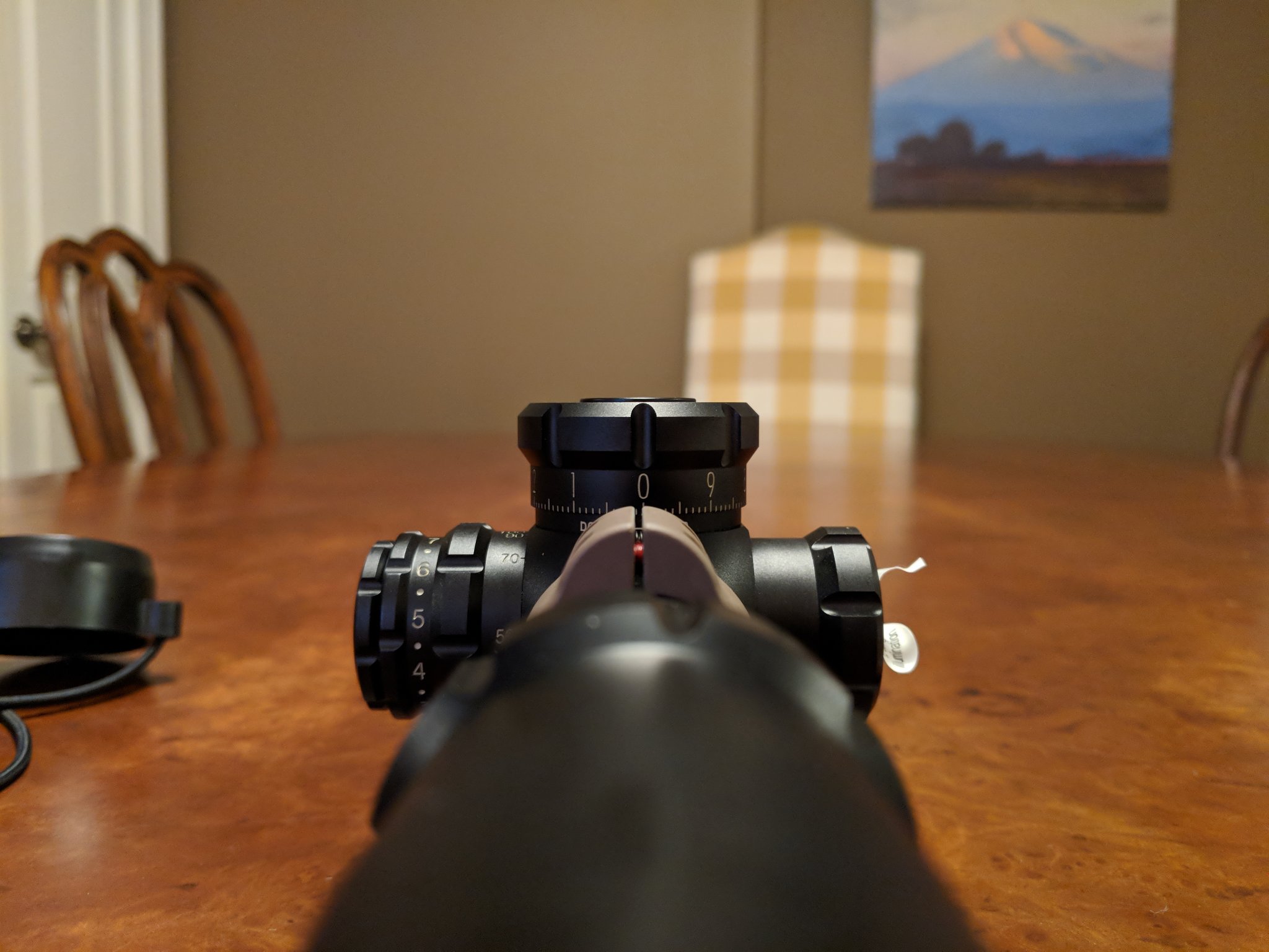

After closer look my arrow is one click off from being straight. So is the problem with the arrow on top cosmetic or is tracking on turret dial off? This is the only scope I have with arrow on top of turret, so for me I chalked it up to being only cosmetic. Please someone help clarify this for me because when I dial everything seems to track fine. Thank you.
The turret is fine. It will also track fine. The problem is the mark on the scope. It is not aligned correctly. I thought the zero marking was on the scope tube but Bushnell informed me that is actually the indexing drum and can be adjusted. My zero mark, when viewed from the rear, was too far to the right.

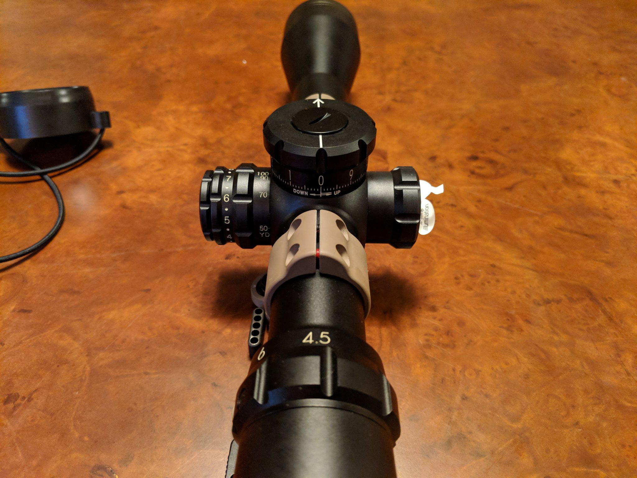

As I said above, my white arrow lines up fine with the scope tube, the 0 marking on the Turret tube and the little notches in the scope turret knob. For those wondering why that white arrow is there, without reading any literature I assume it was to provide a quick visual reference for a hunter in the field to make sure that the turret has not been spun from a hike through woods or any other reason, since it is a departure from the lift up locking turrets on tactical scopes and covered turrets on many hunting rifles. For my money, I think that I would do as the guy said above, and use a black marker to cover it if it annoys you.
