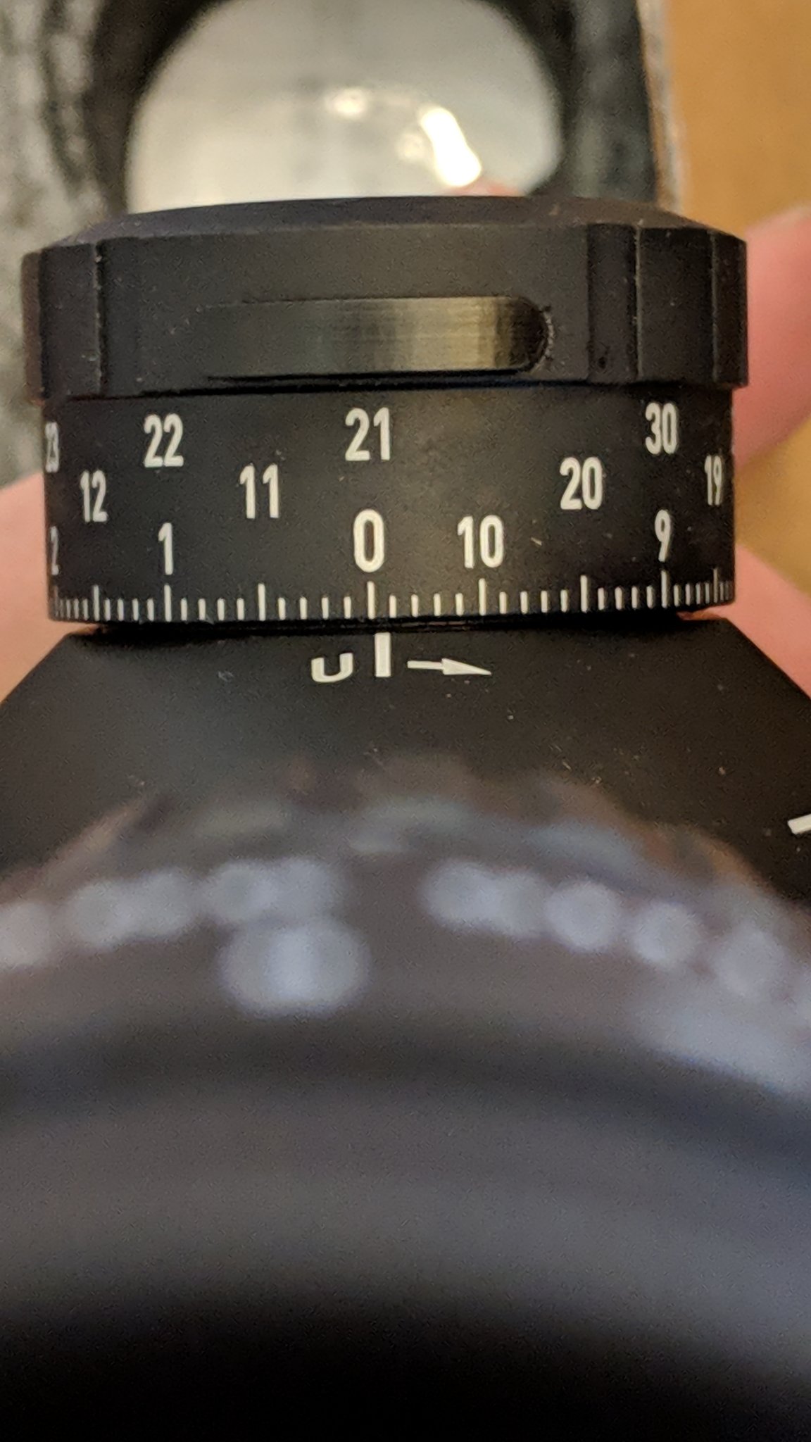

The picture of yours is interesting because the zero hash mark appears well centered on the tube. On the two bad ones I had the zero hash mark was very obviously shifted to the right of the center of the scope tube.

It’s not the arrow, it’s the turret markings / positions in the scope body being off. Krylon painting the cap doesn’t fix it.
It concerns me since it’s likely a QC issue at the LOW factory in Japan. I’m going to run it through a tall target and box test to see if there are other issues before making a decision on what to do next.
This scope has the Zero mark slightly to the left. My LRHSi had it to the left too, which is interesting if yours were both to the right.
Still love my DMR2i though.
Explain to me what you mean and how it actually affects the proper usage of the scope. I see that the zero marking lines up just fine with the hash marks. As such, exactly how does that affect anything?

DJ Keyhole, That pic you posted shows the zero mark lining up pretty close to perfectly to the turret. Maybe you posted the wrong pic?
What he's saying is, the component that says "up and down" is indexed slightly to left or right from center (off-tangent or top dead center from the main scope tube). The turret lines up correctly with respect to said part. The huge arrow just makes the clocking error more obvious.
I can't imagine any of this affects function.. purely cosmetic.
Wow so the two I have look like this but it’s so minimal I thought mine didn’t have it. ?
Seems awful nit picky but maybe I can turn one of them into an LRTSi now... mine is off even less than what’s pictured. Lol

JW, to me that is unacceptable and I'd send that back to Leupold, no matter how many times it takes, tell them not to send it back to you until the 0 lines up with the tick mark. If they can't get it to align I'd demand they send a new scope. With the money we pay for these optics I expect them to be spot on in every way, if the manufacturer won't fix it then I'd tell the community which will ultimately come back to the mfr. That being said, I do have some grace for the mfr and realize sometimes these things will slip through QA/QC; however, they ought to have the attitude that they will fix it if the customer is not happy.

I'm with Bill. To me, this is unacceptable. Is that at 0, 10.4, or 10.5? Actual misalignment between the marking line and turret markings is a no-go.
However, when both line up perfectly but they're both offset just a hair as many here are showing on their LRHS, I'd be fine with that. I can definitively tell when I'm on the right spot on my turret, even if things are rotated a bit. As long as I know where I am for sure, I'm good.

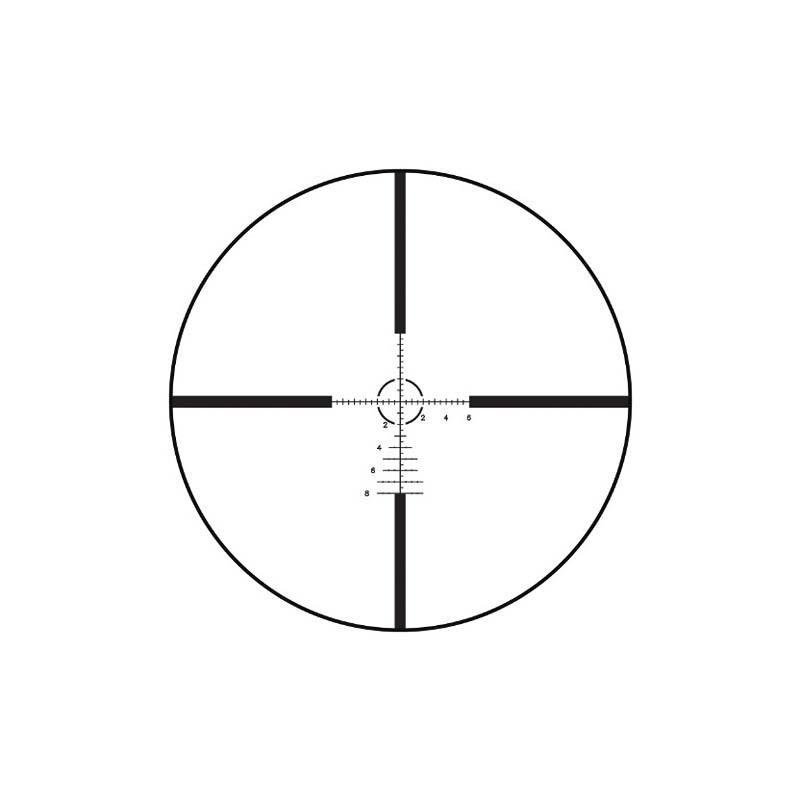

I do think that Bushnell should not lose the LRHS reticle, or “Circle of Death” as some have referred to it. It is a well thought out reticle for LR hunting applications IMO.
You like it even in the 4.5 bottom end scope? I like the G2H in the 3-12, but the G3 seemed plenty visible to me at 4.5. With more use I may find different, I have literally only mounted the LRTS so far. It came in with an Athlon midas 2.5-15, Sig Tango 6, and a couple of Burris 5-25s and i have been pre occupied in load development for my hunting rifle.
Yes, very much so. At 4.5, the circle is still quite noticible, even in low light. The reticle is almost a G2 reticle with the 4 mil circle added. Plus, the major stadia are there just like any other hunting reticle to guide the eye at low power.
Edited to correct 4 MOA to 4 mil.
I can't say the circle ever bothered me in my 4.5-18s. Its always nice to have options.
