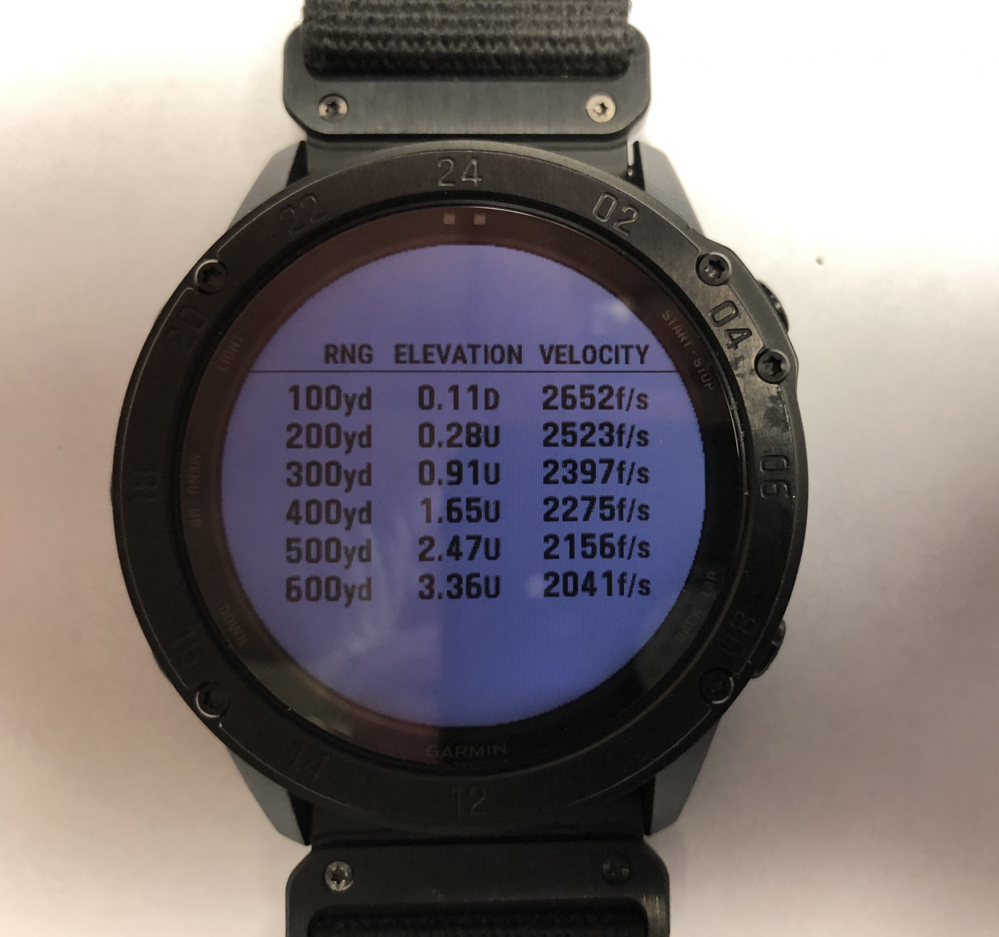

Why is my 100yrd showing 0.11D on elevation?
Just an initial set up, haven't had a great deal of time to play with this yet. Bought it, headed for the mountains, just GPS and Tracking on ATV trails, just getting warmed up to the AB side of things.

I set up a couple profiles on my Tactix Delta AB. For example:
6.5x47L
140gr Berger Hybrid, 2785fps, G7
Zero Range=100 Yards
Sight Height=2.15" Spuhr Mount on top of Surgeon 591
Zero Height=0"
Zero Offset=0"
SSF Elevation=1.0
SSF Windage=1.0
Twist Rate=8.00 in
What's your DOF?
It's prob ADJ causing the issue... just a hunch.
Reactions: reubenski
Ya, turn adj off and see if it goes back to zero. Unless you zero inside or somehow get an actual zero wind day when you zero, it’s factored in and having it turned on will either add extra or double it.

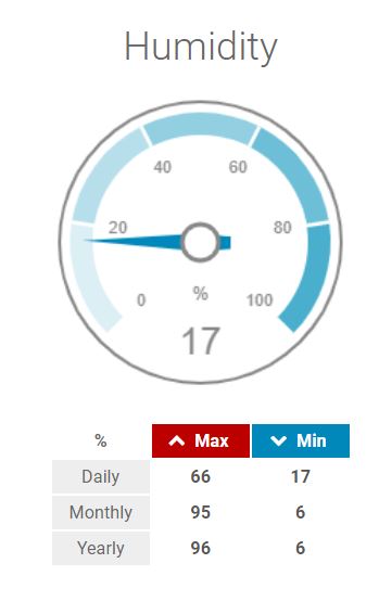

Humidity can be set to 50% on any solver out there and it will do fine. It’s the environmental factor that matters the least.
From 0% to 100% has about a 0.3% effect. So setting it to 50% means you realistically shouldn't ever be more than .1% ish off. Basically meaningless compared to other factors.
