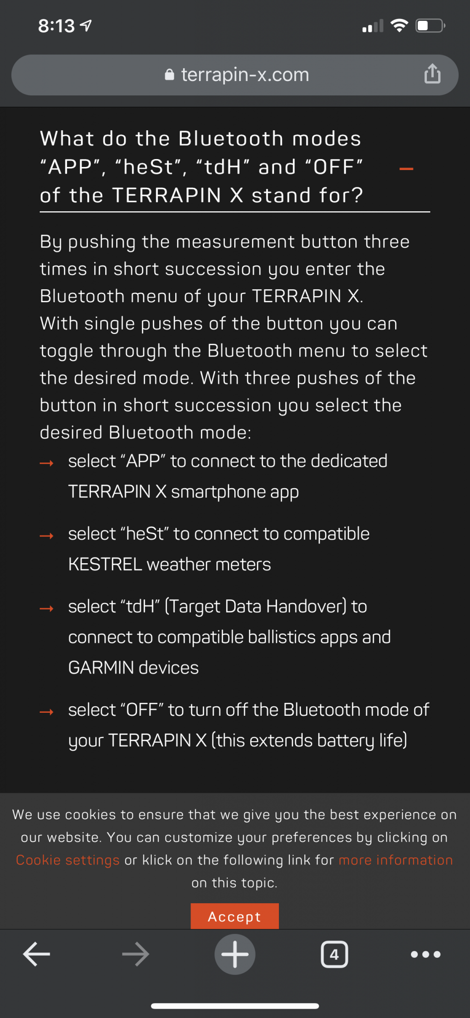

I am in the same boat but with a new Terrapin x and the watch.
Man is this ever frustrating! I have read everything garmin, this thread like 5x and updated - removed - reinstalled...I connect the TX thru sensors, go to AB and get maybe 1 lase maybe and then it drops off BT.

Which of the BT options are you using on the terrapin? When you press the button 3 times and goes to the BT menu, which one are you using?
When I go to “accessories and sensors” AB is not present, I have been using the “circular” function to start AB because I can’t seem to start it from “activities and apps” the only option I get is “remove from favorites” or “reorder”
I almost deleted AB from the Garmin connect app - but wasn’t sure if it would allow me to re-install AB to the watch...any advise is greatly appreciated!
When you press the start/enter (top right button on watch), it doesn’t bring up a list with AB as the first option?
It should and it also could be added or re-ordered which is only moving it up and down. I don’t think there’s an option to delete that I have come across.
Check out the attachment. tdH is correct for the Garmin. It’s not an option for the PLRF25c. Can’t even get it to connect :(
Sorry, not real specific, back to defaults, rebooted watch - went to app for the TX then back to garmin on TX BT; re-paired both and all is well.I m sure I missed something in the original setup - but honestly I tried so many things I cannot recall my misguided turns...
Reactions: SkyScrapin
I had similar experience. Once I downloaded software update for T-X and restarted everything, it’s working perfectly.

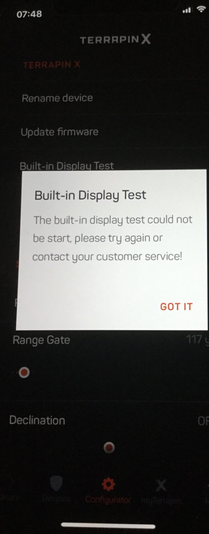

So, I located a massive bull Elk on a ridge, tried to range him with my TX/Garmin combo. The TX ranged him @ 1130 yards perfect broadside. Even though my TX showed a connection to the watch but the Garmin did not show the yardage or solution. I tried again and the BT was flashing on the TX. He moved a bit, so I tried my 2400 ABS but couldn’t be confident if I was ranging the bull or the ridge. I then restarted the watch and and took the TX off BT and then back to BT connection to the watch. The connection was then restored but the bull had disappeared into the timber. I could not relocate him...wanting to get closer I ran out of daylight.
Anyone using this combo, how do you setup before a couple hour hunt or match? Do you leave the watch on “clock” and the TX non BT?
Is their a sequence that is best to retain connection and operability?
Finally, the internal test for the TX has never worked on my device. Has anyone experienced that?
Any help would be greatly appreciated in the middle of this hunting season...thank you

Just shot a match Sunday. Left the T-X and Watch connected without turning the Bluetooth off on the T-X at all.
It would connect and work fine within a few seconds every time. Did this for 6hrs.
Reactions: DetroitRearView
Thanks for the match experience. I found that I was messing up by checking the time on the watch while the TX was still connected to AB.
If I leave the watch on AB and allow the TX to time out it stays connected as it ought. As per normal it was my own fault on incorrect sequencing.
