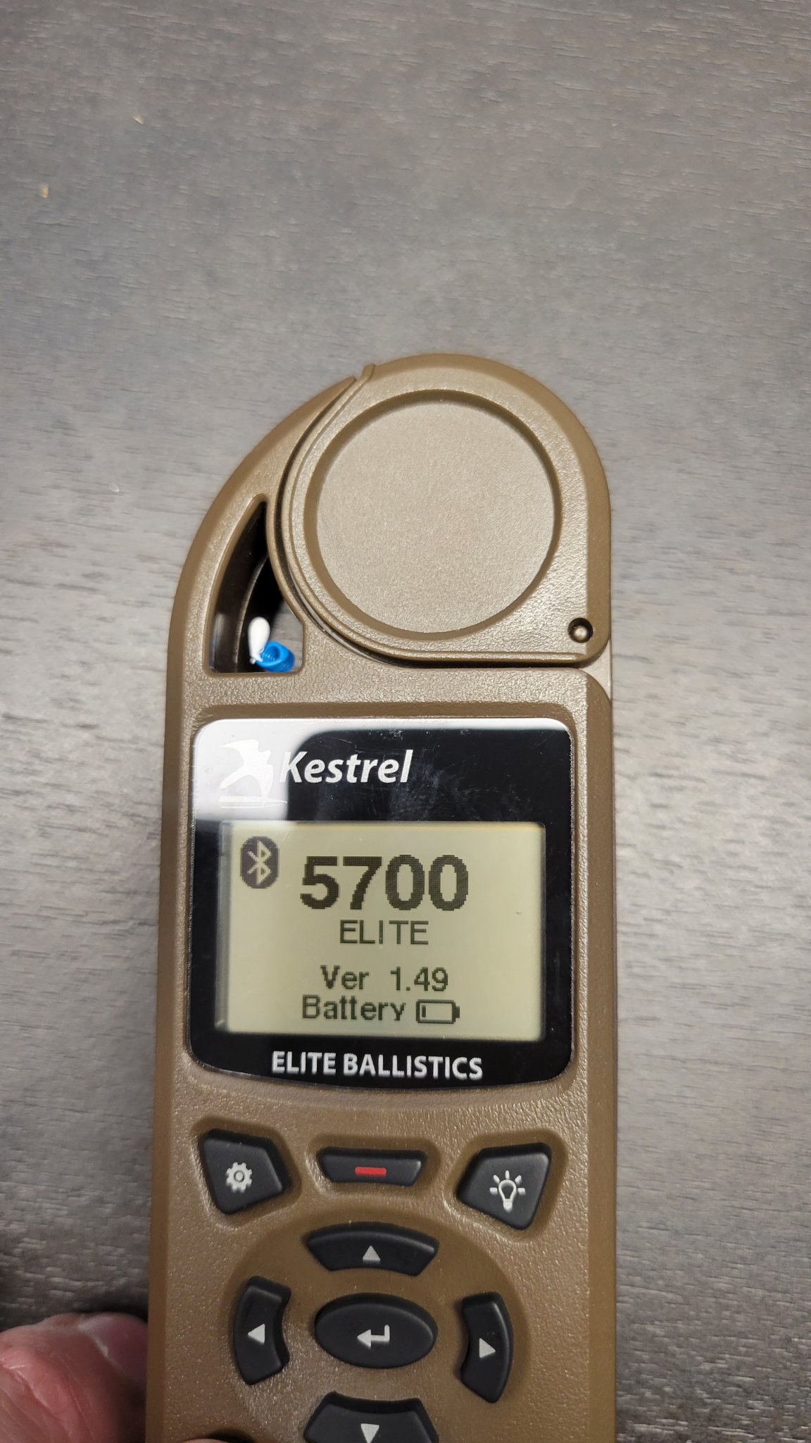

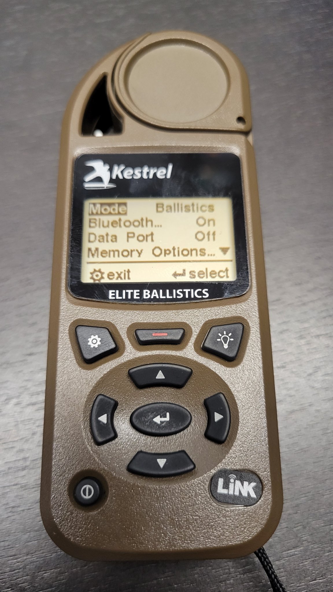

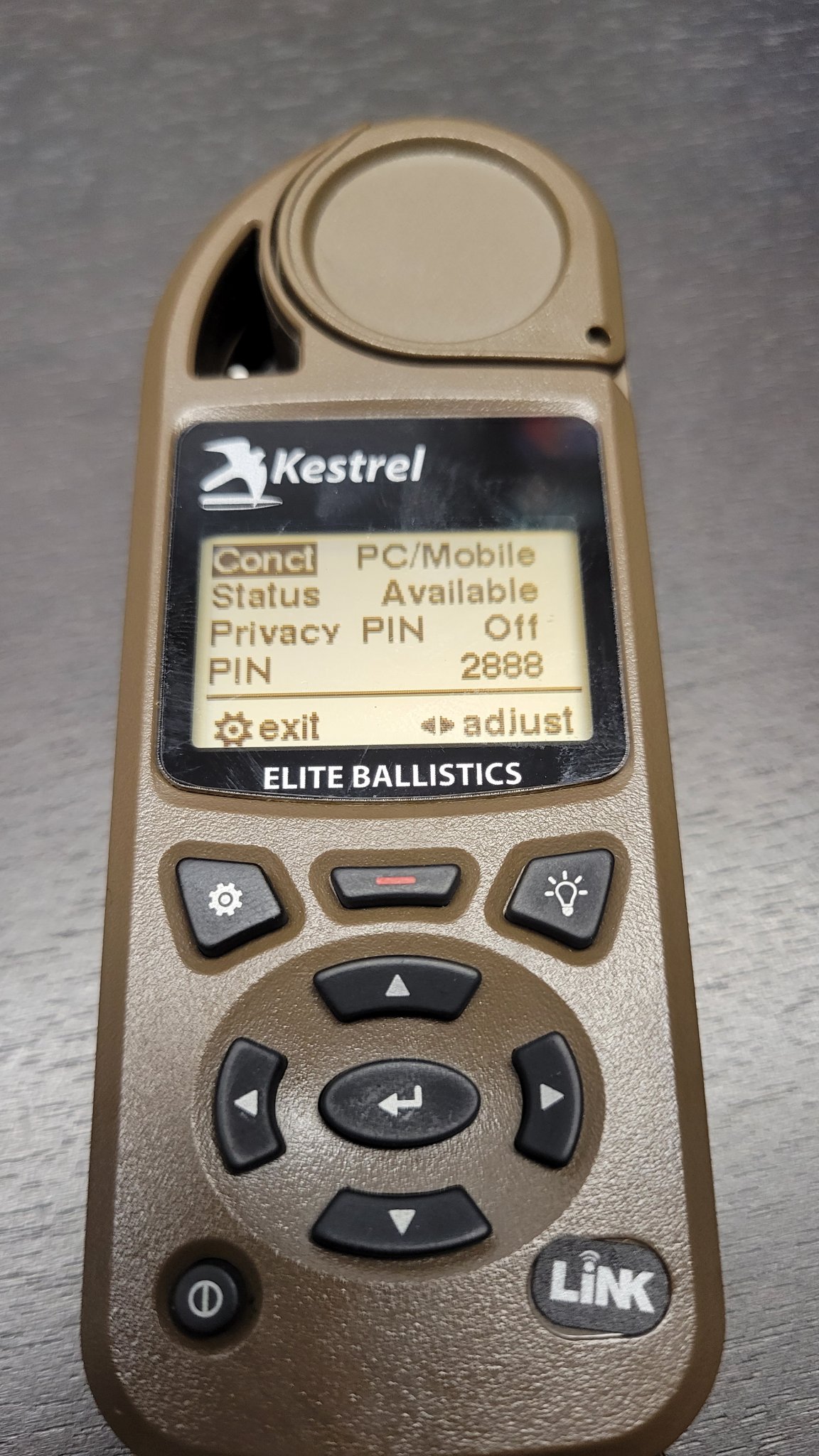

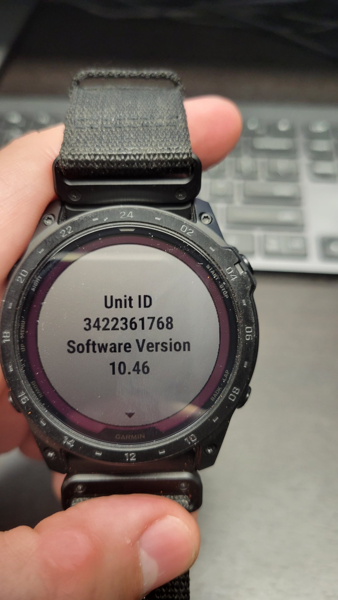

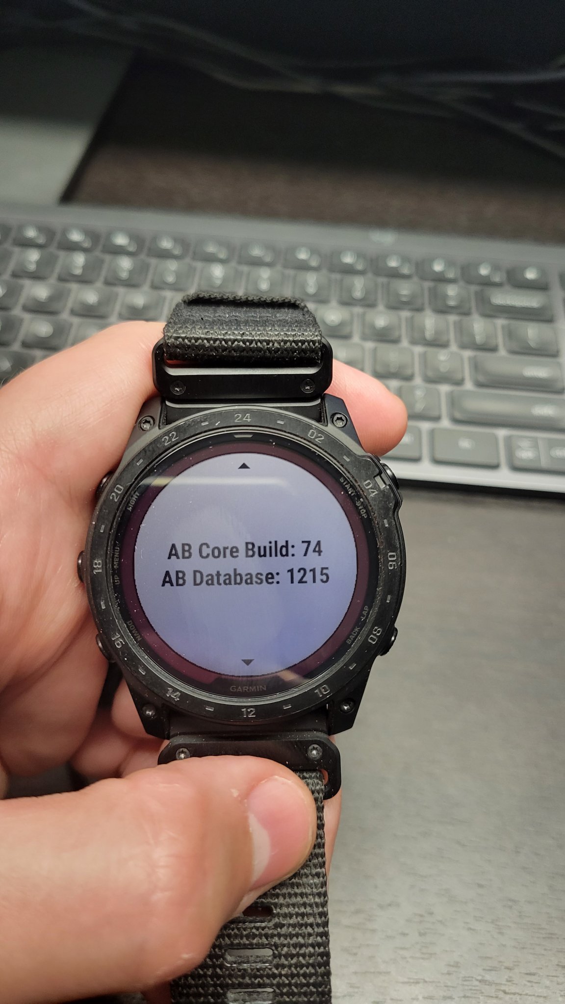

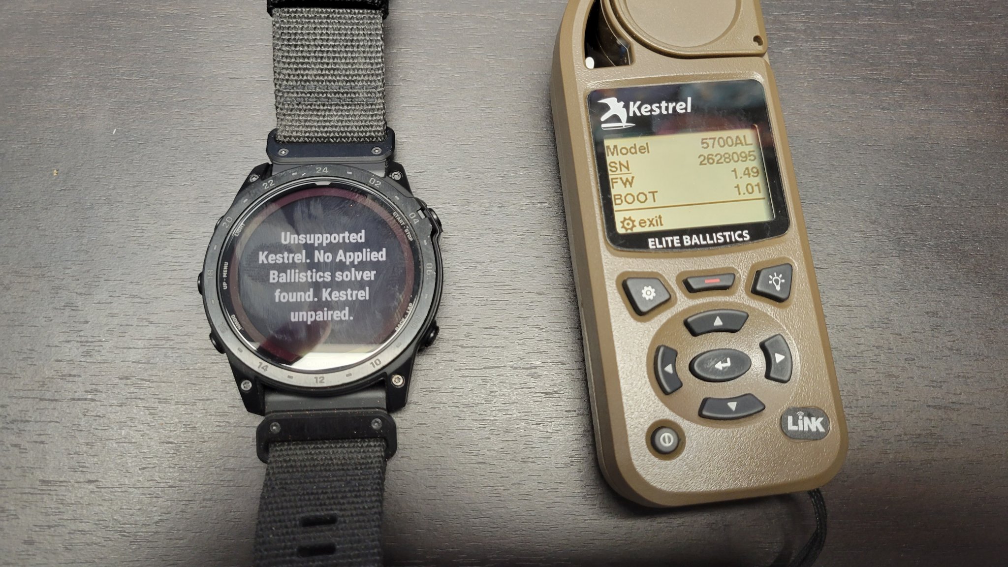

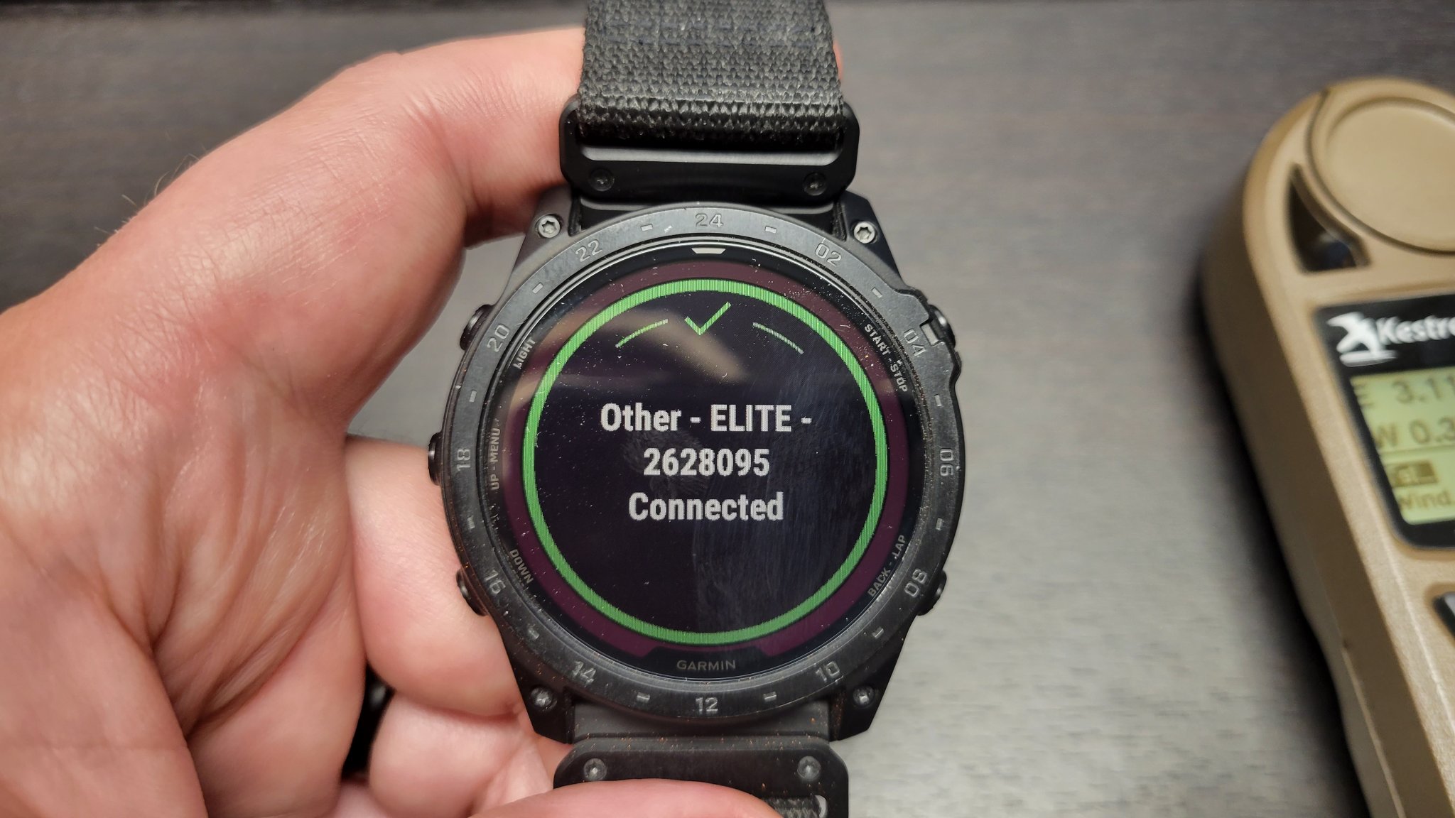

I can pair my Kestrel with the Tactix 7, but every time I try to use it in the AB app, it does this and unpairs the Kestrel. Any thoughts?
Yes. Attaching photos showing what I think are most of the relevant details.
(Hoping @Garmin will weigh in on this.)

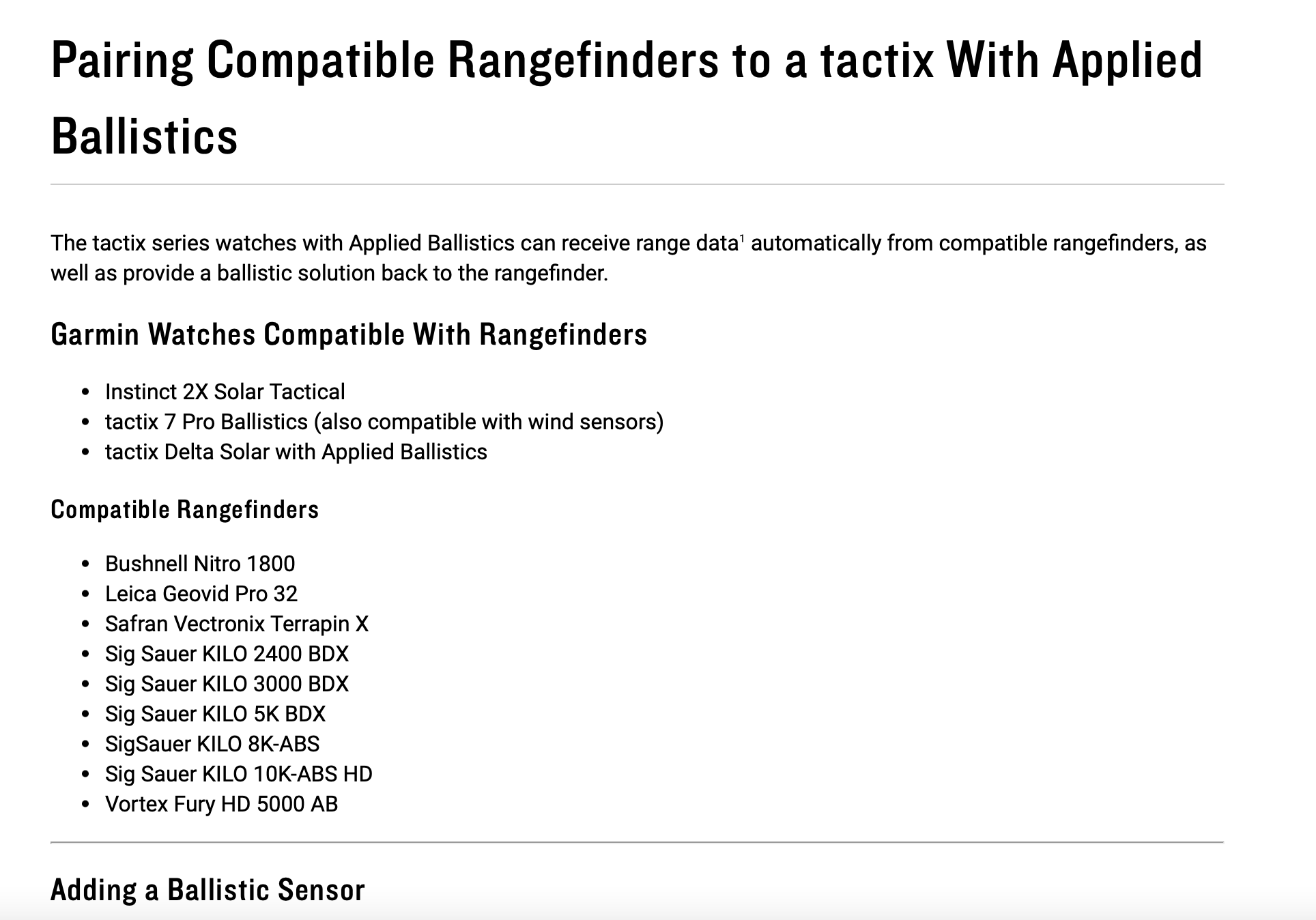

  • Bushnell Nitro 1800
  • Leica Geovid Pro 32
  • Safran Vectronix Terrapin X
  • Sig Sauer KILO 2400 BDX
  • Sig Sauer KILO 3000 BDX
  • Sig Sauer KILO 5K BDX
  • SigSauer KILO 8K-ABS
  • Sig Sauer KILO 10K-ABS HD
  • Vortex Fury HD 5000 AB
?-Sig Sauer KILO 2400 ABS -will not work if it is not in the list?

Does anybody know of a list of fully compatible range finders that will send range, DOF and inclination angle to the watch? I was able to link my Terrapin X to the watch but it will only get LOS range from it.
The list of compatible range finders is available on our support website. The Vectronix is the only one that doesn't send anything other than just range as it doesn't use the AB protocols.
