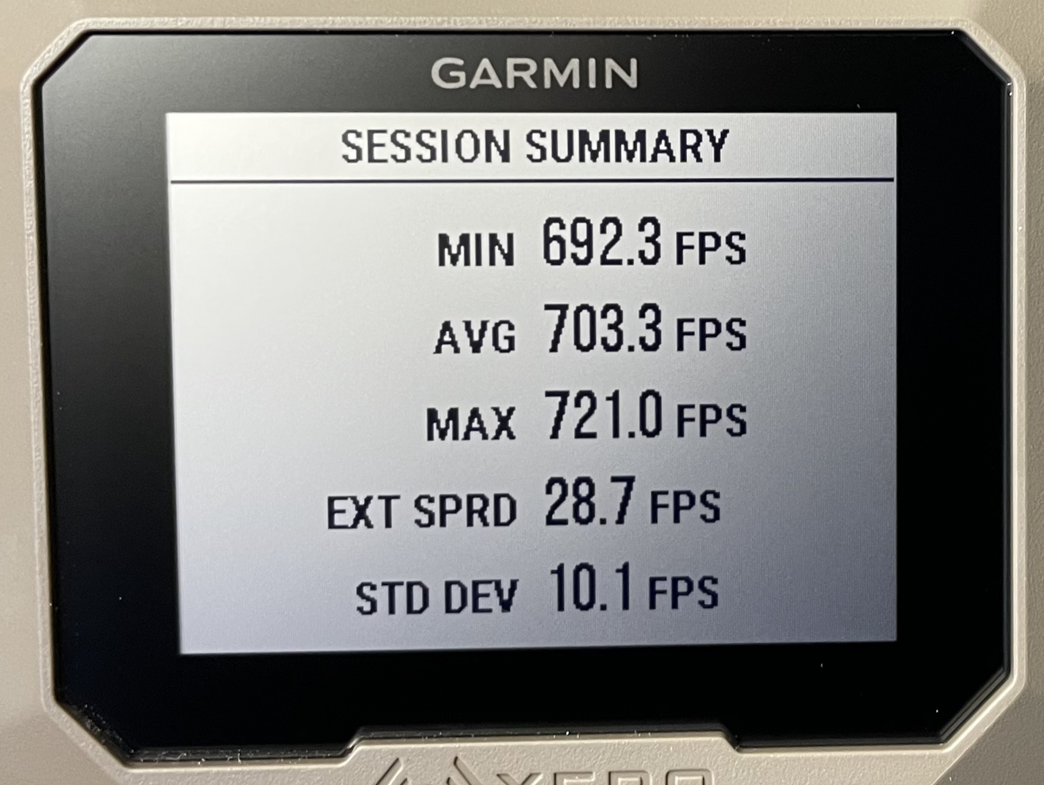

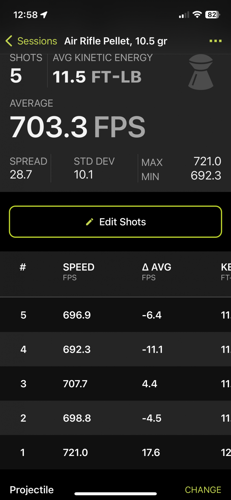

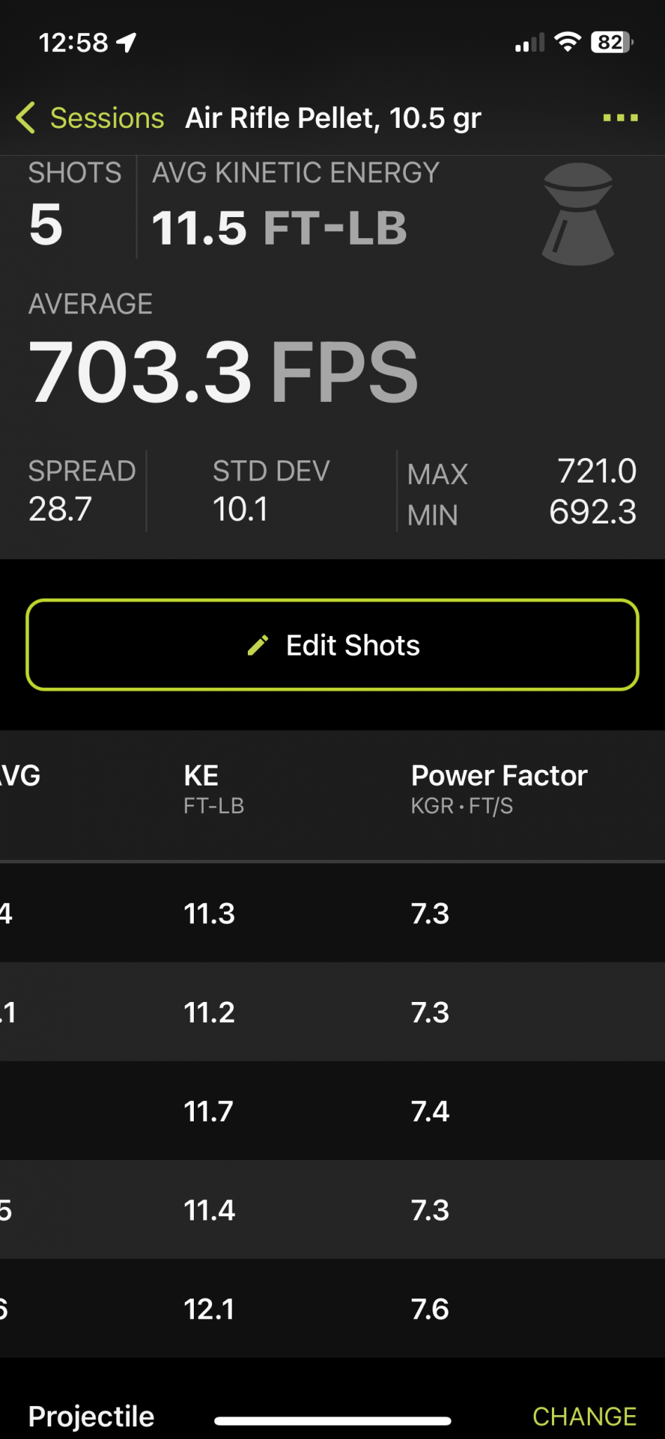

The app seems to be pretty simple and slick overall.
My current experience is extremely limited to 5 shots and what you see above.
I can tell you it isn't greatly sensitive to set up, placement, etc. Yes rifle mounting options really make it nice (top of scope cap with adapter). What I think I like better is that it can be set up on the tripod it comes with, on barricades you are practicing off of, or tripod with spotter nearby.
