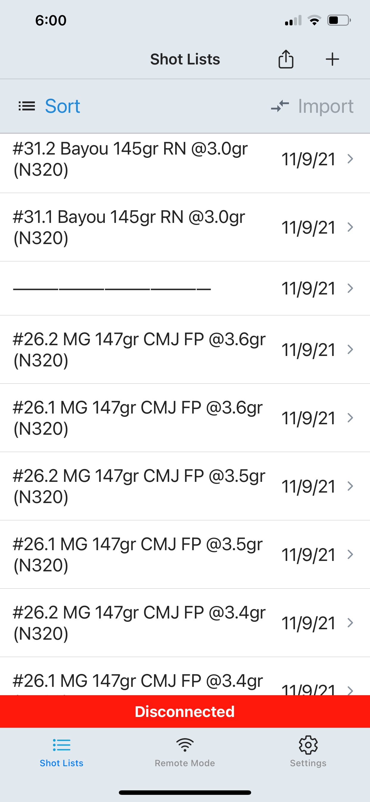

Custom attributes/fields would be a godsend, @Garmin. As it stands now, the only way to tell one load from the other is the use the one tiny note field. Super ghey.
I used to print out the cutesy table the app generated, would export to Excel, also, and print all of these data for the hard-copy 'load book' for each respective caliber; but I could grab any random bullet off the shelf, thumb to the reference number in the app, and find my 'recipe 'and start cooking in 45 seconds.
Here's the fields using my old $90 Pro CX or MX or whatever the hell it's called...literally storing 100s and 100s of loads in there (my Garmin is already 'full').

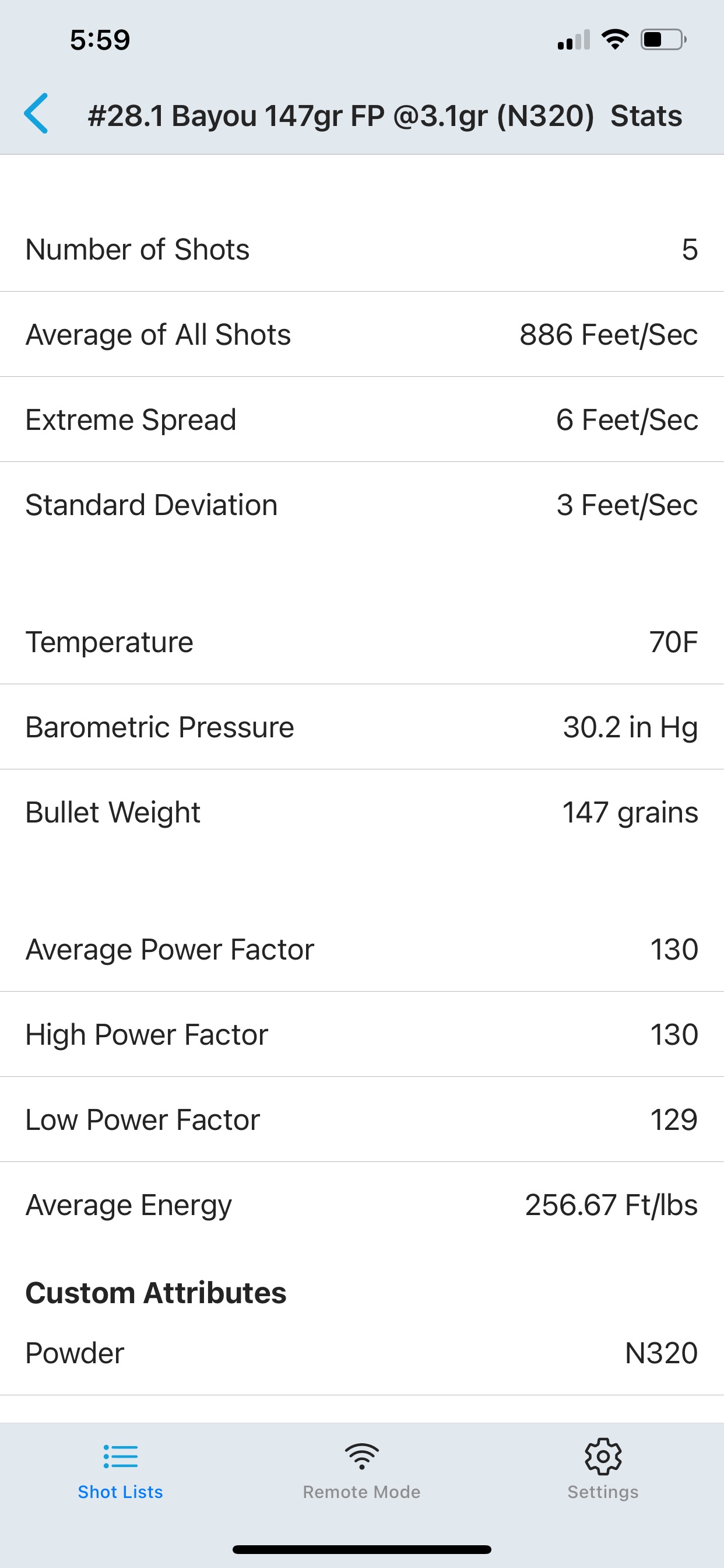

I do know that on 3.27, instead of deleting a shot, click on it and there’s an option to “ignore” it.
If you do that, the shot count reduces by one and the ES/SD calcs do change.
