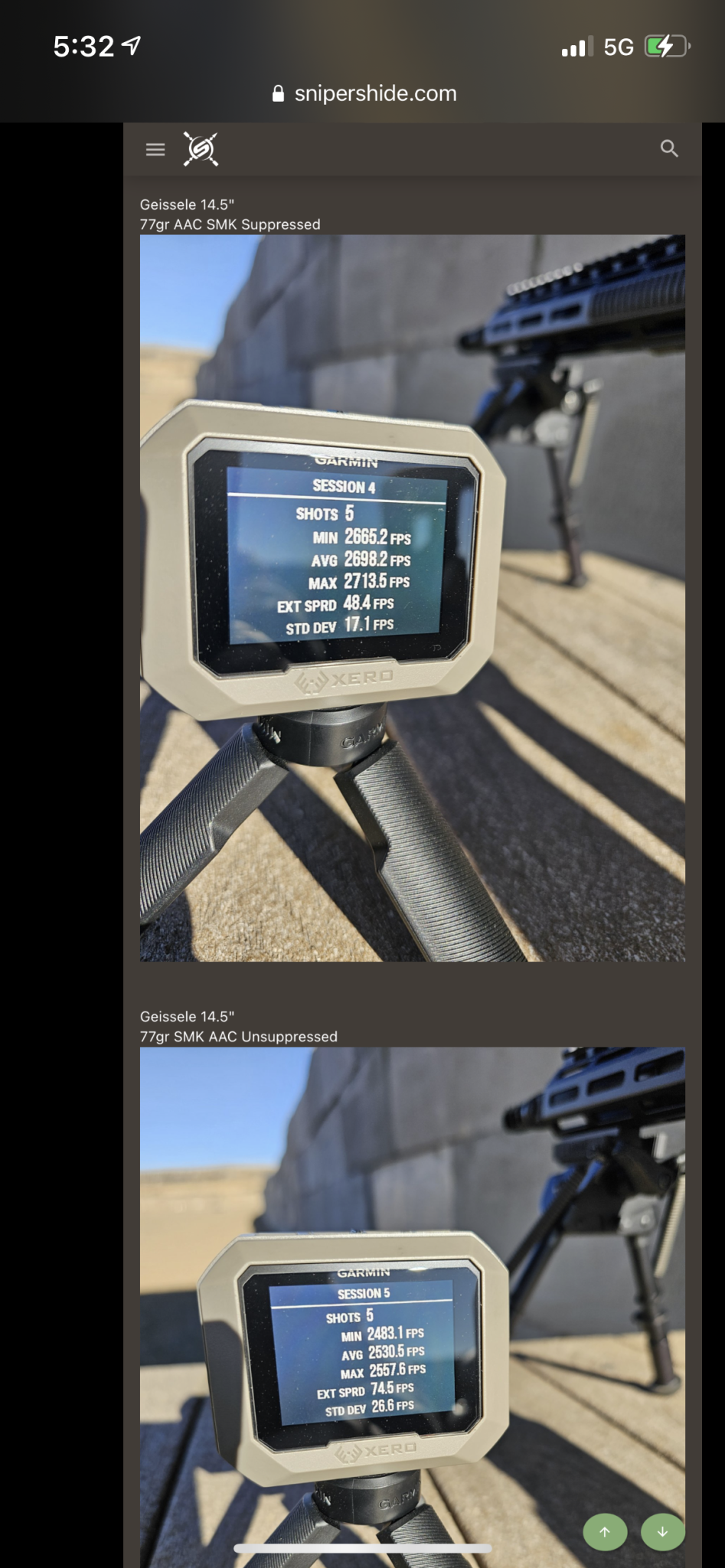

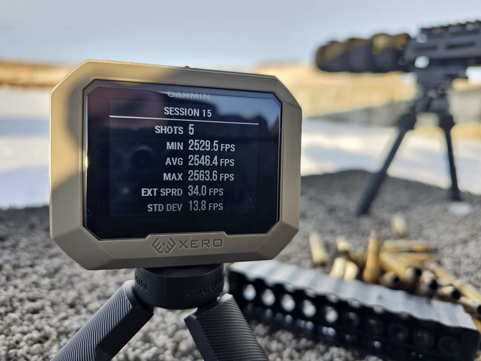

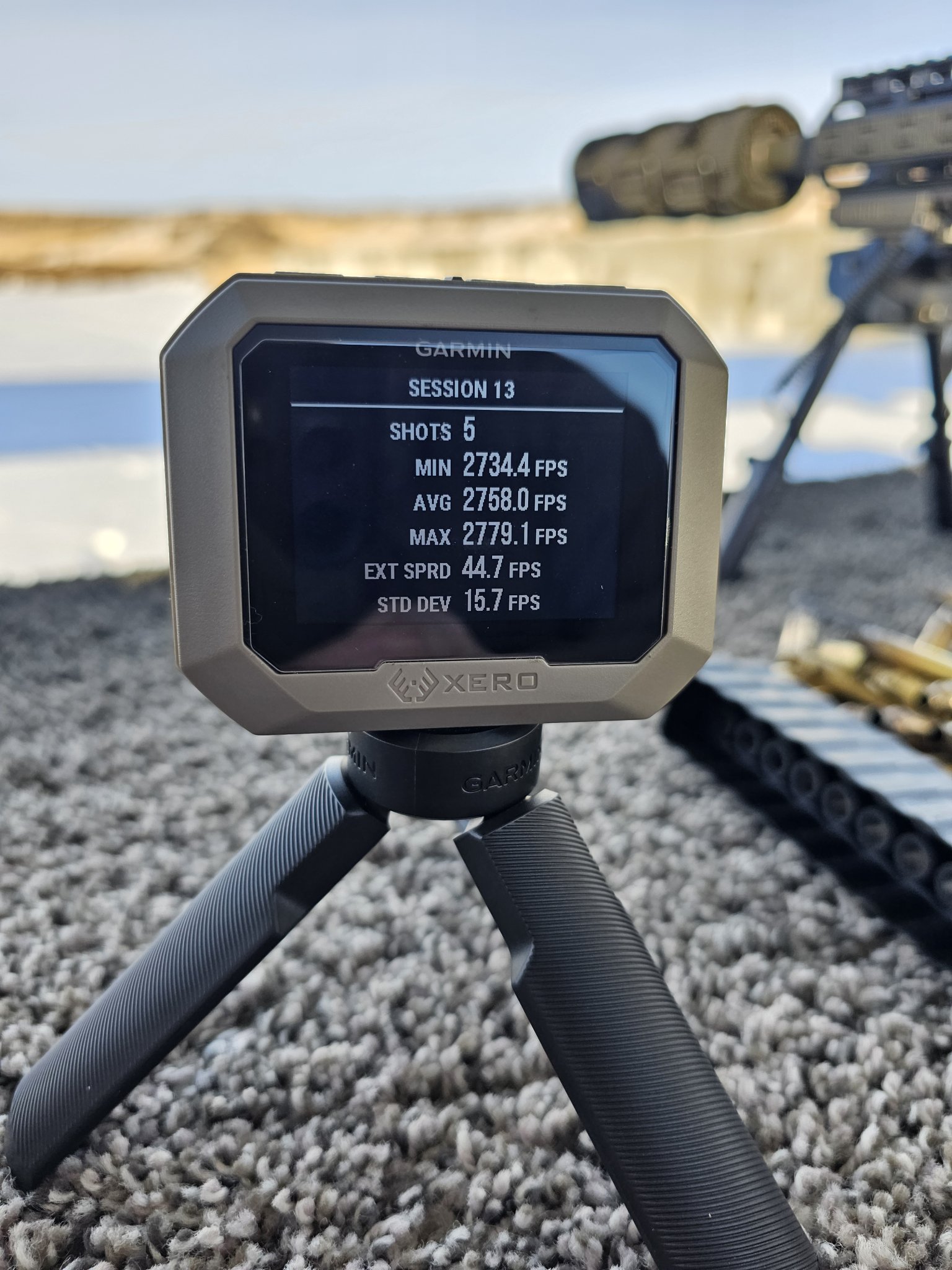

Am I reading wrong on these seems like a big difference suppressed to not

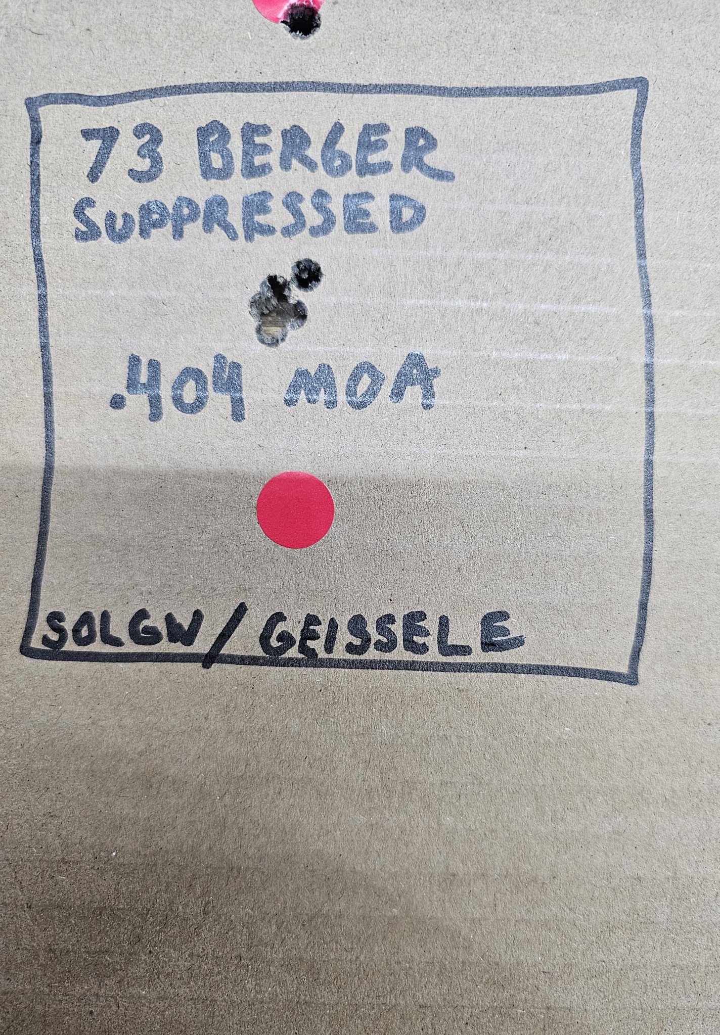

I ordered a few hundred more rounds of the 73gr Bergers. When you think about it, at $32 a box it's really a decent deal.
You get Sub Half MOA factory Ammo with Low SD's/ES, Reloadable Lapua Brass and a quality 73gr projectile that moves at 2708 FPS out of a 14.5" Suppressed barrel.

I'm blown away at that speed. Any crazy pressure issues?
Reactions: matt33 and BurtG

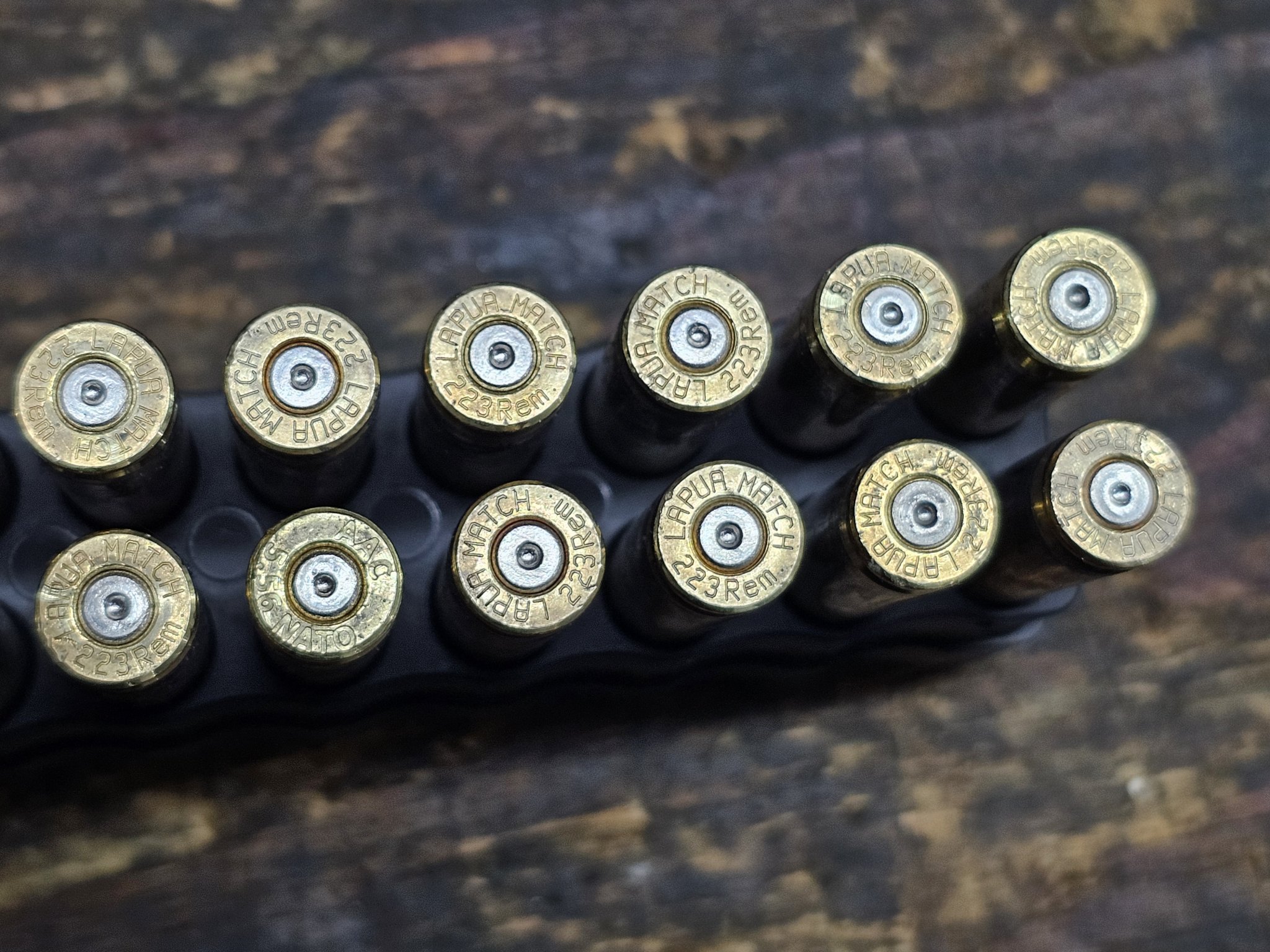

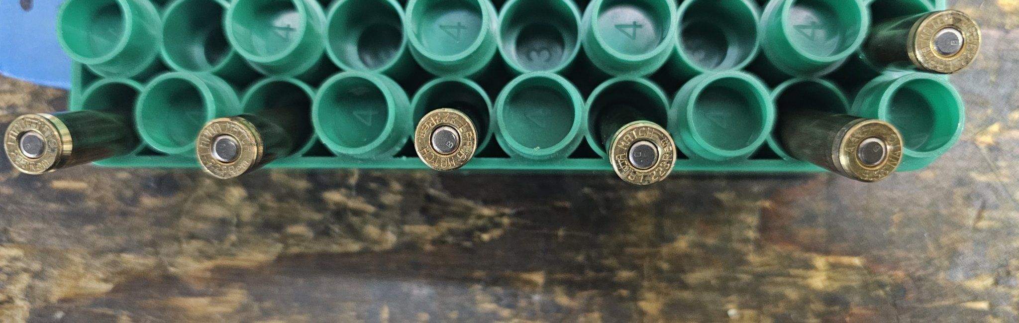

There is a very, very light ejector swipe on the case head when shooting Suppressed that will go away aftet tumbling, other than that no signs.
Once I shoot the ammo, I'll use the brass for my Ramshot Tac and 77gr SMK loads. 99% of the time I find it somewhere between 23.4 to 23.6 grns loaded to just under mag length.

yeah I bet that’s spicy. Berger had some 77gr some years ago that was way over pressure for semi autos, didn’t they?
Yep
Yep
Im definitely not having any of those signs maybe it's just exclusive to the 77gr in the 73's
I'll resize some of the brass today and check for loose primer pockets.
Just resized 6 of the worst cases I could pick out with the most substantial signs of wear, all primer pockets are still tight.

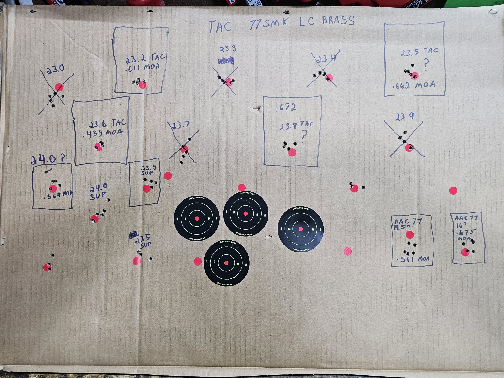

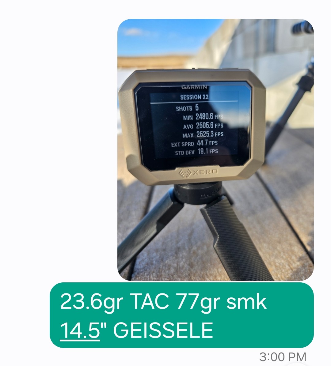

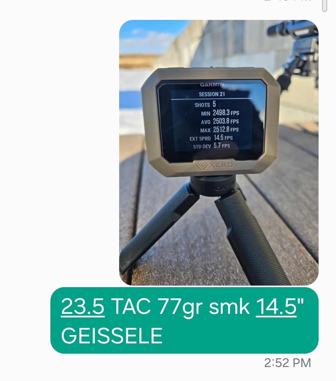

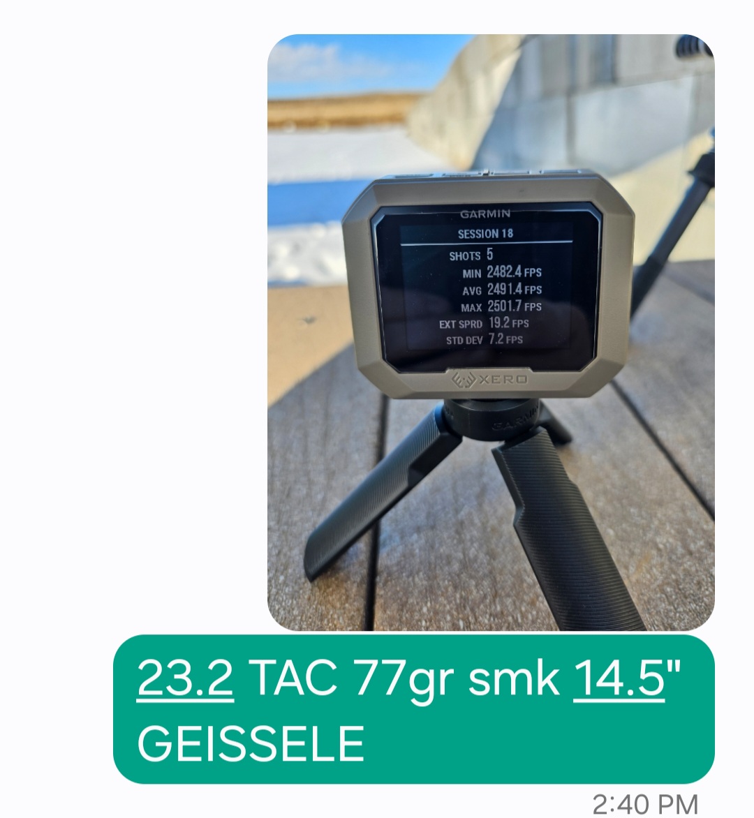

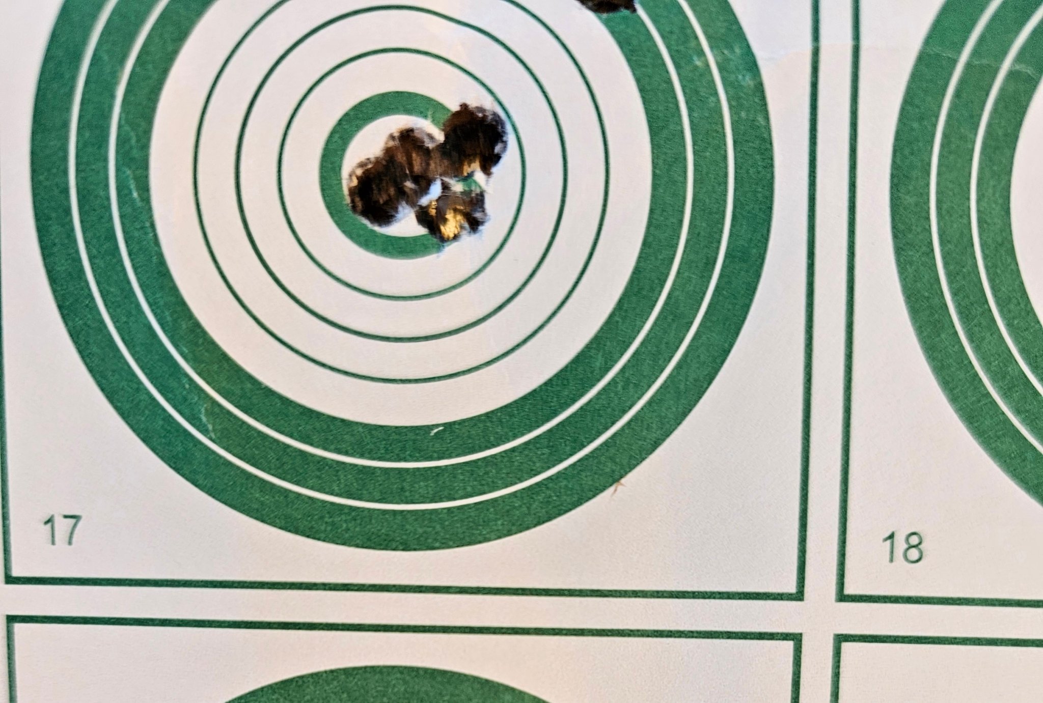

First session of Load development, using 77gr SMK, LC Brass, GM205M Primers, Ramshot Tac.
23.6, 23.2 and 23.5 are showing so.e promise.
I'm not seeing and pressure signs even at 24.0gr, so I'll push it harder till I see pressure signs.
I'm sure I can cleans this up even more with using quality brass, I've got Starline and Lapua on hand so I'll give them a try.

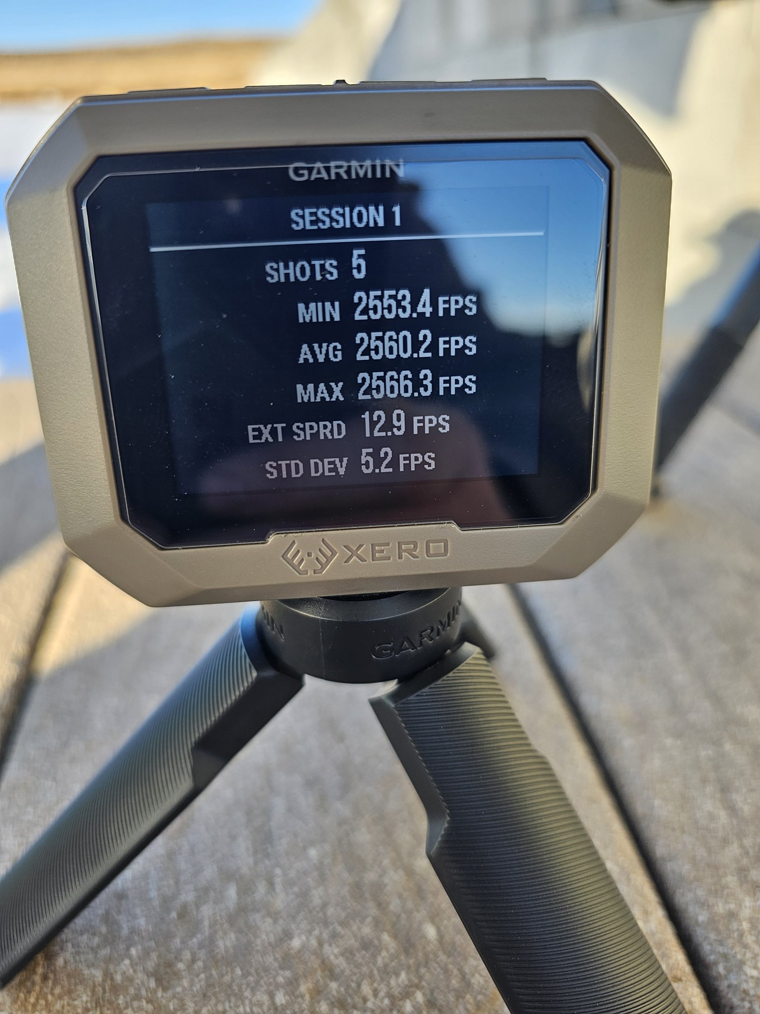

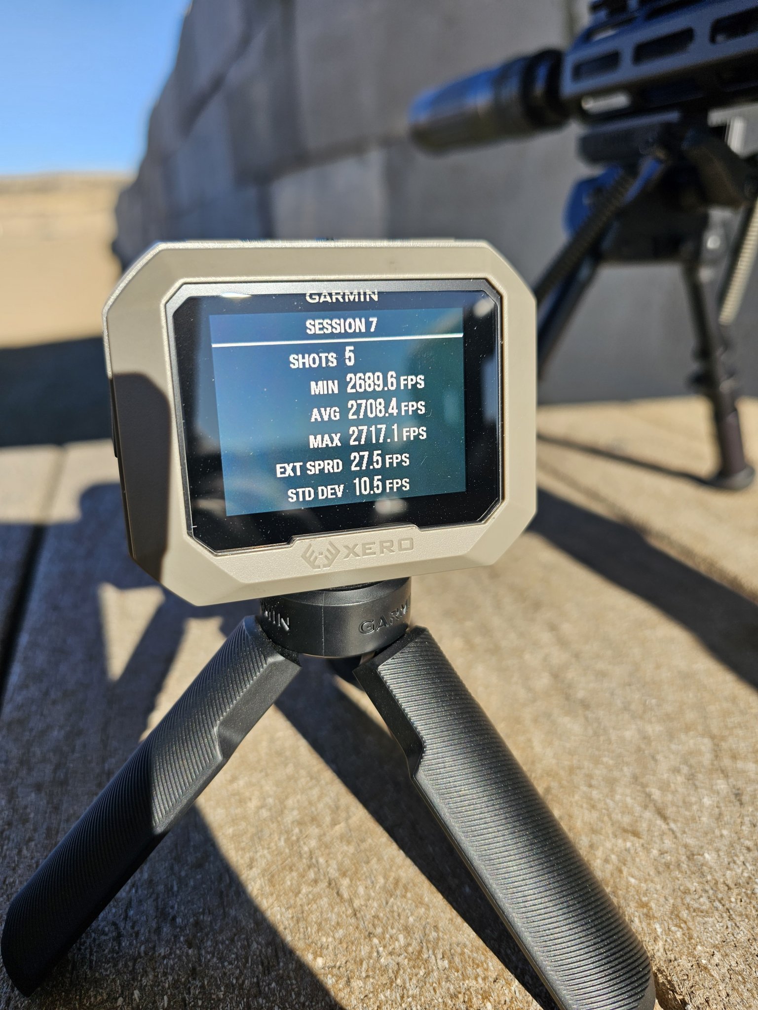

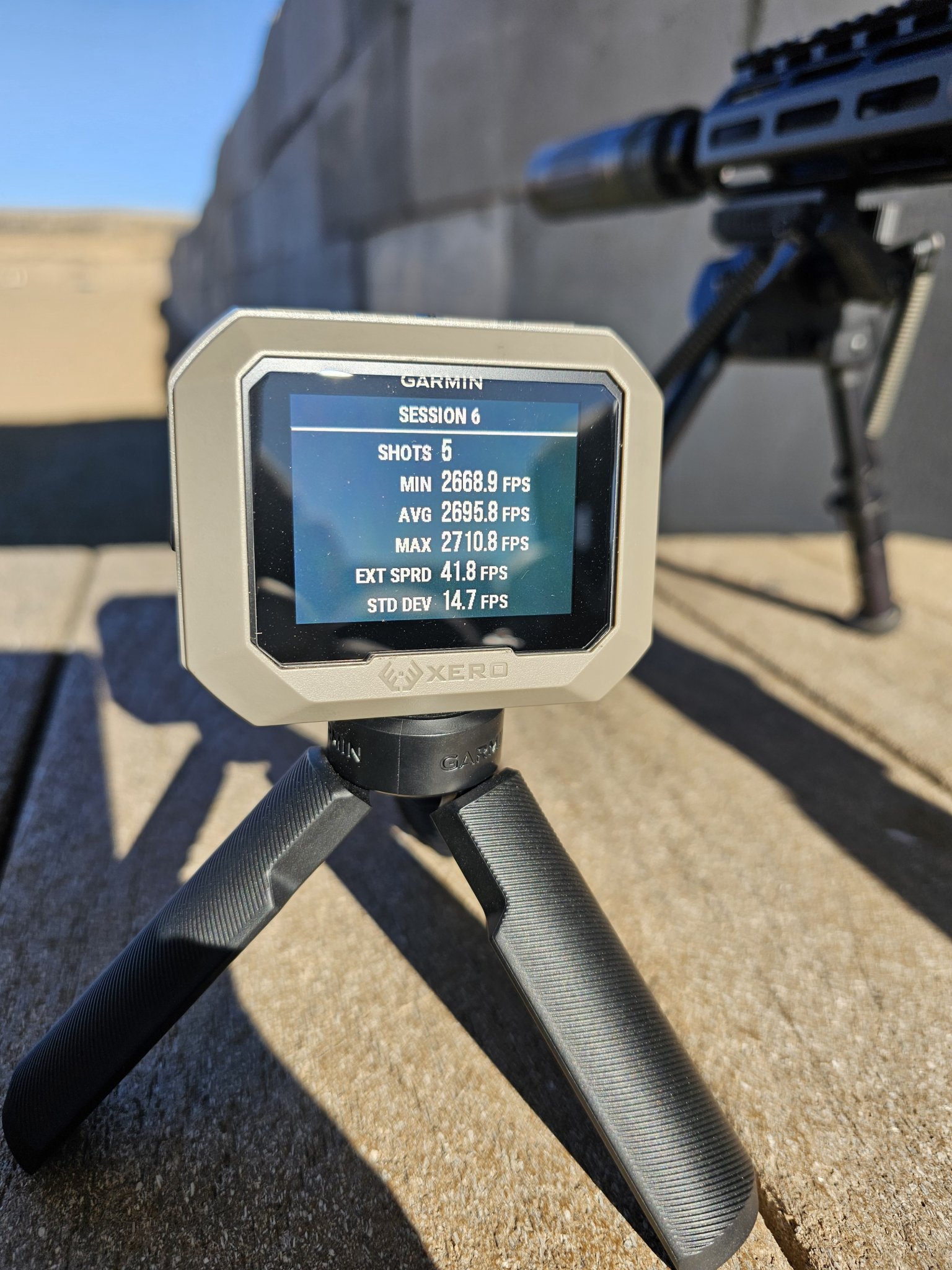

Here's the Data on the 24.0grs of TAC and 77 SMK in the 14.5" Unsurpressed shot around 33°, I'm hoping to hit the accuracy nodes between 2600-2700 FPS with 73's out of the 14.5"
If you guys recall the impressive Muzzle velocity the Berger 73 BT Target Factory Ammo was putting out in the 14.5" Geissele, I shot them again in a Side by Side in a Matching SOLGW Broadsword Build kit with the new Geissele Heavy 16" barrel. The 14.5" and 16" operating parts are exactly the same with the only differences between the two Broadsword/Geissele builds, the 16" has a longer SOLGW Handguard and a Mid-Length +1 Gas System.
The below Data with the Geissele 16" and 14.5" Builds were shot with the same Lazarus 6 Suppressor.
The Data leads me to believe the the Berger 73gr Factory Ammo must be pretty temp sensitive. When I originally chronographs the berger ammo out of the 14.5" Geissele Barrel the outside temperature was between high 50's and low 60's.
When I shot the Berger ammo yesterday it was in the low 30's

The New Geissele Heavy Profile/H-Bar barrels are exceptional. Mine don't care much for 75grs ammo though.
Here is a list of ammo both the 14.5" and 16" Geissele barrels seem to really like that consistently hover around a .57 MOA Average with (2) 10 Shot groups or (4) 5 shot groups, keep in mind this is from a sample size of (4) 16" and (3) 14.5" Heavy Contour Geissele barrels.
I feel confident even though I'm only working with a 7 barrel sample size, which is probably more than twice the amount of the average Enthusiast would be working with, Borescoping these barrels they are Carbon Copies and extremely consistent.
(.57 MOA Average)
AAC 77gr SMK
AAC 69gr SMK
Black Hills 77gr 5.57 or 2.23
Berger 73gr Target.
The Super cheap AAC 77gr OTM Ammo, is a solid choice for Training Ammo that reliably performs under MOA.
