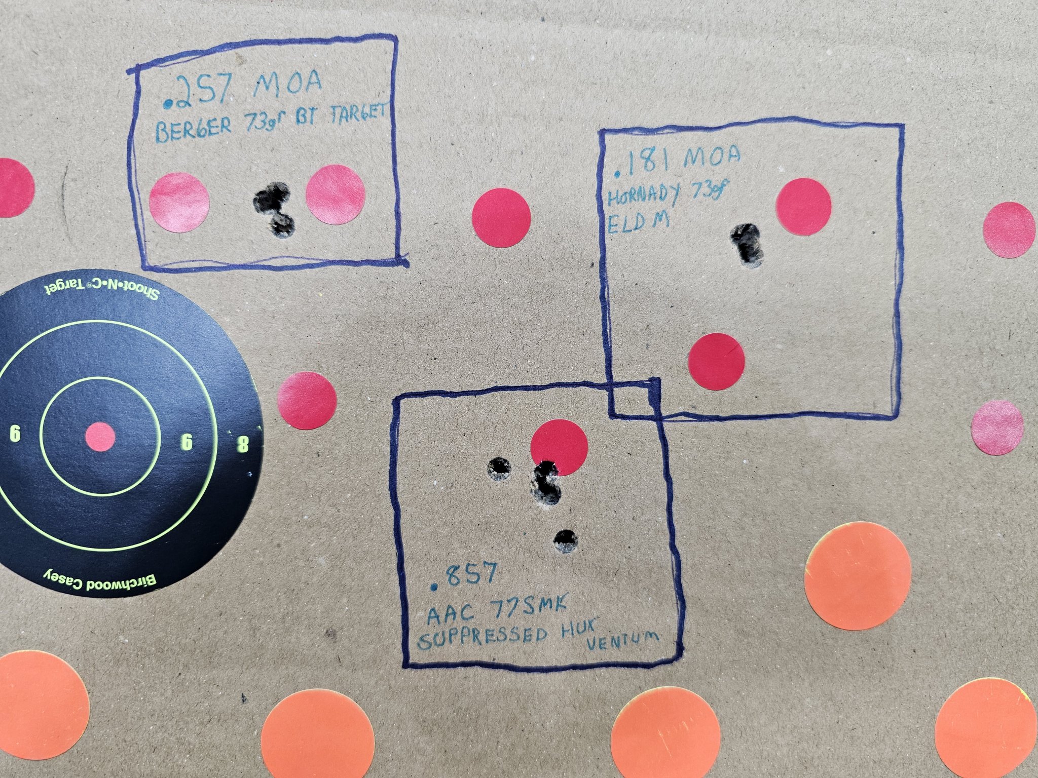

The 73 grain projectiles from Hornady and Berger are truly exceptional out of these heavy Contour Geissele barrels both in 14.5" and 16".
The .181, isn't the smallest five grand group I've ever shot but damn close.

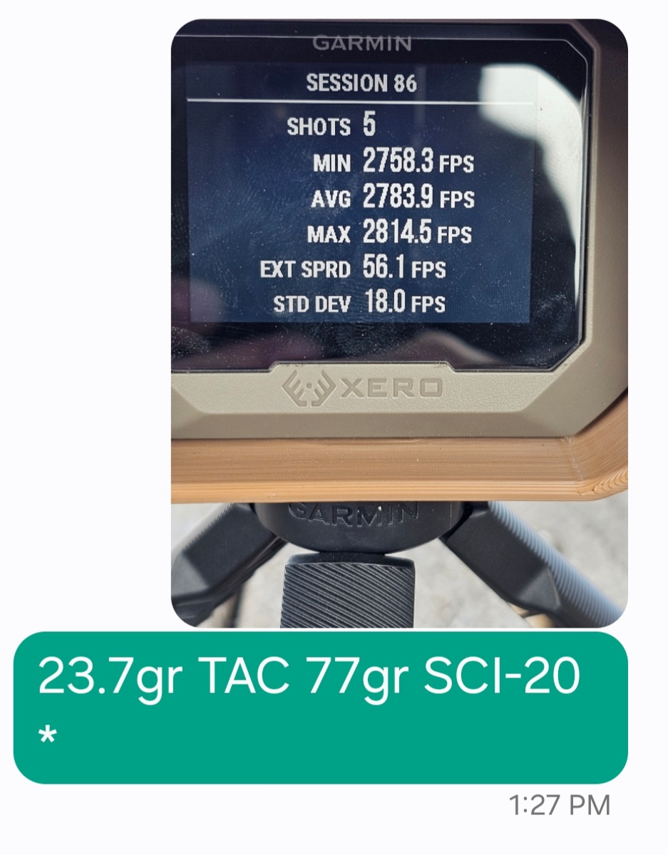

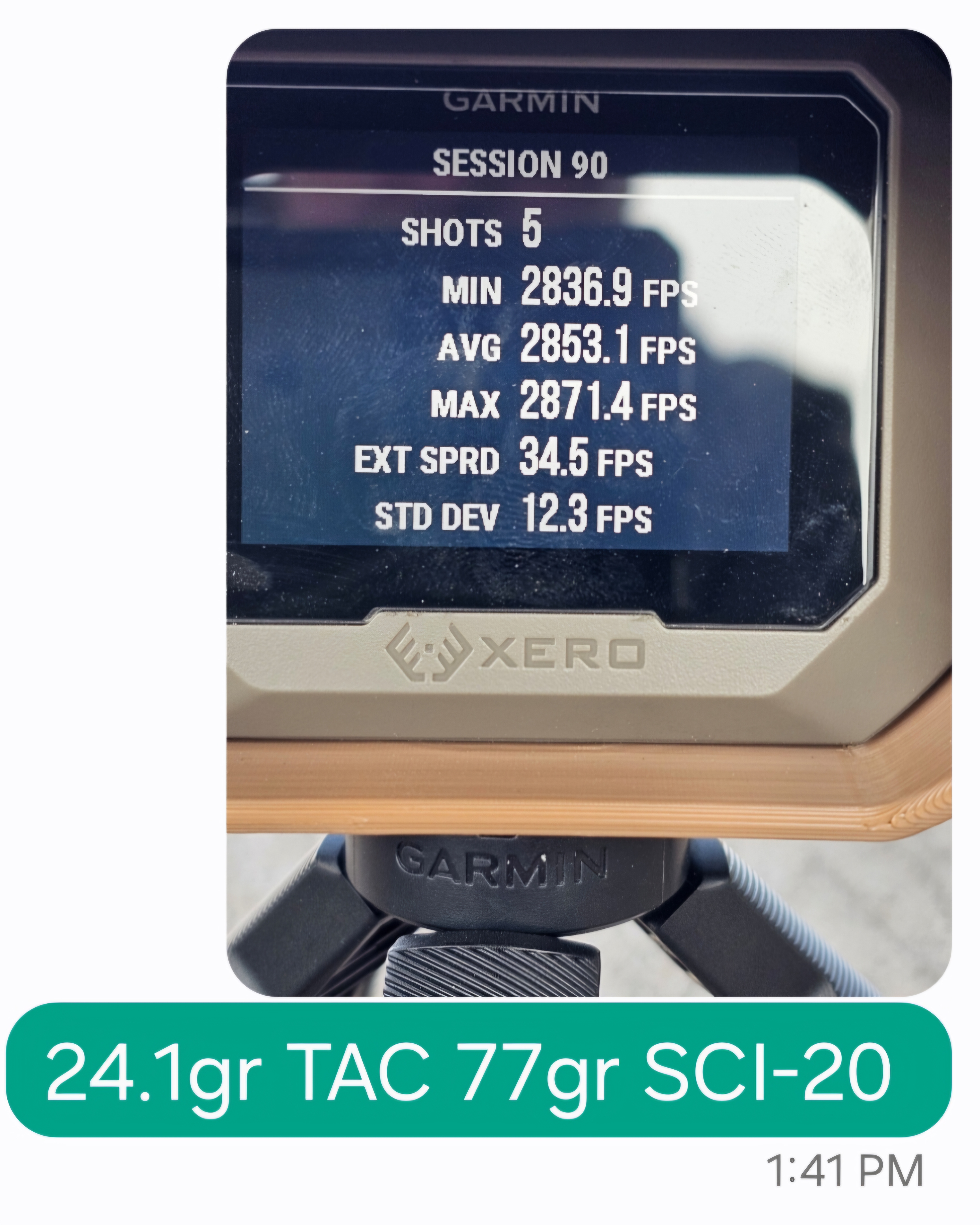

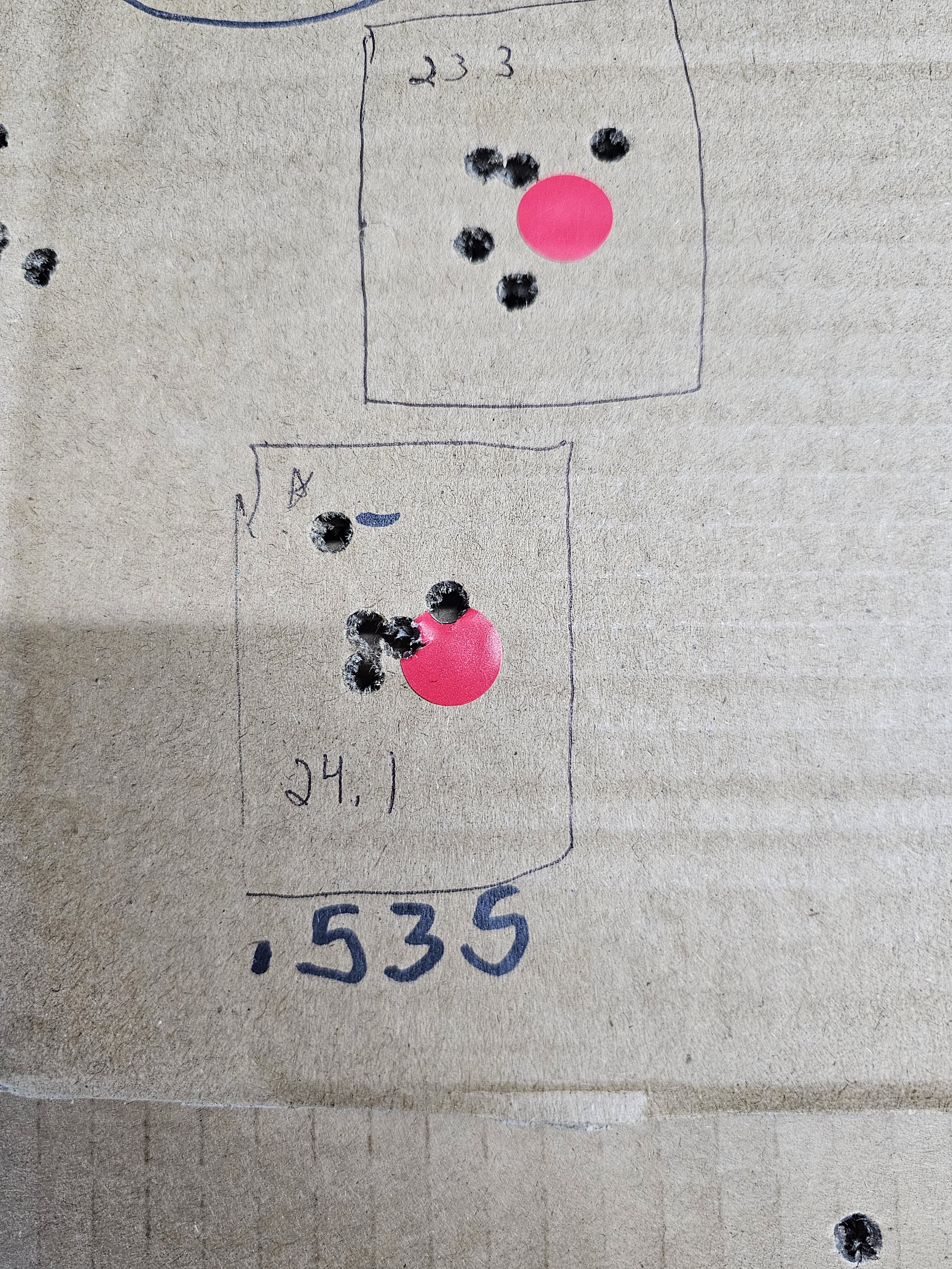

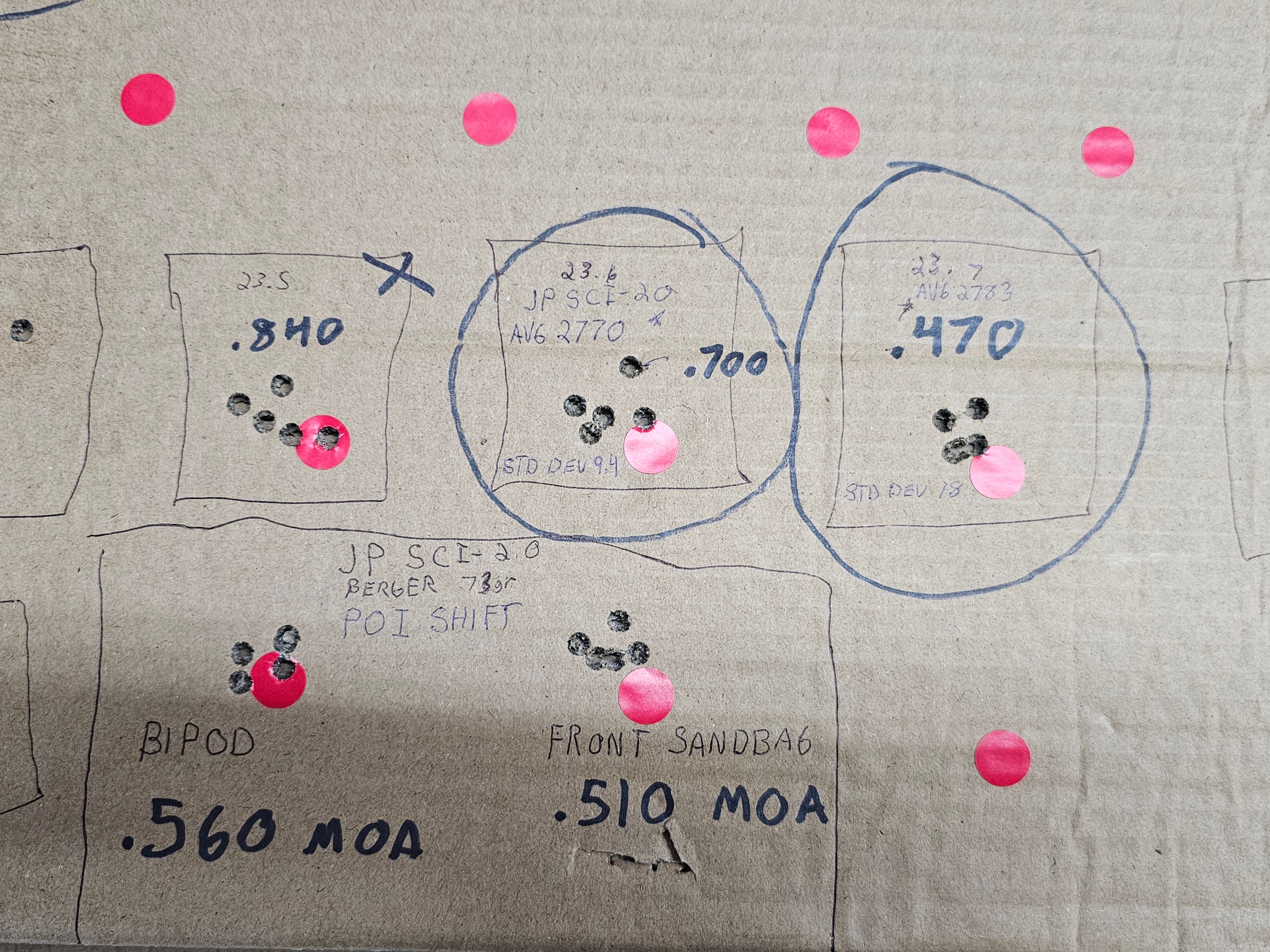

Had a chance to try some of the Hotter Loads with Geissele SPR and 22" Kreiger JP SCI-20.
Still haven't seen any pressure signs working all the way up to 24.7grs of Tac in 18" SPR and 24.1 in the 22" Kreiger.
22" Kreiger
Decent results with 23.7gr and 24.1gr
18" Geissele SPR.
24.5gr Tac

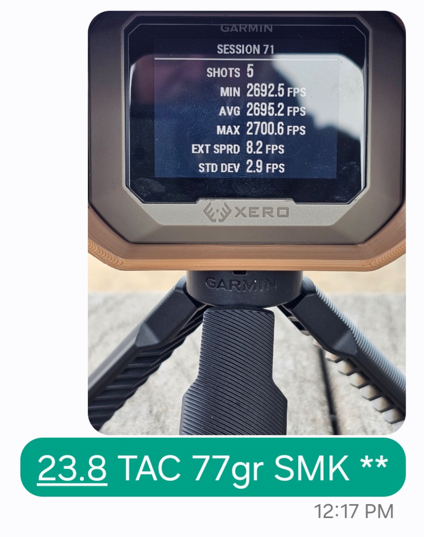

Shot this today with FF brass in the Geissele SPR. Creeping up on 200rds and the SPR barrel is starting to settle in, should get the TAC load locked in soon. Next will be IMR XBR and 77gr SMK.
23.8grs
