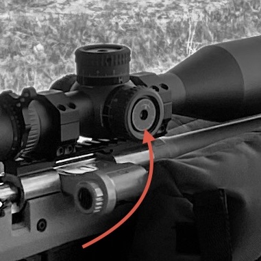

curious as to how I can rezero the turret scales on the g3 razor, On my g2 I just loosen the 3 screws lift up and put scale to what ever I want. have tried to lift the scale on the g3 but will not work. Has anyone been able to reset their turret scales[for lack of proper terms. stan

The Gen 3 turret system is different than the Gen 2 turret system. It is very easy to zero the turrets. To reset the turret to the zero stop, you loosen the set screw on that turret.

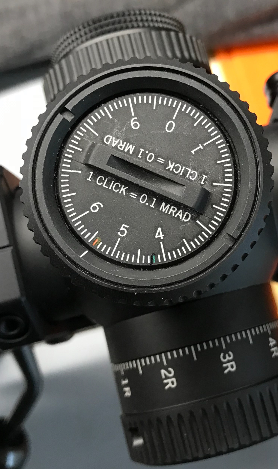

Ok now I have the terminology, I want the inner turret zero to line up with the outer turret zero.
the g2 you can do that but how do you do the gen 3?

What are you talking about? You leave the turrets on zero and locked and then loosen the one screw and then zero the rifle with the top dial. That simple. Then tighten one screw when zeroed and done. No need to do anything else.

How did you do it on the G2 and why does it matter to begin with? Your optic is zeroed by using the internal adjustments under the cap on the G2 and you leave the external at zero. It’s the same concept on the G3 you just don’t have a quarter sized cap to cover them.
It's retarded trying to figure out which direct to turn a micro disk when every other turret on market you loosen and slip to zero. It's a dumb design and the turrets are garbage compared to the gen 2 razor.
Yeah if only there were markings on the turret for which way you should go. It'd be pretty cool if it matched the direction you go for normal operation too... oh wait
