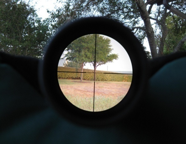

Sight Alignment
Sight alignment is the relationship between the crosshairs (reticle) and field of view. You must place your head behind the scope so a full field of view appears in the scope tube with no dark shadows or crescents. Center the reticle in a full field of view with the vertical crosshair straight up to ensure the scope is not canted. You can purchase anti-cant devices that attach the scope or base from $30-$100. Anti-cant devices insure the scope, as well as the reticle, are parallel to the pull of gravity on the bullet and directly above the barreled action. This slight mis-alignment can cause the bullet to deviate from its anticipated course.
Sight Picture
Sight picture is centering the reticle with a full field of view on the target as seen by you. Place the reticle crosshairs on what portion of the target you wish to hit. Let me reiterate here, a full sight picture! Shadowing in the scope can be an indication of many things. Improper cheek weld, head position, body position, improper eye relief etc. You want edge to edge clarity. In other words, you want to see the perfect black edge all the way around the sight picture with no fuzziness.

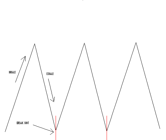

Breathing
You must exercise breathing control during the aiming process. Breathing while trying to aim, with the natural up and down motion of the chest, will cause the rifle to move up and down. Up and down movement occurs while laying down. Breathing movement can be side to side when sitting at a bench rest type table when your body is against the table. You must therefore accomplish sight alignment while breathing and finish aiming in your natural respiratory pause. You do this by inhaling, exhaling, and stop at the moment of natural respiratory pause before beginning to inhale again.
A respiratory cycle lasts four to five seconds. Inhalation and exhalation take only about two seconds, thus between each respiratory cycle there is a pause of two to three seconds. This pause can be extended a couple seconds without any special effort or unpleasant sensations. Vertical strings on your target may be a indication that your holding your breathe. You should fire during this pause when your breathing muscles are relaxed. This avoids strain on the diaphragm.
You should assume your firing position and breathe naturally until your hold begins to settle.
The respiratory pause should never feel un-natural. If it is too long, the body suffers from oxygen deprivation and begins to send out signals to resume breathing. These signals produce involuntary movements of the diaphragm which interfere with the shooters concentration and lack of movement needed to make a shot. Always break your shot at your natural respiratory pause.

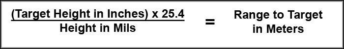

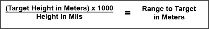

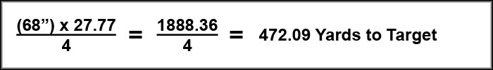

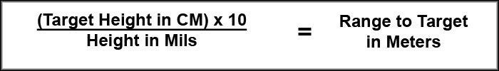

Range Estimation Formulas
^This formula is used for a known target height (in inches) and reading your mil based reticle for a target distance in yards.
If you have known MOA data and go to a mil scope you can just convert it by dividing by 3.44. So, if your 500 yard dope is 12 MOA then 12 / 3.44 = 3.48 or rounded to 3.5 mils so you dial up 3.5 mils and you will hit.
If you’re using a Mil based reticle with moa adjustment the conversion is 3.4377 MOA per mil so multiply 3.4377 times the correction (3.5 mils) and you find there are 12.03 (12) MOA in 3.5 mils. Since each click is 1⁄4 (1/8 click) of an MOA you would need four clicks per MOA (4 x 12 = 48) (8x12=96 clicks)
Realistically formulas are great and should be learned however drop charts are much faster!

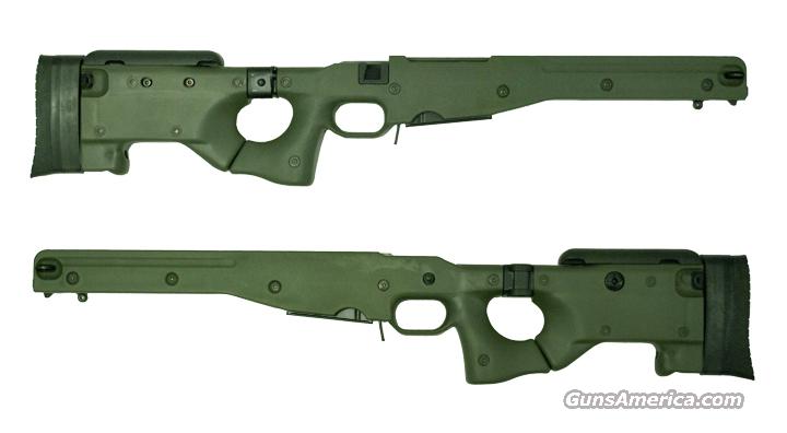

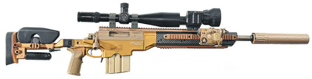

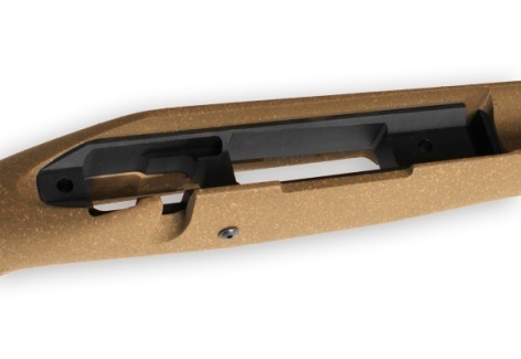

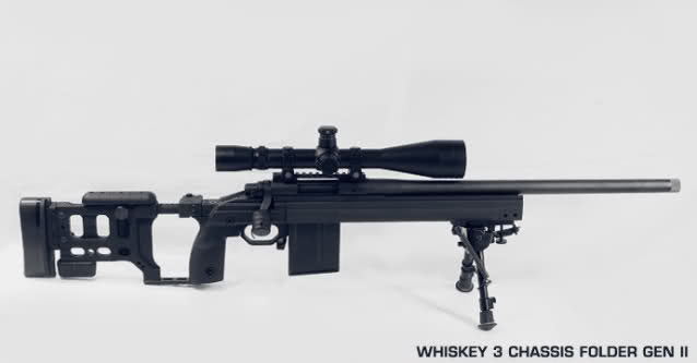

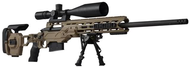

Stocks/Chassis
You can have the greatest barreled action, scope, and trigger on the market, but if you have a tupper ware stock chances are your accuracy will greatly suffer because of it. These are only a few chassis options on the market. Chassis can range from $800 to $3,000.
AICS Chassis
Ashbury Precision Chassis
Drake Associates Chassis
Kinetic Research Group

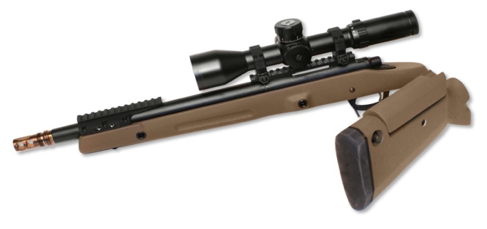

Manners stocks now have the option of having a “mini” chassis molded into the stock plus a stocks that folds in half.
Fiberglass and Composite stocks are still great stocks still used very heavily by military and competition shooters alike. We like to break these stocks up into two categories, “professional” and “budget”. McMillan and Manners fall into the professional category where HS Precision and Bell and Carlson (B&C) fall into the budget line. Both the McMillan and Manners are solid throughout their construction while the HS and B&C are filled with foam, hence why you don’t see these stocks with flush cups installed. McMillan and Manners will require you to pillar bed plus bed the barreled action into the stock to reach its potential for accuracy. Disregard the bedding if using a mini chassis with the Manners. HS Precision and B&C stocks have an aluminum bedding block meant to provide more accuracy. We have found these stocks still greatly benefit from skim bedding the barreled action into the stock. Bedding takes out any inconsistencies between the stock and barreled action and marries them to each other like a glove.

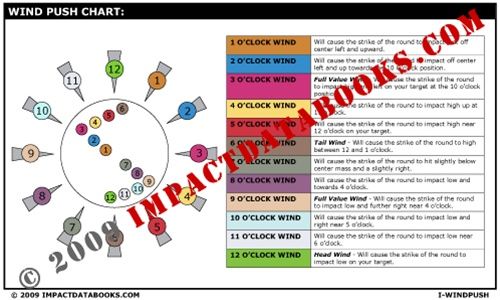

Wind Reading
The single most unpredictable element in long range shooting is the wind. There is always air movement even though you may not feel or see it. Wind can be determined from two departments, art and science. Art refers to monitoring everything between you and the target. The tree leaves moving, tall grass swaying and any other clues you see. Science refers to taking reading with a meter to be addressed below. Together, these two methods will give you the best tools to make a call on the wind. Mirage discussed blow is another tool to use; however, it is much harder to see compared to objects moving in front of you.
Wind is not constant. It is not side to side or front to back. It moves about the terrain around you. It is best to visualize how water would flow over a given terrain. Water and air are both mediums. The air will flow over hills and valleys just as a river flows over rocks, through bends as well as eddies. Chances are the wind will change as soon as you’ve made a wind call. You will need to be on the fly with your observations. Feel the wind. If you get a funny feeling that the wind is going to change, don’t shoot. Wait for your next respiratory pause to shoot.
There have been some discussions as to what area the wind matters most. The wind closest to the shooter since the wind has longer to act upon the bullet. The wind at the target since the wind has a greater effect on the bullet due to a diminished velocity. It all matters. Focus on the entire distance to the target.
Not all wind is acting equally upon your bullet once fired. Depending on the direction the wind it coming from, it can be classified as full-value or half-value. After you have determined a wind speed, check your ballistics for the corresponding wind drift. If the wind is nearly side to side, apply that full-value to your firing solution. If the wind is coming at an angle, apply the half-value to your firing solution.

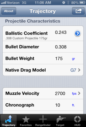

Ballistic Coefficients
Whatever type of ballistics you use, you will need to know the ballistic coefficient of your bullet. A ballistic coefficient (BC) is a measure of the bullet’s ability to overcome air resistance in flight. It is a function of mass, diameter and drag coefficient. The higher the BC the more slippery the bullet is as it flies through the air. Most bullets for long range have a good BC. A higher BC will allow a bullet to retain its velocity aiding in trajectory, wind drift and retained energy. Ballistic coefficients are not set in stone. They will vary upon velocity. Typically, the faster the bullet starts out, the higher the initial BC is. As it begins to slow, the BC will be reduced some. This is very important when entering your bullet’s BC into ballistic software. When entering into software, you may come upon multiple drag models for a particular bullet. The most common are G1 and G7.
G1. The G1 drag model coefficient is the number usually given or displayed by bullet manufacturers. The G1 coefficient describes a blunt nose, flat base bullet. Most long range bullets are typically not of this form, but it can be used for trajectory calculations.
G7. The G7 drag model coefficient describes a long, sleek bullet with a boat-tail. It more accurately depicts a long range bullet. Ballistic software using a G7 coefficient usually yields a trajectory close to the actual trajectory.

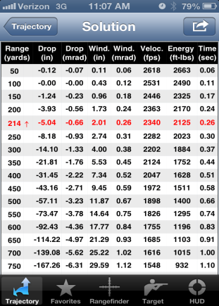

Different Types of Ballistic Software
There are quite a few ballistic programs available online or on a mobile device. Some are rough and quick while others are detailed and complex. You just need to dig into a program and see how it performs for you. I prefer to use JBM Ballistics. It allows you to control all inputs and outputs. You can create your own range cards for different conditions even look up bullet lengths and stability calculations. It’s all there.
Some commonly used ballistic software are: Field Density Altitude Calculator, Adaptive Quick Card, JBM Ballistics, Field Firing Solutions, Ballistic AE and Shooter. The quality of the information you enter will determine the quality of the outputs. Typical parameters are: bullet, BC along with drag model, muzzle velocity, distance to chronograph, scope centerline above bore centerline measurement (sight height), temperature, pressure, altitude and humidity. Always pay attention to units, and it never hurts to make sure the output makes sense.
Once could write a book on ballistics and software. In fact, Bryan Litz has quite literally wrote the book. When selecting any bullet BC or drag

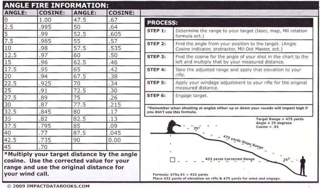

Angled Fire

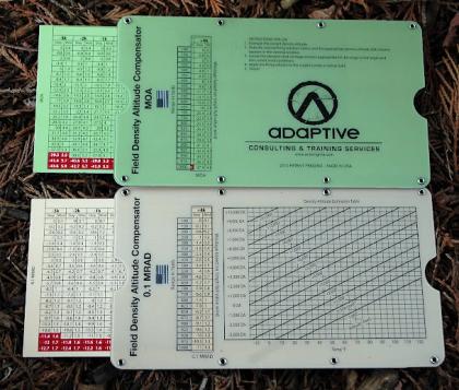

FDAC (Field Density Altitude Compensator)
Designed for use with all MOA and MRAD adjusting optics. This product was entirely conceived, designed, and validated by Adaptive Consulting & Training Services, LLC (ACTS). ACTS is a small business completely owned and operated by former USMC Scout Snipers.
The FDAC is an analog slide rule that displays elevation and windage firing solutions using density altitude (DA). It has two sides, side (A) calculates firing solutions in MOA (minutes of angle) and side (B) calculates in 0.1 MRAD (one tenth milradian, commonly referred to as “mils”). The front of the product has a density altitude calculation table, allowing the user to easily compute density altitude with acceptable accuracy in the absence of an instrument such as a kestrel or other device that measures density altitude. The user simply inserts the slide which is the closest to the muzzle velocity of his rifle, and then slides the internal firing solution matrix (the slide) until the current density altitude and the below listed firing solutions are visible in the viewing window. All firing solutions contained in the FDAC are calculated using the G7 drag model and Bryan Litz’s tested G7 ballistic coefficients. All data contained in the three slides are the results of an extensive two year live fire testing and validation project involving several military snipers, about 20 different weapon/optic.

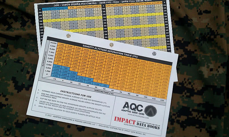

Adaptive Quick Card (AQC)
The AQC is designed to be the most simple, intuitive, and accurate tool available to estimate density altitude (DA) and calculate long range firing solutions for a large array of popular firearm calibers, bullet types, and muzzle velocities.
The AQC's design is an adaptation from the FDAC (Field Density Altitude Compensator) and was completely conceived, designed, and validated by a team of Marine Scout Snipers. The AQC is intended to simplify the process of calculating a firing solution, so that all users of all experience levels can quickly and easily engage targets in austere field environments, without the use of any additional devices.
The firing solutions found within the AQC are incredibly accurate and have been extensively tested at long range to ensure data accuracy and compatibility with the wide range of firearm and optics combinations used by today's military/LE snipers and long range shooting enthusiasts.

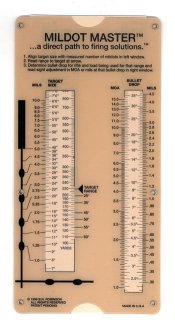

Mildot Master
The Mildot Master in use is fairly simple. You measure a target of known height with the Mil scale in your rifle scope. You then match the target height on the sliding scale of the Mildot Master to the milled height on the body. You then look at the arrow on the scale labeled "TARGET RANGE" and bingo! Check your ballistic table, dial in the correction and fire. No more need to remember the Mil Relation formula or worry about your calculator breaking in the field.
The Mildot Master accommodates meters instead of yards by just turning the sliding scale over. There is even a place on the back to place your ballistic table.
One last cool feature that the Mildot Master has is a scale for reading the angle to target. If you have ever shot from high angles, then you know that this will cause your bullet to impact higher than it would at the same range over a flat line of sight. There is some trigonometry involved in working out the exact "corrected" range to the target. At short distances, it really doesn’t make a difference, but at long range and high angles it does. When dealing with extreme angles, the distance to the target is typically close due to terrain. Remember to use the elevation setting for corrected distance to target (along Earth’s surface), and the windage setting setting for straight line distance to target (measured distance).
On the back of the Mildot Master, there is an angle scale. You tie a piece of string and a small fishing weight (or rock, or whatever) to the rivet labled "PIVOT". Simply sight down the side edge of the Mildot Master to your target and read the angle off of the scale. Then flip the Mildot Master over and match the angle to the scale under "TARGET RANGE". That angle will correspond to the "corrected" angle on the scale. Dial in the scope correction required for the corrected range and engage.
Alternately, you can have your spotter measure the angle of the rifle barrel while you sight in on target.
The included instruction booklet goes into great detail on how to use the Mildot Master. It even includes practice problems.
While this may not be something that everyone needs, it is definitly worth the price. If you are a Military Sniper or a LE Sniper who may have to shoot over extended ranges this is a "must have" backup to your Laser
