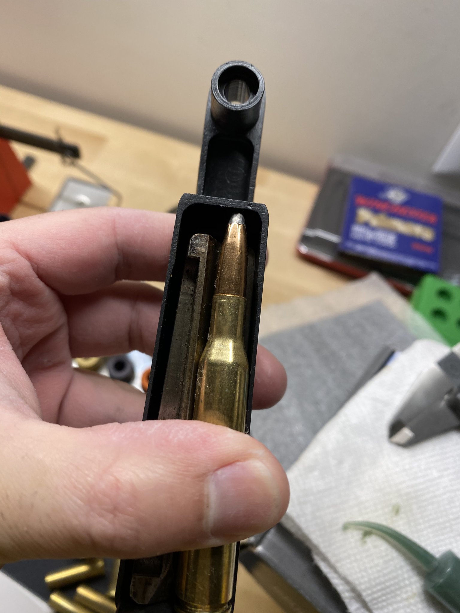

As for your action there is a tool that you can purchase to lap the bolt rails. If you are having someone else finish the build they will take care of it, it would have probably been better to blue it after checking the torque shoulder but either way I'm sure it will be fine. Do not, I repeat do not scrap this build. I catch a lot of flack sometimes for my 308 until they see it shoot because it's not a Remington or some other fancy new action some people dont think it's worth saving.

I am running a .280 ai in mine. It's fun to have a Mauser action, but not easy. I have 10 stripped actions laying around, and in the process of building another wood stock for the .280. if doing it for nostalgia, cool. If not get a different action. Not a huge stock selection available that is not just a base hunting stock. Also scope mounting can be a pickle. I had a canted rail for mine built. The gun shoots phenominal, but once I get it done, I will likely be trying to dump 10 actions.

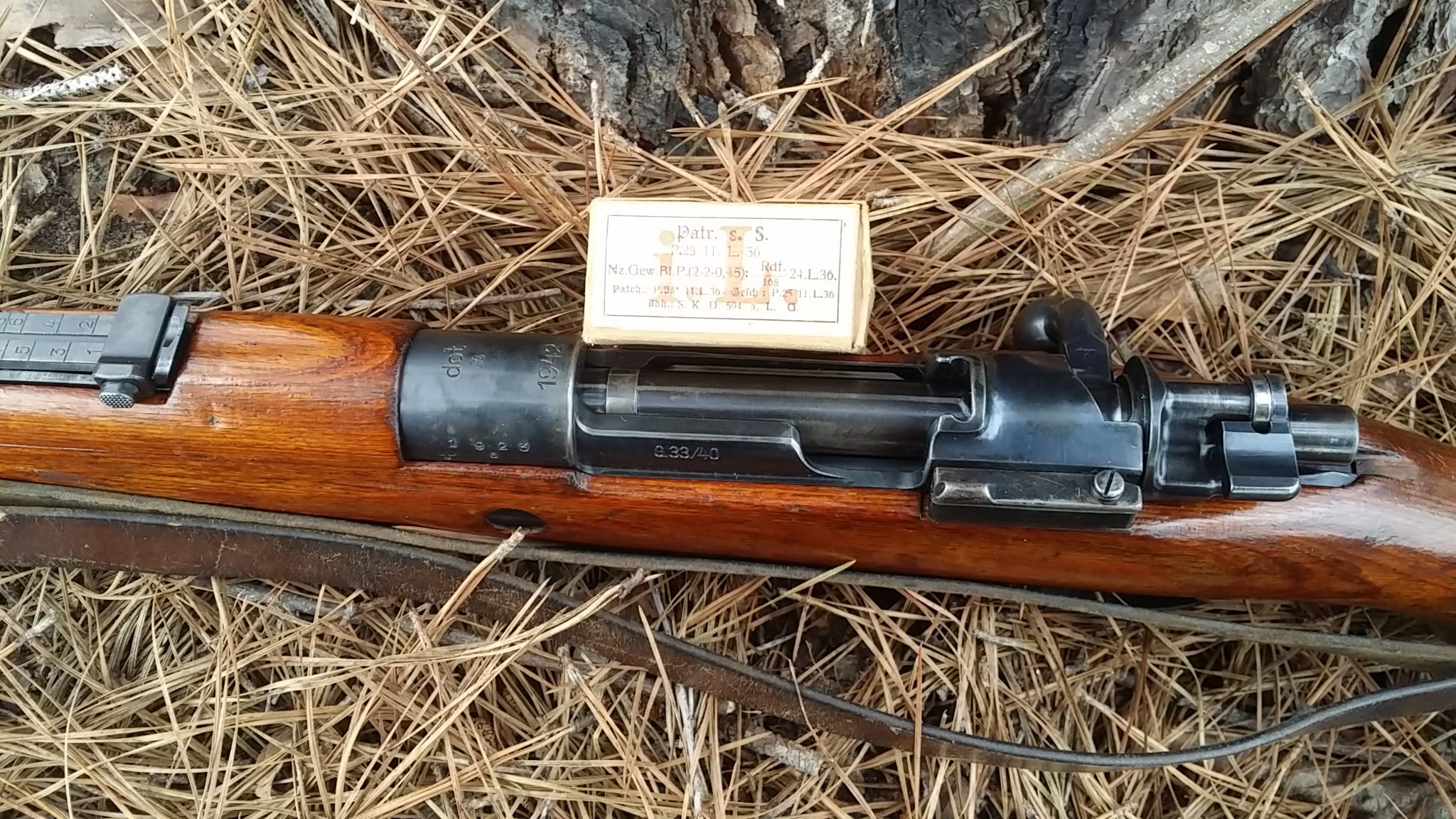

I did rebuild a WW2 K98k. New barrel and chambered it in 7.92x33mm (8Kurz). Shortened the mag follower on the back end and put a filler block in the backend of the mag well as well. Worked like a million bucks. I know this is totally getting away from what the OP is looking to do but they’re are options.

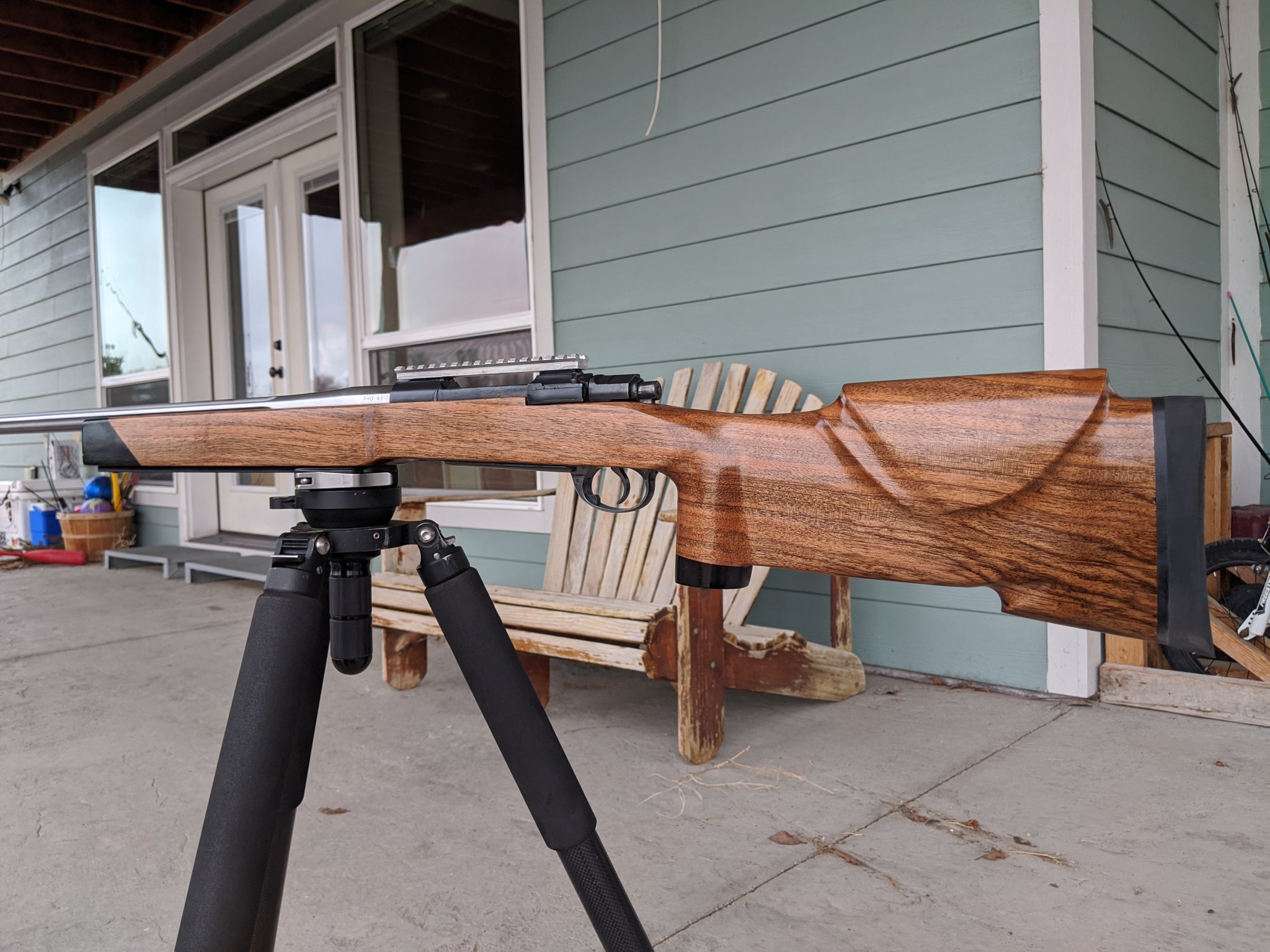

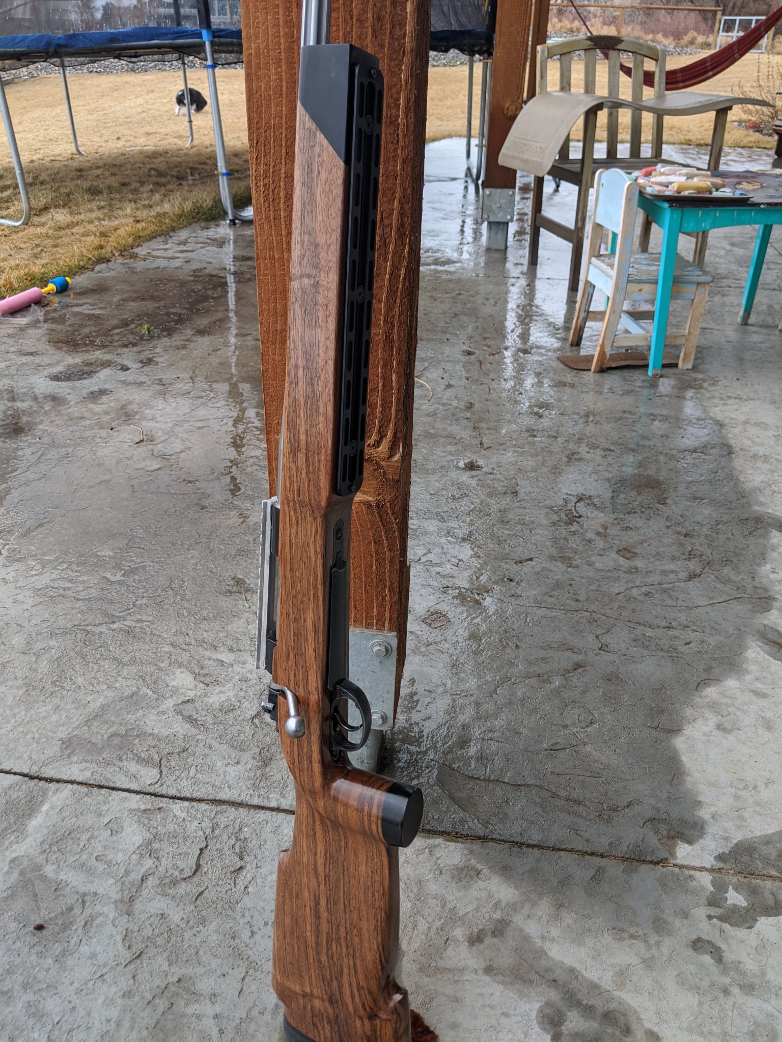

As I posted recently in another thread, I built a M98 (VZ.24) into a 7mmRM a couple years back and it is a fantastic shooter.
I had a local smith do the machine work that I couldn't and he was amazing. I purchased a short chambered Shilen and brought that to him. He cleaned up the action, trued the receiver face, cleaned the action threads, re-faced the bolt for the larger case head of the 7mag, opened up the feed rails, fitted a turned bolt handle and threaded and timed the muzzle for my brake and fitted a PTG 20moa base I supplied.
I did the stock work on it, including opening up the barrel channel, pillar bedding the rear action screw and ultimately bedding the action to the stock.
Overall, I couldn't be happier with the results. With both Hornady Precision hunter in 162gr and my handloads with Nosler brass and 162gr ELD-X projectiles, Im getting a consistent half MOA.
Total investment is right around $1,100-$1,300, including the original purchase of the rifle ($108 back in 1999). I think I got my moneys worth at this point.
