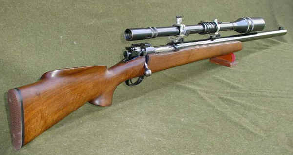

I know its a 1903 not a Mauser, but still, you just dont get beauty like this with a Remington or Howa.. and with proper bedding, truing, and a big truck axle Douglas barrel, I dare say it'll shoot up to snuff as well..
