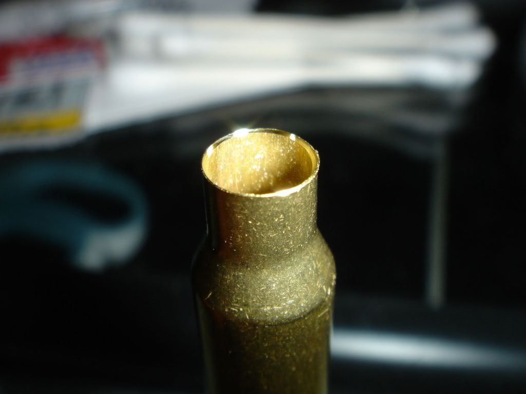

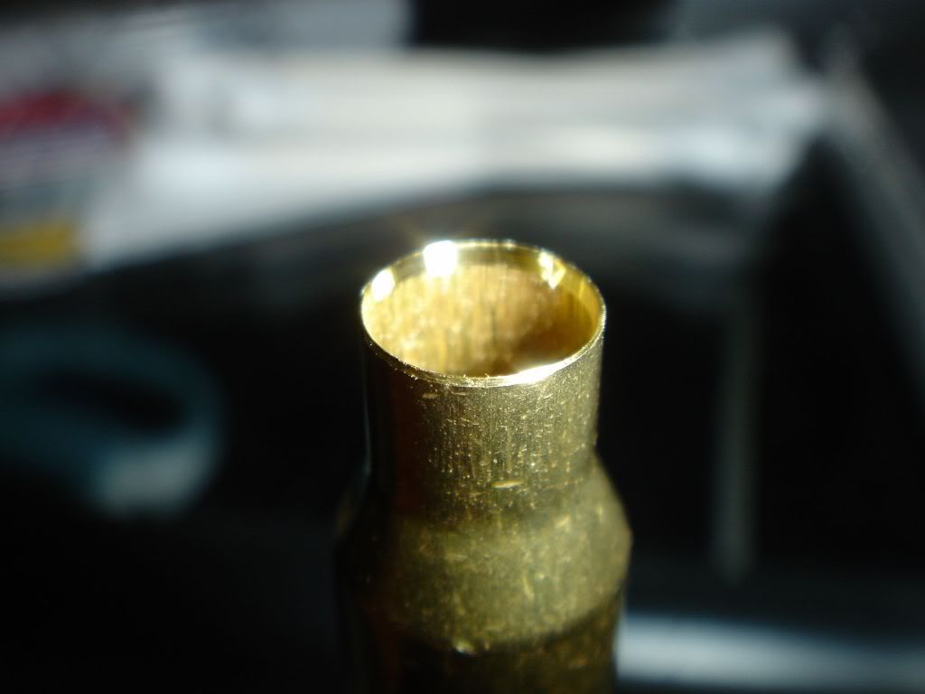

does anyone have problems with the Giraud not trimming evenly around the casemouth even after turning the case around? I have this problem and Doug thought it might be because of my decapping rod not being center and pulled the case mouth off to the side. I replaced the decapping rod to a new unit with a carbide button and is still having this problem. I have not tried on a different press yet. If you have this problem and has corrected please share your experience. Thanks.

<div class="ubbcode-block"><div class="ubbcode-header">Originally Posted By: turbohardtop</div><div class="ubbcode-body">does anyone have problems with the Giraud not trimming evenly around the casemouth even after turning the case around? I have this problem and Doug thought it might be because of my decapping rod not being center and pulled the case mouth off to the side. I replaced the decapping rod to a new unit with a carbide button and is still having this problem. I have not tried on a different press yet. If you have this problem and has corrected please share your experience. Thanks. </div></div>
Here's how about 70% of the cases turn out, this is the same piece of brass showing the chamfer on one side and the opposite. I always turn the case and it doesn't make any noticeable difference. One side has about double to triple the chamfer as the other. Does it really matter though? The bullet should orient itself based on the neck below the chamfer, so I don't think it's a big deal but I suspect that is causing the vibration/grip problems I'm having. This was mostly LC 07 brass, I need to try some lapua and see if the neck thickness and concentricity is better and if that makes a difference.

If you are not dragging an expander ball through the neck, then you are most probably using a neck bushing die set. Is your bushing nice and tight in the die body or floating to self center? If it is locked down tight in the die body, it is probably not concentric with the die body. If it is just barely loose, it can self center on the case as it enters.
Also, double triple and quadruple check that the case holder is clean inside. If there are chips sticking to the side, it will cause the same thing.
