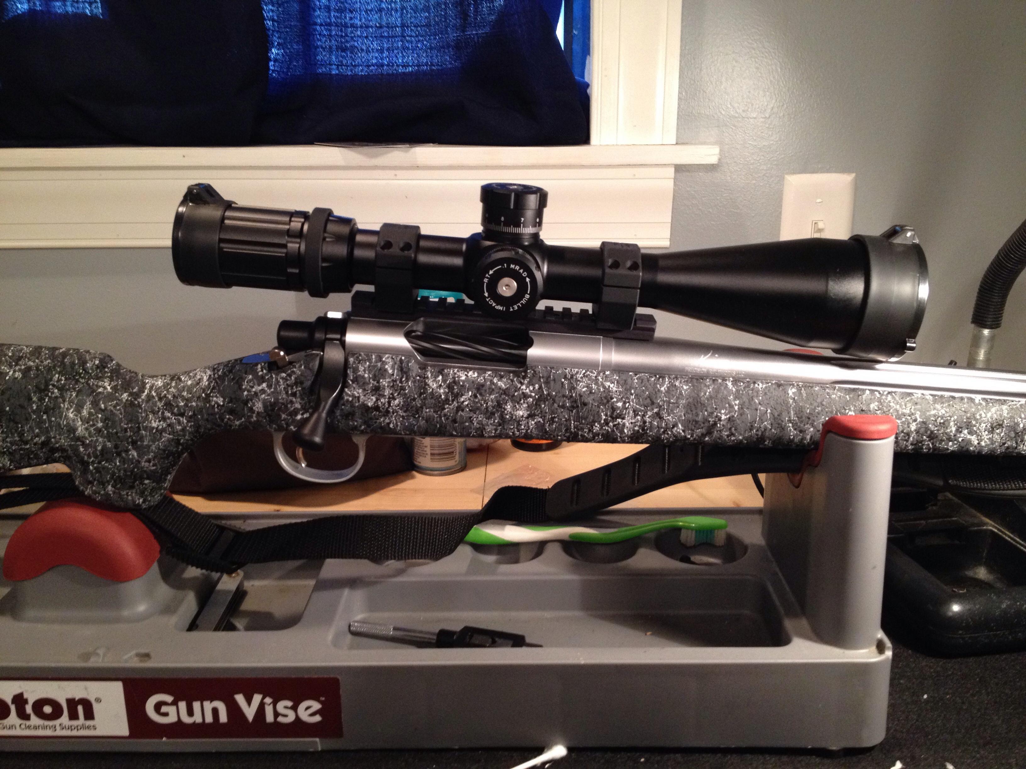

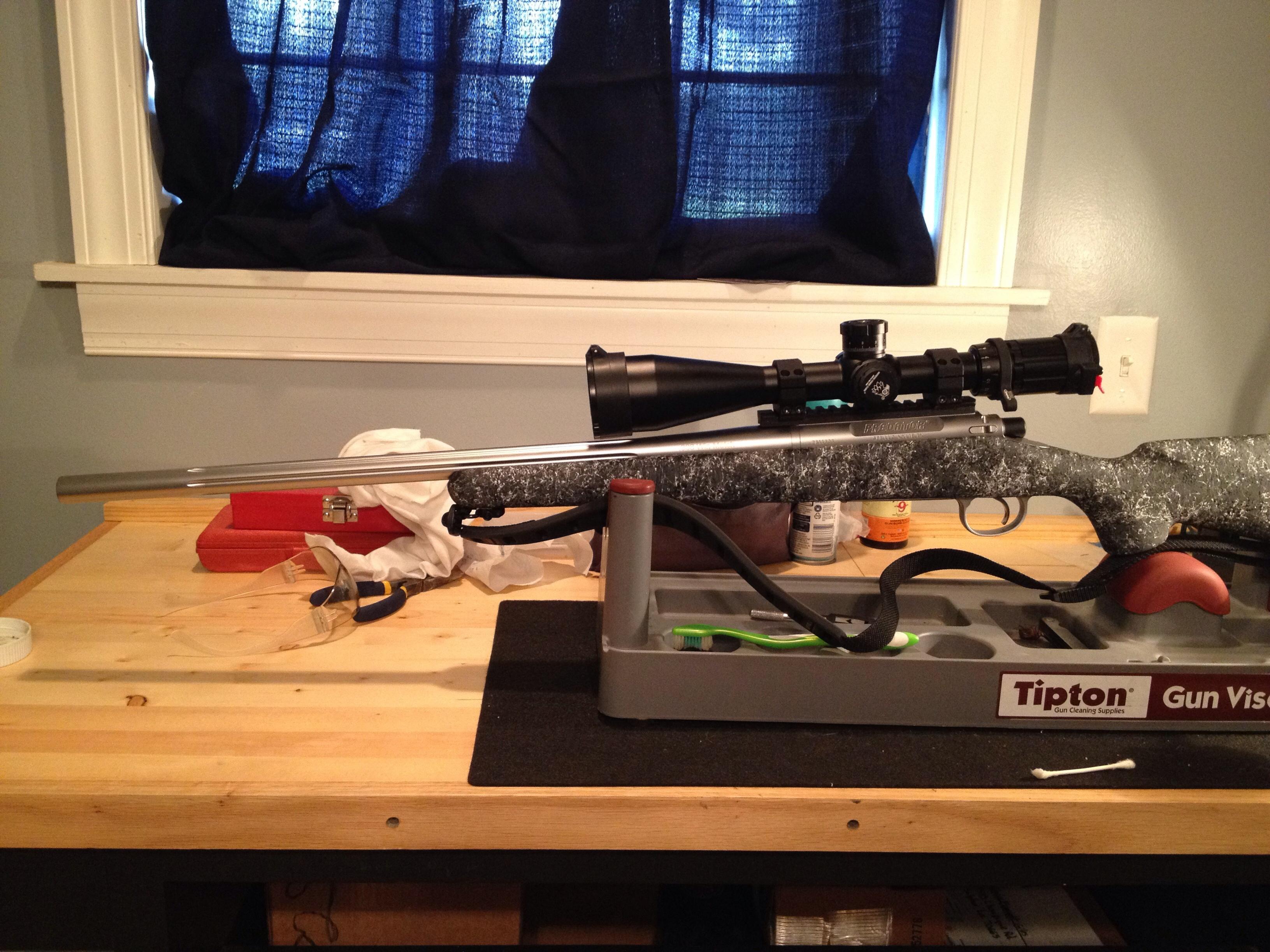

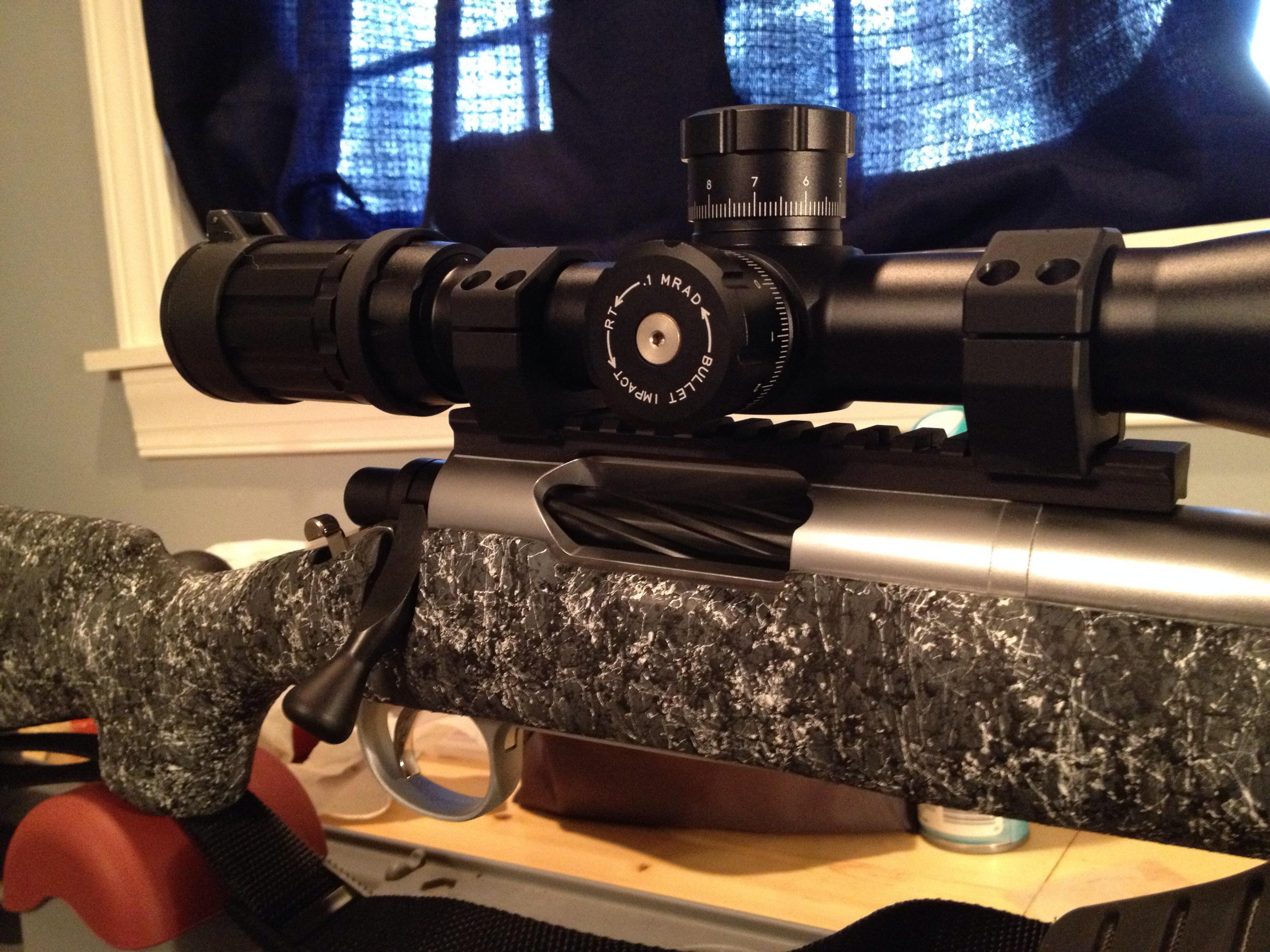

Thanks bhoges. I ordered the #10 to try. I will test it on a few scrap pieces of stainless first, but I think it will work out. I would imagine anything between #9-#12 would be fine. You don't happen to have or can take a pic of the finish you have with the #10 media? Thanks again.
Blasted my barreled action with #10 (100-170 grit). Came out awesome. Just for reference to others, you may want to sand out and scratches before hand. My test material had light scratches and they were still visible after blasting.
About 2 hours of hand sanding with 400 grit and it was ready. I'm pleased with the results. Thanks for the info.
Got it all blasted and assembled. Came out awesome to me. Couldn't be happier with the finish!
Thanks for all the help choosing the media.
