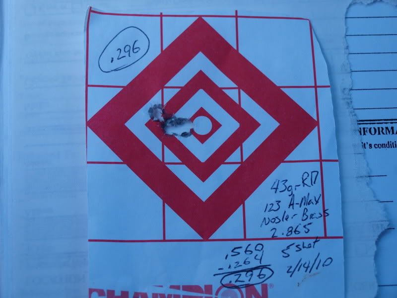

Working up a load using new bullet and new powder at the same time can suck at times. Other time you get lucky. Trying out a new bullet, Hornady 123gr and new powder, R17, in my Savage 260. Working up in .5gr steps it started at around .75in and got down to .296 at 43gr. Opened back up over that so I'm thinking 43gr is where I'll stay. Have not been able to chronograph it yet but should be 2850 or so, I hope. Any who another plug for Kevin at Stockade is in order. Yay for Kevin!

Sorry, I forgot to put that in. All I use anymore are CCI BR2 primers for large rifle stuff so I don't usually take the time to write it down. I want to try some of the Wolf primers but haven't been able to get my hand on any as of yet.

Just got back from the range. Avg. velocity is 2890 for a 50 round string. Haven't done all the mth and probably won't. 74fps spread high to low over a 50 shot string works for me. I think that some of that had to do with my son "helping" me while I was measuring charges. If I throw out the high and low the extreme spread is 34 fps. Guess I need to be more carefull while loading. Anywho looks like a keeper.
