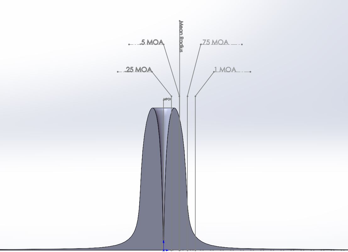

So in short, what you are saying is, if I had shot the same bullet (theoretically) through each target, 100yrd, 400yrd, and 1000yrd, I would have had the same group size. But somehow, luck of the draw, my 400yrd shots were on the outside of the bell curve?Here's a 3D representation of the probability distribution of the shots from a 100-shot sample. Basically the total volume of the solid (cut in half here) is 100% of the shots, and as you slide radially you can enclose more or less of the probability a single particular shot will land within said radius/diameter (whatever reference frame you want to use, you can look at it purely radially in 2D and ignore the revolved volume).
The distribution is very similar to a normal distribution with the exception that you cannot have a negative radius for a given shot. What would be a "negative radius" shot just pops out as a positive radius on the other side of the MPOI. The mean radius isn't far enough away from the MPOI, and the bell curve tails cross over the MPOI (this is more and more true the better the dispersion is). So if you could imagine where ever the tail crosses the MPOI, the effective distribution % remaining flips back over the MPOI and skews the peak of the curve inwards towards the MPOI.
Assuming a circular group (generally true)... Functionally, your radius of any given shot is a random event and follows a (mostly) normal distribution. If you think you can define the PDF at various ranges with 3 or 4 4-shot groups, I've got bad news for you.
Almost all of the discussion regarding groups shrinking and growing and shrinking over distance are accompanied by several small DIFFERENT groups being fired at different ranges. They are not the same group. The group you shot at 100yd is not the same group you shot at 1000yd. Neither is big enough to be a predictive tool for dispersion, and both likely fall well within the bounds of the total probability density function that encompasses a larger radius than you believe your equipment is capable of.
When you fire the same group at various ranges with Shot Marker systems or paper at two distances, you see pretty much linear scaling until the point external forces (wind, MV spread, BC variation, etc.) take over. There are some variations from this that I'd like to investigate further (individual bullet dynamic behavior), but in general we've never seen any system produce 1 MOA at 100yd then 1/2 MOA at 500yd or anything like that.
There are people (mysteriously) who are genius in every aspect of life ... except probabilityHere's a 3D representation of the probability distribution of the shots from a 100-shot sample.
