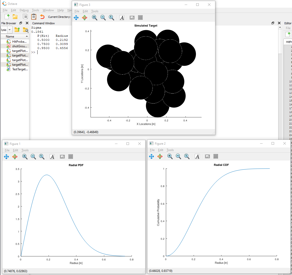

Just a thought: I've been screwing around in MATLAB with different ways to manipulate dispersion data in similar ways to what you're suggesting. If you assume your coordinates are normal and IID in the x and y axes then you can describe the distribution of radii using a Rayleigh distribution. You can develop that directly from your SD/variance only and then use the Rayleigh CDF to spit out your hit probabilities.
Thorough derailing of the thread, but I got curious. Knocked together some quick code that can do what I mentioned above. I generate some phony shot group data, calculate the sample standard deviation and feed it into the Rayleigh. I can get predicted group radii for given hit probabilities, or just output the graphs. Is that similar to what you had in mind @Ledzep ? I'd be curious to see how close to normal your large sample data is.

The large sample stuff definitely matches the Rayleigh better than normal, but normal is not incredibly far off. A year or two back myself and Jayden tried to get Excel to do a Rayleigh or skew a normal distribution to fit real data but couldn't figure it out and got distracted with other stuff. I'm going to pursue a MatLab seat this week. We've been talking about getting it for a while-- we've been pushing the limits of what Excel can provide for a few years now lol...
For example, you can use a normal distribution, take the mean radius + 2 SD's (SD in this reference is SD of individual shot radii) in either direction (double that) and approximate 20-shot average group sizes pretty accurately. I need to dig into the Rayleigh again to see the difference in SD vs. normal.
Matlab is awesome, definitely recommend. You could also test drive it with Octave (which is free) and if you decided to spring for a Matlab license most of your code would port straight over.
If you'd mostly be doing it for stats purposes R is also free, and I recently discovered a pretty robust dispersion analysis package for it (shotGroups).
