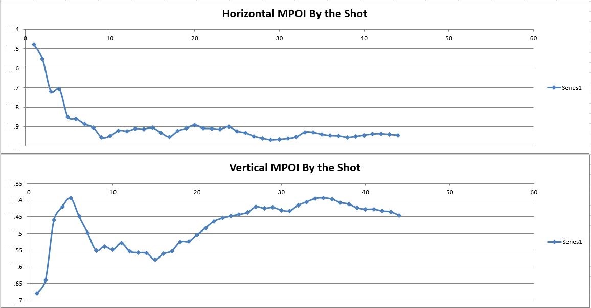

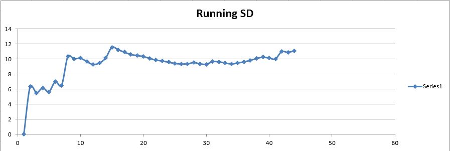

Here's some SD-by-the-shot action. Notice that at 5 shots I'd believe I had 6fps SD, but the long term actual SD is closer to 11fps. At the 5-shot mark this can go either way. It can be horrible (15+) and level out to normal, it can be right on the long term average, or it can be below the long term average. Moral of the story is that they ALL level out at 20-30 shots into the test.

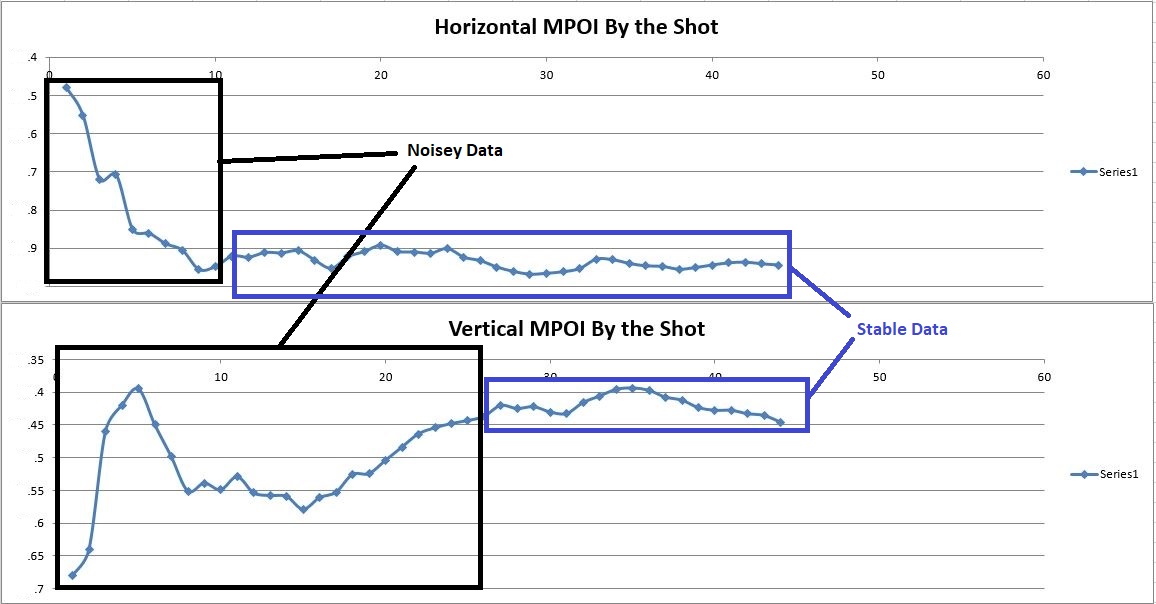

And here's MPOI vs. shot count for horizontal and vertical position. The numbers on the left side are in inches (for scale) but are just from a reference location on the target. Again, this typically settles out about 20-30 rounds in, and is moving around quite a bit for the first 5-15 shots. Things to think about the next time you re-zero based off of a 3 or 5 shot group, then encounter a tenth or two of error between real life and your calculator at range.
As the barrel fouls velocity increases and vertical POI does seem to shift. I did see a loose trend between MV and vertical POI across tests, which is nothing mind blowing.

They are running numbers. The SD graph shows the SD at 2 shots, 3, 4, 5, 6, 7, .... 45, 46, etc... Basically if I took the SD of the total number of shots to that point.
The other graphs show a running average of point of impact, horizontal and vertical.
At 5 shots, had you stopped there, your chrono would tell you that you had a 6fps SD, and your 'zero' would be .1" left and .025" or so high from the long term actual zero.
At 10 shots, had you stopped there, your chrono would tell you that you had 10fps SD, good horizontal, and .125" vertical shift from long term actual.
This is one set of data. I was briefly going through it earlier and there was one that moved over 0.3" from 5 shots in. Some settle down in 5 shots. Some are stable across the board, some settle down at 30 shots. The point is that you DONT KNOW IF WHAT YOU HAVE IS STABLE IF ITS NOT A STATISTICALLY SIGNIFICANT SAMPLE SIZE.
They almost all do this one one form or another:

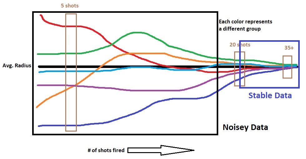

What I'm getting at is that you need to shoot 20 shots minimum (like rock fucking bottom minimum) to have a good chance of being past the noisey data and into the stable data. It still wanders around a little bit, but the changes are much more gradual and much smaller at that point. Like .05" shift or less instead of .1-.3".
Again,

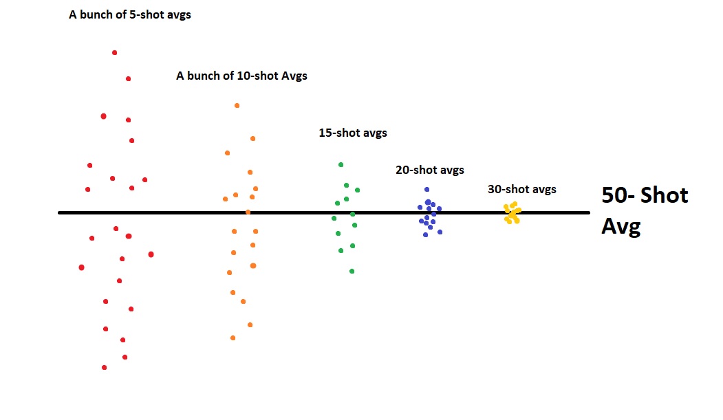

Here's another way to look at it. If I take a large sample size (100+ rounds) and I shoot them in a shit load of 5 shot groups, then repeat the exact same test with a bunch of 10 shot groups, then a bunch of 15-shot groups, then a few 20 shot groups, then a couple 30 shot groups, and compare it to the average of a couple 50-shot groups, this is what it would look like:

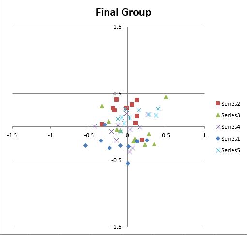

So you tell me when you shot a single, or 2, or 3, or 4, 5-shot groups... which one(s) of the red dots you were given by the gods of randomness.
ETA: Now, if you shoot 6-10 5-shot groups, and record a common reference (same POA, for example, and overlay all of the individual groups into 1 composite), you'll find that the total average of those compiled 5-shot averages will (nearly) equal the same thing as the 50 shot average. That is fine, you have real data. But a few 5-shotters here and there, and "hmm must've pulled that one" data discards, with no common reference, means almost nothing from a real statistical analysis point of view.

The biggest new tool I have is discovering that most of the time the standard deviation of the radii of the shots form (more or less) a normal distribution centered on the mean radius. This has led to pretty remarkably accurate predictions of total dispersion, which has in turn led to a much better level of understanding and observation of things like hit % on KYL rack plates.
Also my skills in Excel are much better!
ETA: A barrel tuner is on the list of things I want to play with. Inherently I tend to believe that messing with mode shapes can dampen barrel whip that I assume is what (in part, at least) causes the dispersion.

Maybe this is a silly thought, but isn't a group with a higher number of shots more likely to be affected environmental variables that have nothing to do with the gun's mechanical accuracy but will lower perceived accuracy? 50 shots have 10x as much chance for changes in wind, barrel temp change, shooter error, etc...
While I don't doubt that more rounds=increased group size due to probability, I also think that in the real world, more rounds=increased group size due to uncontrollable factors. And in the real world, I'm not sure how you'd separate those at a certain point.
There's actually a whole field called "design of experiments" aka DoE, parts of which deals with exactly this. It *could* have some interesting applications in developing (and periodically validating) 'robust' loads... but considering that most reloaders run screaming from any math more complex than ES... and most of the rest of us are more interested in shooting than testing... it's not happening any time soon.
The simplified version is "randomize what you can, and block what you can't".
