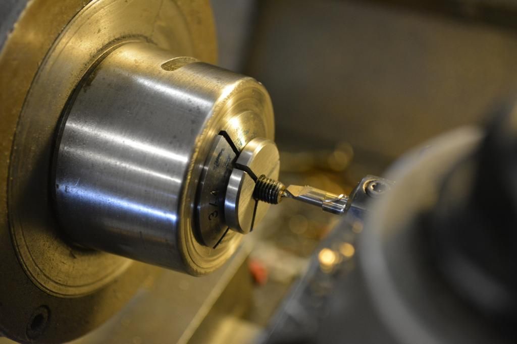

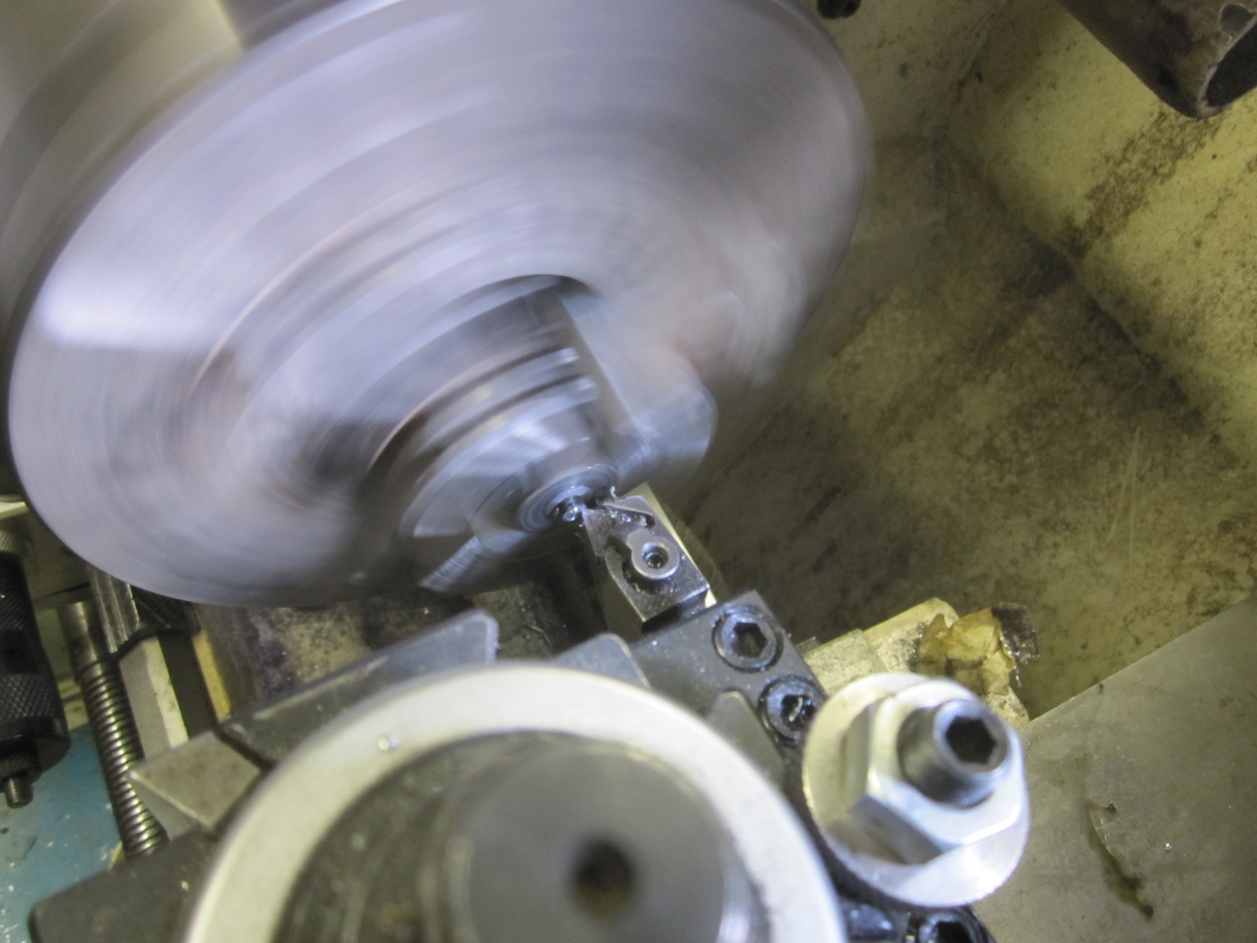

    Fitting guard screws is a deceptively simple process. While some are satisfied with blasting a screw against a grinding wheel or belt sander, others look for an alternative.

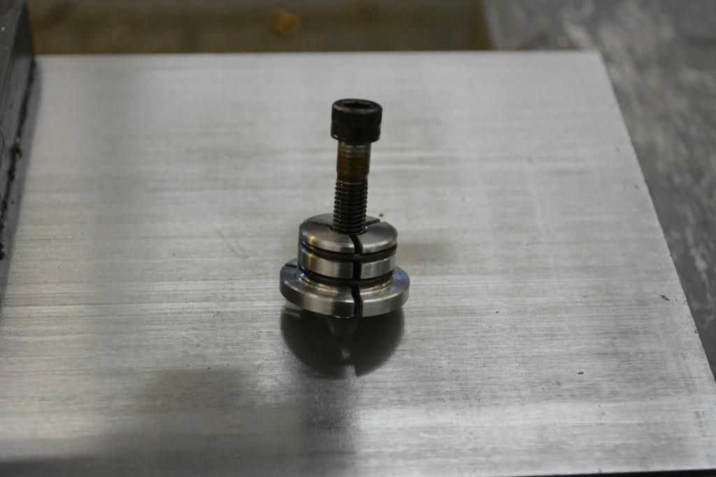

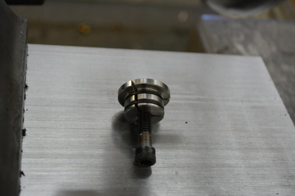

    I've made a collet setup that captivates the body of the screw without mashing the threads or having to slide the screw from the rear of a 1/4" 5C collet. This is the latest revision as the previous version had a portion of the O ring exposed above the body that always caught on the inside of the 1" collet.
    Tools like this really go a long way towards making stupid jobs quick/dirty and clean. Screw leads are square to the body and the thread chamfer can be easily restored so that the end user doesn't have fits putting his rifle together.

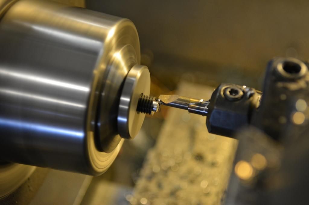

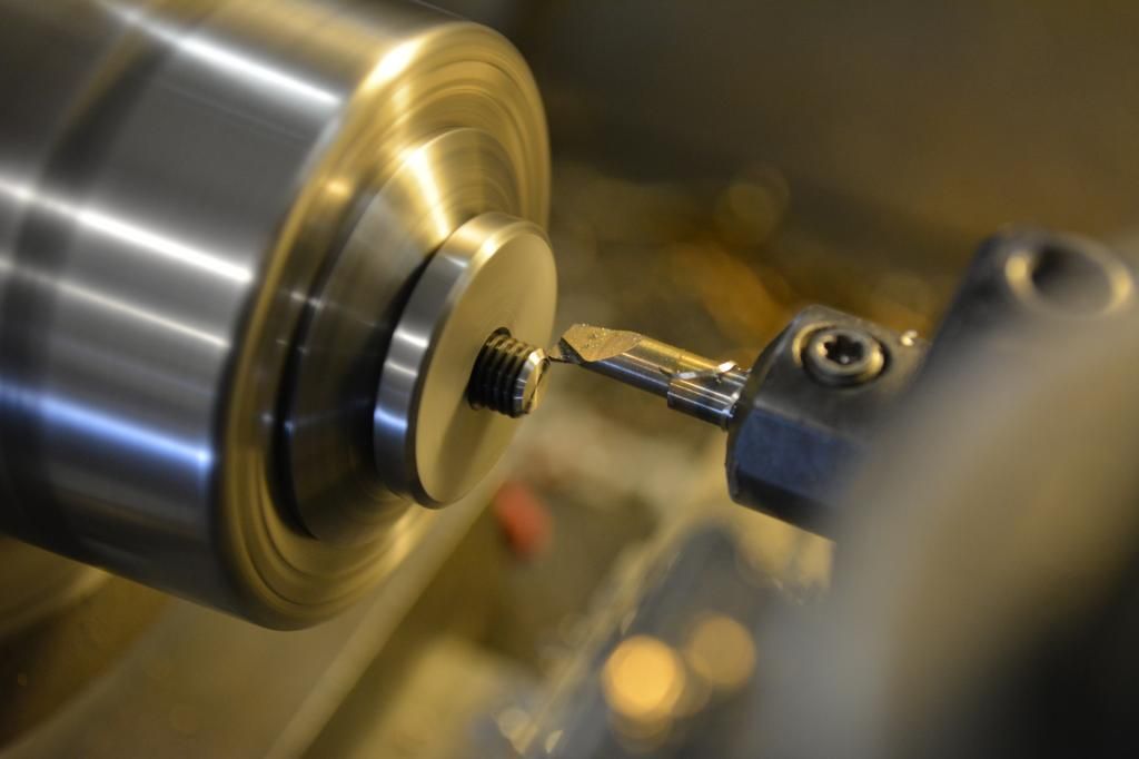

    I like using a boring bar to trim these screws. Running the spindle in reverse puts the cutter on the backside so that in one setup I can face the screw and chamfer. If you choose to do it this way, just make sure your tool's on center and your don't go too far past spindle center. The little boring bar inserts I'm using won't tolerate it well. They'll chip at the lead edge of the cutting surface if you mistakenly load them the wrong way. At $47 bucks a piece you can hemorrhage the VISA card pretty quick if your not careful.
    Maybe it'll help out a guy down the road somewhere.
    Enjoy.
    C.
    Guard screws chuck up nicely in a 3/8 or 1/2 Jacobs chuck too. The allen head fits behind the jaws nicely. It takes a non-trivial amount of time for me to set up the 5C drawbar and closer, but I only have to remove the chuck to pop in a Jacobs on a MT3 mandrel (plus the South Bend adapter). True about munging up the threads if you clamp that Jacobs too tight though.
    And here I was, using split nuts to hold screws into a 3 jaw chuck... :)
    Seriously, nice set up! :)
    Out of curiosity, do you have something akin to a case shoulder gauge to set up the depth of the screw into the collet? Seems like that'd be a really quick & fairly precise way to set up the depth, with the flange (of the work piece collet) pressed into the collet in the head stock...
    I make it simple; i take a piece of aluminum round stock, drill a hole through it the size of the screw and split it. It goes in the three jaw and I use a parting tool to shorten it. Five minute job or less.

    I do it like this:
    Run the screw in the gun to assemble it. Attempt to close the bolt. Back the screw out and count the rotations till the bolt drops. Go an extra 1/2 rev from that. Take the # of rotations X's the pitch and that's how much you trim. A 28 pitch is .0357"
    Same for the rear.
    On blind holes I just chip away will I get it.
    Whole point of this tool for us is that I have a tool room lathe (Hardinge) that's never had a scroll chuck on it. So, swapping a collet and using this is quick work. If your stuck with one lathe, this may/may not be the best solution for you although I used a 3 jaw for years to do this stuff.
    Aluminum will certainly work, but this is a tool I only wanted to make once. So, it's out of O-1. This way I don't ever have to worry about cross contamination of aluminum/steel when bluing parts. (AL bad ju ju for salts)
    C.

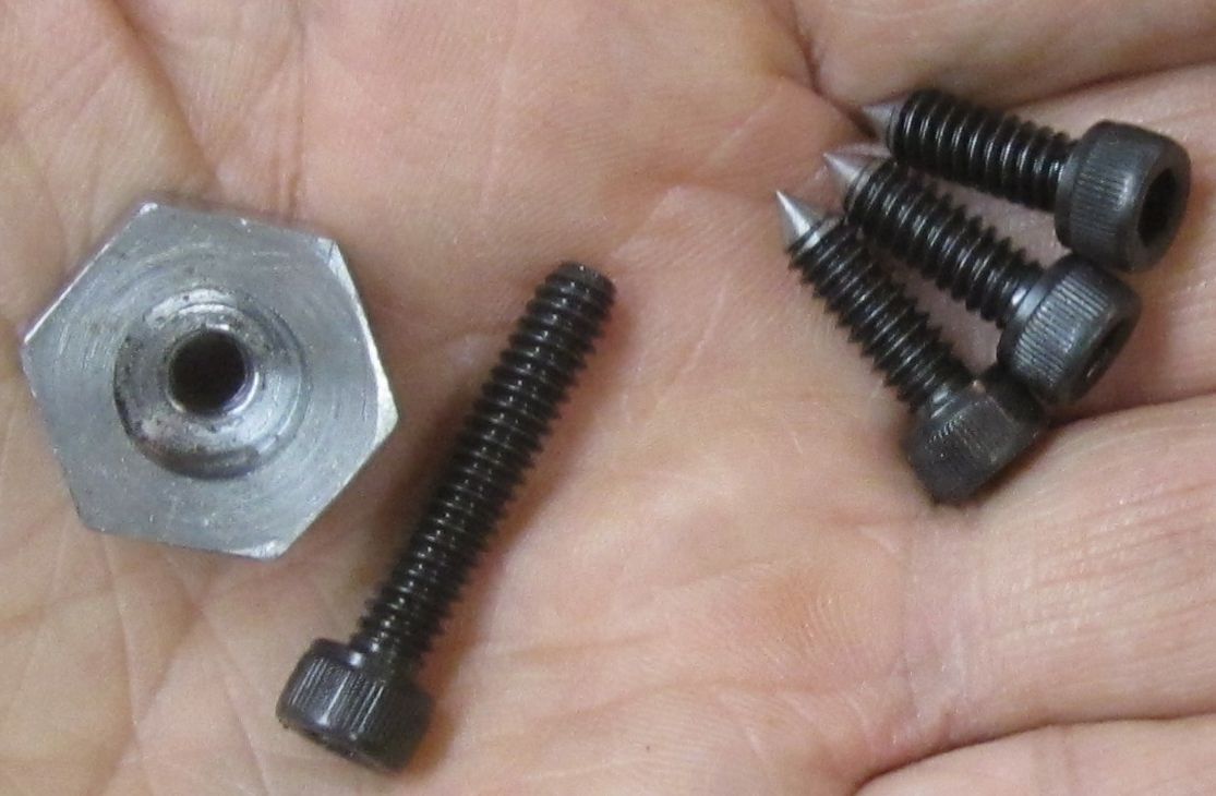

    When modifying 10-32 attachment screws for the co-ax press shell holder jaw housing for faster centering during jaw end swapping, I did not have a collet. So I screwed them into a threaded hole in some hex steel and ran the lathe backwards so they would not unscrew while cutting.
