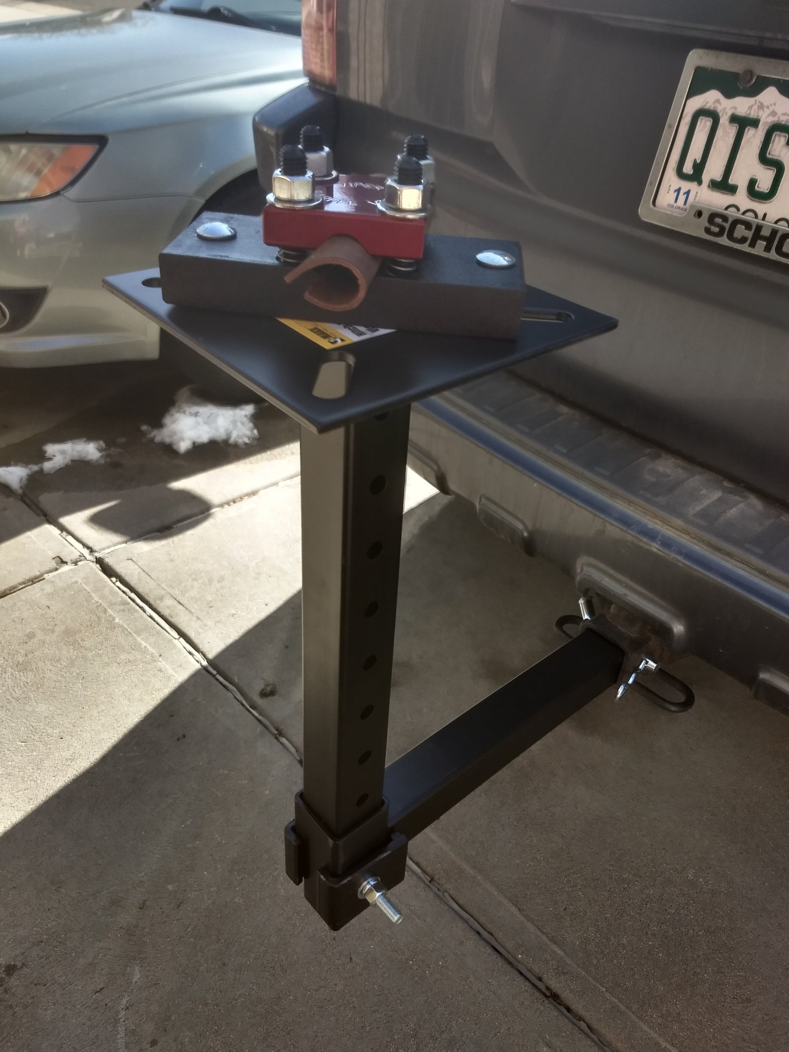

I think I’m just going stop letting my garage situation box me in, do it all myself, and just buy:
1) this trailer hitch vise mount (thx @DeathBeforeDismount)
2) the modular SAC barrel vise (or maybe the beefy LRI one)
3) the Wheeler #1 external action wrench and flip one part over to fit the flat sides of the Tikka receiver
4) and an internal Tikka action wrench (SAC, Bugholes) to install the new barrel
5) some USA made go/no-go gauges for peace of mind, knowing that every manufacturer’s gauges are going to dimensionally vary a little, even from each piece to piece

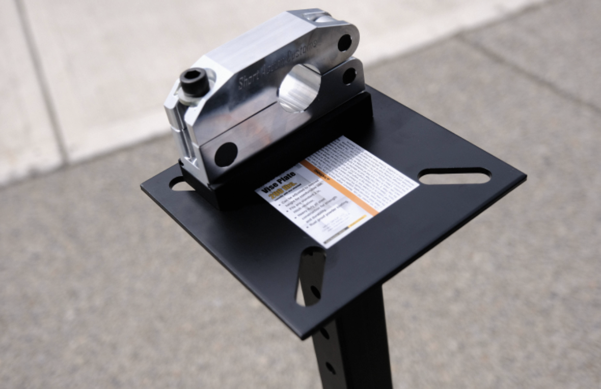

I did a write up on this. It's way easier than what most people make it out to be. Not sure where you live but if you're in southern Idaho I'd be happy to pull your barrel for you I've done about a dozen now and it only takes a few minutes. Everything I've done has headspaced within a couple thousandths.
I bolted my barrel vise to a two by four. I wrap the barrel in an old toilet paper tube trimmed to fit one lap around the barrel and then tighten the barrel vise bolts.
I stand on one end and slide the other end under a ledge on my gun safe. Insert the action wrench into the action, attach a 3/8” socket to the wrench, clip my torque wrench to that.
Slide an old iron pipe over the torque wrench, give it a good pull ensuring the far end of the board is under the safe, and I’m standing on the board, and the barrel breaks free.
Reverse to install ensuring I coat the barrel threads with automotive anti sieze, and set the torque wrench to 50 ft-lbs.

You don’t need a garage. I use two C clamps to clamp my barrel vise down to a counter / table / bench when I need to use it.
Yeah, unless I use our wobbly antique kitchen table or granite kitchen countertops I don’t have a bench, man. And I’d be a dead man if I use either lol.
