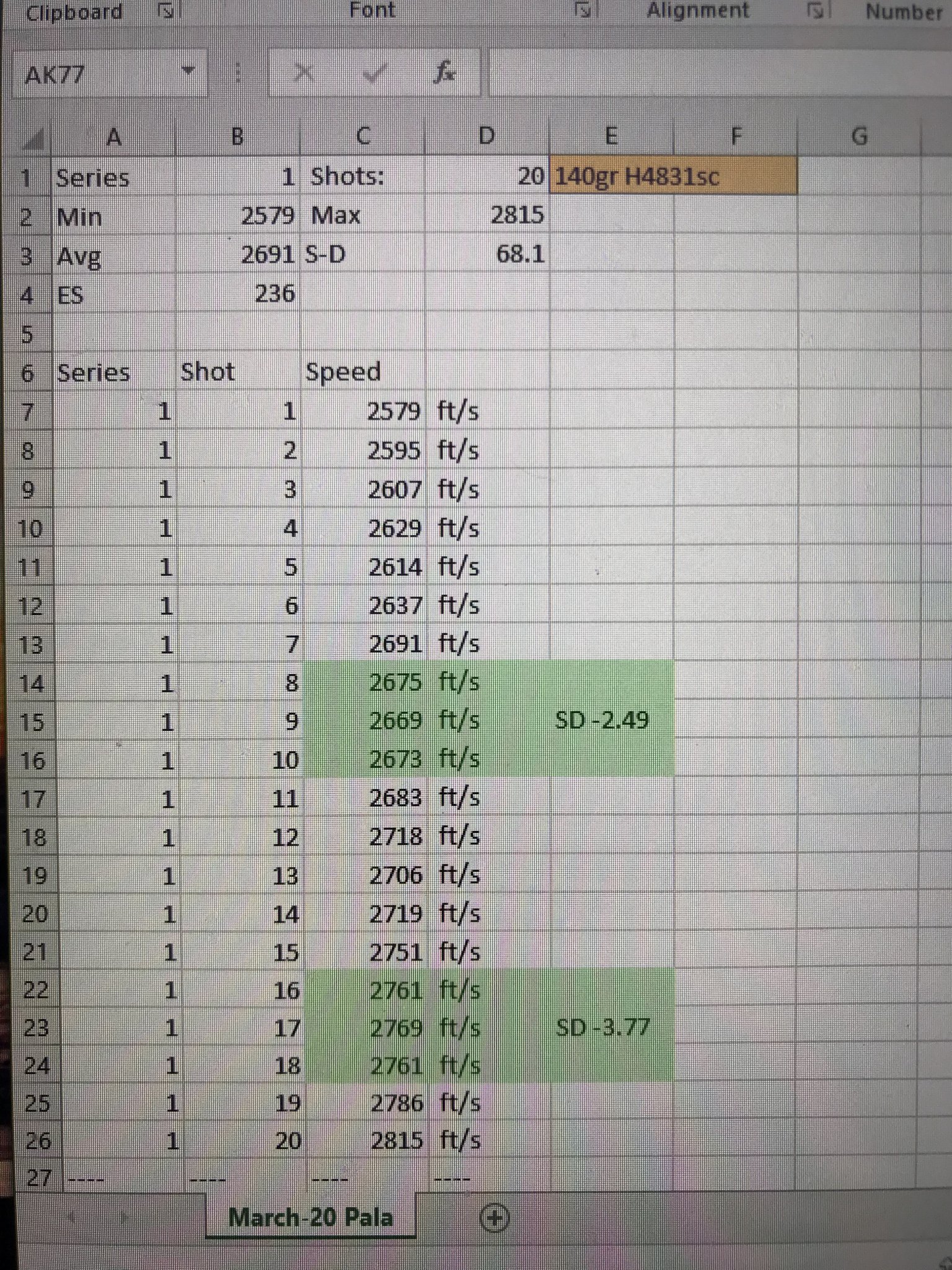

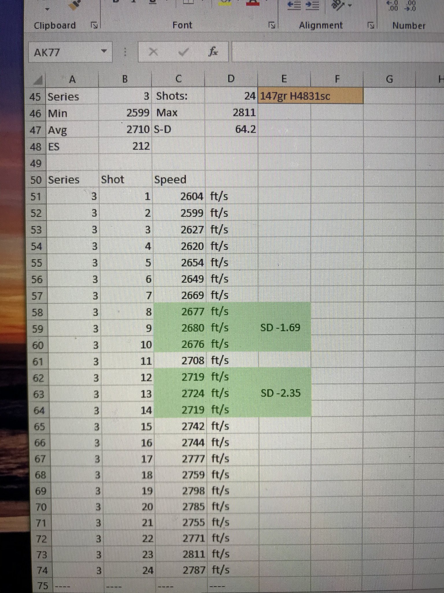

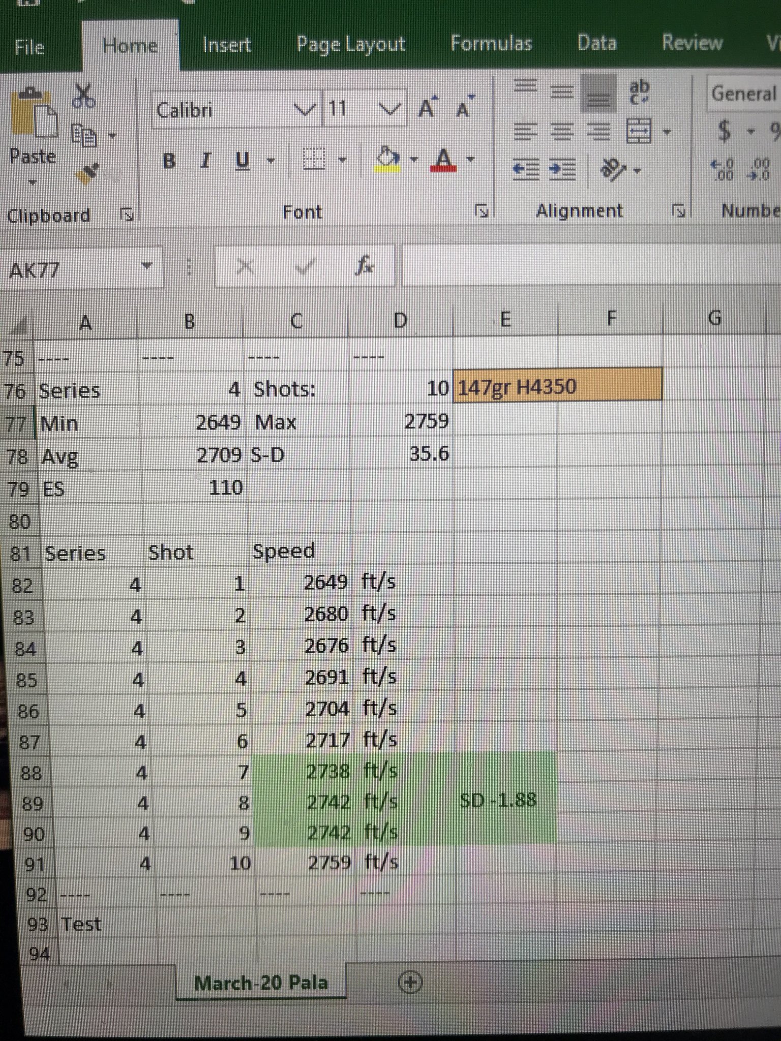

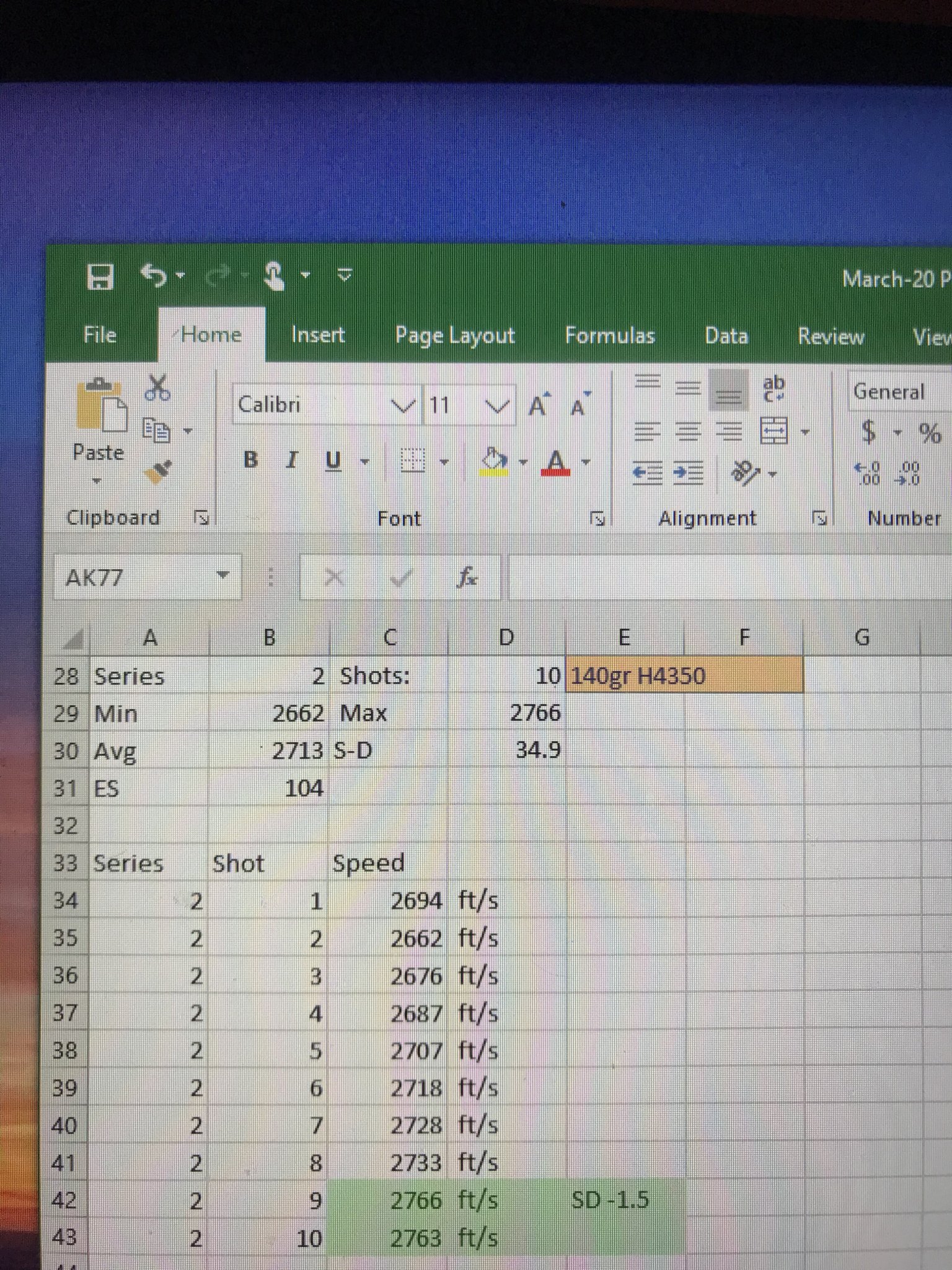

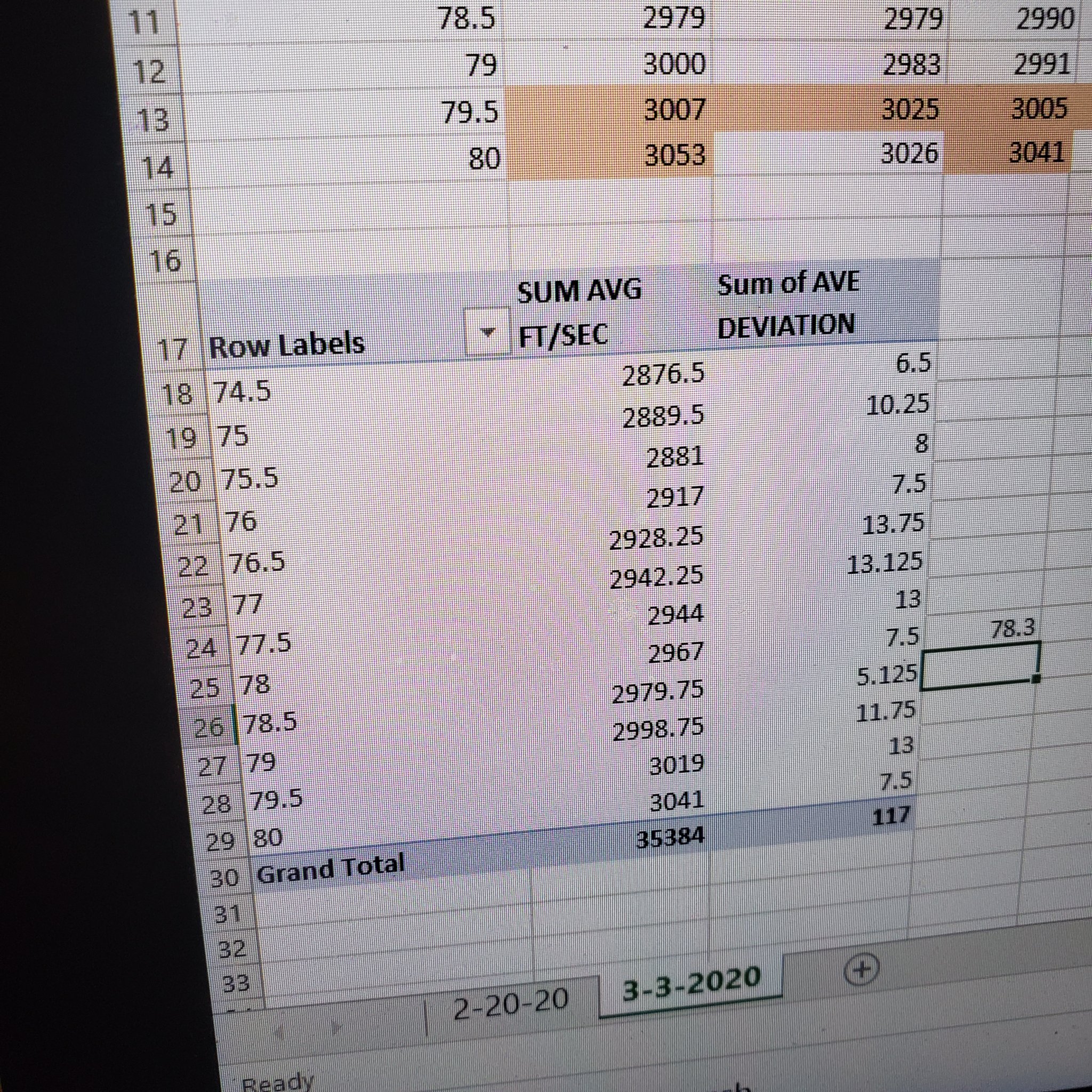

Rather new to reloading but I gathered this data a couple weeks ago. More work to do...
Reactions: rbazinet
I'm new too. Been reloading and shooting nice groups from 3 different calibers, many .25moa. I've always set my FL dies by running them down till they make contact, then one more turn downward. The shoulder bumping is taking place then, right? Thanx for a great thread!

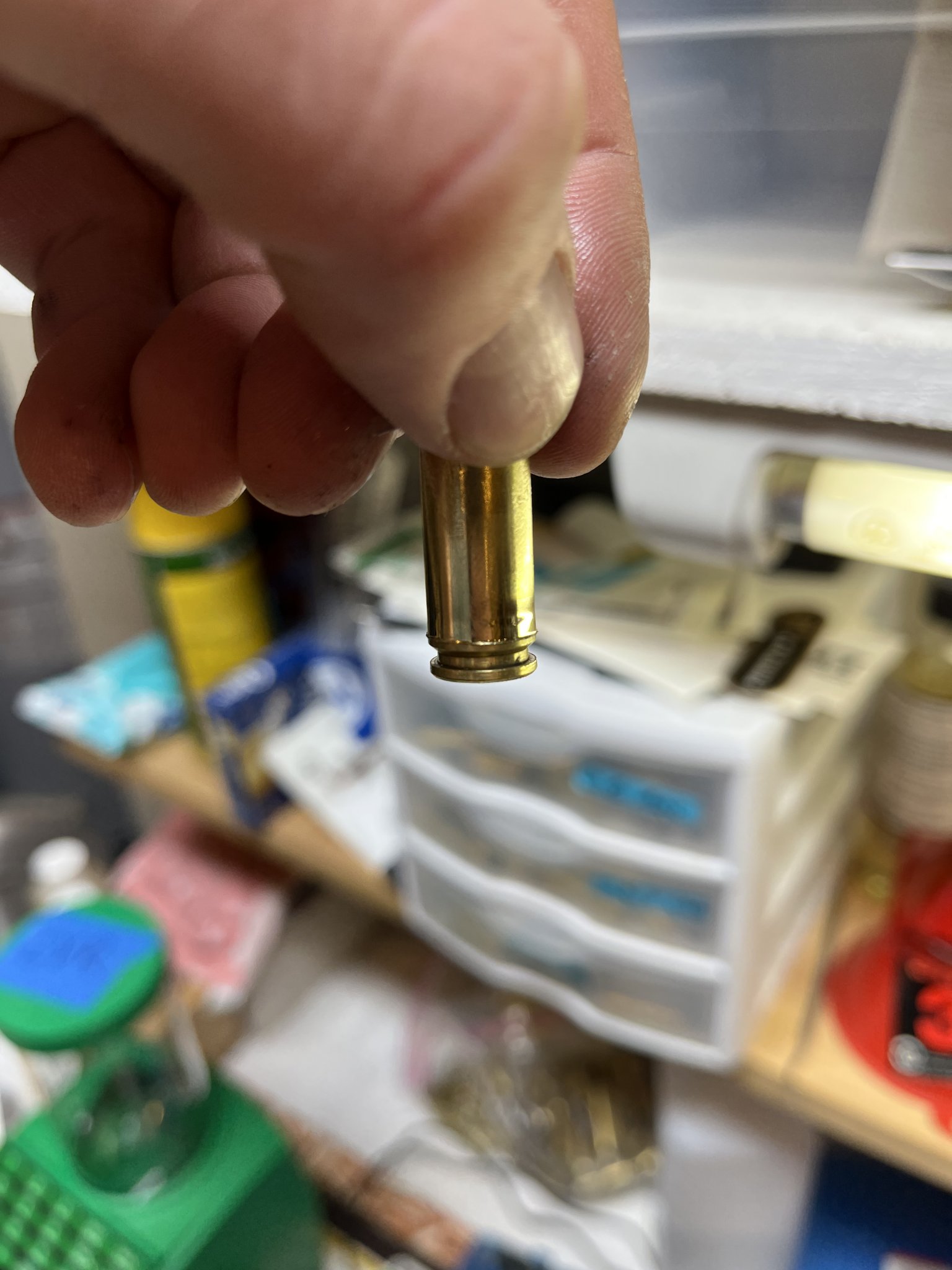

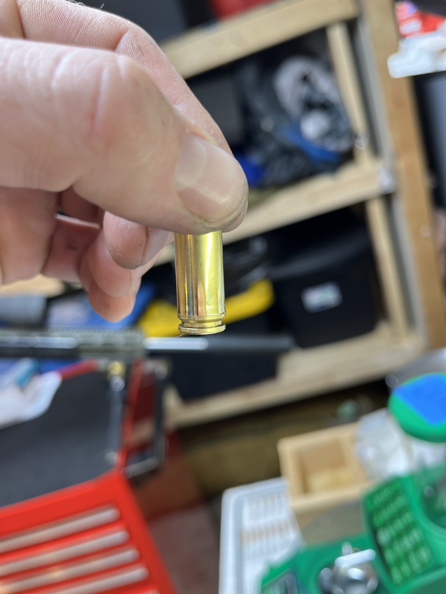

Trying to find the best place to post this question. Recently on my 6ARC gasser, when sizing, about 30% of the cases are extremely difficult and result in the brass being, lack of a better word, skinned just about the case head. The result is a 6ARC that looks like it has a belt. I have not narrowed down wether this is just from the factory ammo or my 1x/2x brass, but have not had this issue when resizing Hornady 6.5G 1x fired to 6ARC.
Again, this is not apparent after firing, only when sizing operation occurs. I know Johnnys Reloading Bench posted a video about it, mine is similar. Just after sizing not firing.
I have been annealing hill billy style with a drill and a torch, so maybe my annealing is off? I’m going to try some without and see what the result is. I figured I’d ask all you smart fellers on here to get some help.
Also, 6ARC is a hammer and I love that thing. If there is a specific load thread and someone knows where it is, please post or message it to me.
Again, sorry if this is the wrong thread for this.

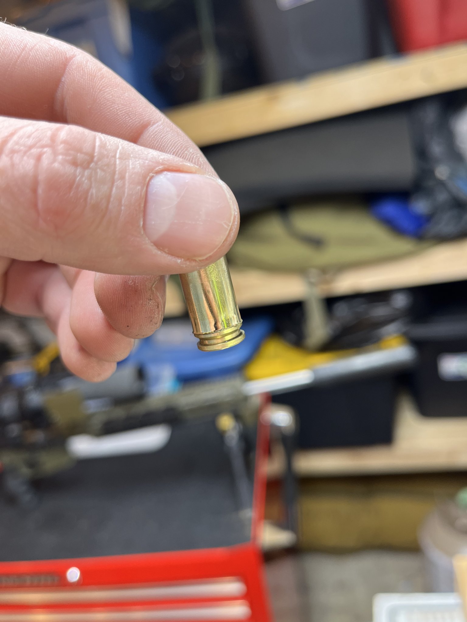

View attachment 7859780View attachment 7859781
What die are you using? That’s most likley the culprit.
FWIW the LE Wilson FL bushing die does not do this.
Hornady is .002-.003 smaller at base & will shave Lapua Grendel brass. RCBS small base is the worst.
The other 30ish were fine, silky smooth no issues
Look in the big 6ARC thread for load info. I posted about the die’s in there also.
Reactions: MidsouthHunter
Was using Hornady custom now using Hornady match with bushing and it’s worse. Just did 50 cases again this morning and 22 were destroyed/unusable.
This has been a known issue in the Grendel for a while, but guys are rediscovering it with the rising popularity of the ARC. The brass the the belts is likely toast. You'll hear lots of theories as to what causes the "Grendel Belted Magnum" but the gent who developed the Grendel, Bill Alexander, has said that they most often saw it in guns that were timed incorrectly and so unlocking too early with too much residual pressure in the bore.
There's a thread on the hide about it here link is to Bill's first post in the thread, as he's easily the most knowledgeable person posting in it):
