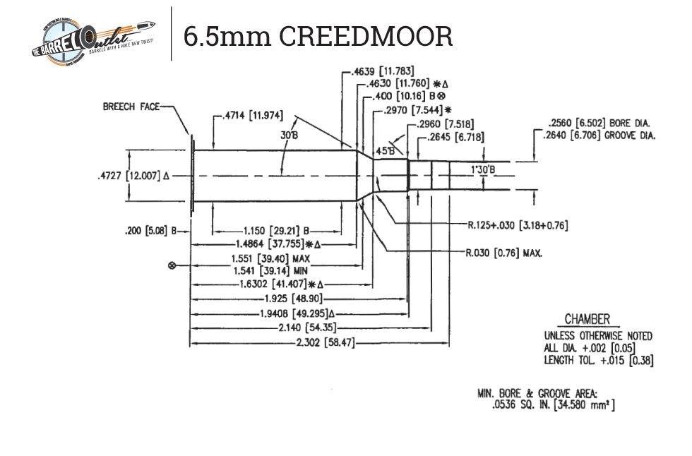

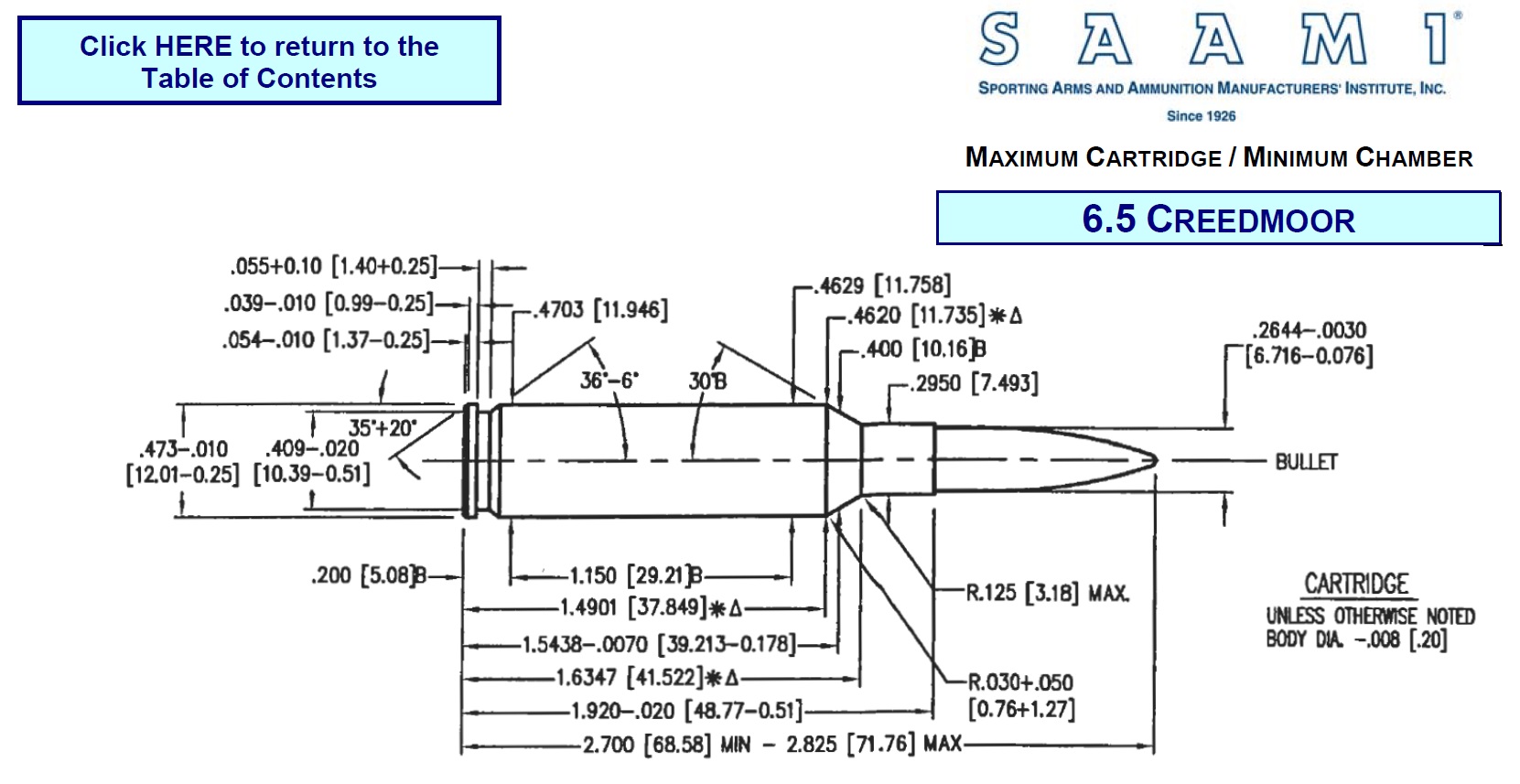

Thanks so much Fatelvis. after resizing, headspace measurement got longer, tried all the shells and it stayed the same @ 1.5295. it went from 1.5280" to 1.5295" (6.5 Creedmoor 1X fired Hornady brass)
Seems like a short chamber, this was from a Remington Magpul 700 in 6.5 Creedmoor. I noticed my Barrett MRAD measurement was a tad longer. And my AIAX-SA was even longer than the Barrett. Will have to try 1X fired Brass from each chamber and try "bump sizing" again with the shell holders.
Better yet, maybe just neck size your 1X brass and then start work on your 2X fired brass. That will give you a better picture of what your chamber really looks like.
It will get longer. That is because you are making the OD of the case smaller, which stretches the case longer, but your case has not contacted the shoulder in the die yet. Since you have tried all the shell holders, loosen your lock ring on your die, screw the die in another 3/8 of a turn and start with the 0.010 shell holder and re-measure. Then go to 0.008, then 0.006 and so on measuring each time and stop at the holder that gives you a 0.0015" to 0.002" set back. In your chamber that would be a 1.526" to 1.5265" measurement.

I think the issue i had was the headspace of the brass was slightly short...or not fully fireformed (1X fired factory). Based on the attached files (chamber and cartridge measurements) the brass fired out of one of my rifles seems to have a chamber on the short side. Thus causing the brass to 'grow' when I FL sized.
Recently measured some 4X fired Norma brass and it was ~1.5365". I used the .006 shell holder and was able to bump the shoulder back down to 1.5350"
I'll continue to monitor my progress on this.
