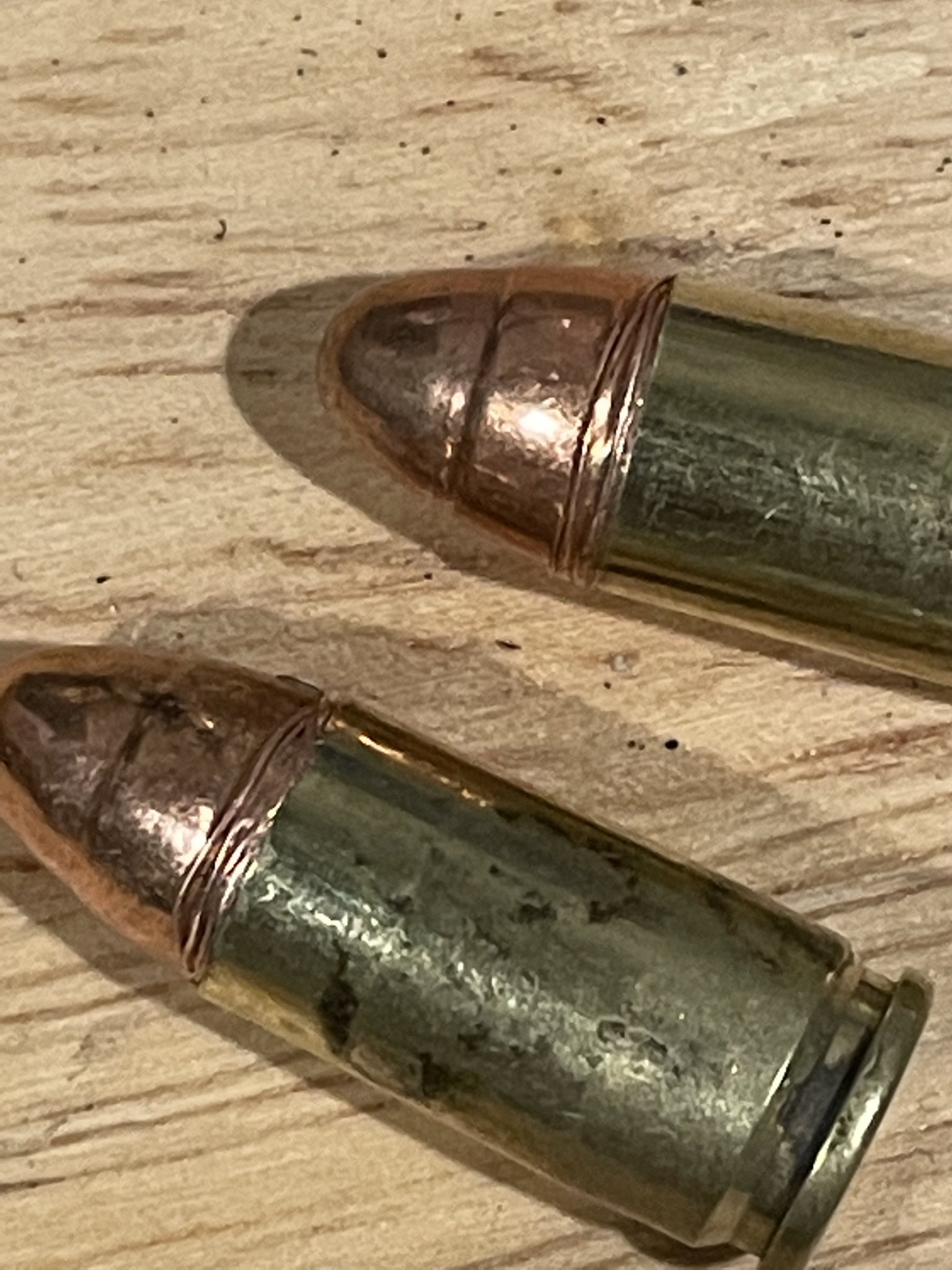

Guys and gals ,I need you guys help. I just started loading 9mm but I get some rounds that get wrinkled from one side , any idea what I am doing wrong , and also the projectiles get like a halo at the top part . Any help is greatly appreciated
Thanks
