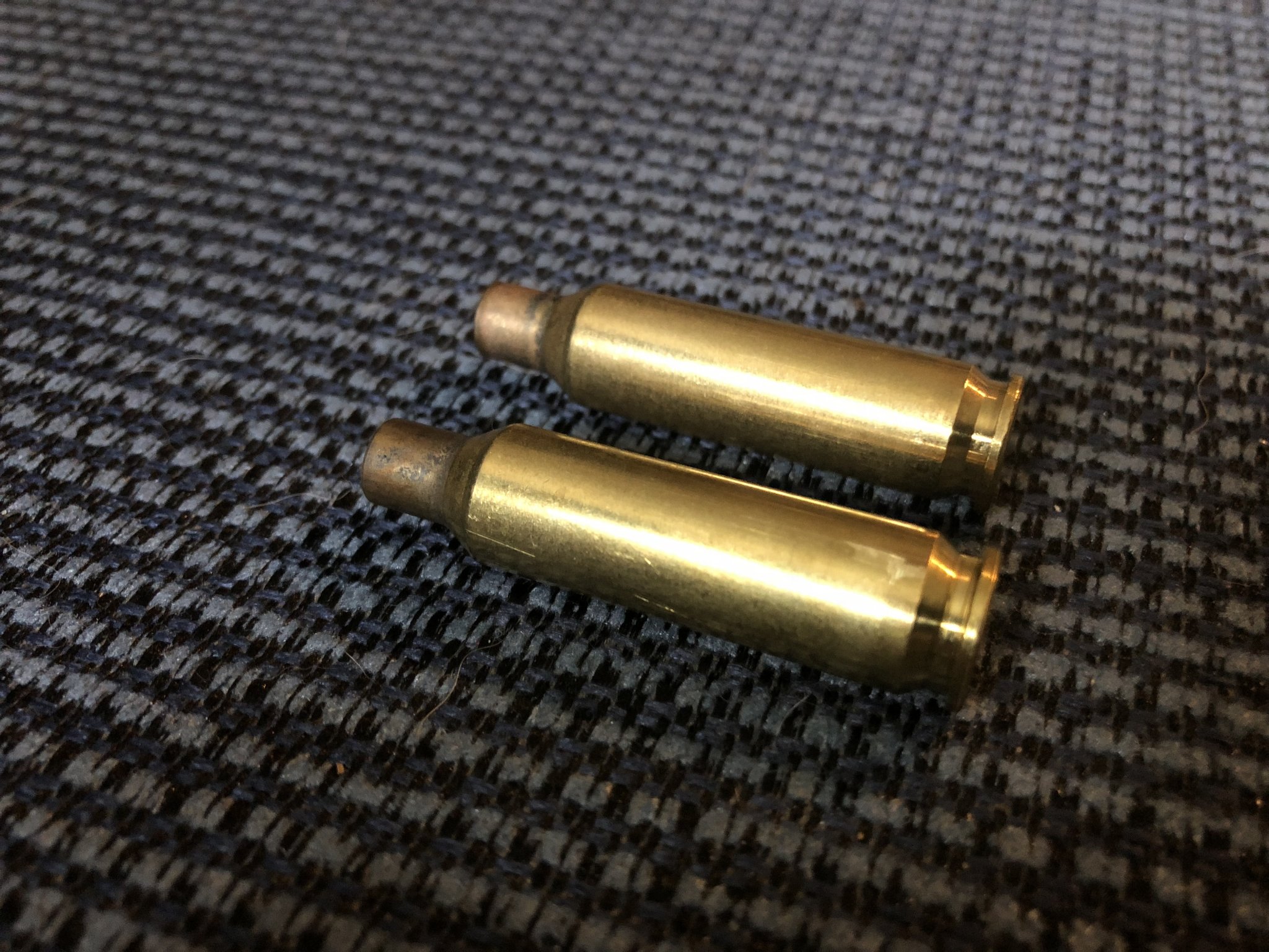

Wouldn't hurt to clean the chamber, what does the brass look like? Ejector marks, primers flattened?
There is some actual signs of drag on the down brass. Barley if any sign on the ELDM brass. Closest brass is the Gunner.

Can you show a picture of the primers on the 140 AG vs. something else that doesn't stick, like the 147's.
Also if you have a set of calipers, measure the case body diameter just forward of the rim cut-out. Find the widest part of the case and compare that to one that doesn't stick. Also can single load a round (in a safe environment), then extract it and see if there are scores on the bullet from engaging the rifling.
My guess is for some reason it's producing more pressure than the others in your rifle. If the primers are flatter, or the body dia. is more (even .001") then you know the brass was pushed harder and that's what's making it stick. Could be a number of things, either internal (powder charge, softer than normal batch of brass) or external (dimensional difference causing interference-- neck too thick for your chamber, bullet seated into the lands, etc.). If you know someone else with a 6.5 Creedmoor rifle, might be an indicator as to whether your chamber is on the tighter side and causing the interference, or if that particular lot of ammo is loaded warm.

Primers look about the same. I can only measure down to hundredths and both pieces of brass are the same at neck and above the rim. I will have to find another 6.5 to shoot it out of and see how it does. I will also try and extract a hot round to see if any scores on it.
