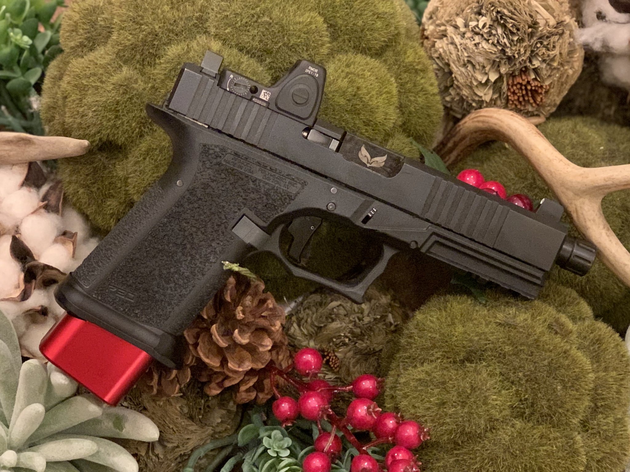

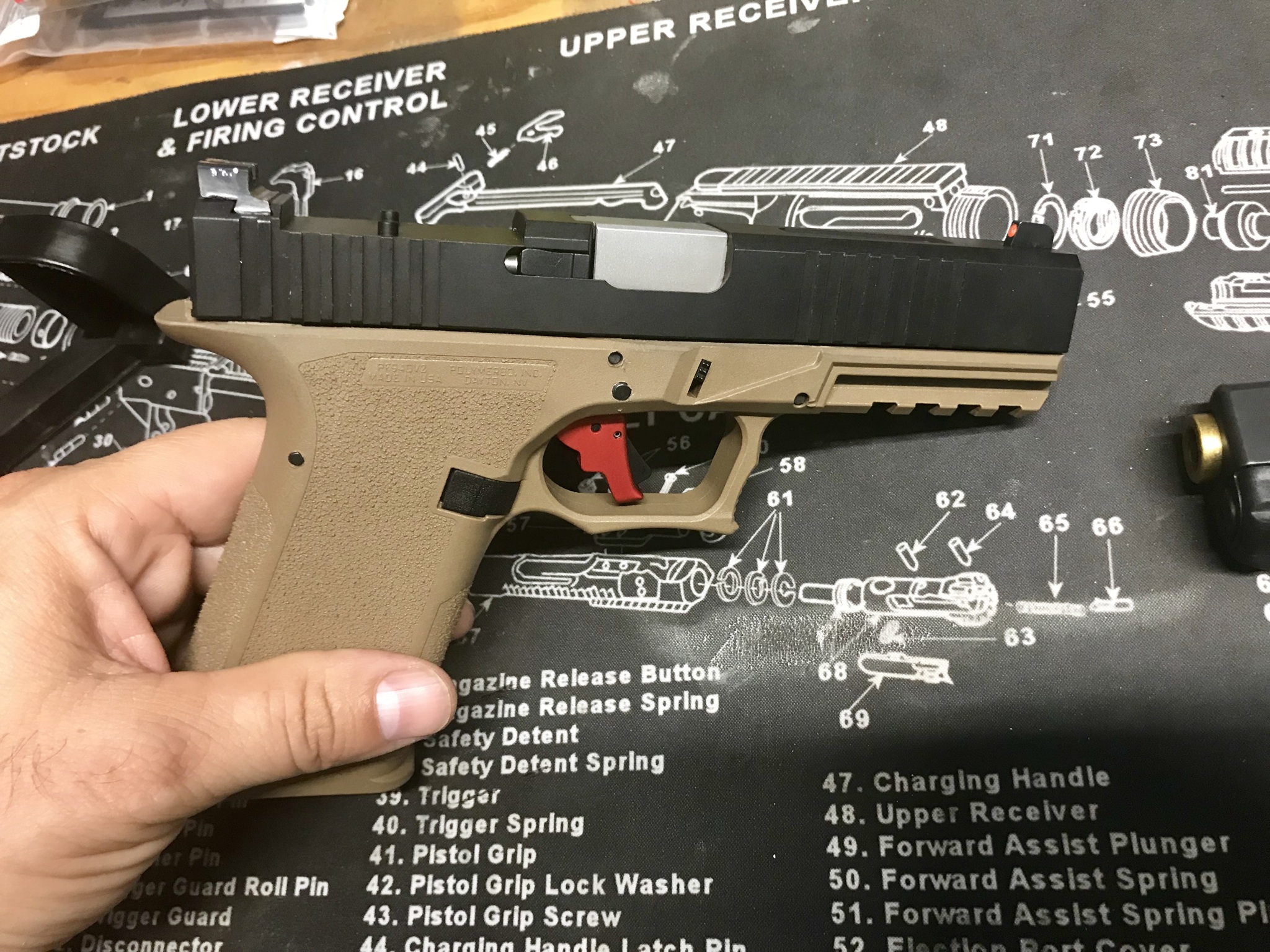

    Built one a while back. Super easy with dremel and hand files. i hate standard glock 19 grips and these are a decent upgrade and perform reliably.

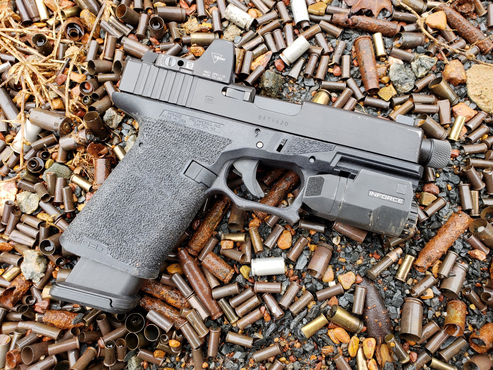

    I’ve built 2. They go together easy, they function well with good parts, hell I like mine.

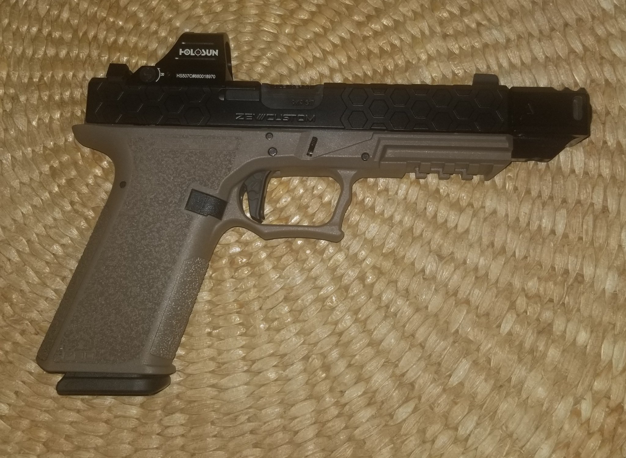

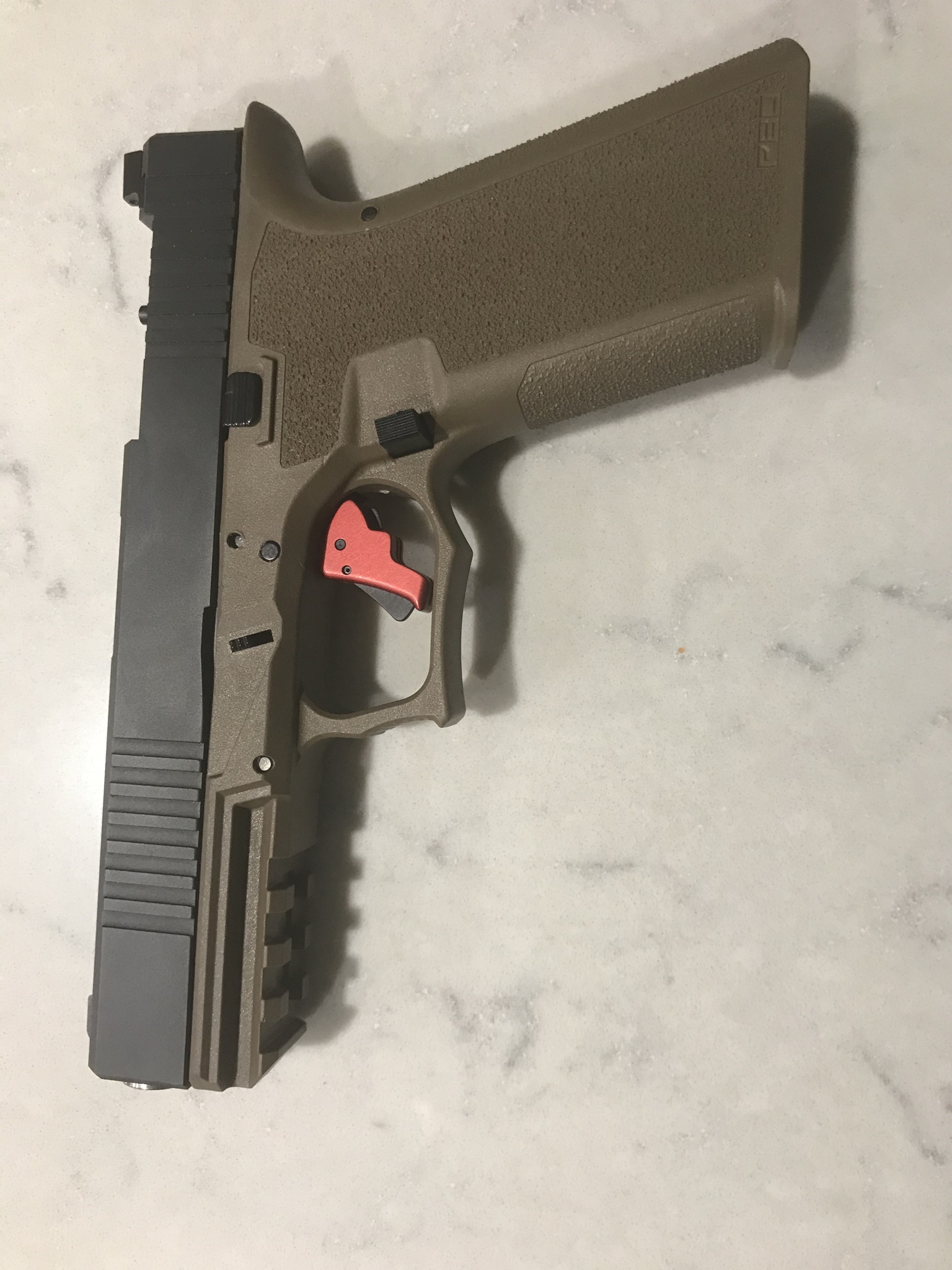

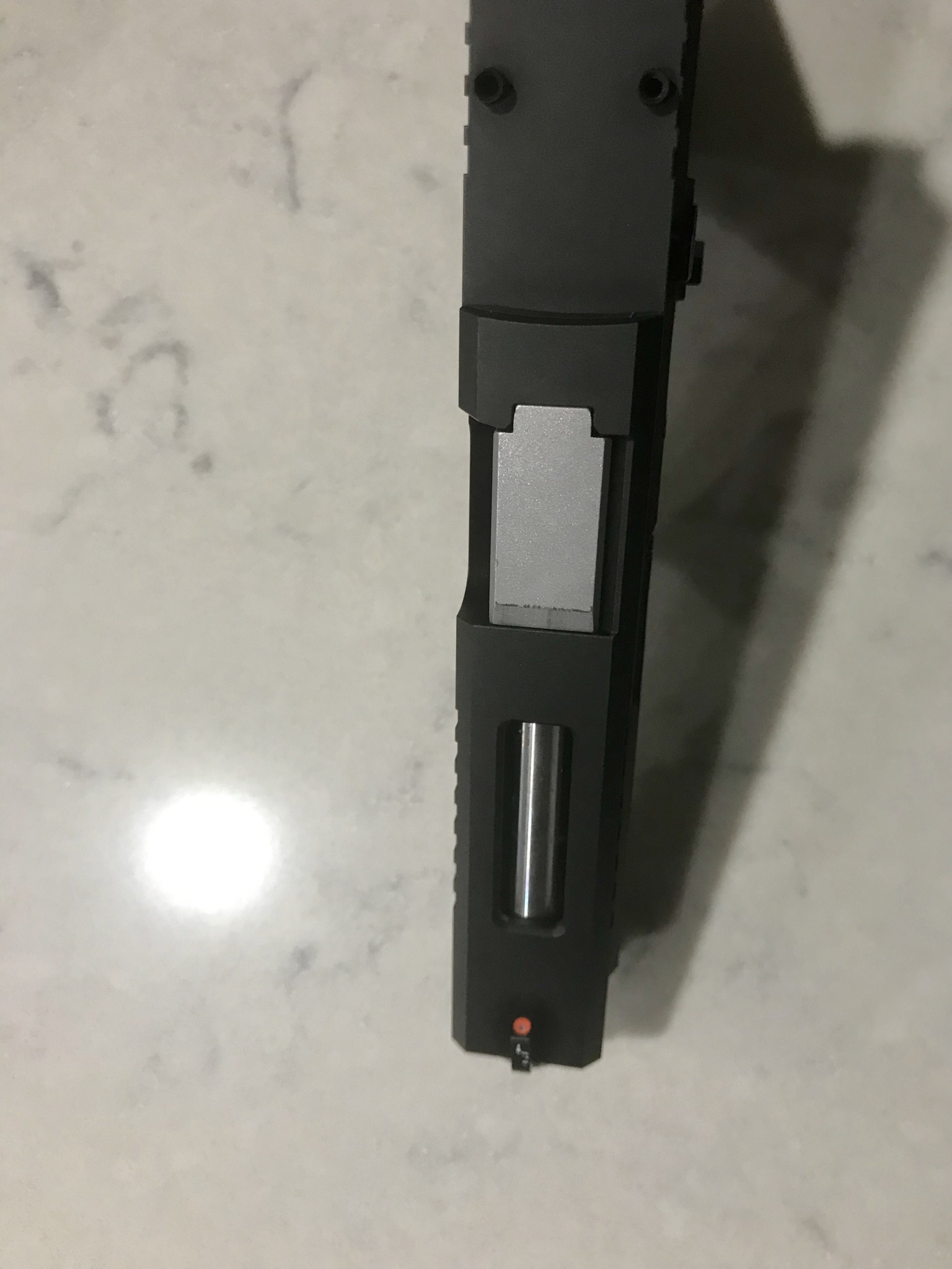

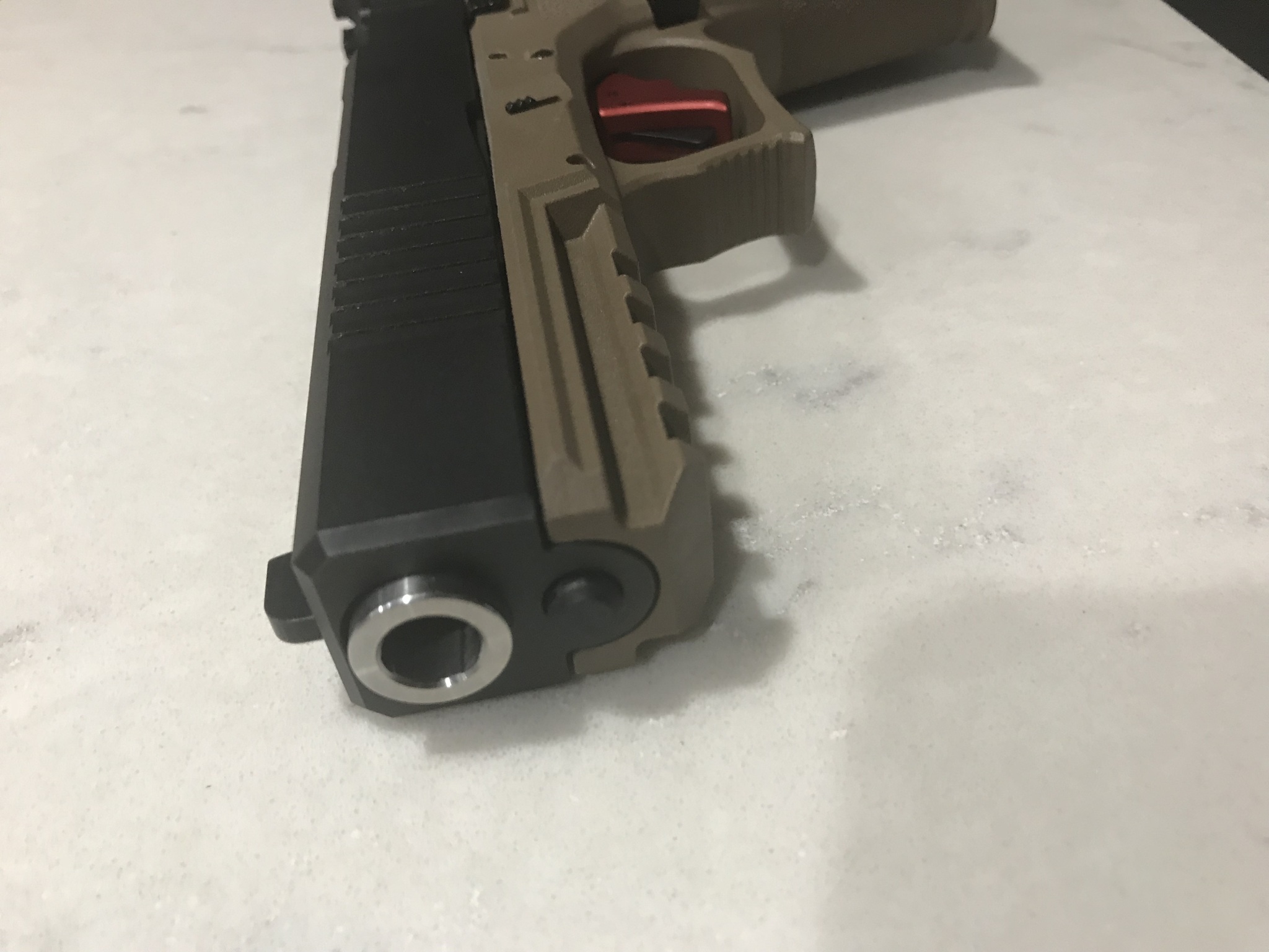

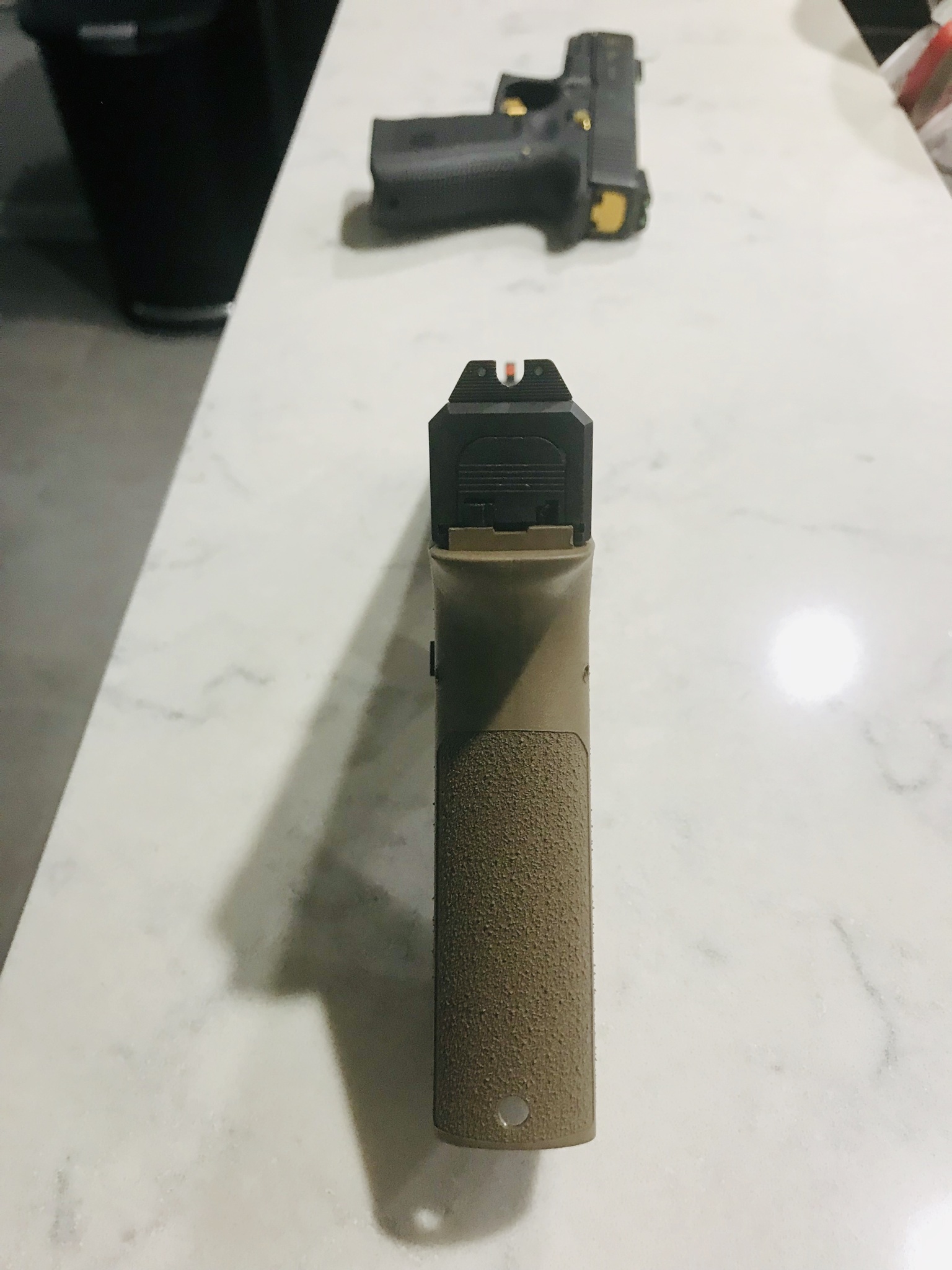

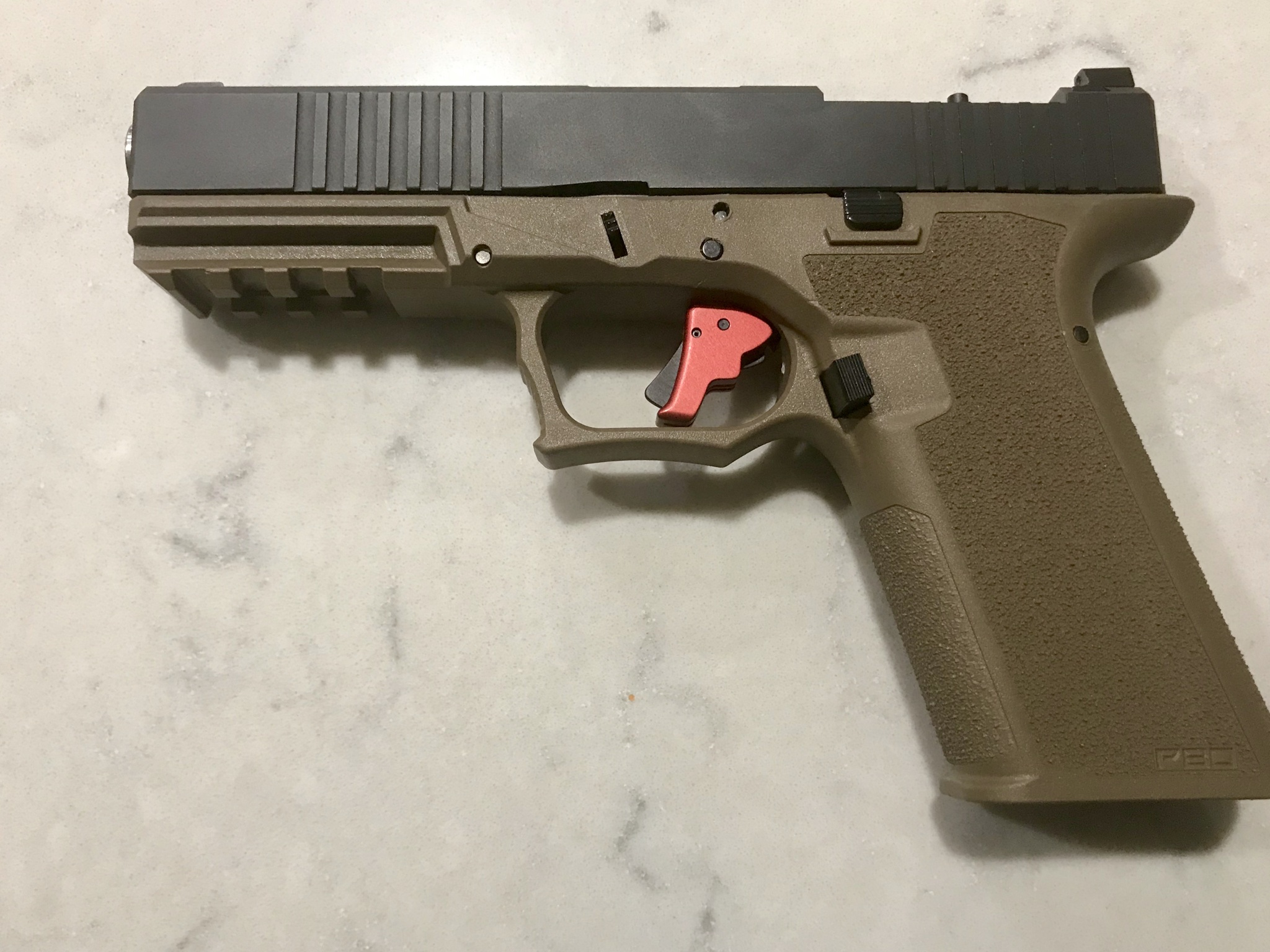

    I built this Polymer 80 glock 17 and I have fired around 500 functions flawlessly. I got a great deal on most the parts from brownells and the glock store was a learning experience just take your time and don’t rush trying to rush removing material from frame.

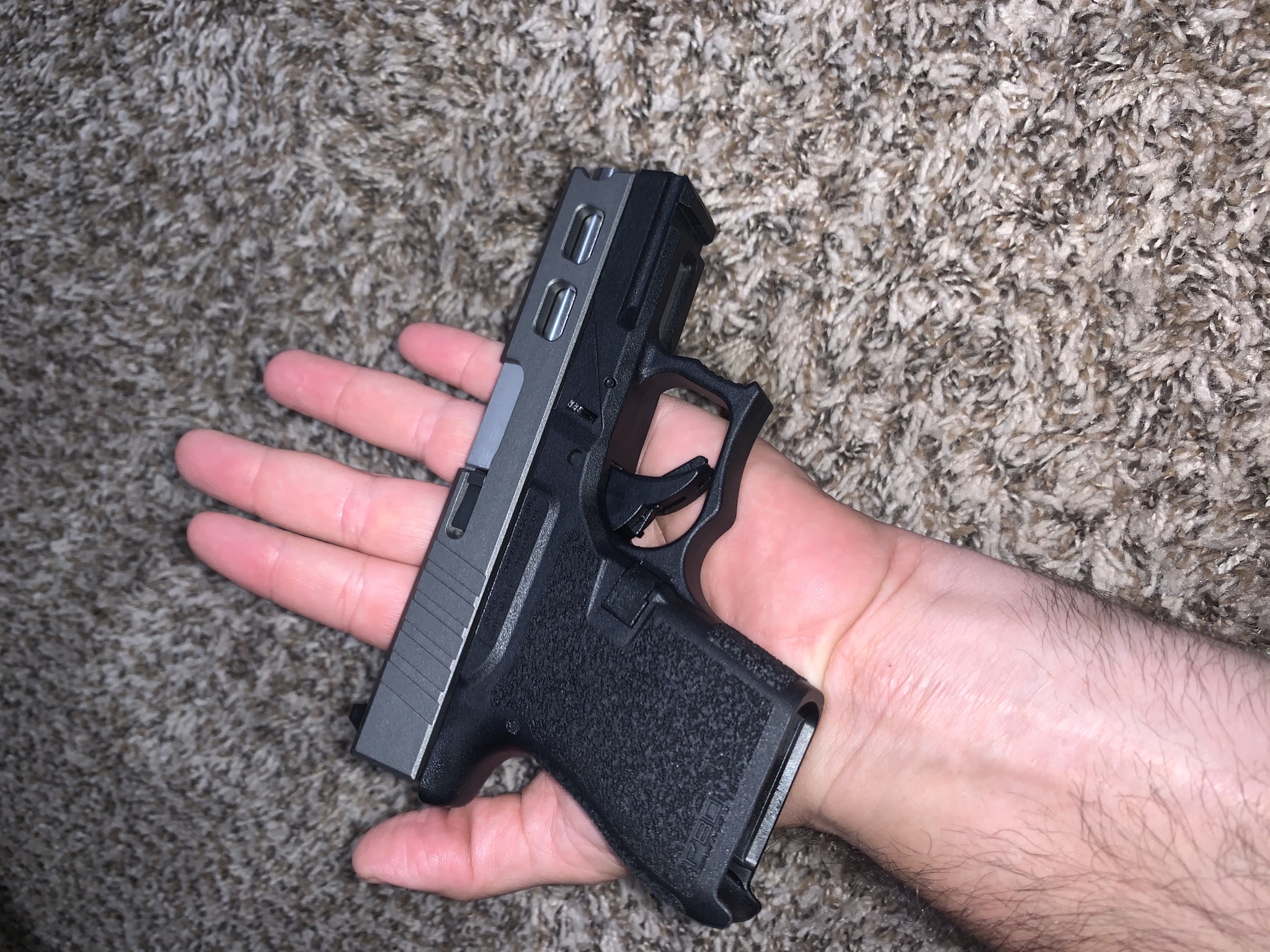

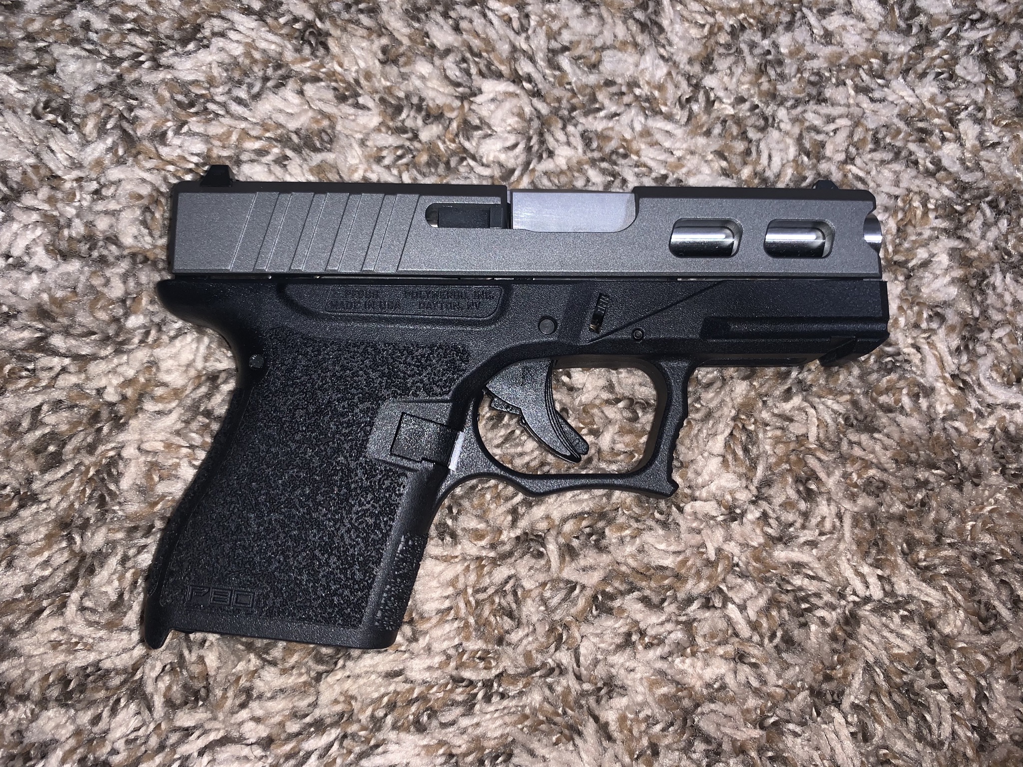

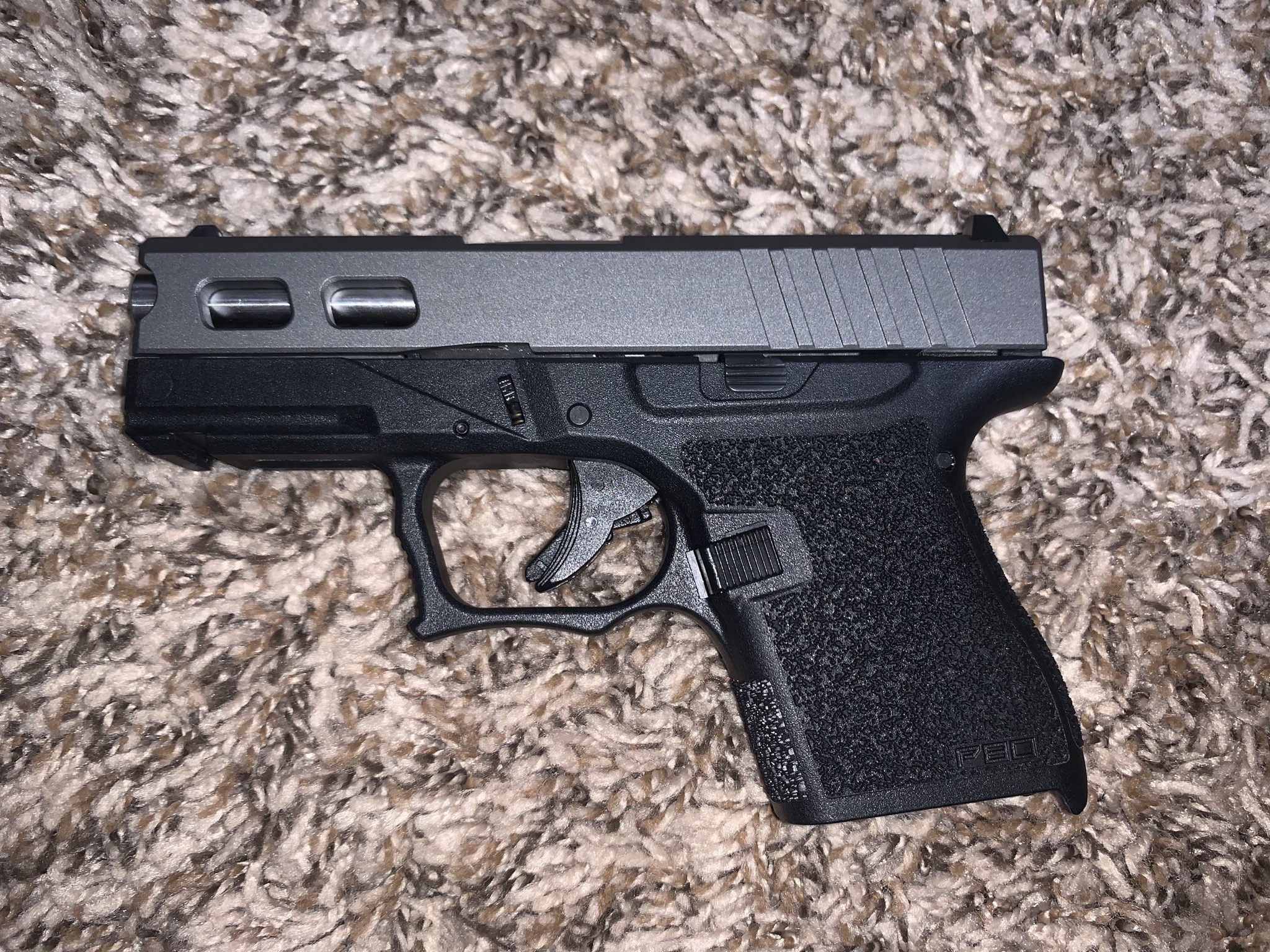

    I just built this G43 Kit it turned out very nice just have to take your time and make sure you polish the lower frame rails with a dremal to a slick smooth finish and I have also had to slights polish the feel ramp to load smooth. The videos from Marine Gun builder are great info if your interested in a polymer 80 build.

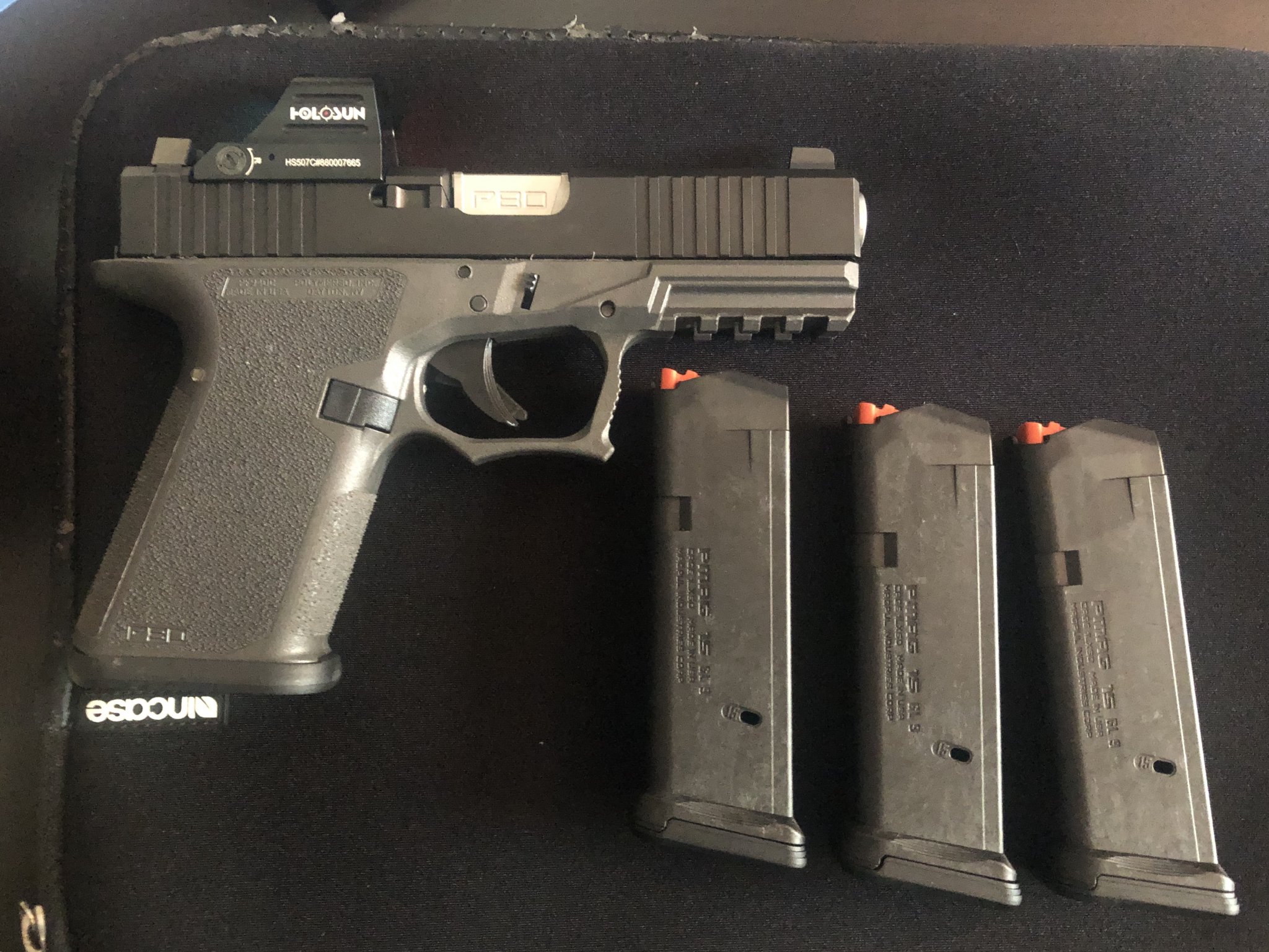

    Mine:
    Getting it to run well didn't require polishing the frame rails but rather a lot of trial-and-error with the main recoil Spring.
