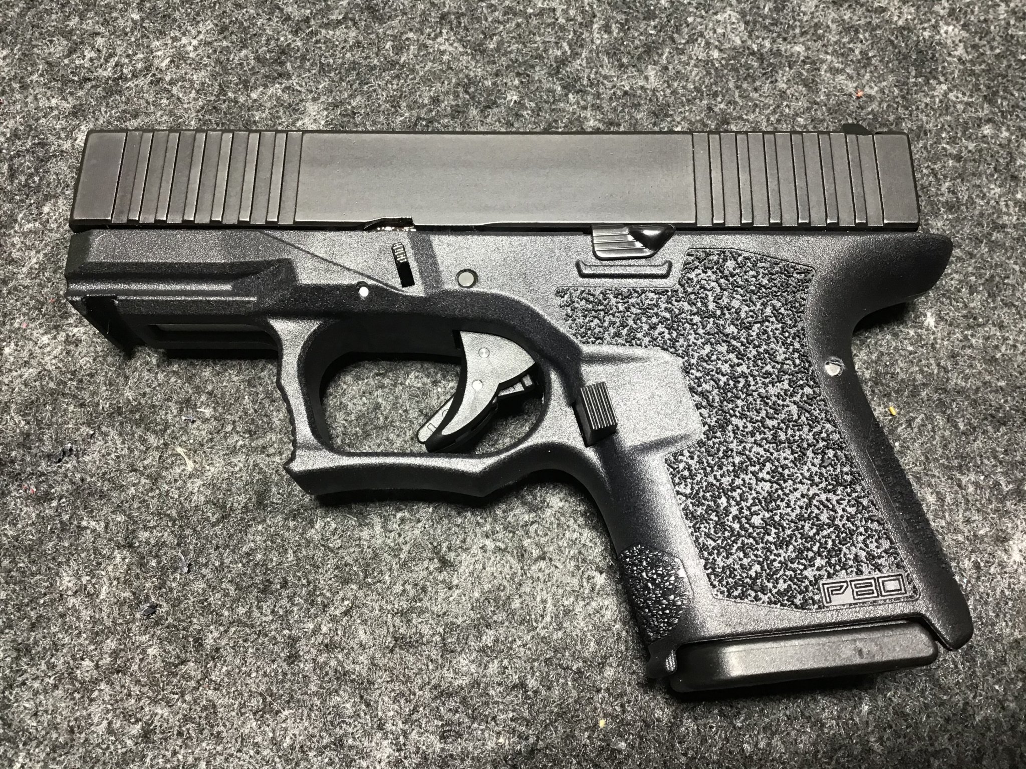

    Just built a G26, I tried something different this time with the tabs that need to be removed. I took a utility knife with a new blade and slowly cut those tabs off by scoring it real slow. After about 6-8 scoring the tabs came right off. The cut was so clean I didn‘t even have to sand the receiver at all. You really can not even see where there were.
    Reactions: BullGear
    sam4886
    Stunt Cock
    PX Member
    May 15, 2019
    613
    308
    Eastern WA
    Looks good. I like the end snips/razor/file combo. These things are so damned easy to build, its hard not to have 100 of them.
