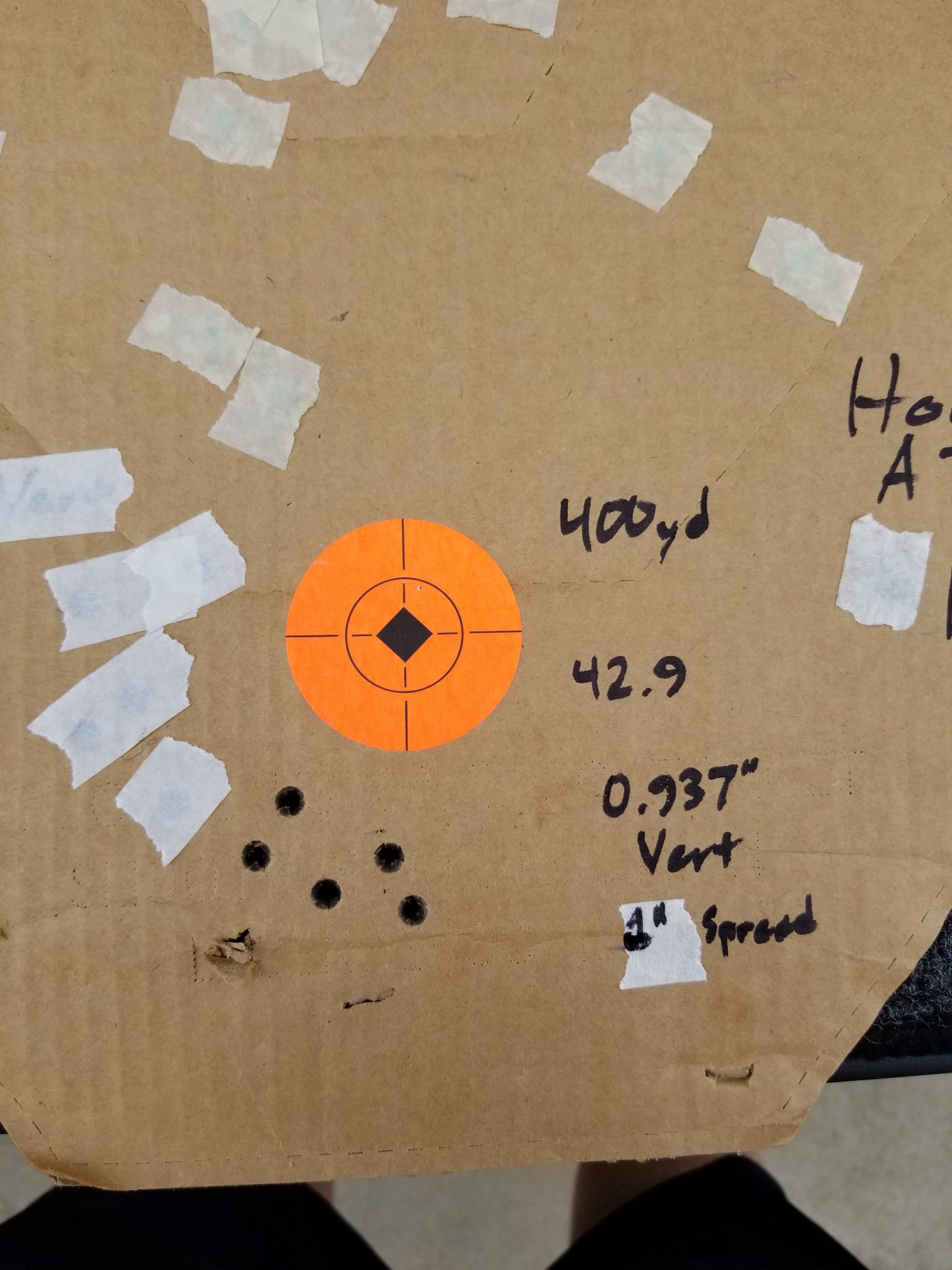

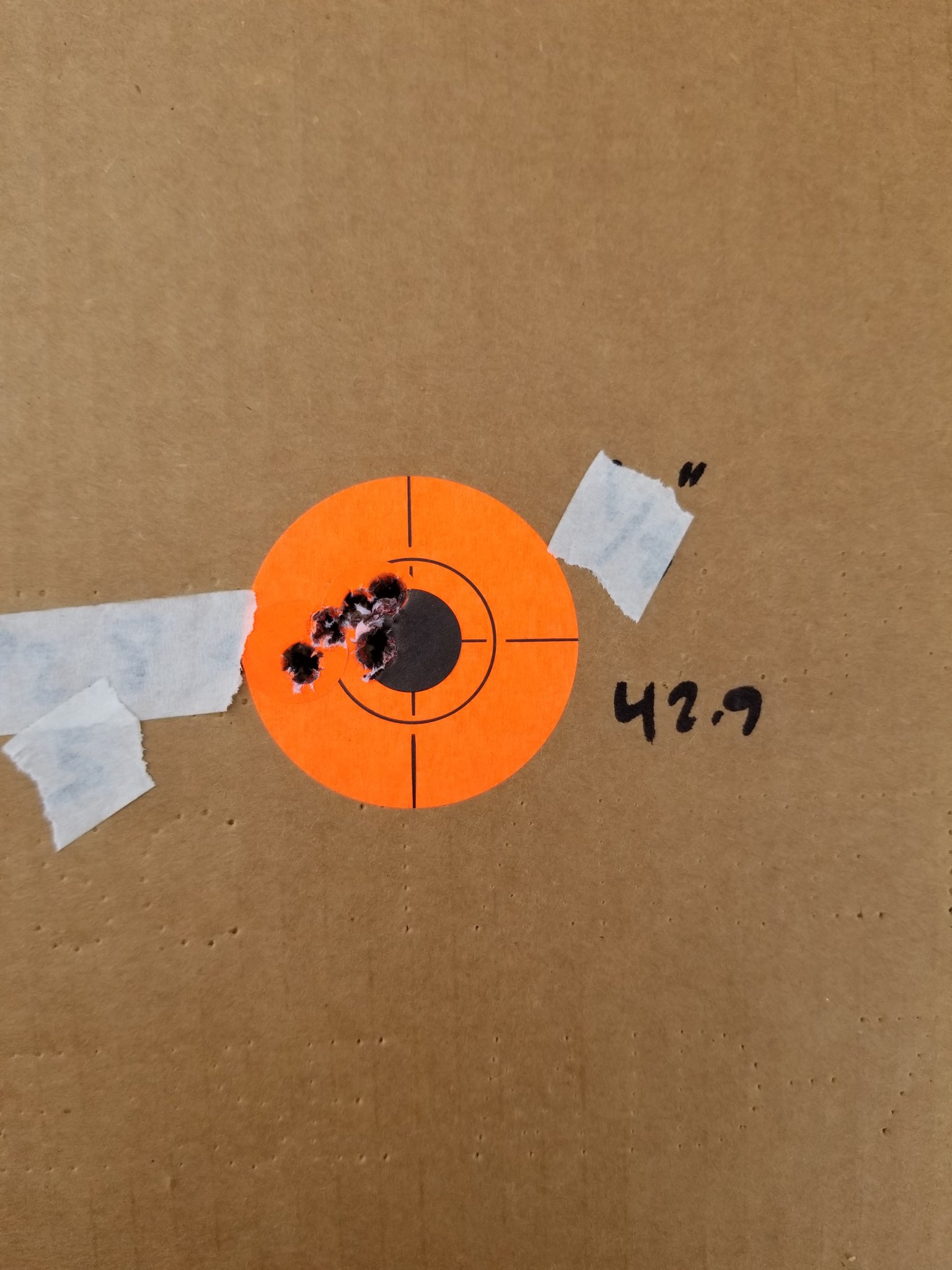

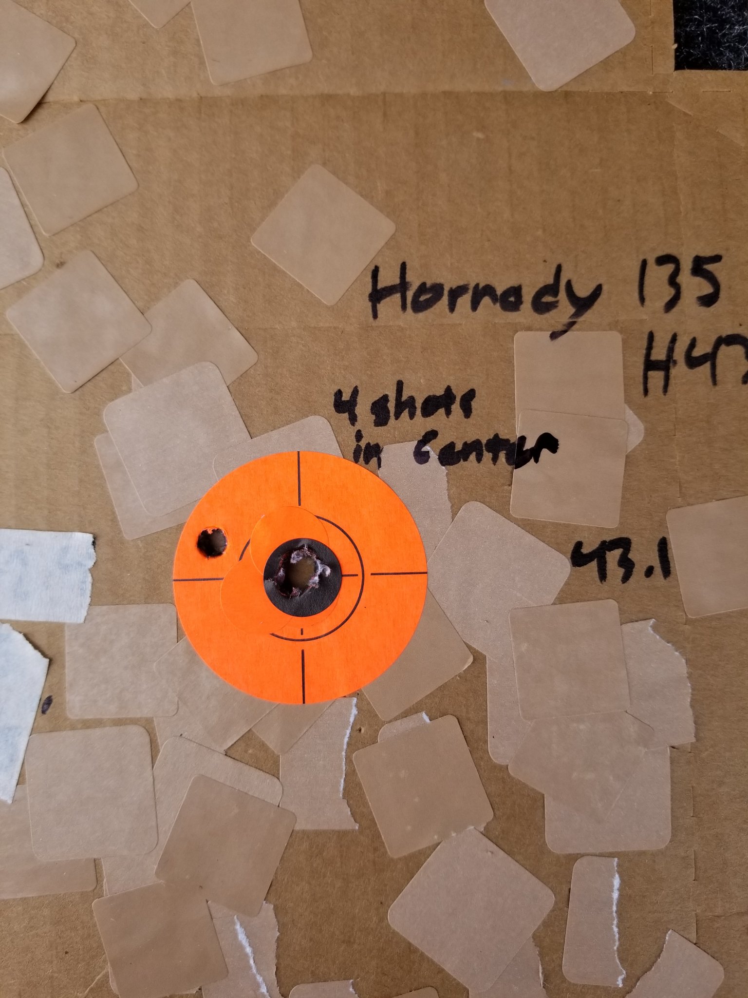

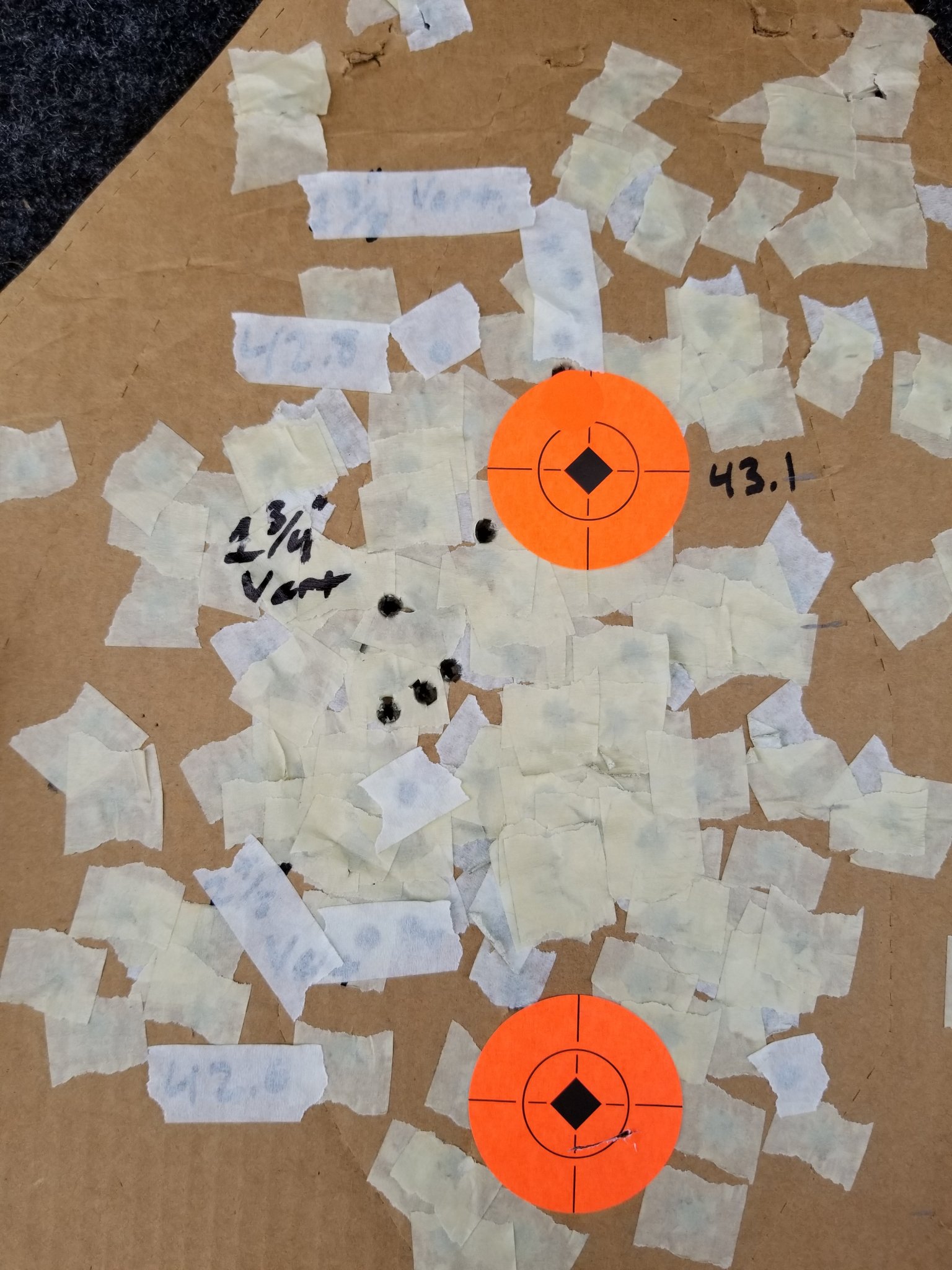

As an update, I've loaded a couple more batches @ 42.9 and 43.1, the former being Hornady's listed max and the later a bit higher. Those may not even be shot if the 42.9 doesn't do how I like, but I believe the pressure to be in check.
I've also lengthened the rounds 0.036", making the base-to-ogive 2.170". I doubt I could squeeze a sheet of paper between the tip and the binder plate, but it cycles smooth enough for my uses. Still keeps the bullet 0.034" off my lands, but this is within the realm all my other loads liked. Should be able to shoot them early Thursday morning and will report back.

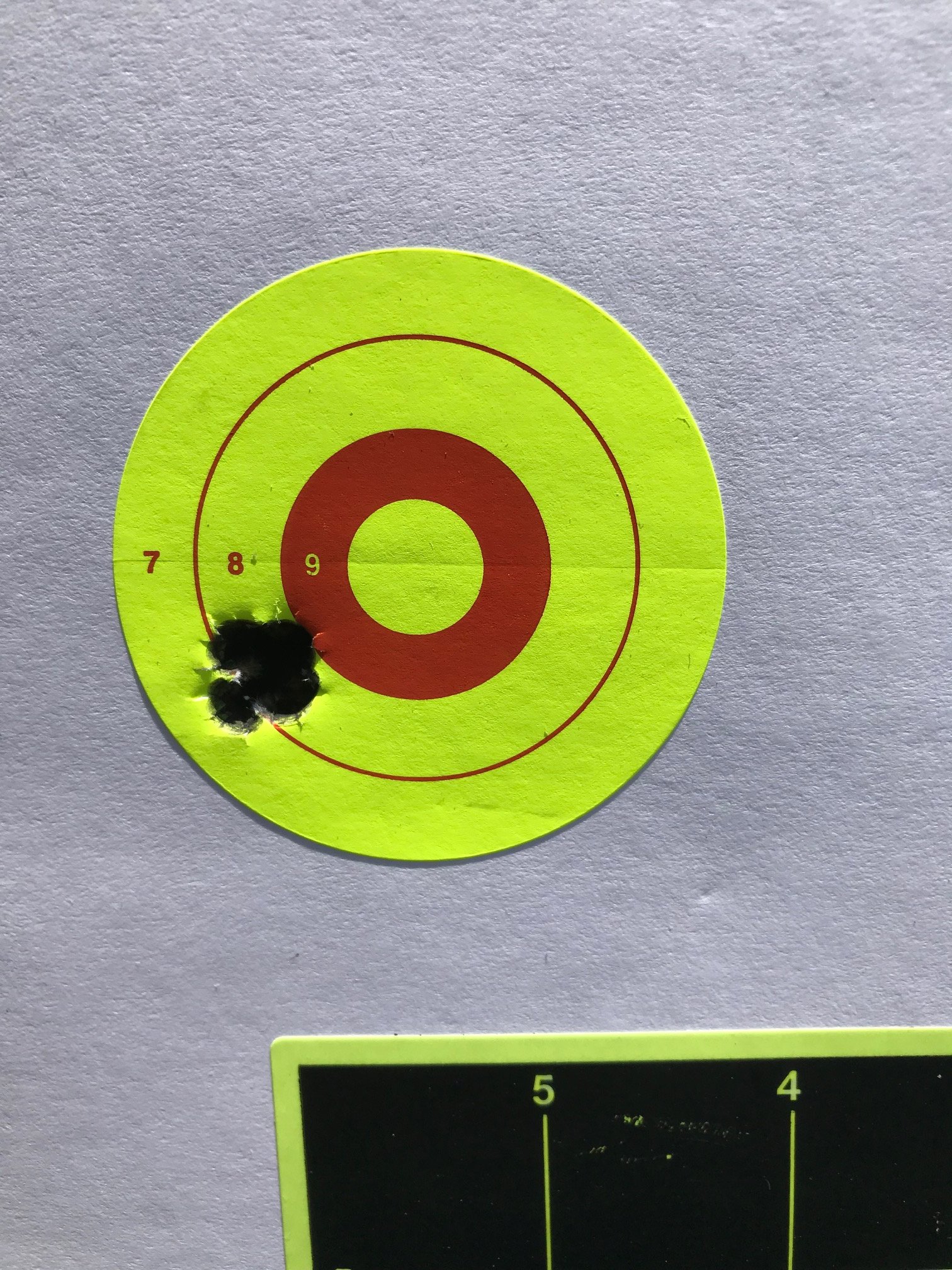

Here are the results of my test this morning. It turned out very, very well. I attempted Hornady's max of 42.9 and pushed a little further to 43.1 of H4350.
Even though the best group, technically, was with this higher load, the extra speed gained was not adequate enough to repeat. I also believe the 42.9 is capable of the same accuracy, especially since it's 400 yard group was stellar.
The picture are in ordered pairs, 42.9 @ 100 + 400, 43.1 @ 100 + 400. All loads were seated at 2.170" base to ogive, 0.038" jump. I couldn't jam a piece of paper between bullet tip and binder plate, so I single fed them. May try sliding it back a tad and retest, I only pushed it out to allow for pressure in the larger load. Or, I'll just get a new mag. Enjoy, let me know what you think. Target dot is 2".
what were the numbers for these loads? Velocity, SD, ES? Very promising. I just got mine, will be shooting this week end using RL16.
Hopefully, you can read my chicken scratch. Boxed number is the charge of H4350, numbers below are velocity (I didn't bother repeating the 28-- each time) and each line is a different, 5 shot string, in the order fired. S.D.'s are at the right.
I also picked the 42.9 due to the history I have with my barrel. I've noticed it needs to settle in a bit from being cold/first shot, regardless if cleaned or not. The first grouping had a great S.D. and the 2nd is the best I've ever recorded, following what it's excibited over the last 1,000 rounds.
While the 43.1 charge was good, it didn't offer a substantial velocity bump so oh well. The dope listed at bottom was just my note, I dialed 1.5 up just to put it close on paper. Actual number @ 400 yards is a tad over 1.6 which is 0.2 less than my ol'faithful 142 SMK load. This projectile is outstanding. I really hope they make a 7mm variety, too. I just need a binderless mag.

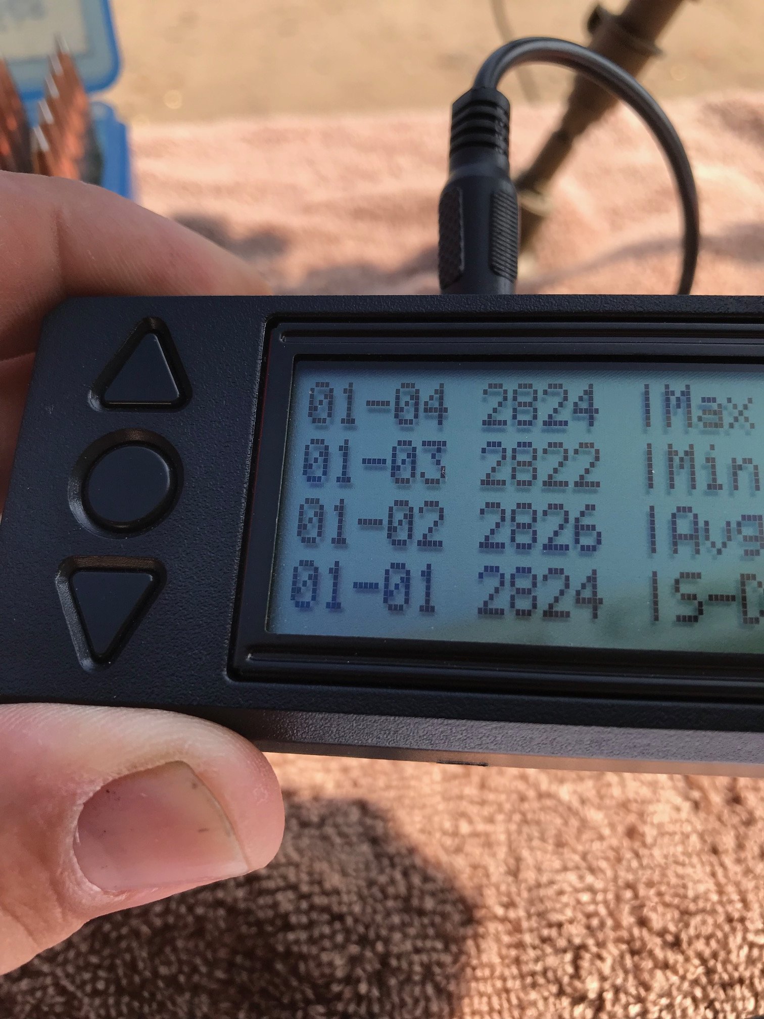

Got to shoot first set of tests today. Gun is a custom Savage Stealth with 28" barrel, 1-8 twist. 135 Atips jumping .070, this puts the base of the barring surface about 3/4 or a smidge more in the neck. Neck tension is .002. Powder is RL16 with Federal 205 match primer. Velocities captured on Labradar. I will try to add pics via phone after this.
I ran 3 shot groups from 41.5 to 43.5 (based on 140 grain max published data). 41.8 was the best group @ .319". 2864, SD 5.2, ES 10.
Groups opened but SD/ES numbers were great. Groups started to close again at 43.5 which was 2970, SD 2, ES 3 but group was not great. 2 touching/overlapping and 1 @ .8" low left from the other 2. But I can see the overall group is starting to close down again as charge weight is going up. No signs of pressure at all. one piece of brass had some mild cratering on primer, but that is normal in a Savage bolt. (Factory Hornady 140 ELD Match ammo craters all the time and I am using small rifle primers, so I ma worried) I replaced my Wife's 6mm bolt head with PTG and shaped the firing pin and it does not crater anymore, so I will be doing this to my 6.5 next. No heavy bolt lift, no flattening of primers and no ejector or swipe marks at all. I will be going to 44.4 next in .2 grain increments. I created a profile based on a (modified) 133 flatline in quickload and it is matching up very well. It shows 44-44.2 is going to be the sweet spot so long as I don't hit pressure and it shows max of 45 grains. ( I take this data with a grain of salt. Based on my experience with this gun/powder I think I will hit front side of pressure at 44.5-6) Velocity is projected to be 3000-3012 @ 44-44.2. I was expecting a 2925-2950, this is a bit of a surprise, but I will take it. I hope they continue to close and it finds a node going up.

Retested a couple seating depths this morning. I had two batches, 0.038" and 0.074" jump. Both shot slightly better than 1/2 moa at 100 and 400 yards. S.D.'s were fine, especially with the shorter jump (average of a couple groupings was 4.0). I settled on the shorter jump even though I will need to single feed or buy the longer mags.
I did this because I noticed with the longer jump/shorter seating depth it had the first heavy bolt lift I've experienced with this round. Not worth it when a simple mag switch and the others have shot far better. I got even better groups the last I shot the 0.038" batch and I attribute the slightly looser groups to weather conditions. I keep going early, but it's unbearably humid where I'm at right now. I wasn't exactly feeling spry.
I settled at Hornady's max load of H4350 @ 42.9gr. it's getting, on average, 2838 fps with very low S.D.'s. The load takes a couple or 3 shots to warm from a lower velocity, then settle in around the average. Once I run out of H4350, I'll chase some more speed with RL16. Don't think I need it, modelled it with 4DOF and I'm supersonic past 1,400. More than I wanted.

I finished testing the 135s in the 6.5 Creedmoor and the 110s in the 6 Creedmoor. The 6.5 landed at 41.8 of RL16 which produced a velocity of 2875, SD of 2.9 and 5.6 with ES of of 6 and 13 for the two final strings. I will be testing this load at distance this week end. The upper node of 43.3 has good numbers but produces fliers, which is not acceptable to me, so I dropped back to this node as the extra 100 fps was just not worth chasing. The COAL landed at 8.20 which was .115 jump in my rifle. I wanted to mag feed and .050 was mag length. When I did the seating depth test, the best performance was seen between .110 and .135 jump in both guns.
The 6mm landed at 41.1 of Rl16 producing 3084 fps and almost identical SD and ES numbers. Coal is 2.795 which is .130 jump in that rifle.
They both produced tiny one hole groups at 100 yards.
Both rifles are custom Savage model 10s with 28" Shilen bulls. Brass is Peterson SRP. Primers are Federal match.
I got to run a few rounds to 350 and they stacked. I had 1 flier at 1.2" out of the group, and the other 4 stacked on top of each other. I will be running these well past 1k this week end.

I started my development with the 135 using RL-16. My starting load of 42.8 in new Lapua brass gave me 2824 with single digit SD and ES. Once fired velocity stayed the same with a slight change to the SD but still very low. I am happy with the results to 600 yards (max range tested so far). I am jumping them .030 and they barely fit in the ARC mag. I think OAL is 2.895, I'll have to double check that when I get home.
I went up to 43.4 and the numbers weren't there for me. I may try to push it further but the first load has been great and repeatable. I almost don't feel like I need to push it harder.
