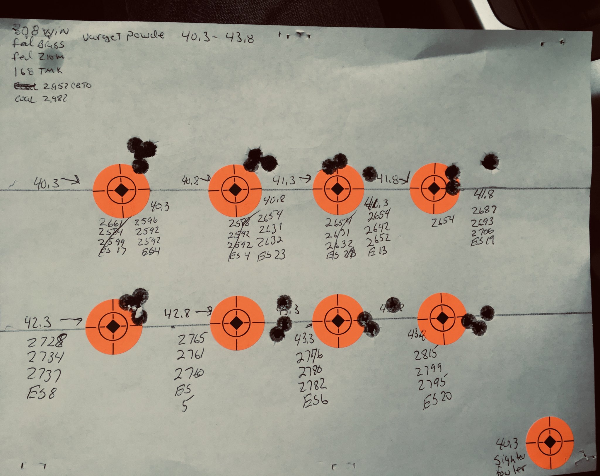

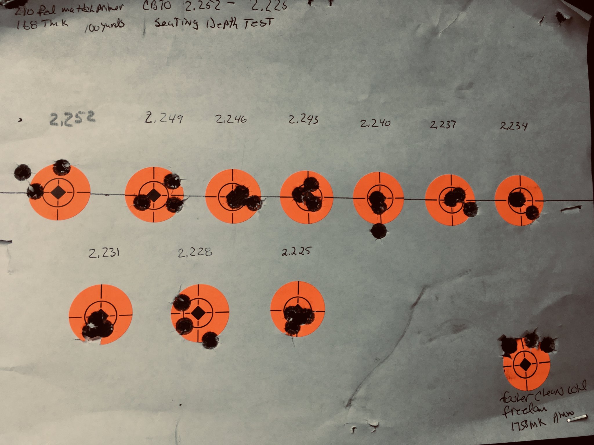

I have one on my bighorn origin and it shoots lights out!
Both are 5 shot groups. With the marksmen profile.

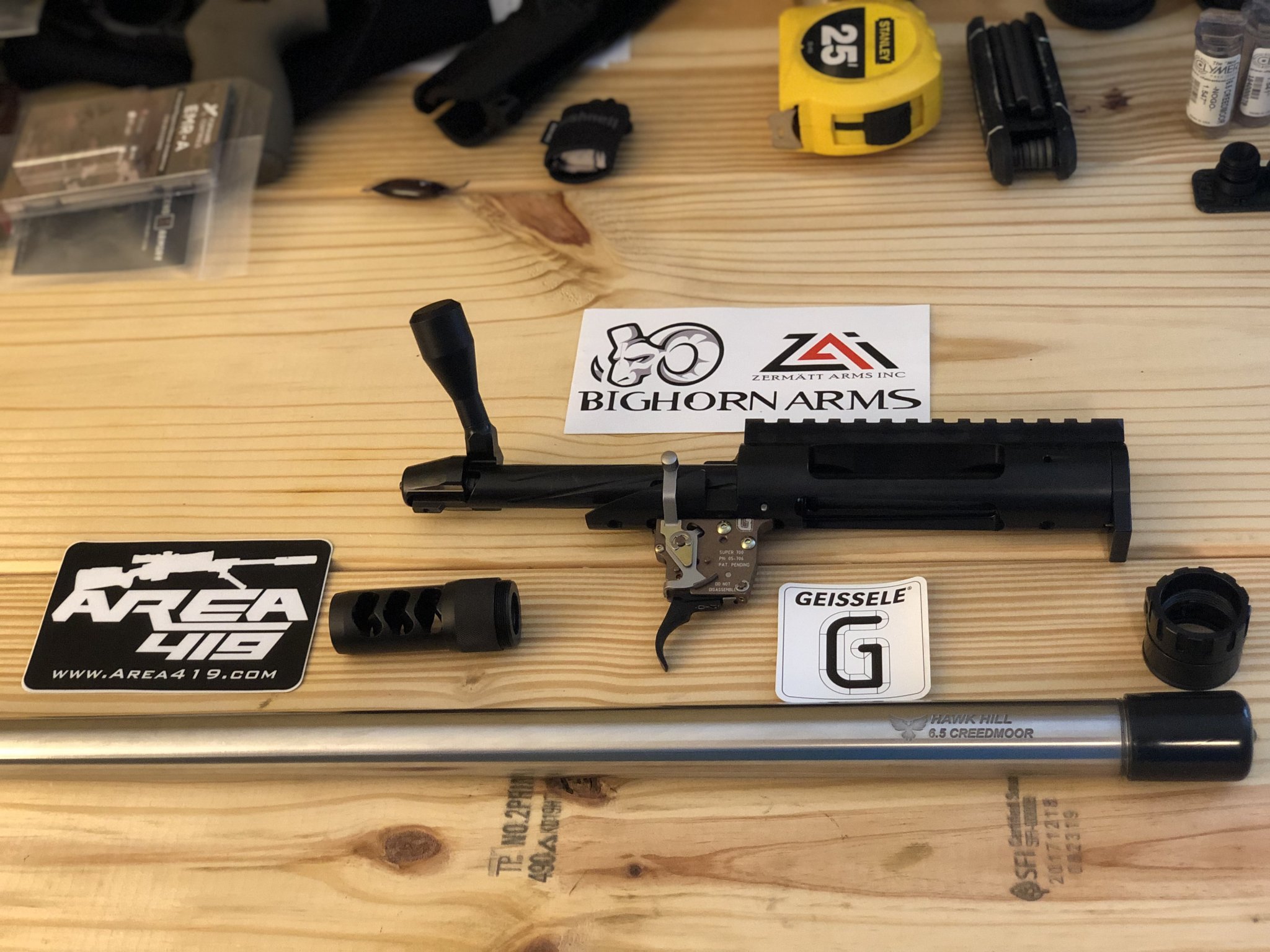

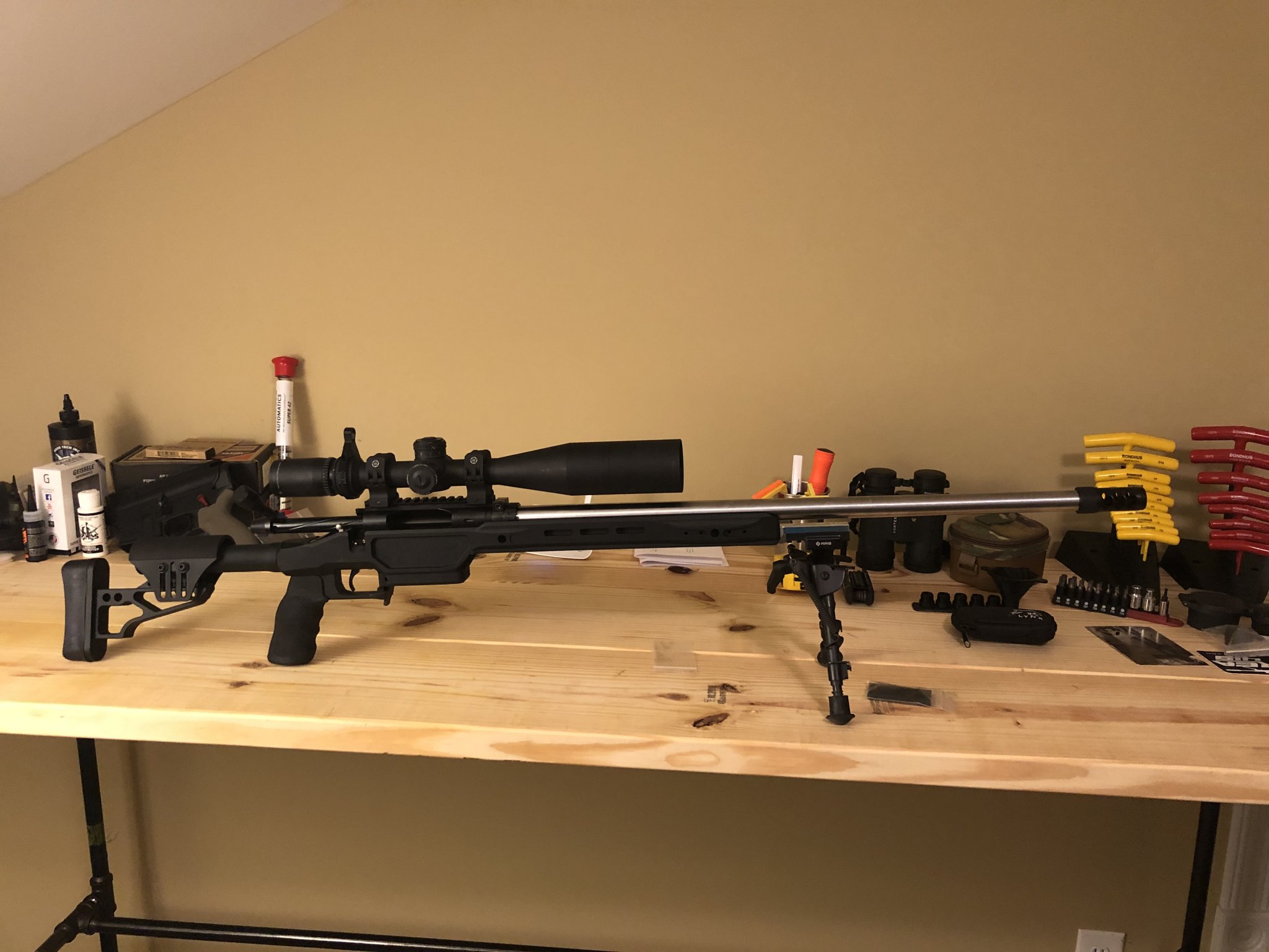

Yep, got the following:
  • Bighorn Origin action
  • Geissele R700 trigger
  • Hawkhill 6.5 CM 26 Marksmen Prefit
  • Area419 Hellfire Brake
  • ARC Barloc
It was like adult LEGOs. Only 30 minutes to assemble. It was a laser at the match this weekend. Just watch out, I barely had enough thread to set head space. May not be an issue with the Nucleus as it has a thinner action lug.
  • ARC Barloc

If I remember right you have to be careful when using the barloc with prefit barrels because of that reason.
