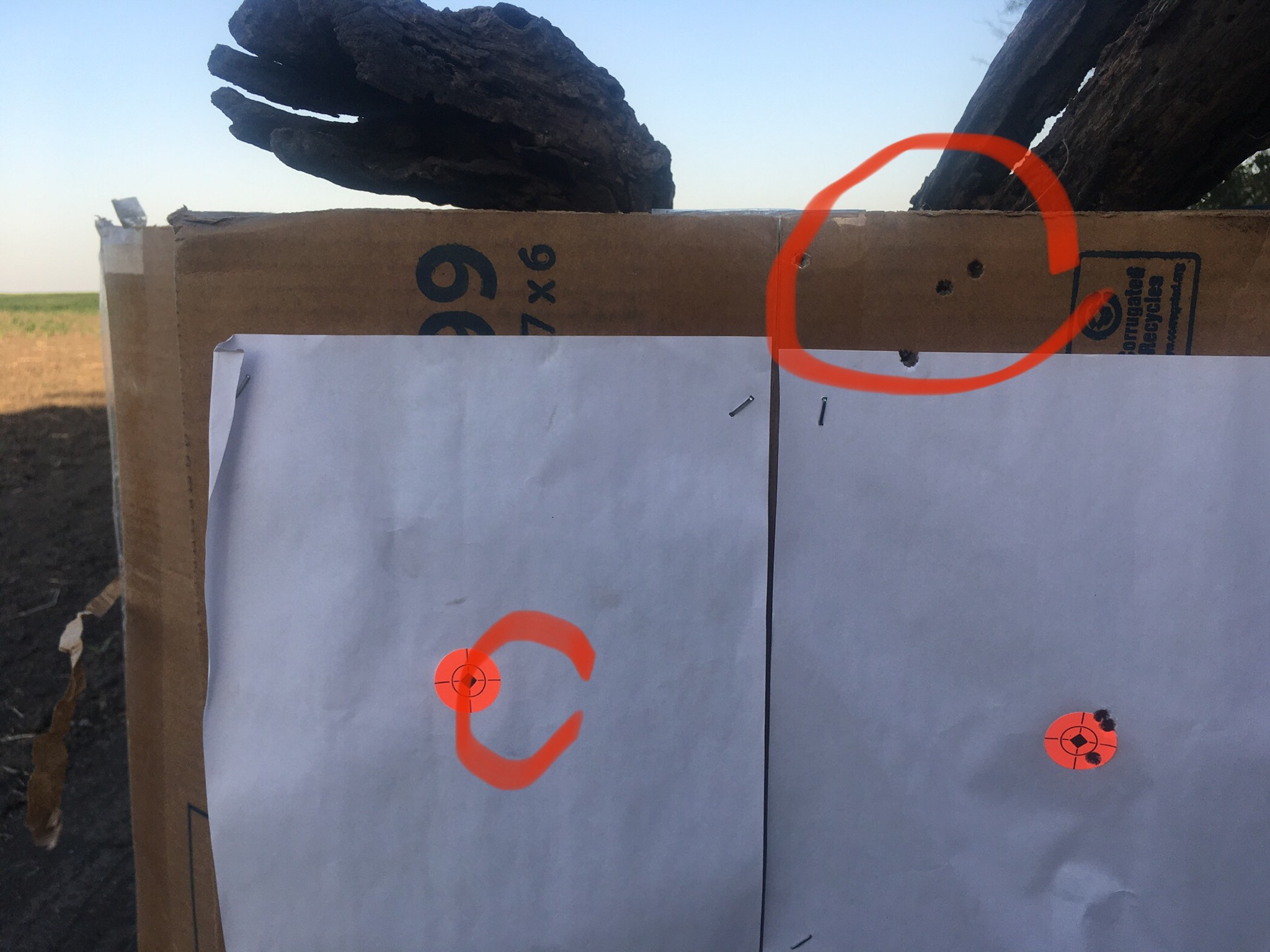

Seandradamus, this is a picture of the group I shot in the mirage.
What I experienced lines up with the numbers you said.
Thank you guys, I learn quite a bit here.
There is a big difference between reading about wind and mirage and actually shooting in it. I have had an aha moment.

At 400 my group moved up about 6 inches and right about 6 inches. That is a hair less that a half mil?
Would it move more at 1,000? A half mil at 1,000 would be about 17 inches? or would it move more?
