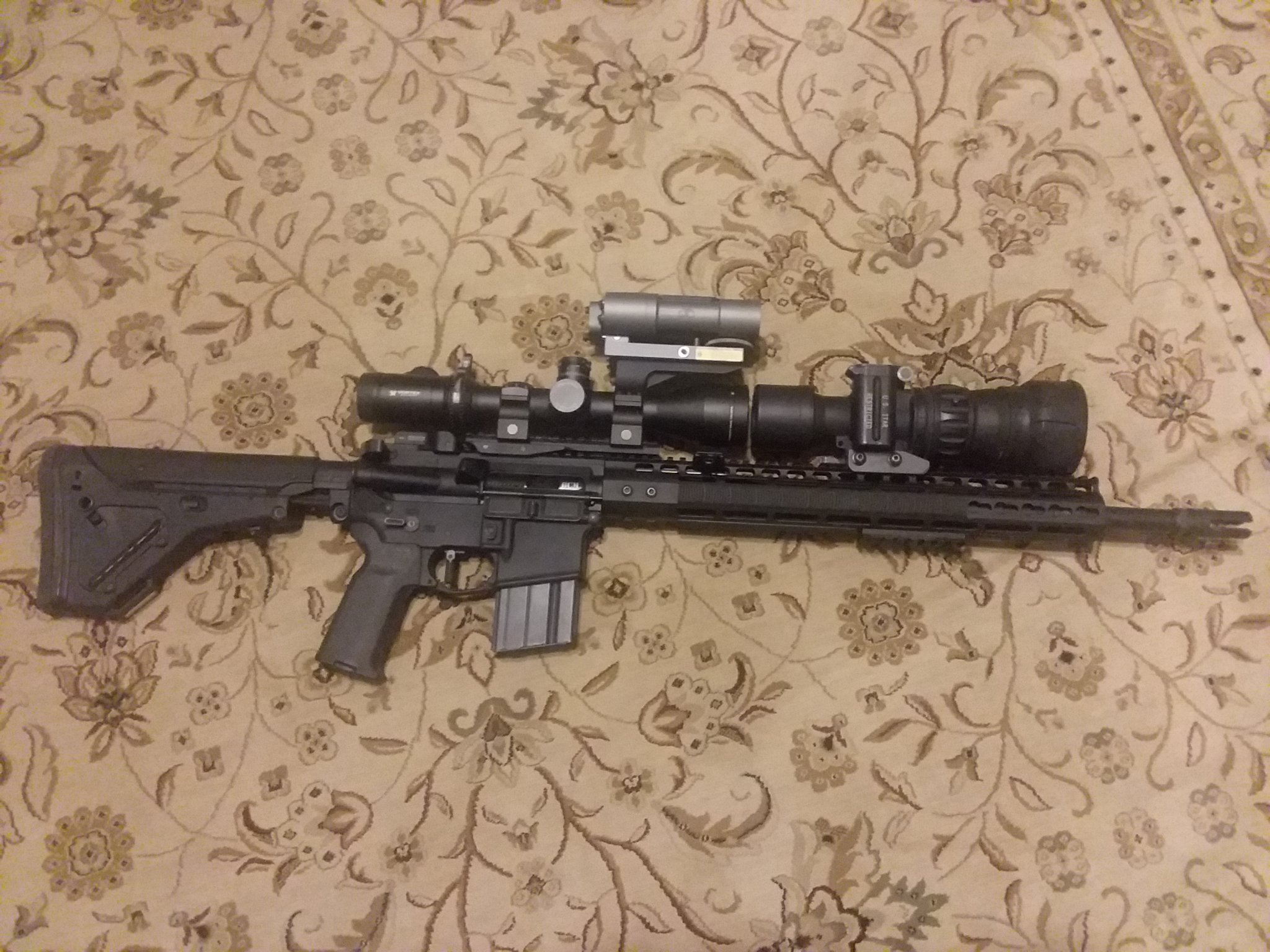

    Most clip ons are designed for a scope that is 1.5" 0moa. What is then it on optic height and angle before you see problems with zero?
    It's hard to find 1.5" 0moa mounts that have a top rail for a radius. I'm getting 2 moa vertical and 2 moa horizantal shift with a lwts in front of a nf 1-8 in a 1.375 20 moa mount.
    Thanks
